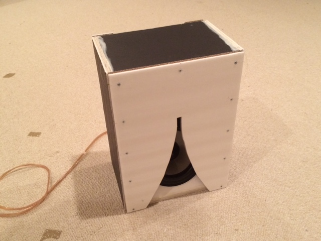

cool - it looks good as a "__Zba" and the woofer box is quite small - how bad is that spray glue on one's respiratory system?
Glue doesn't have too much smell as the spray is pretty directed. I put pieces on newspaper and spray light coat from 8in away. Very quick and thin coat bonds like crazy. Watch for overspray on floor or carpet.

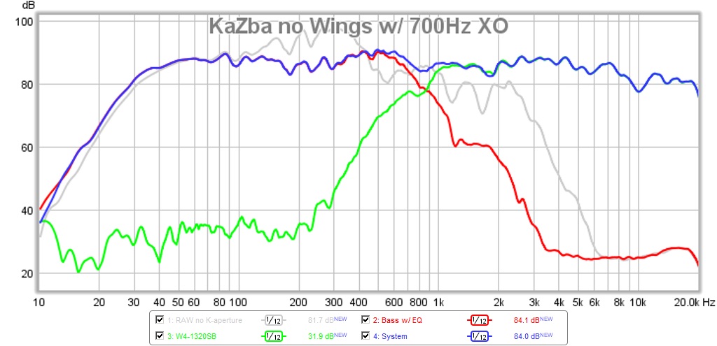

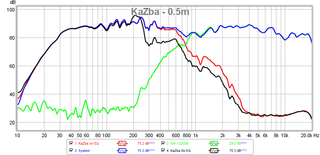

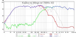

Here is measurement with 750Hz XO and with and without EQ. Title incorrectly labeled 700Hz XO.
This high XO was tested to ensure compatibility with AMT.
Yeah, looking good with such a size.
After the wings are added, the path lengths will be longer, which is equal to a larger baffle. So I expect the bass will improve further.
it'll be interesting to see how it behaves graph-wise plus subjective comments as a full KaZba system with whatever driver X had in the little version.

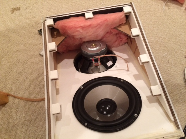

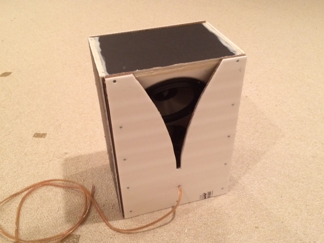

Dual 8in KaZba with K-aperture
Here is the completed KaZba with the K-aperture on both sides. I added some fiberglass in the larger end of each side to help reduce the internal reflections. The K-aperture is held on with screws and a set of internal FC-cardboard cleat blocks. Correction on the dimensions: height is 17in not 18in as stated earlier. Cross sectional area of K aperture was set at approximately same as Sd of one driver. So compreasion ratio is 2:1.
The good thing is that within the bandpass of the slot, there is no coloration of the response from the no-aperture case. However, the effect of the slot and volume behind it produces a bandpass that now ends up at about 250Hz (black), in order to get a flat response to 750Hz requires excessive EQ'ing shown here (red), with the full range top (green). With this much EQ required, this is not a good thing so with this combination of volume and aperture, the XO really should be around 200Hz to 250Hz - in which case the response is quite flat. Here, a 30Hz high pass at -18dB/oct is used and the low pass is a -24dB/oct LR at 750Hz.

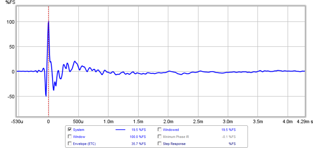

Here is the corresponding impulse response, this is a very rough setup which can still be optimized for time delays and XO point. The W4-1320SB was used at the full range top here. It sounds much better with a XO at 225Hz vs 750Hz:

The red line is EQ'ed, so you boost it quite a bit between 300-600Hz ! Did I read it right?
How does it sound?
How does it sound?
Yes, red is EQ'd by a lot - too much. I have to spend more time listening. Just got build done and not enough time to listen. The one track I heard seems to have a reverberant effect with the XO at 750Hz. But as you predicted, the bass extension is deeper and gets solidly into 28Hz -3dB now. Maybe I am just being greedy thinking it should span 30Hz to 750Hz?
freddi has mentioned several times that the narrow part of the aperture affects the higher range a lot.
Your apertures look a bit short, with one of the driver almost completely covered. Would this be the reason for the recess of midrange?
I thought the narrow part affects the bass more - as HF's need large spaces to pass through and bass squeezes through the narrow portion? I can try extending it. It may have more to do with the top driver being blocked so that mids have to bounce around to get out.

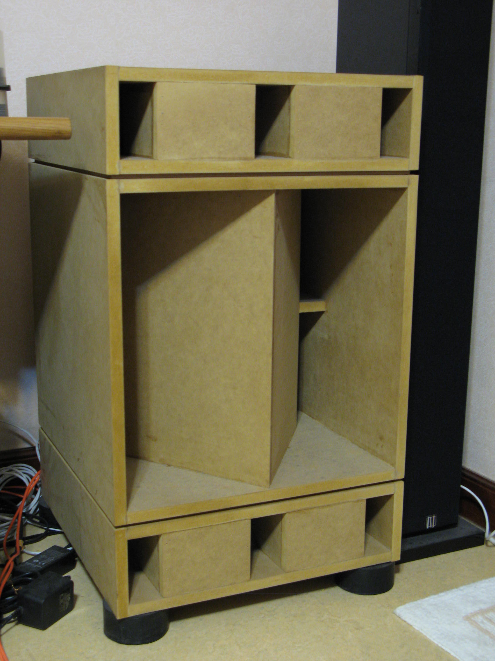

snappy FR - KaZba's kick drum sounds good - are the aperture plates removable? - if so , then you might investigate the effects of a larger starting gap. Carl's 20 year old isobaric passive radiator klam had a large gap as he reasoned there was no need to disperse highs.
I don't know what driver was in C's klam but you can see that it augmented 8-10" Scan Speak woofers - its aperture

if the aperture plates are permanent, then you might extend the slot towards the top - maybe as a narrowing slit - I don't think it would have a big effect on response - might get worse - its an unknown as your KaZba is a fresh idea.
X - what is the Q of this KaZba? - you can run an impedance sweep and read it as would free-air parameter (I think)
The aperture plates are removable - hence the cleat blocks for screwing them in. Enlargening the aperture must have an effect on increasing the bandwidth as the asymptotic case is no aperture. I can run an impedance scan of the KaZba - do I just look at Qts as the total cabinet system Q?

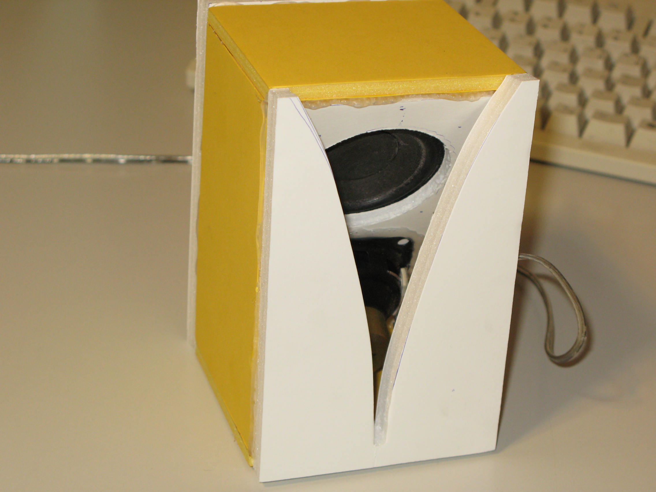

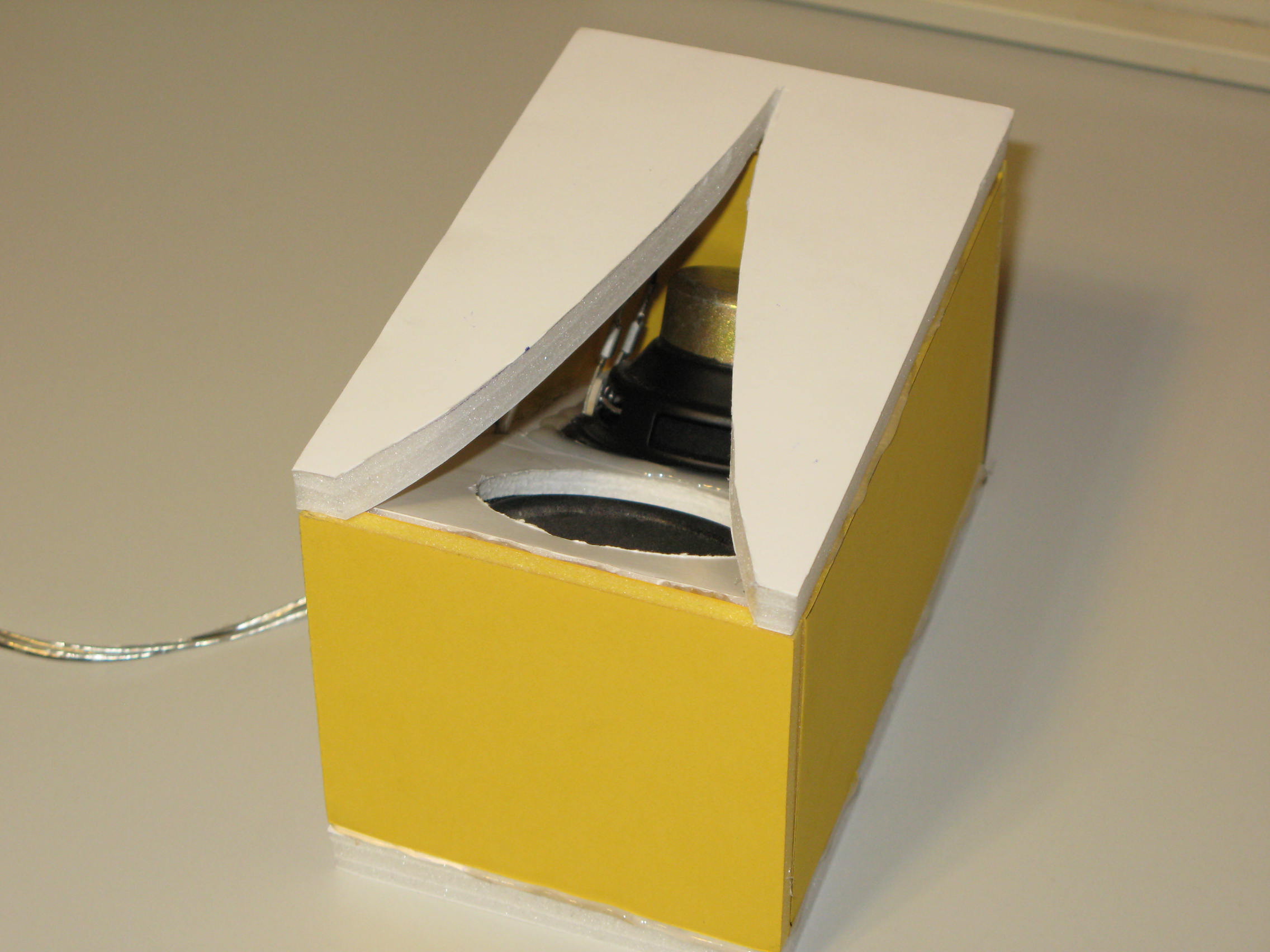

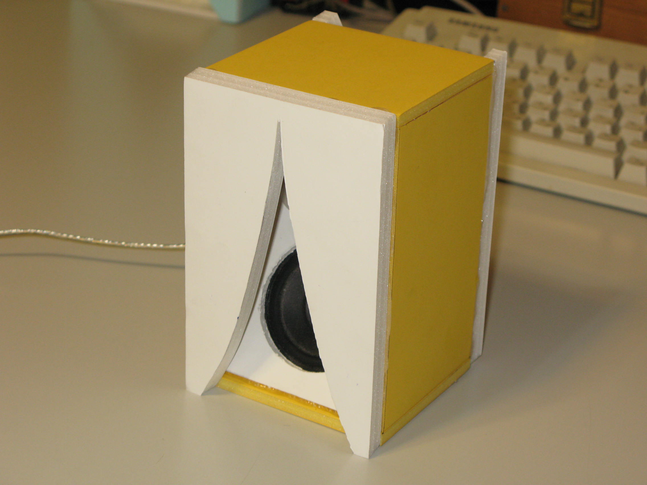

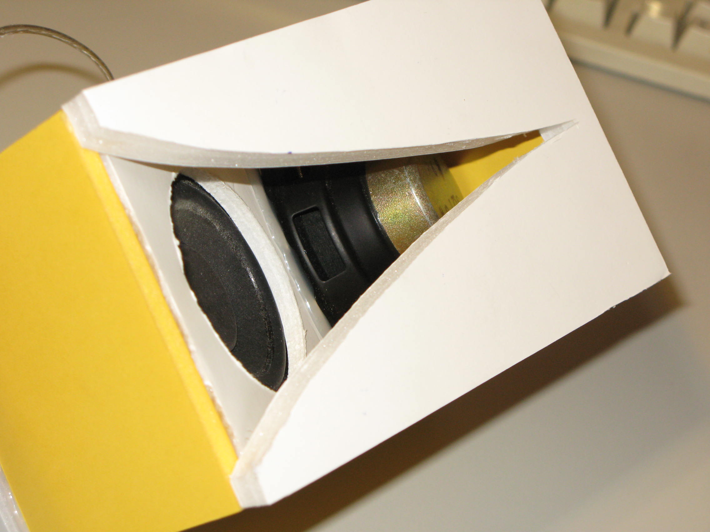

This is my KaZba mini.
I made just one with two 2 inch woofers that came out from a Klipsch igroove.
Just straightforward foamcore construction, with the K-aperture made from 1 cm thick FC.
The push-pull arrangement really helps the cheap drivers, and cleans up the sound.
I figured I could get maybe 350~1200 hz out from this guy, so I hooked it up to my 3-way rig, and gave it a listen.
The sound has that open baffle 'ambience', but due to the K-aperture, it is
crisp and snappy, and more 'focused'. (as opposed to the 'diffused' sound from OB's that I am not too fond about)
My opinion is that this KaZba design is definitely an upgrade to the standard OB's that I have experienced till now.

Just a few questions regarding the push-pull orientation.
1. What about the W frame PP as in LX521? Will it be usable?
What do you think the pros and cons be against the standard PP mounting
in original KaZba?
2. Can you use the PP orientation in a double driver Karlsonator?

Bolexsbm,
Thank you for the kind words and Wow! Nice build there! You make good looking foam core stuff. Do you paint it? What are you using for bass and tweet given that you were aiming for a midrange on this? K-tube tweeter no doubt 🙂
Congrats
Regarding the Z baffle push pull vs Linkwitz W baffle push pull they are probably very similar - I would bet they model almost identically in Akabak. The Z baffle lends itself more to having the larger part of the K aperture aligned with the front face.
The motion on the Z baffle may have more vibration compared to the W which has semi orthogonal motions. A true counter facing push pull slot will cancel motion induced vibrations.

xrk971,
Thanks for the compliment! (It means a lot, coming from you)
And also thanks for sharing the design(s)! Next on my list is the xki... 😉
The foamcore is the colored variety which comes in 4-5 colors, I think.
(The yellow one is some scrap left over from my 200hz 'Smithagrain' Paraline project - I'll try to post the details in the FC speaker thread)
I'm using a K-tweeter for highs as you guessed.(Unit is from Klipsch Promedia - I used to be a Klipsch guy - had almost all the Heritage series at one point. LOL)
For bass, I'm using scaled down (to 12 inch size) DIY LaScala which has quad 8 inchers per side in a PPSL plenum with the djk ported mod.
I know LS has limitations as is, and when scaled down, it's usable range kinda 'shrinks' 🙄
But I have a soft spot for Klipsch designs, so I really wanted to make one for myself, incorporating all the mods.
So my LS plays the 80~300hz range, and my experiments take it up from there. (I live in an apartment, so can't play much lower anyway. 😀 )

that LS is adorable 😀 - where are its corner and -10dB points? are your drivers 8" or 6"? I don't think PWK's little bast$rd (LB76) could play as well (?) bolexsbm - have you tried cone K-dispersed tweeter? (or maybe a piezo with K-aperture?) I know the K-tube is "king of tweeters" - lol (but true over a certain range with good compression drivers)
