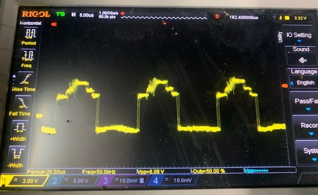

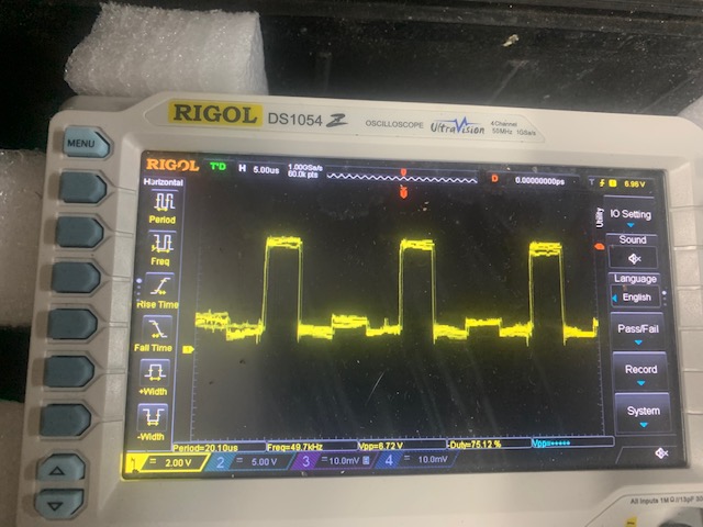

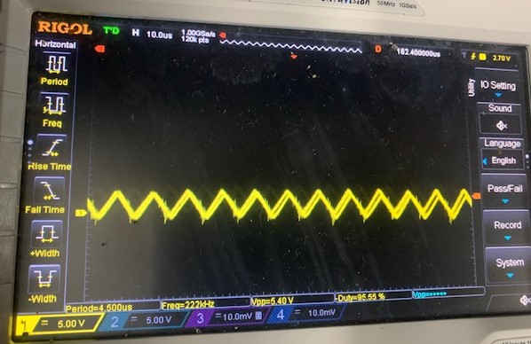

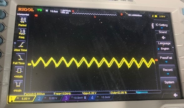

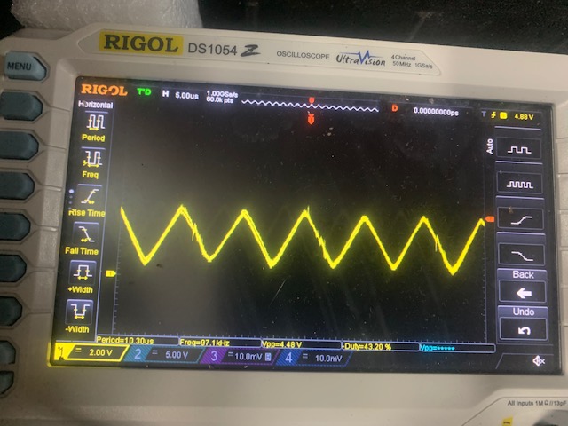

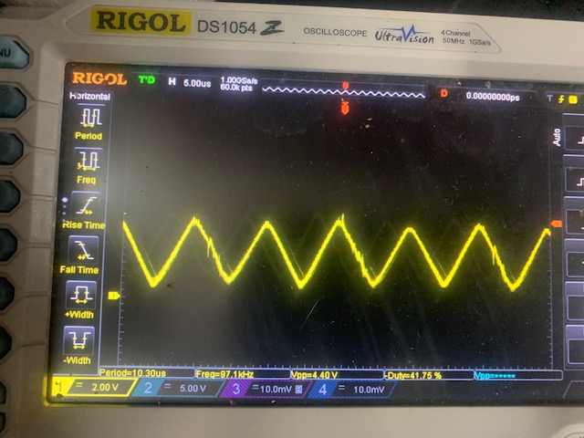

Hi guys, I got this amp in with blown PS and output FETs, I worked through the PS and got it running:119v. I then moved across to the audio side and replaced all four drive circuit components along with the two 5110s. I've powered up the amp with only four output FETs installed (Q414, Q417,Q426, Q434). I'm getting (attached pics):
- a clean triangle wave on pin 5 - U301, 302.
- a fuzzy square wave on both toggle A and B.
I found the 10v gate drive voltage on the 5110 (pins 3 and 6), to be 3.6v. Without the audio board connected, I'm getting the 10v gate drive voltage at the emitter of Q45 and at the grey ribbon cable. With the audio board connected it drops back to 3.6v. I worked my way through the drive components a second time looking for shorts and leaks but nothing, I replaced both 5110s again, same results. I looked at the LM317 and replaced as a precaution, again the 10v gate drive drops to 3.6 when the audio board is connected. ?
All other voltages (5v ref, 6v, 15v) are present. Is my 74hc74 bad?

There's a 10V gate drive voltage, pins 6 on the LM5110 its reading 3.6v.

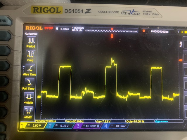

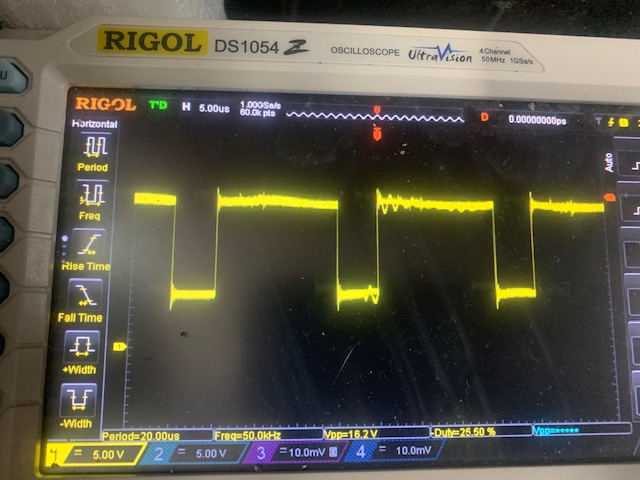

I removed both 5110s and Q402, Q403, Q408, Q409 out the drive circuit. I powered up the amp without blue and red wires connected (both ribbon cables and white wire connected, as you stated above Perry). Signal looked a lot cleaner coming into both solder pads 2 and 4 (of the two 5110s). Voltage on solder pad 6 measured 11.02v.
I soldered in one (new)5110 and powered up again, voltage on pin 6 fell to 5.15v. Signal waveform on pins 2 and 4 went back to weaker and fuzzier as before.

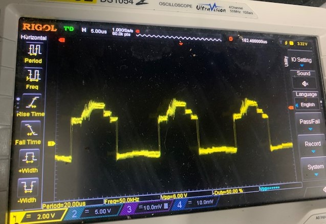

I have all the drive components installed, I removed both transformers, both 5110s run cool, not heating up again. I attached some pics of waveforms at various points, with and without R315 jumpered they look almost identical. it seems both transformers are shot.

Ok folks, I received the replacement transformers and after a long weekend, I managed to install them, had to replace both 5110s again, and I found a defective zener diode D412. After replacing them all, I got carrier triangle waves on U301 and 302, and square waves for both toggle A and B. All appeared alright on the scope, I installed all 20 output FETs. Amp powered up for a few mins, gate drive voltages on both 5110s were verified at 9.96v, all op amps in the audio section had their +\- 14.85v, all op amps in the BD section had their +\- 6v. Amp was shut off for a few hours, when powered up it goes into protect. In addition to this, when I remove the remote power, the amp remains powered up.
