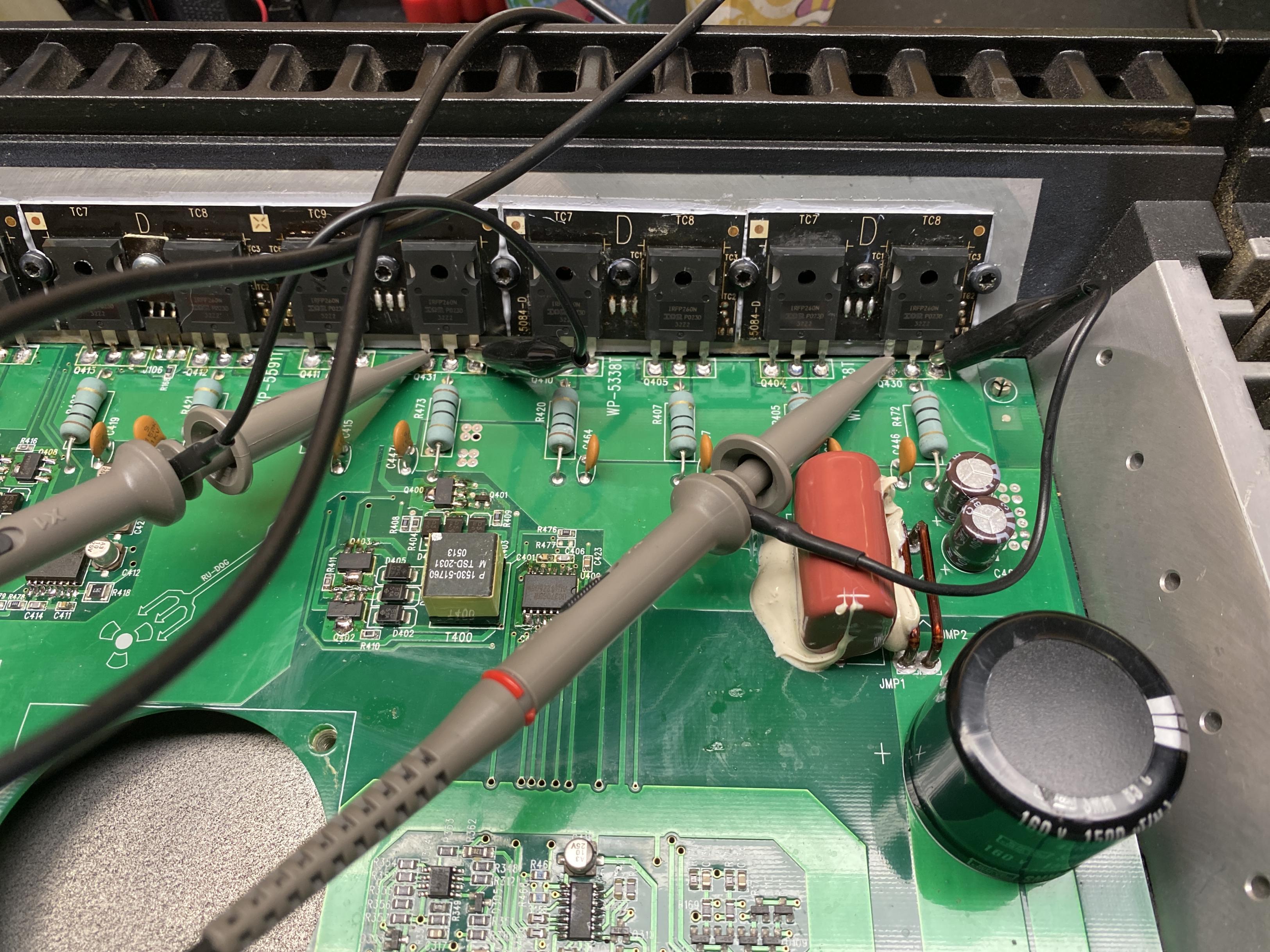

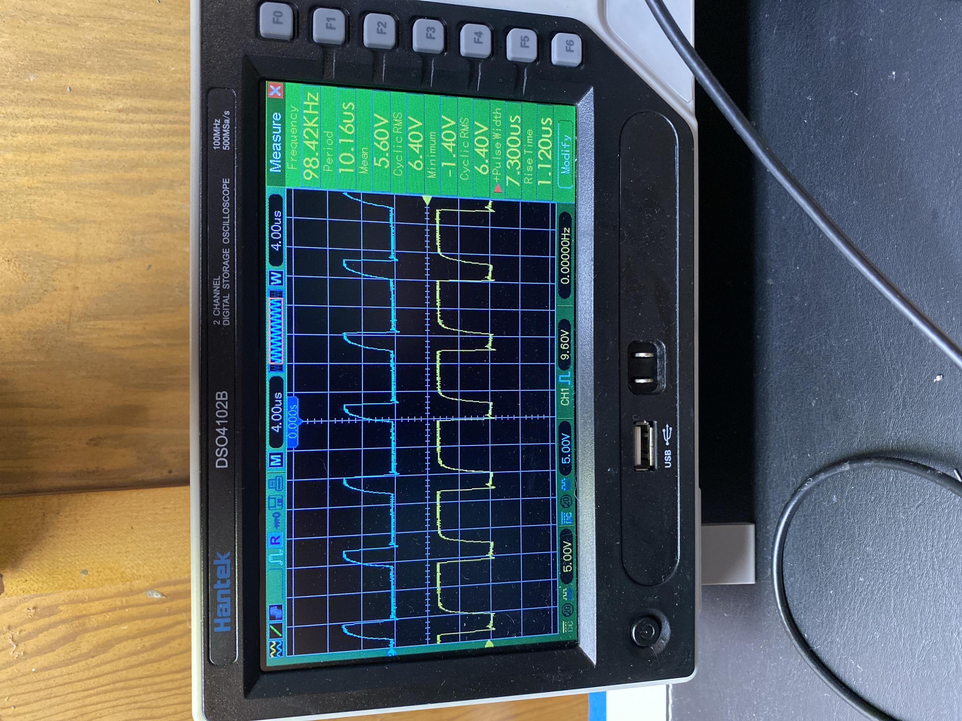

There are all sorts of problems that you could have with the drive circuit but I don't see any. The drive at the output transistors looks OK. I'm assuming that the drive to the other two banks is OK as well.

It’s almost like it’s trying to share the voltage with banks but cycles in and out of protect. I will go back through the driver circuit and double check I didn’t make a mistake
You're losing drive because there's too much DC offset. That may indicate that there is some leakage in the output stage (contamination, leaky output).

I rebuilt the driver circuit this morning. I didn’t rebuild it initial because I didn’t see any bad components. When I power the amp with hv the is just cycling in and out of protect.
