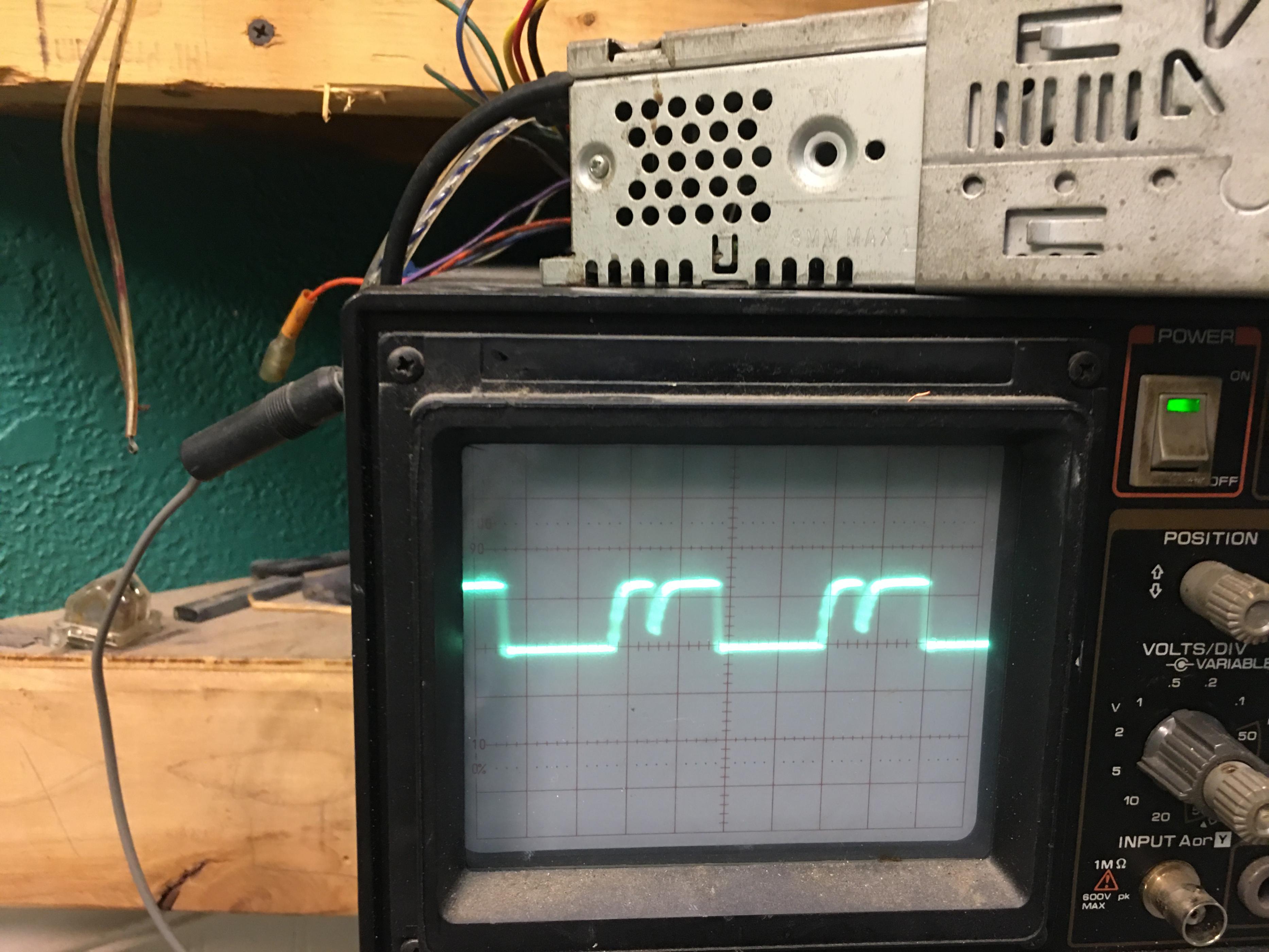

Rockford Fosgate T2500-1bd
Scope is set to 2us 5volts/div
This is what I get on the gate of the outputs

Ok amp came back to me and I just opened it up .
It happened to me on the bench once but it has the same issue .
The power supply drivers keep blowing . All fets test good I triple checked them .
Do you have any ideas on why the power supppy drivers keep blowing ?
Just the ones on the main board . Q100,101,102,103. They blew before when it was here the first time I replaced them and it came back with same issue .
It did blow that bank of fets . Q1,2,3,4,5,6
So now it has blown the same bank of drivers twice .

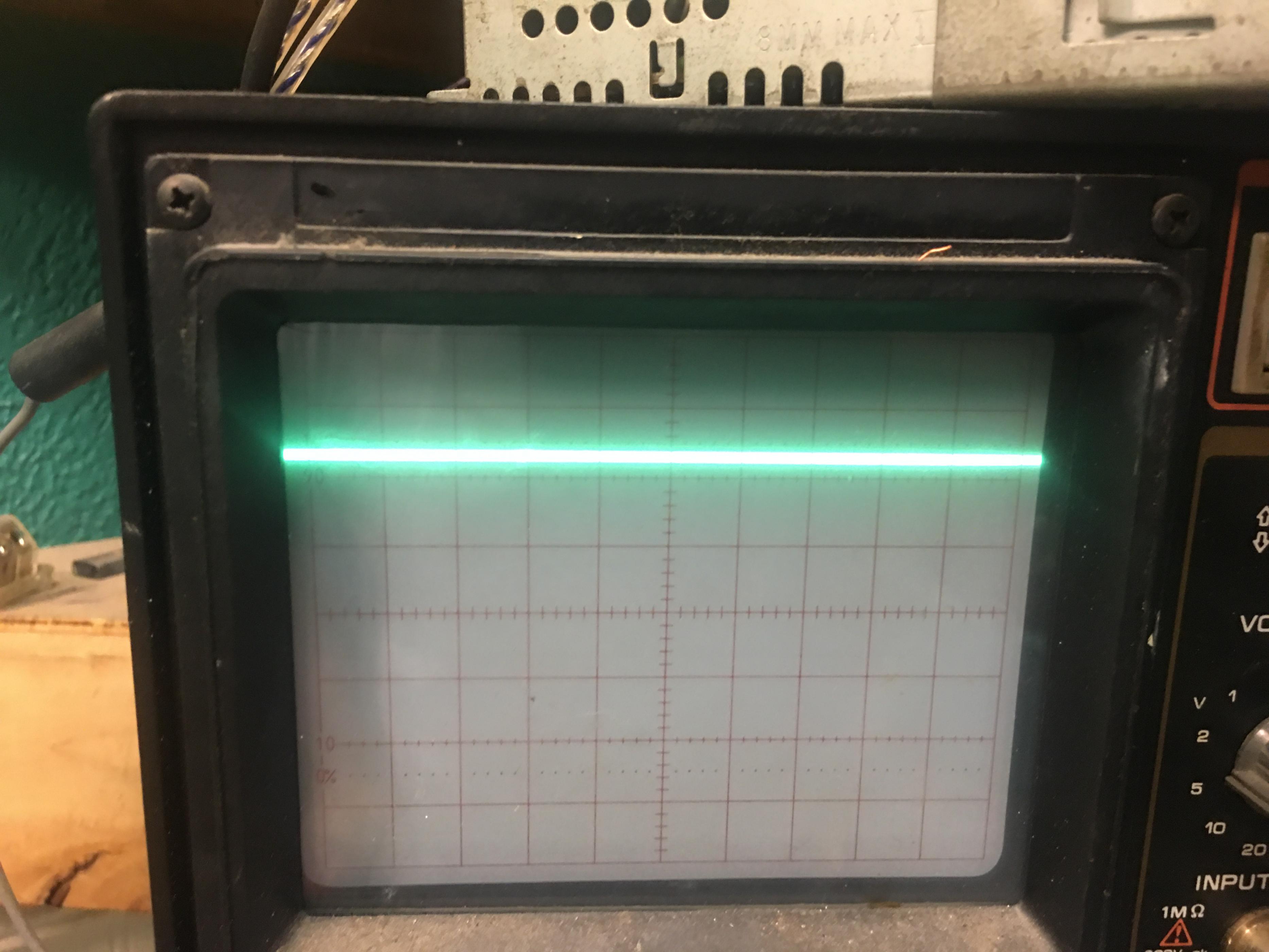

Can I just use remote and ground and post a pic of the waveform on that bank ? Fets are out of that bank right now
