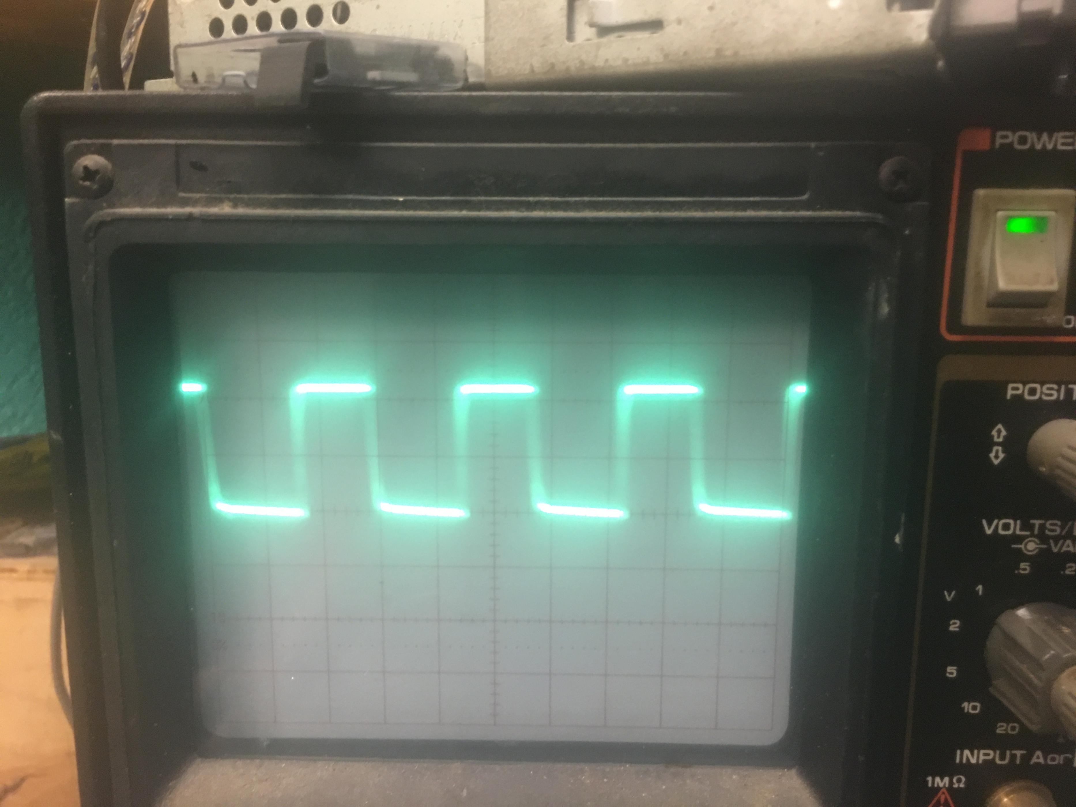

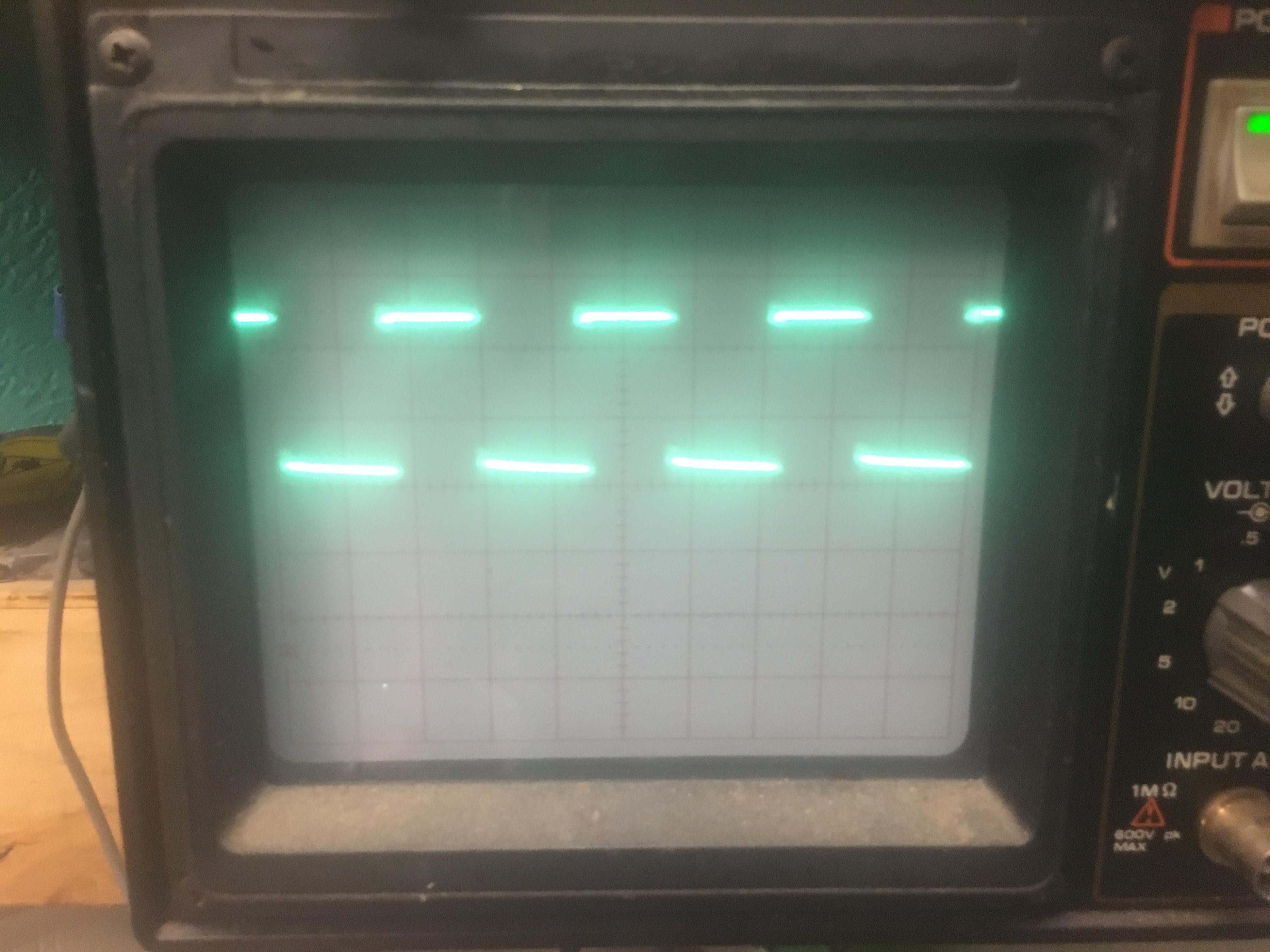

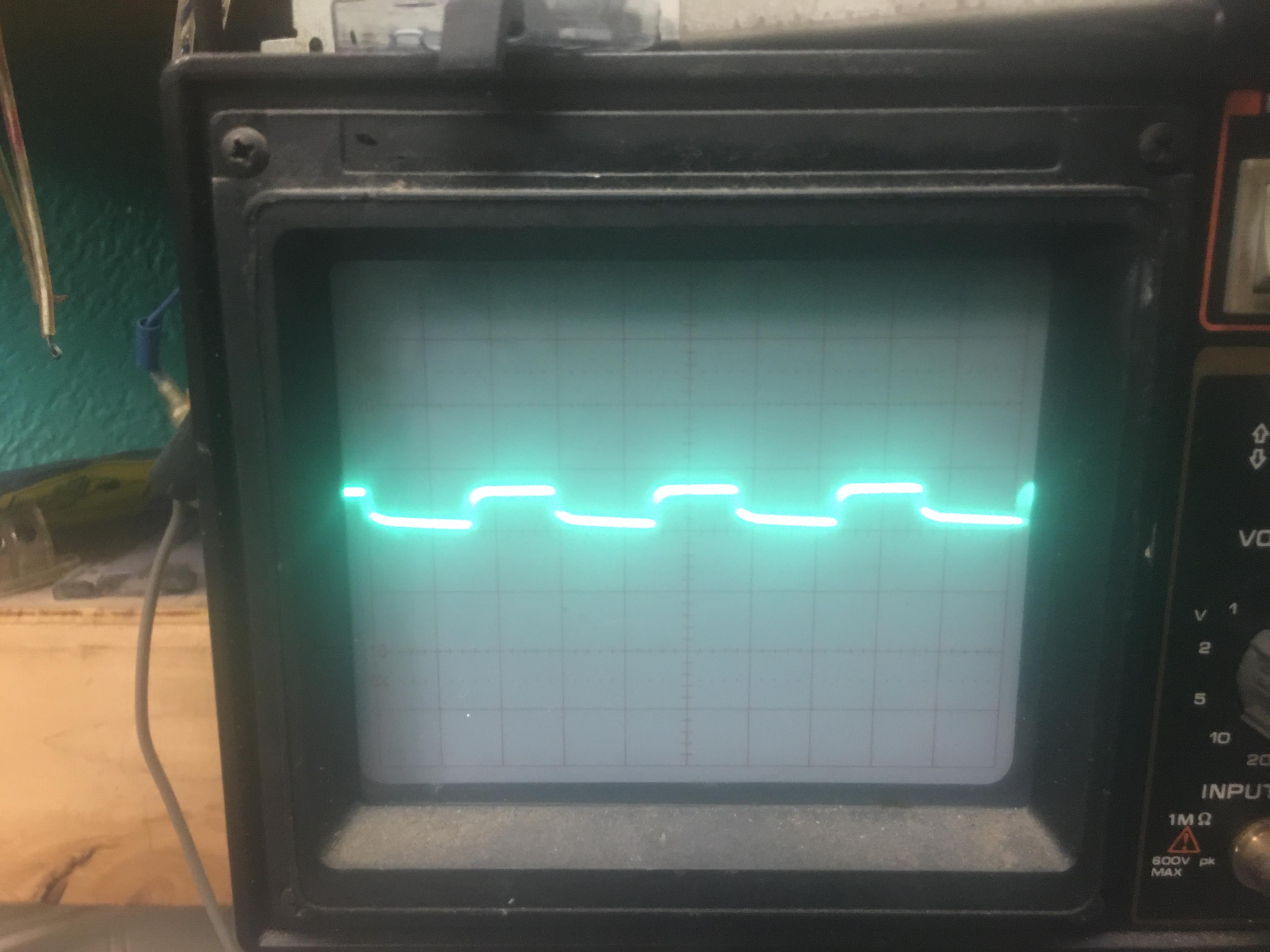

So I after replacing the drivers fets and some diodes .
This is what I get on both banks of fets .
Scope settings are 5us 5volts/div
Do these drive signals look good ?
