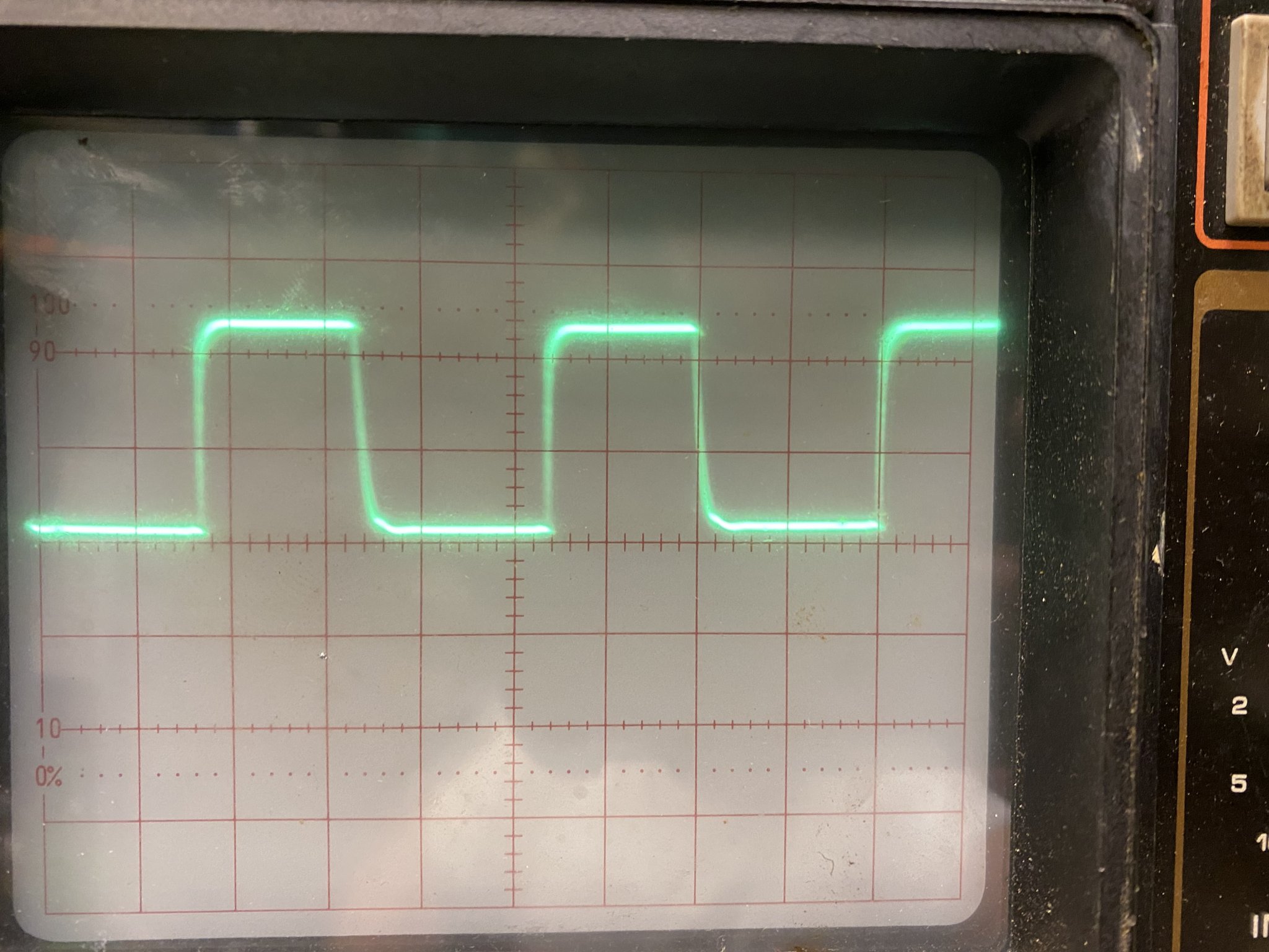

Ok the driverboard is fine the issue is on the main board somewhere i have an open connection somewhere since the drive comes out of the driverboard but doesn’t reach the fets
Something on the driverboard is defective I switched out driver boards and now o get signal to all fets . Here is what I get the drive signals are identical on all fets
Scope set to 10us 5 volts Div
Were you getting 2 drive signals to the header of the other driver board?
So, no heating of the FETs, now?
No hearing of the fets I had a bad connection on one of that gate resistors I didn’t notice until I powered it up and it blew the fet . I have spares from the same batch so I’m good there

You have to have the same value for all parallel FETs.
51 ohms in place of the 60.4 should be OK.
