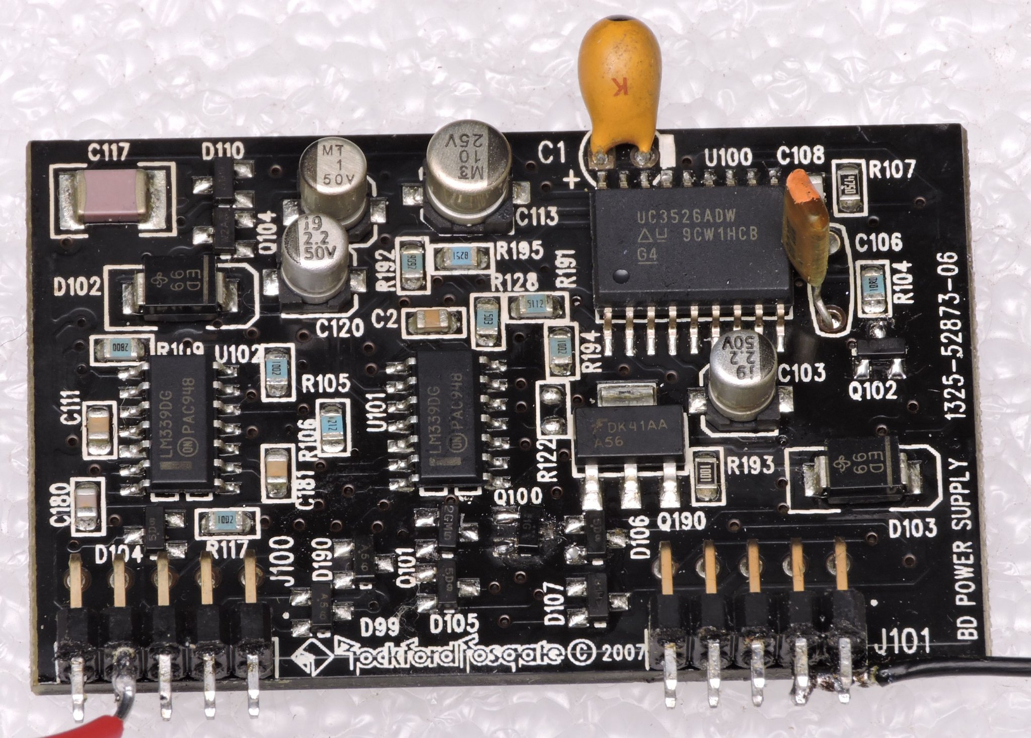

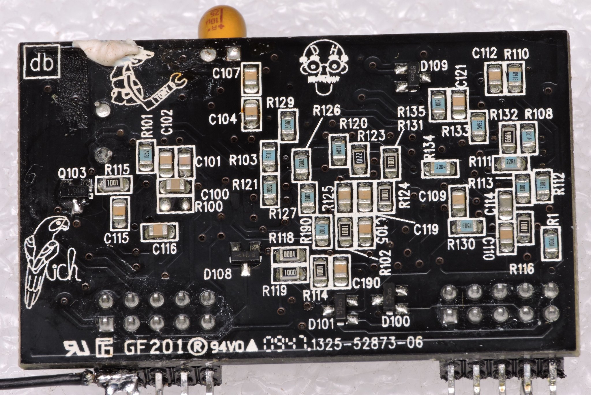

Something on the driverboard is defective I switched out driver boards and now o get signal to all fets . Here is what I get the drive signals are identical on all fets
Scope set to 10us 5 volts Div

No hearing of the fets I had a bad connection on one of that gate resistors I didn’t notice until I powered it up and it blew the fet . I have spares from the same batch so I’m good there
The problem I have now is the gate resistor is also no good . I don’t have any 60.4 ohm gate resistors or 47 ohm .
wondering can I leave the original 47 ohm resistors and on the other bank of fets where they were 60.4 ohm can I switch them to 51 ohm ?
Only asking since I don’t have any 47 ohm resistors and I can’t just switch 1 resistor out I have to switch all 3 out
