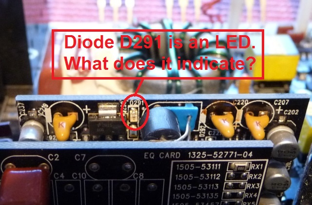

I thought D291 may light up when the amp was over-driven but it didn't on the amp I have here.

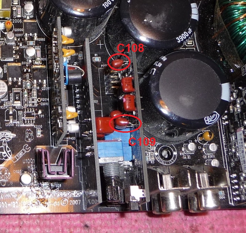

I though I felt something hot on the crossover board, and probed the caps on top of the board and found DC on one side of C108 and both of C109. Circled in red in pic below.

Anybody know the value of the metal film caps C108-C110?
I have them circled in the attached image.
Two of them have markings 'L7-154' and two have 'L7-184'.
One has a split...
C108= .18uf (CYV-184-024)
C109= .18uf (CYV-184-024)
C110= .15uf (CYV-154-024)

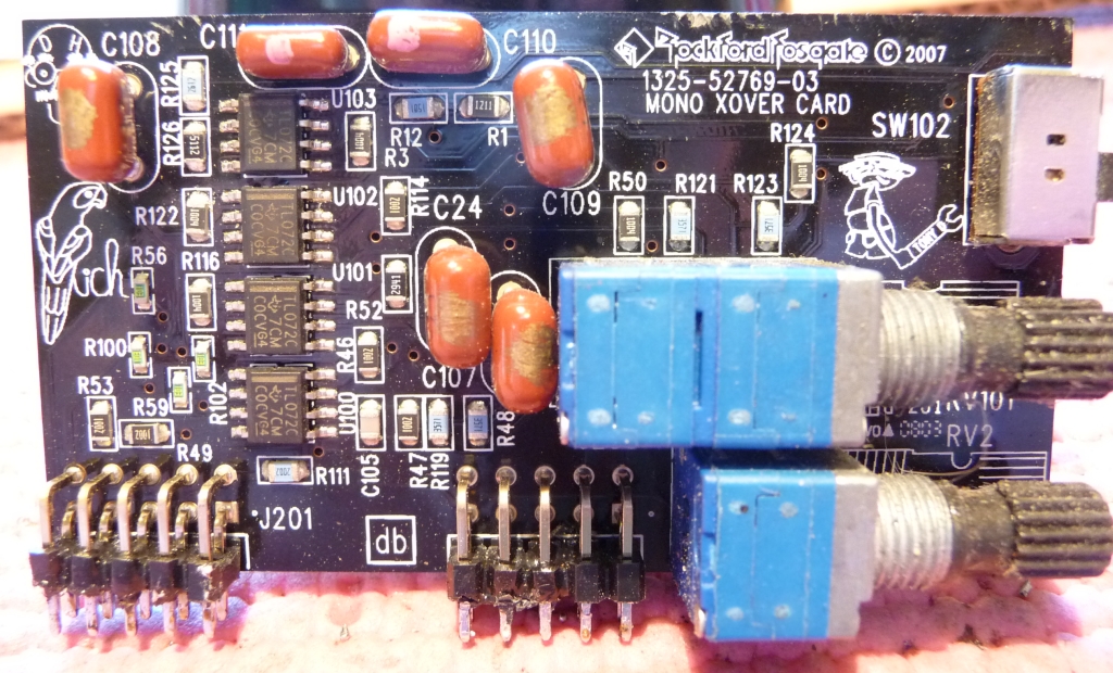

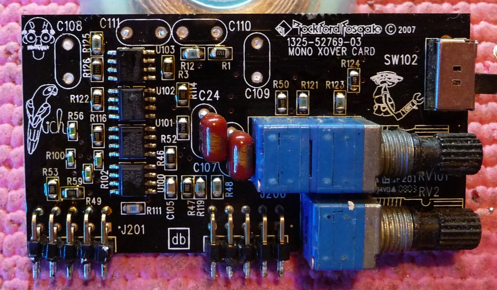

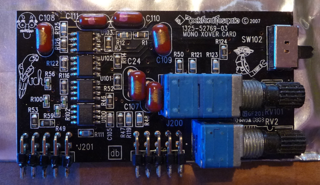

also, some pics of xover board

Here are some pics of the Crossover board. Hopefully they'll help somebody down the line. I've already put the 4558s I had where the first TL072's were, and the caps are out, but should be good for reference... I'll prolly get some TL072s; I just want to know where I'm, at on this thing.
