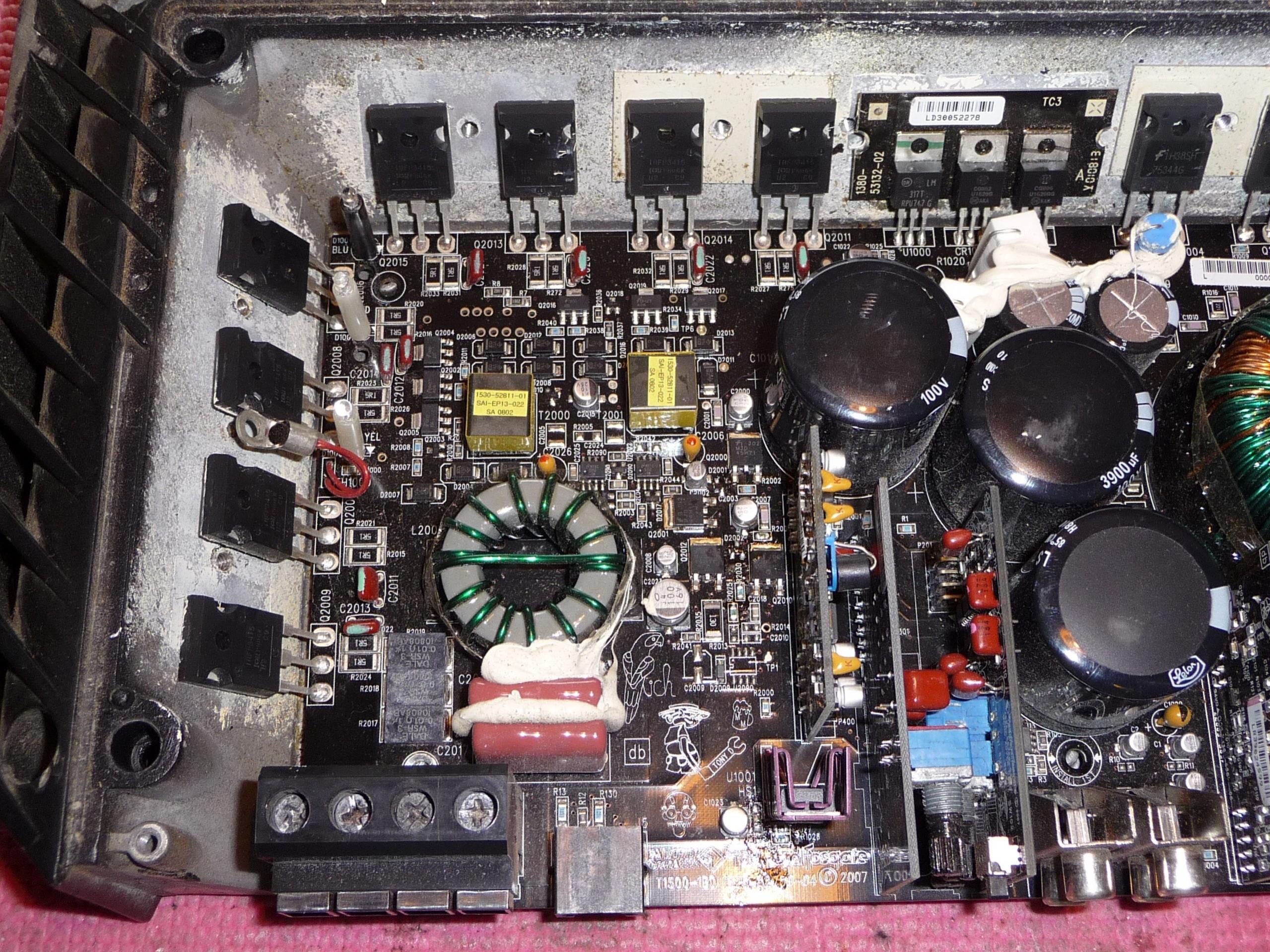

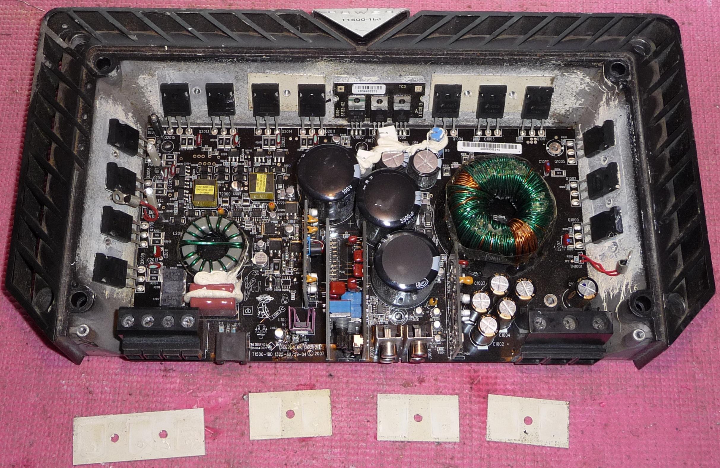

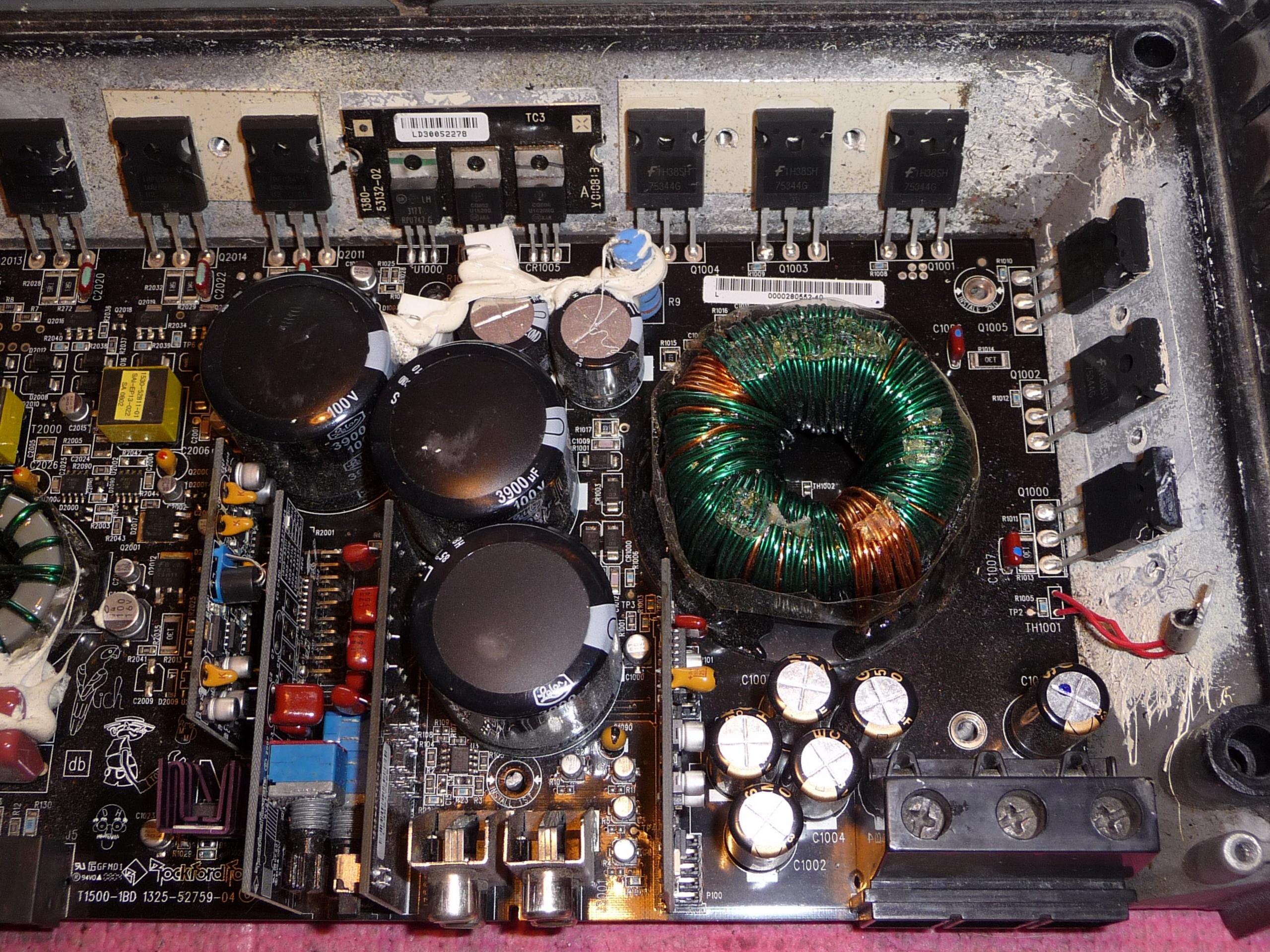

Hi Folks, checking out a Rockford Fosgate T1500-1bd.
It just stopped playing. No protect light, no smoke, no fuses blown. It appears to turn on normally, just no output.
I checked the outputs (IRFP3415) and the supply fets (75344g), all good.
The rails read +32 and -40 at CR1004 and CR1005.
After you turn it off the pos rail runs up to 77volts or so, while the neg rail quickly drops from the -40 to 0.
The low voltage supply seems kind of funny - at the rectifiers (CR1000-CR1003) the output is plus/minus 26.8 volts, with the LM317 reading +14volts and the LM337 -15volts.
The lm337 heatsink seemed to get really hot really fast, and somethings warm on the subboard next to it (left most board)...
Does anyone know what the rails should be?
I have a schema for a Power 2004 T10001bd. Does anybody know if its close?
I have to run out for a minute, but I'll remove the subboard when I get back I guess as there's no access to it for metering, etc.
Also, this amp has aluminum panels instead of the normal thermal boards....?
So, any ideas on where to start?

checking trans Q2000, etc
Confirm that the regulator transistors Q2000, 2001, 2010, 2012 have the correct output voltage (-6, +6, +10, +10 respectively).
Check the solder connections on R2035 and make sure that R9 isn't broken from the board.

You have to measure the rail voltage with the two probes on the center legs of the rectifiers (no probe on ground).
This amp uses metal heat spreaders with an insulating coating. There should be one behind all of the output transistors. Do not let the transistors touch the heatsink.
The diagram that you have may be good enough to give you some idea of what the circuit is but it's not close enough for most components.
Don't remove anything yet.

Rail voltage
Ok, the rail measurement is about 20. As I apply/remove Remote it pops up to seventy for just a moment then comes down just as fast.

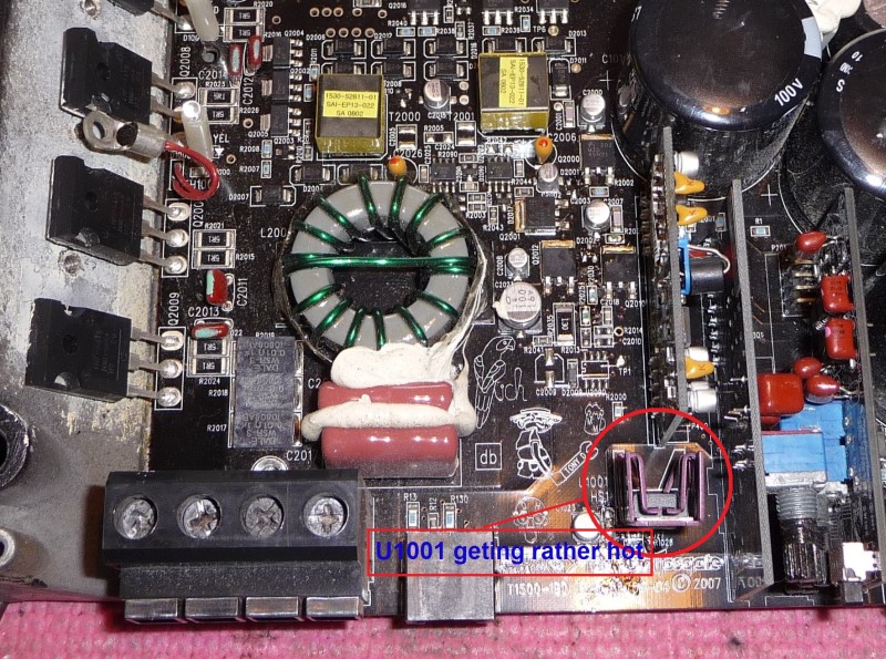

Also U1001 (regulator on separate heatsink - pic, seems to be getting really hot.)
Anybody know where I should be seeing audio or what pins of the preamp boards should have it?
Or any comments on the regulator U1001? Does it normally run hot-hot?

Anybody know if there should be anything in R109, C14 or C15? Just want to make sure they should be empty. Solder looks right, but...
