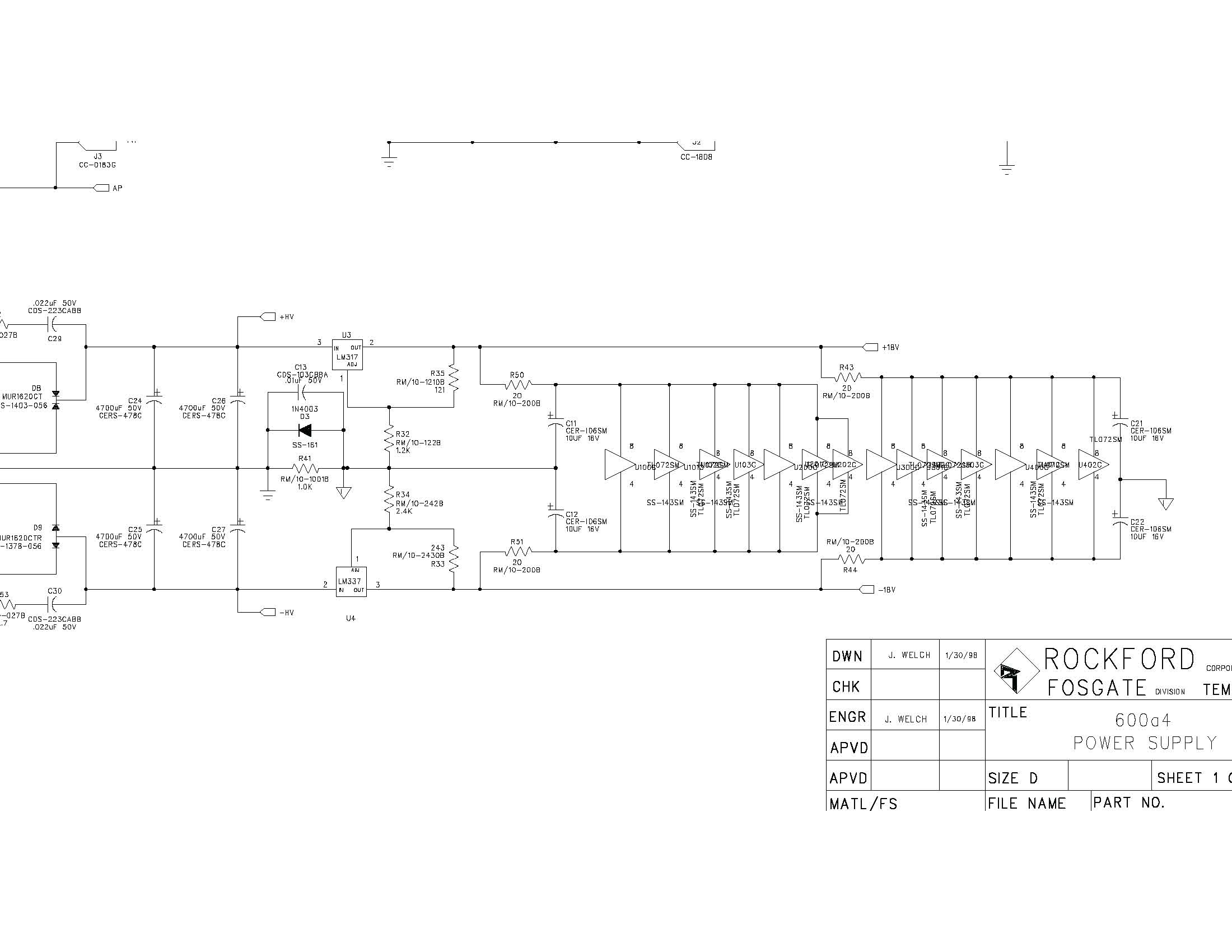

I went ahead and got voltage off all the remaining TL072s and they were all basically the same (except the one I have pin 4 & pin 8 lifted).
R50: 0.60v
R51: 0.60v
R43: 0.54v
R44: 0.53v
But this is with U402 pin 4 & 8 lifted. Should I resolder those and check again?

Try reconnecting U402 and see how the voltages change.

Adjacent as in U202? That is with the other parallel set of op-amps and would hypothetically change R50 & R51, I believe. I have to shut down for the night but I'll check it out tomorrow. Thank you for the help

Before then, would it be a good idea to lift, for instance, R50 & C11 (and maybe R51 & C12), to isolate that entire set of opamps? I guess I'm not sure what we're looking for by only lifting the power supply to any given opamp, or replacing one we've already lifted the power pins to.
That's going to take half of the load off of the regulators so, of course, the regulators will run cooler.

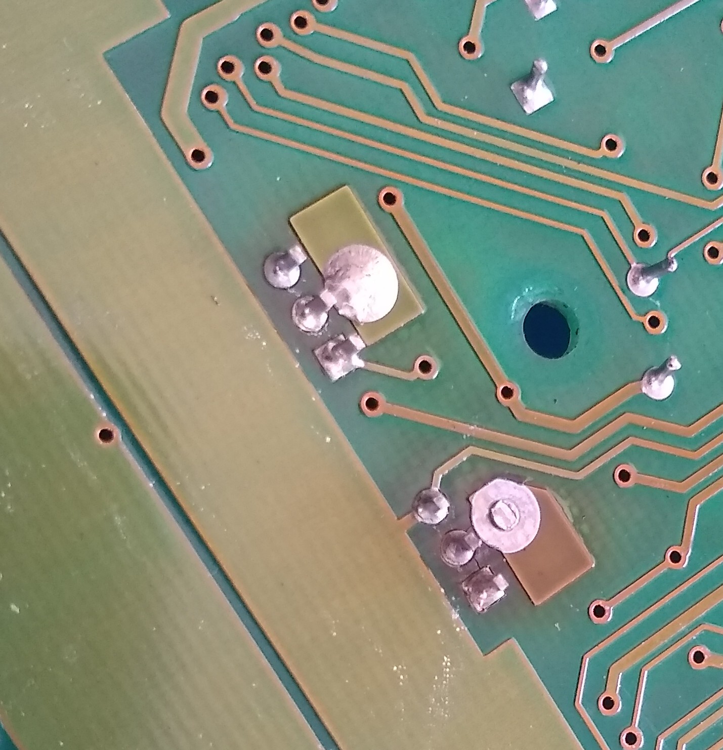

My main concern is the extreme heat of the regulators, being, or having been, hot enough to do damage to the board around them.
Is it normal for all the MPSA06 and MPSA56 to get hot at idle as well? Not 200° hot, but as much as 120° give or take.

The two groups of op-amps are drawing approximately the same current. Look at the drop across the 20 ohm resistors. There may not be a problem but I don't remember the op-amps getting hot.
I looked at the photos on the ampperformance.de site and the regulators were showing signs of heating the board (bottom photo). I don't know how much use the amp had compared to yours. In Germany, they likely had cooler temperatures than we do.

I guess I am concerned that this is too hot, considering it gets over 200° even with low 70° ambient temperature. Here's a close-up of mine - looks like the PCB has even cracked a little.
