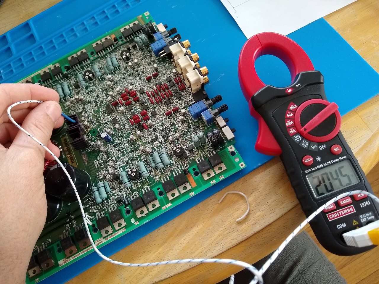

Audio output from all channels still seems fine at low volume, and you're correct that the whine stops before the mute delay lifts. I reflowed the cracked looking solder joints on the regulators, and also some similar looking joints on the output fets. Still getting plenty of heat from the regulators. My measurements were slightly different, but that may have been my meter battery was dying.

You are on the tab. If the tab is hotter than the heatsink, add some heatsink compound.
I don't know what's normal for these. There could be a load that heavier than it should be.
Are any of the op-amps running hot?
Yes, but I was getting similar readings off the back of the heatsink.
Q6, Q8, Q13 are definitely heating more than Q5, Q7, & Q12. About 125°F compared to about 100°F.
U202 is heating as much as 117°F give or take, and similarly U402 next to it. It's difficult to get accurate readings. The other TL072 chips are getting warm also, but these are the hottest as far as I can tell.
I just noticed if I take a voltage reading off pin 1 or pin 2 of the TL494 I get the same coil whine as when the amp is powering up. Not sure if that's relevant but figured I'd mention it.
Q6, Q8, & Q13 drop down to similar temps of Q5, Q7, & Q12 if I lower the supply voltage from 14V to 13V. U202 & U402 continue to be around 116-117°. I think U402 may actually be the hotter of the two, but only by a degree or two.

I lifted PIN 4 and PIN 8 of U402, TL072C. Before lifting those pins I was getting different readings on R43 and R44. I was getting about 40ohm on one and 37ohm on the other. With U402 PIN 4 & PIN 8 lifted they both read correctly at 20ohm.
Regulators are still heating to the same amounts as before. At 13.5V input I get:

Is the op-amp next to U402 still heating like it was?
It's possible that the op-amp was defective (leaking internally) but not causing any significant current draw from the regulators.
Yes. It seems most of the op amps are heating. Some more than others. My IR gun is difficult to aim at such small areas precisely. The LM833 are also heating.
Where is the LM833?
The voltage is well within what the op-amps can withstand. I don't remember TL072s getting hot but they can't all be bad.
Pick one of the hotter remaining ones and post the DC voltage on all of its terminals.

There are two sets of 4 TL072 and 3 LM833 paralleled together on pins 4 & 8.
DC voltage on U201 TL072:
Pin 1: 0.57
Pin 2: 0.57
Pin 3: 0.56
Pin 4: -12.15
Pin 5: 0.48
Pin 6: 0.50
Pin 7: 0.50
Pin 8: 13.67
I get almost identical readings from U401 on the other side of the amp
Pin 1: 0.57
Pin 2: 0.57
Pin 3: 0.56
Pin 4: -12.15
Pin 5: 0.48
Pin 6: 0.50
Pin 7: 0.50
Pin 8: 13.67
That op-amp looks healthy.
What are the circuit board designations for the LM833s?
Do you have the same voltage across each of the resistors in the two pairs of 20 ohm resistors?
