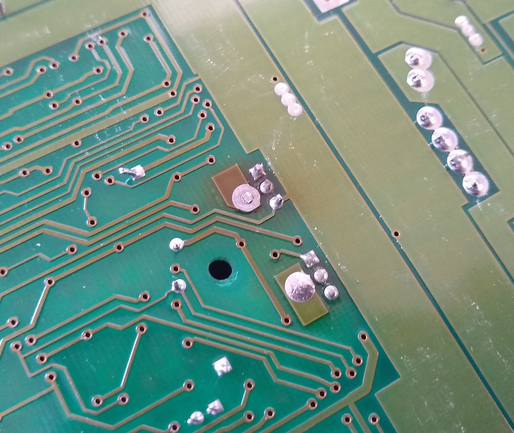

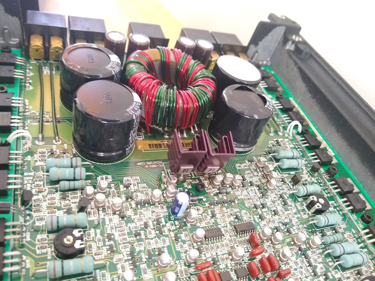

U3 (LM317) and U4 (LM337) are in the middle of the board with their own dedicated small heatsinks, and they are getting painfully hot.
Output sounds okay from all 4 channels during a brief test, and there were no shorted outputs or any other damage I could see, except that the toroidal transformer is mounted so high that it's rubbing and being pressed down by the case cover, forcing the pcb to bend under the pressure. Also, the filter caps aren't looking so great, with one even being dented somehow.

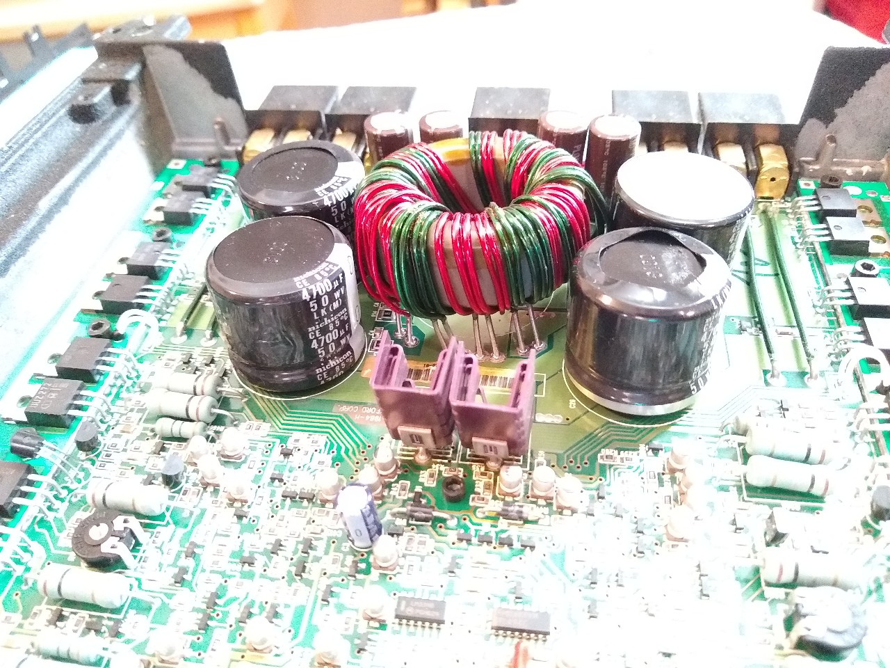

The transformer will obviously have to be lowered towards the board.
The caps may be OK. The tops don't look swollen. The heatshrink isn't a good indicator of the condition of the caps.
If you pull the caps, be VERY careful. If the vias are tight, it's easy to destroy them.
Make sure that the regulator heatsinks aren't touching. They can run hot and survive. They have internal protection circuits that shut them down if they are in danger of failing. The ones in the BD amps operate at very high temperature and only very rarely fail.

200 degrees Fahrenheit, right? That is pretty toasty -- warmer than I like -- but a reasonably safe distance from imminent death. Also, not too unusual for modern gear. Once you get the rest of it all nice and peachy, it might give a little extra reassurance if you were to run it for 10 minutes with loads, and the cover just sitting on (assuming that's possible without damage). Then pop the cover and aim the infrared gun -- just to confirm that it isn't 30 degrees worse all buttoned up.

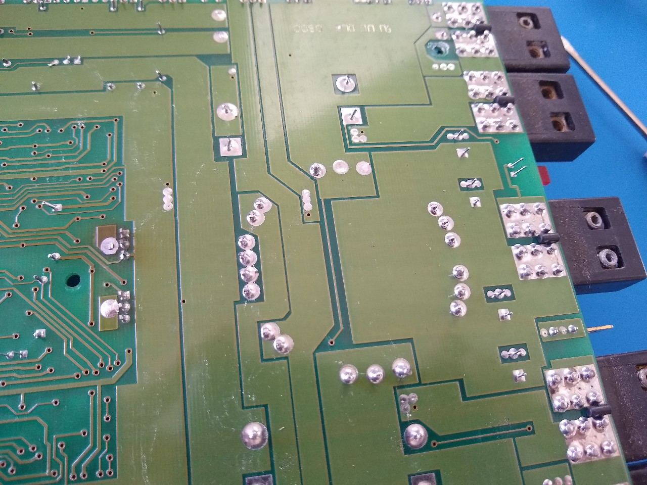

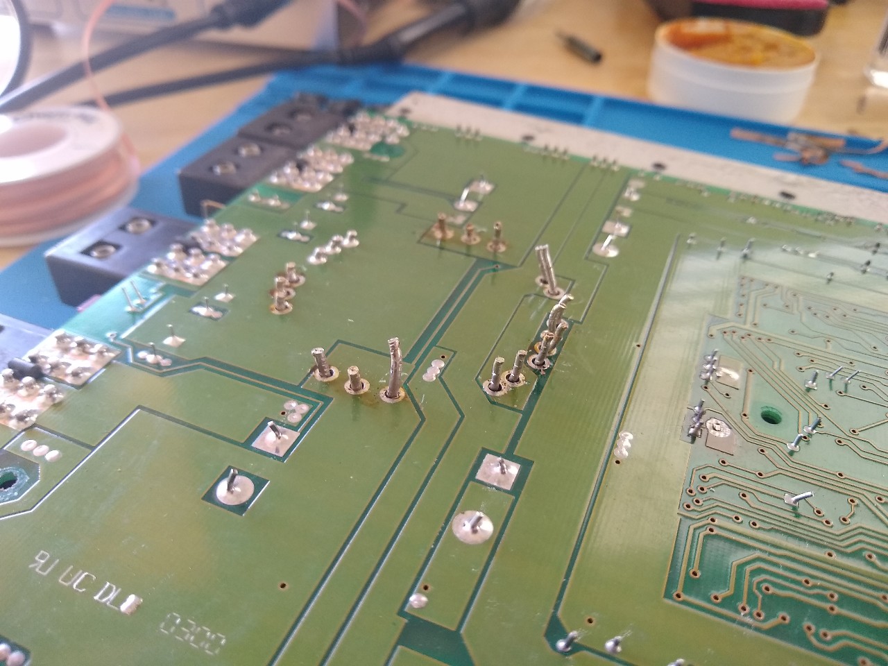

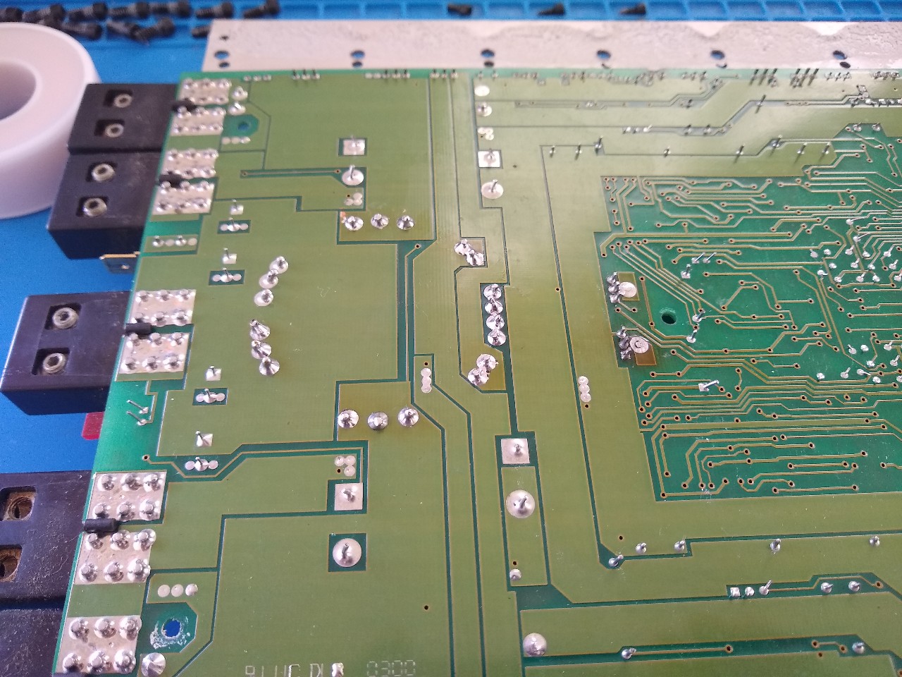

Pulled the board and reworked the transformer down to a reasonable position. Also noted the heat discoloration on the board from the U3 LM317.
Filter caps all read ~400ohm and then gain up beyond 2000+ on either my meter's 2000ohm setting or diode mode.

Level the cap with the heatshrink that's pulled up and put a drop of adhesive under the points that would touch the board if the cap was pushed to the side.
Never use hot glue. Use something like goop, e6000 or even silicone. All you need is a tiny dot on opposite sides.
