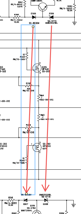

In the schematic it says D308 is a MMBZ5231
D307 it just says SS-803SM
Does the mean D307 is also a 5231?
I understand that the 4148 is the same as the 914 .
But the original diode that’s in this amp is a 5231 marked 8F so is the 4158 pretty much the same as that also ?
If not that’s why i’m asking what the SS number is on the schematic is for
