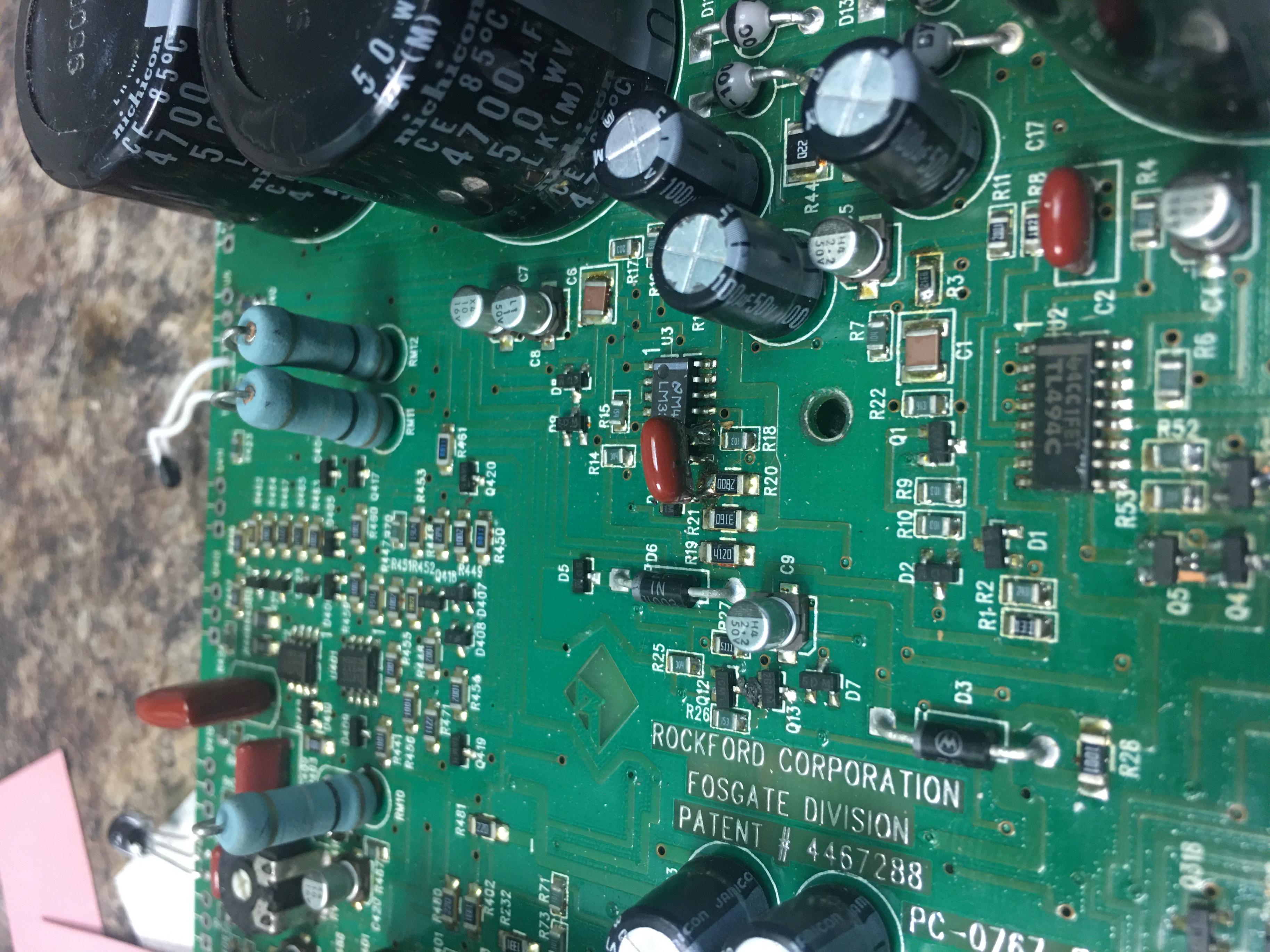

Does anyone have a schematic for this board number .
PC-0767-E
PC-0767-E

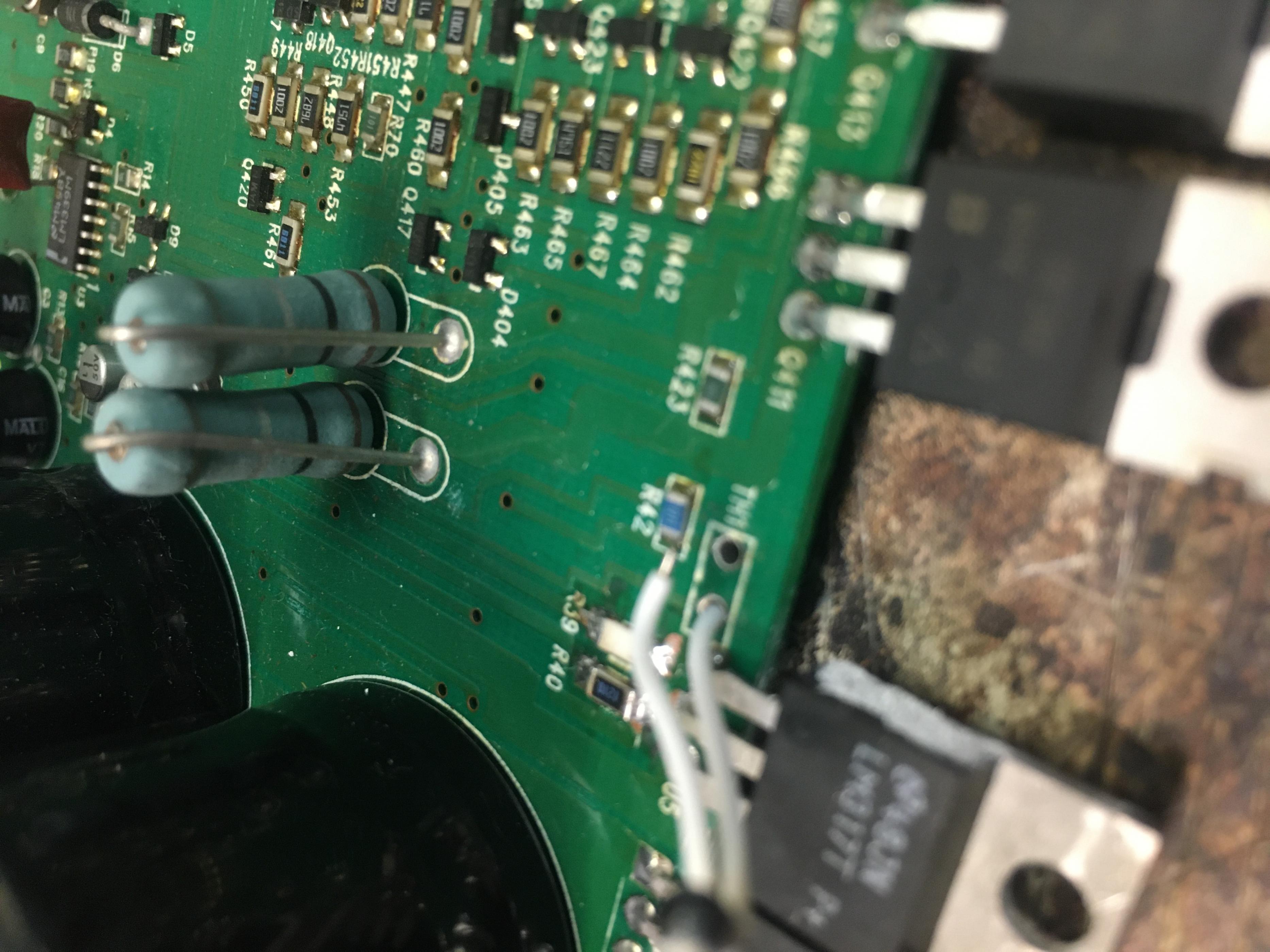

Do you have a pictures of the area around the 494?
R5,R3 according to the schematic are supposed to be 110k but in this amp someone put a different value something like a 90k resistor in those location wondering if it’s from the factory or someone else
This is a guess but it could be that the regulators were running too hot so they reduced the input voltage to 18v. Since the rail voltage is dependent on the 18/24v supply, they may have changed the resistor value to get the rail voltage back to where it should be. This assumes that you had the 12v supply voltage at the amp's terminals in the normal range (12-13.5v, give or take).

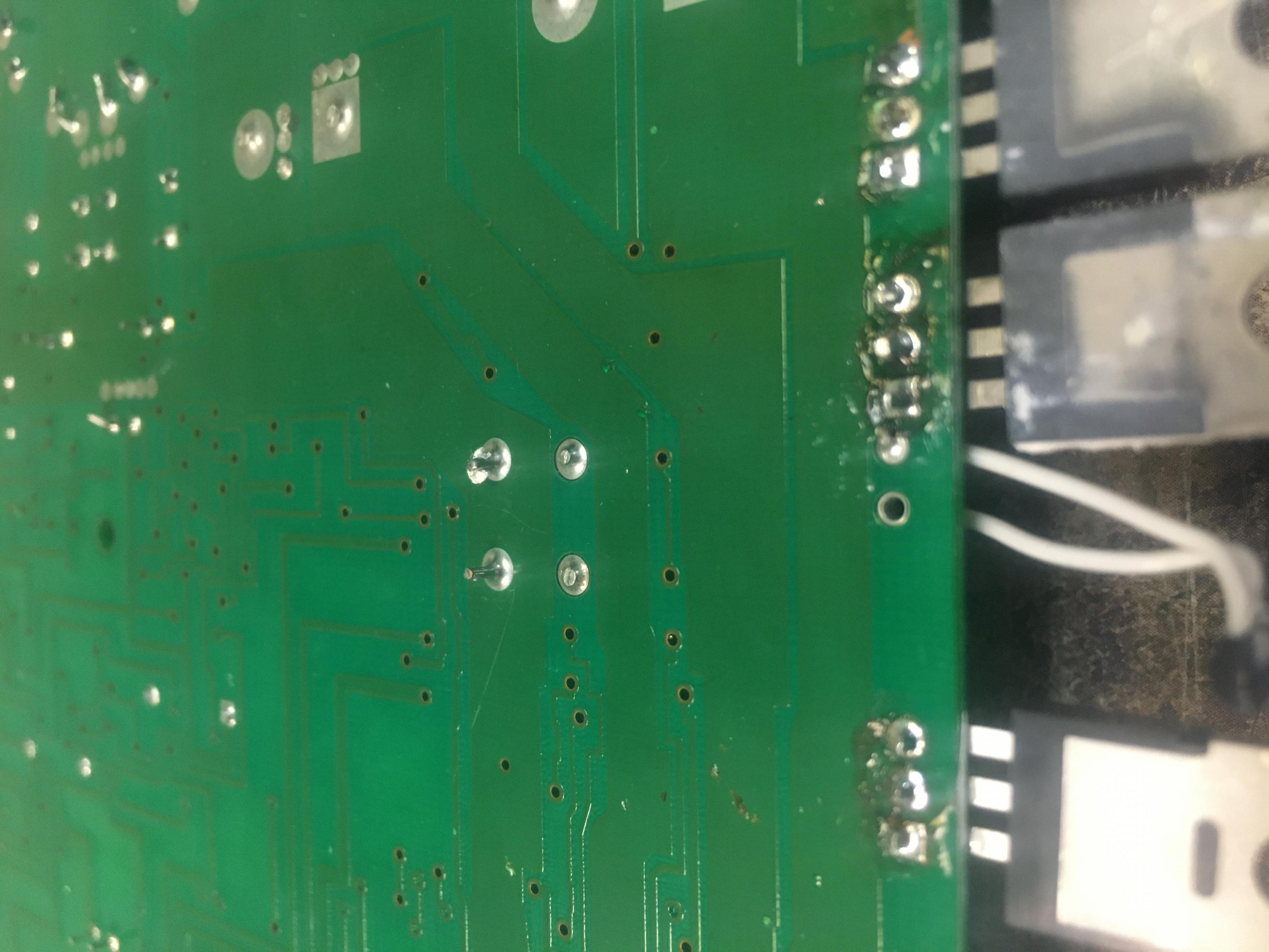

If only half of the power supply fets were working correcly like only 1 bank could that cause the distorted audio in 1 channel ?
I have intermittent connections on 1 bank of power supply fets
Possibly but not likely considering the amount of capacitance in the amp.
It should be an easy fix.
Well I’ve been chasing a problem with distorted audio thought the issue was in e channel or preamp section .
I fixed the connections on the power supply fets and the amp has clean audio out of both channels .
Thanks for your help and patience with me throughout this repair I greatly appreciate it
