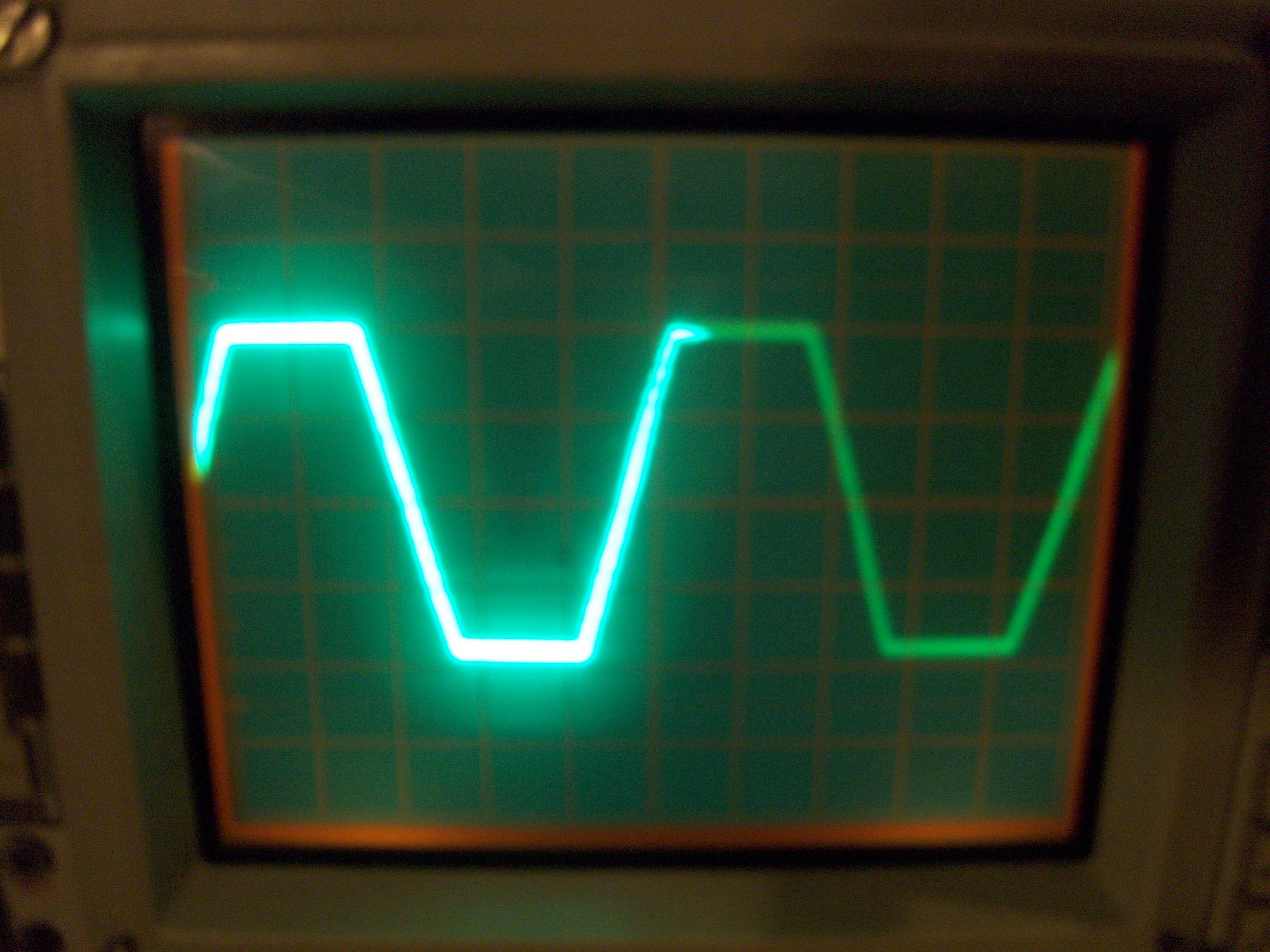

The drawers i keep my parts in the 2A bjt's and A7 diodes are right next to each other. Somehow some A7's got mixed in with my 2A's and a A7 was installed in location Q119 when it should have been a 2A.
I have sorted through them and corrected the problem, note to self check the parts you are putting in to confirm they are what the drawer says they are.
Other than than that nothing. Still dont know why the protection transistors would cause distortion upon re-installing them (Q130 and Q126)

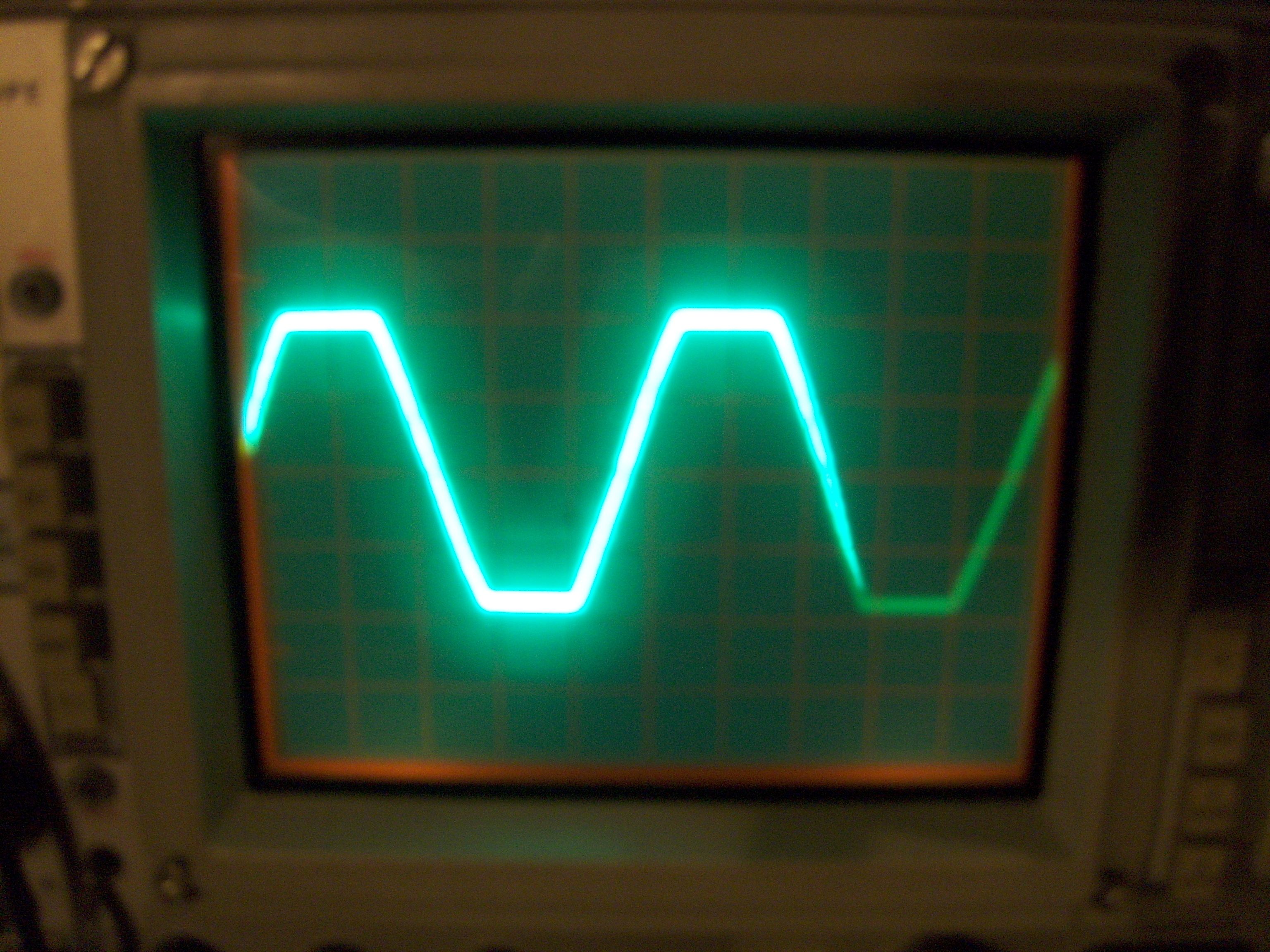

With Q130 installed the amp still produces clean audio, the first pic is before Q130 is installed and the second pic is after Q130 is installed. Looks the same to me but pic 2 I had a tad more volume so its a little more square.
Scope settings were 20 vol/div and 2ms. My probe is on 10x so I believe its 20 vol/div

We'll have to troubleshoot that part of the circuit. Removing these two transistors did the same thing as removing the diodes Dx04, etc) in the later amps. It disabled the protection circuit. This allowed us to see if the problem was in the protection circuit or in the audio circuit.
Reinstall Q126 and remove Q120. Does the amp still produce clean audio?

Yes it does with a nice signal on the scope as well. Q126 is back in and Q120 is out.
I don't think the 2A will withstand the voltage in this circuit (driver voltage plus -rail is about 100v). Are you 100% certain that it's not leaking?
If so, the problem could be further back in the circuit.
