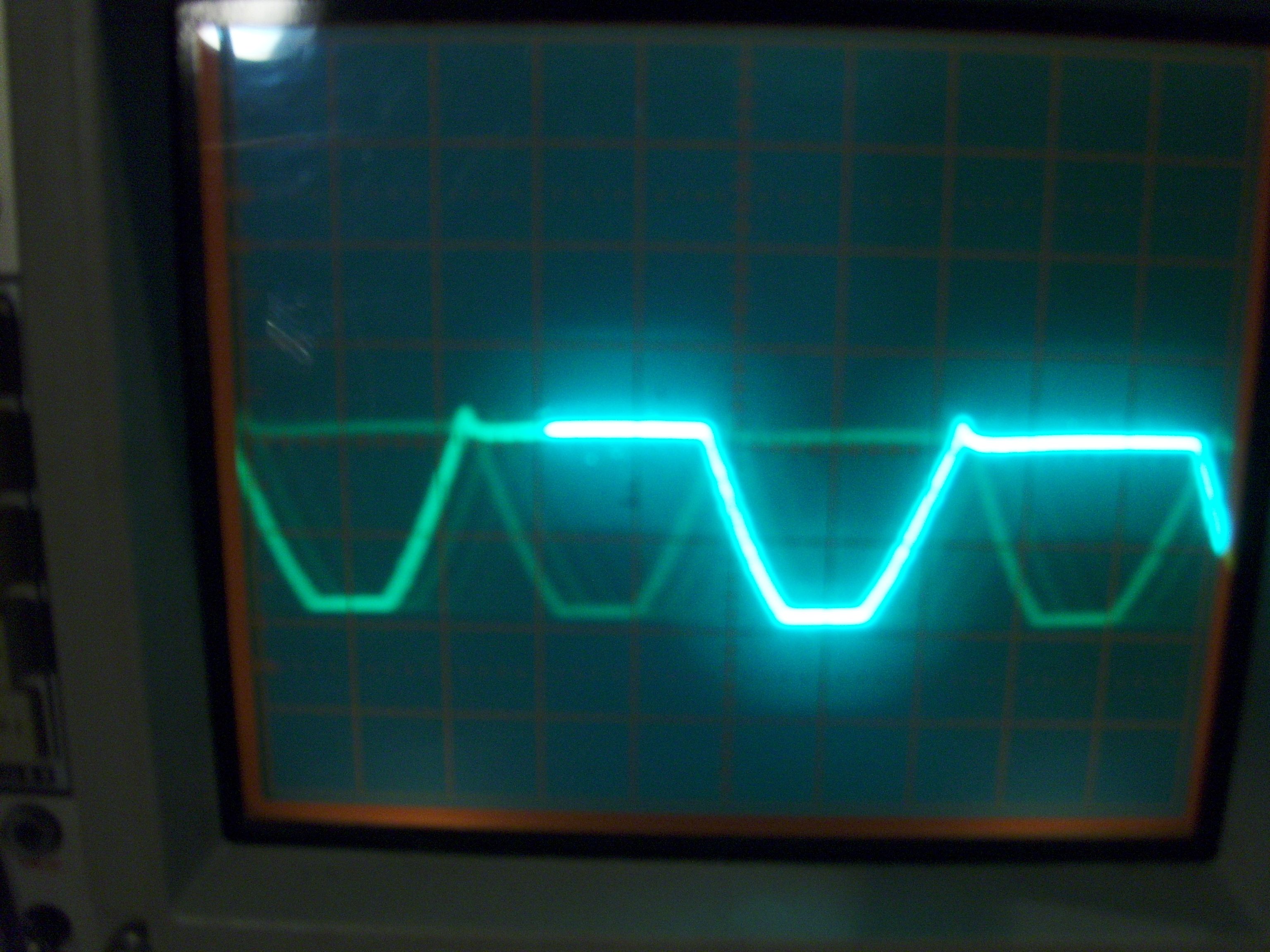

No the 100 series channel still does not work.
It no longer has DC on the bridging terminal at idle but the dc slowly increases with the volume.
It is still distorted badly, and when viewed on the scope the channel only deflects below the baseline and clips only below the baseline.
Another wierd thing is when the rca plugs are hooked up and the volume down the amp is quiet and idles fine. When you fire up the amp without the rca plugs hooked up the amp is very noisy inside hissing and squeeling, and makes tons of wierd noises through the speakers.
Lift Q126 and 130. What changes with those out of the circuit?

Lifted Q126 and Q130 nothing changes, still have DC increase with volume increase, Still same reading on scope only deflecting and clipping below baseline, and still very distorted.

With Q126 and Q130 removed the DC is gone totally and does not increase with volume. It also produces clean audio.
If I reinstall Q126 and Q130 the audio becomes very distorted.
