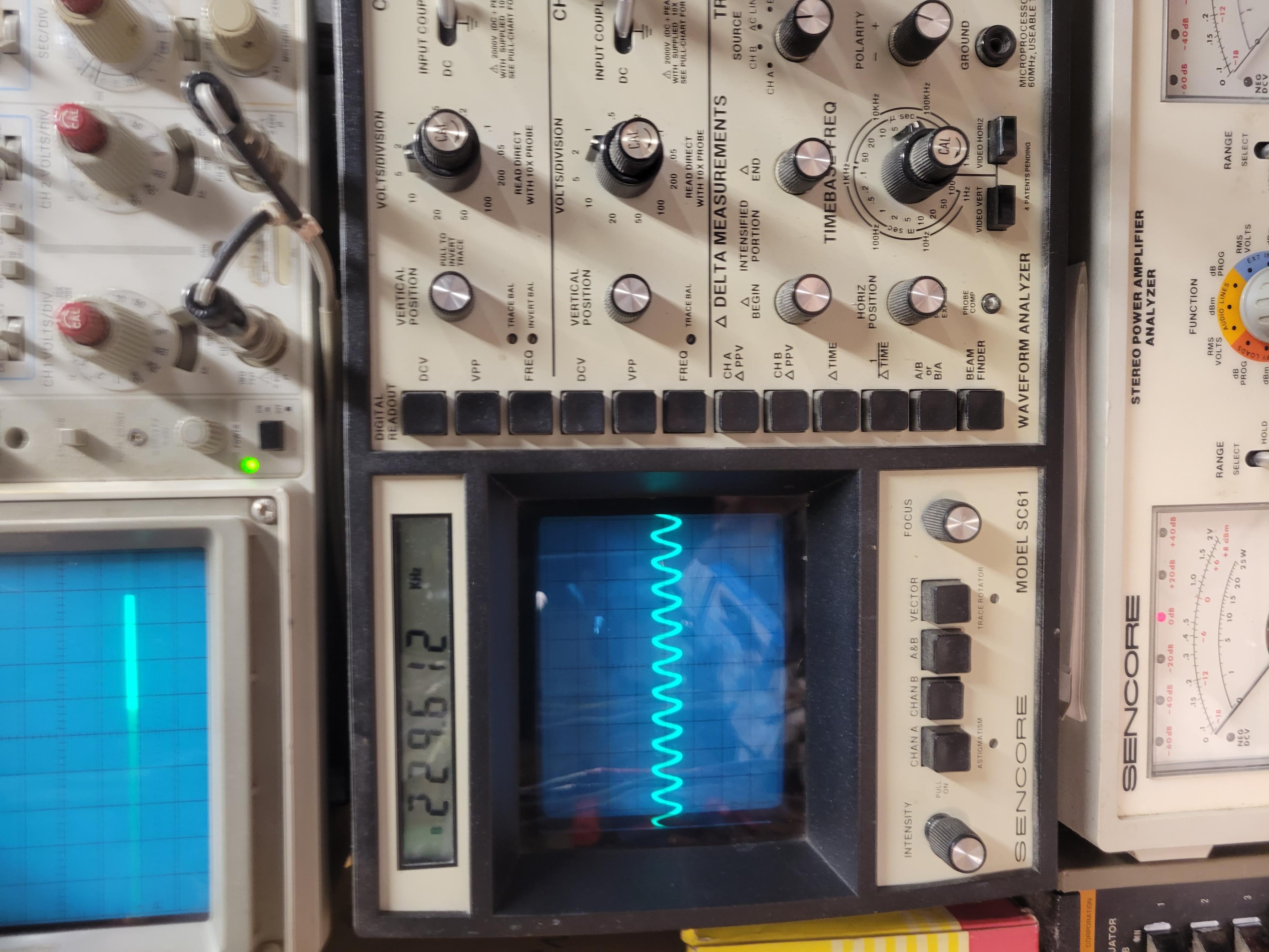

Hi, working on a RF Power T2500-1bd. Power supply is running. No shorts in the outputs. I have +142V rail. I don't have the minus rail voltage. I have 160 AC to both negative rail diodes CR2 and CR1005 but +24 v on the cathodes. I pulled all the outputs just to make sure they weren't a problem. Anyone familiar with this amp that can give me some ideas. Called Rockford. Schematic not available.

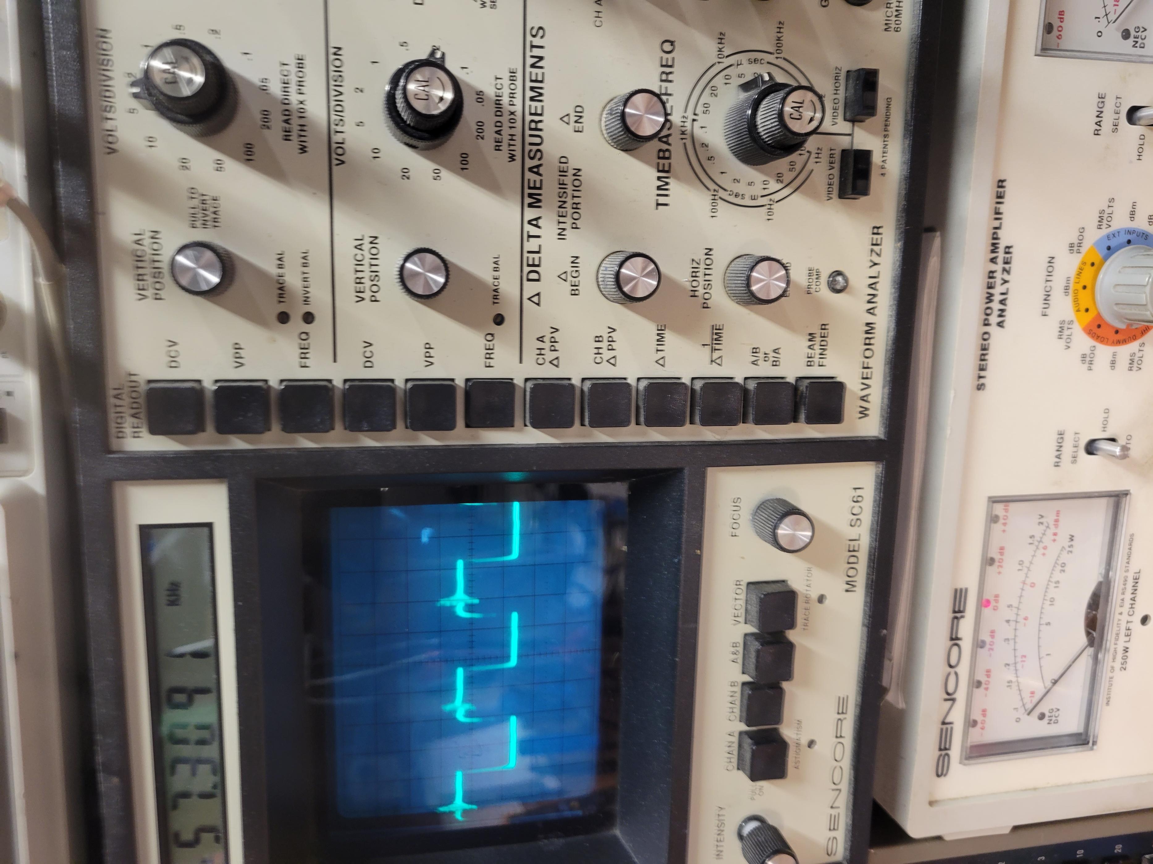

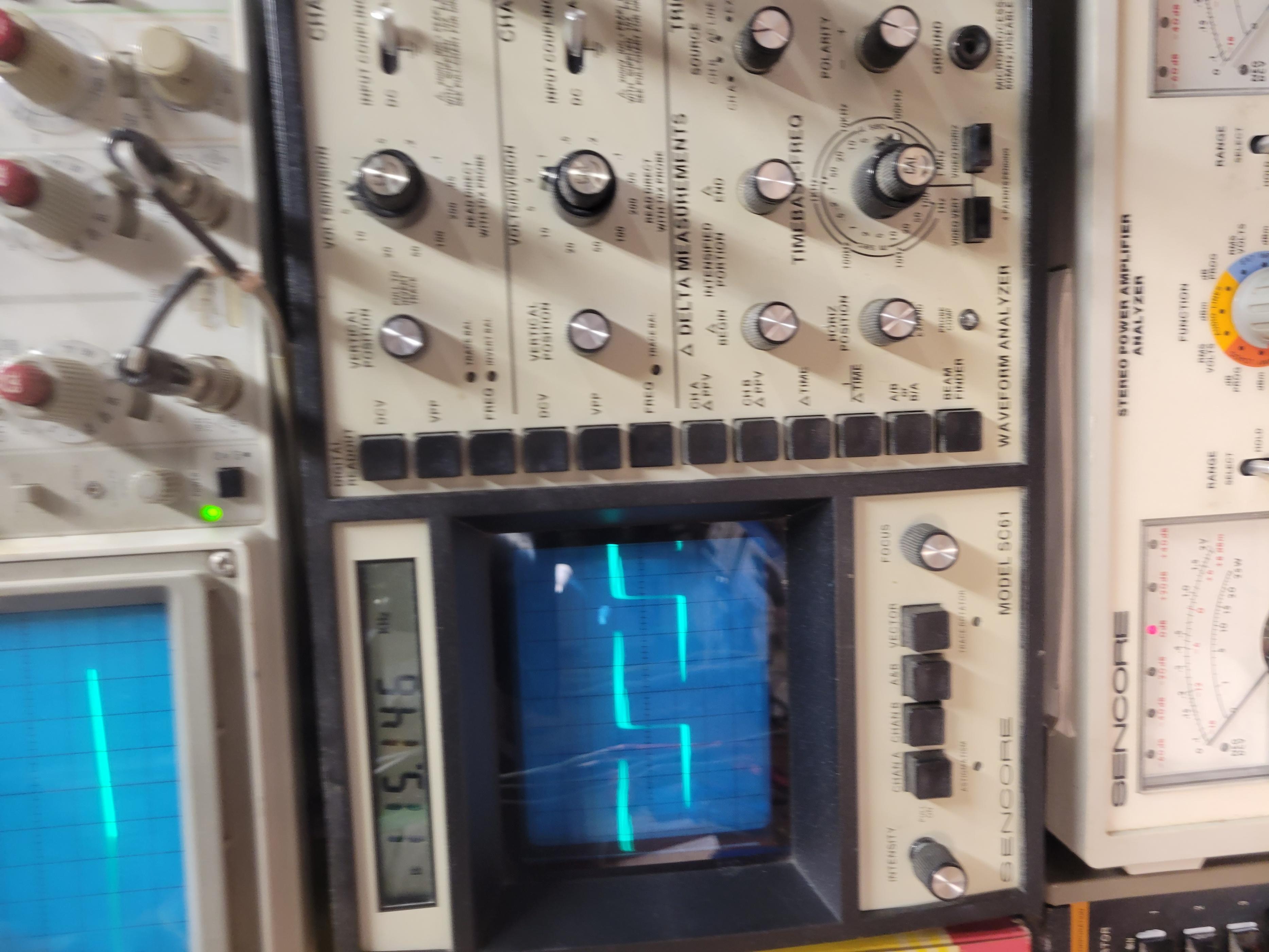

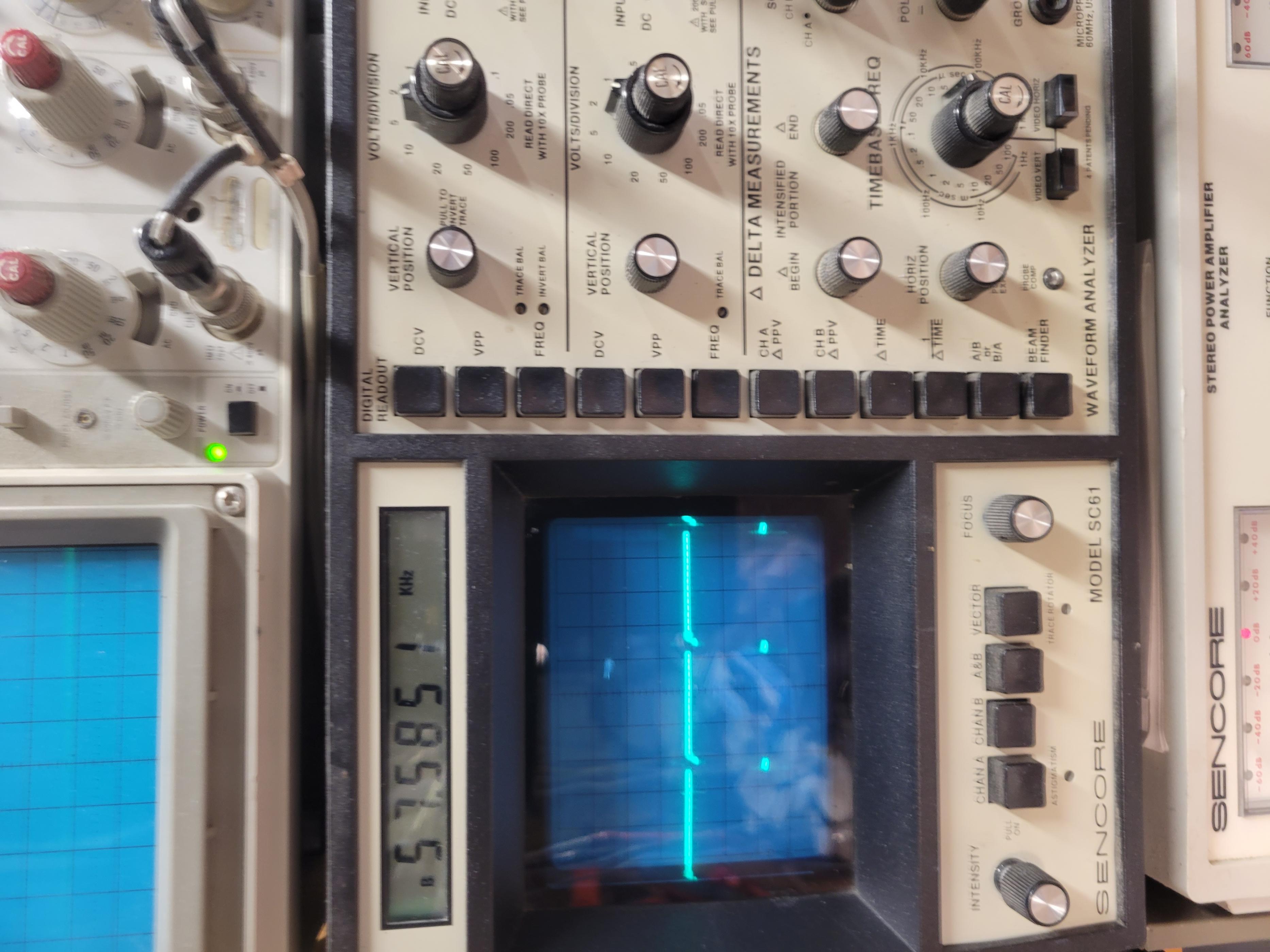

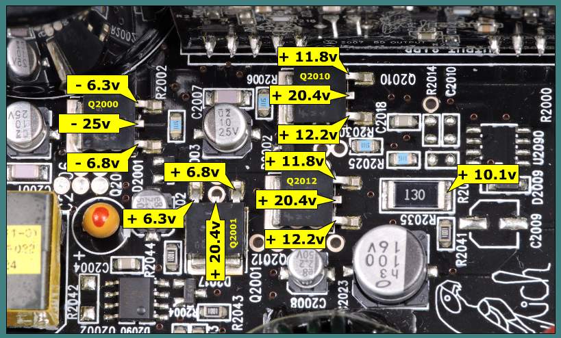

Anyone familiar enough with this amp to answer a question for me. I think the amp is muted. I have what looks to be input on pins 2 and 4 of U2000 and U2002 but no output on pins 5 and 7. I have 6.8 volts on pin 8 of both chips. I believe this to be bd mute. I'm using a schematic for a Power T5001bd. Can't find where bd mute originates. Can anyone help?
"On that diagram, U4-D is the mute output." Yes found it on the amp power supply driver board. U101
"Do you have all of the various supply voltages?" I have rail voltage. +/- 15 volts. The schematic shows regulators for various voltages. I don't see regulators on this board. So I don't know about the other voltages.

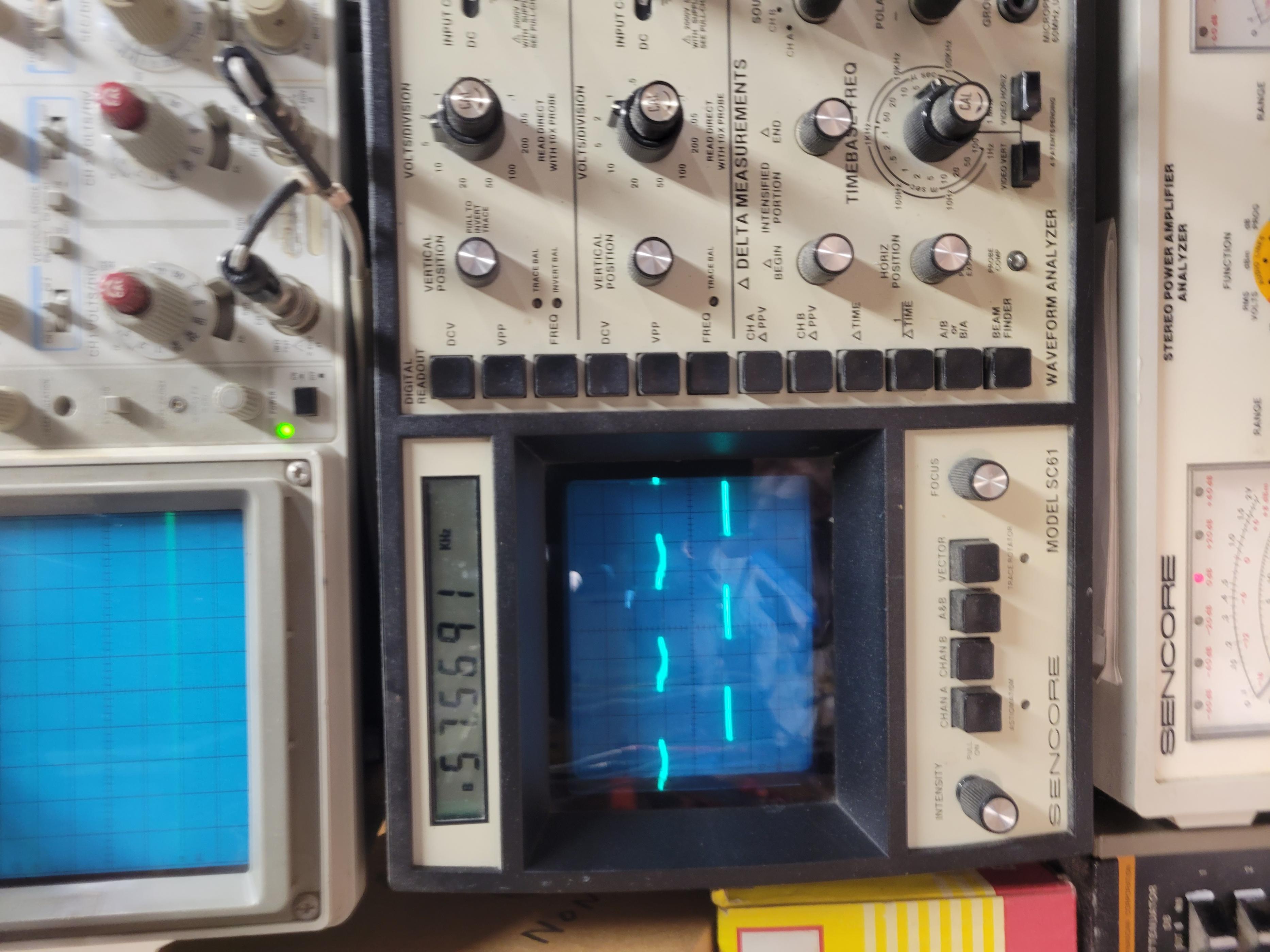

The pics are with no signal in.
Aren't the audio driver ICs U2000 and U2002. They drive the transformers. I have a nice square wave on pins 2 & 4 of U2000. But nothing on the outputs pin 5 & 7. I have a lessor not as nice square wave on the input pins 2 & 4. But nothing on the output pins 5 & 7. I have 6V on pin 8 muting the outputs. Sorry if this isn't what you were asking.
