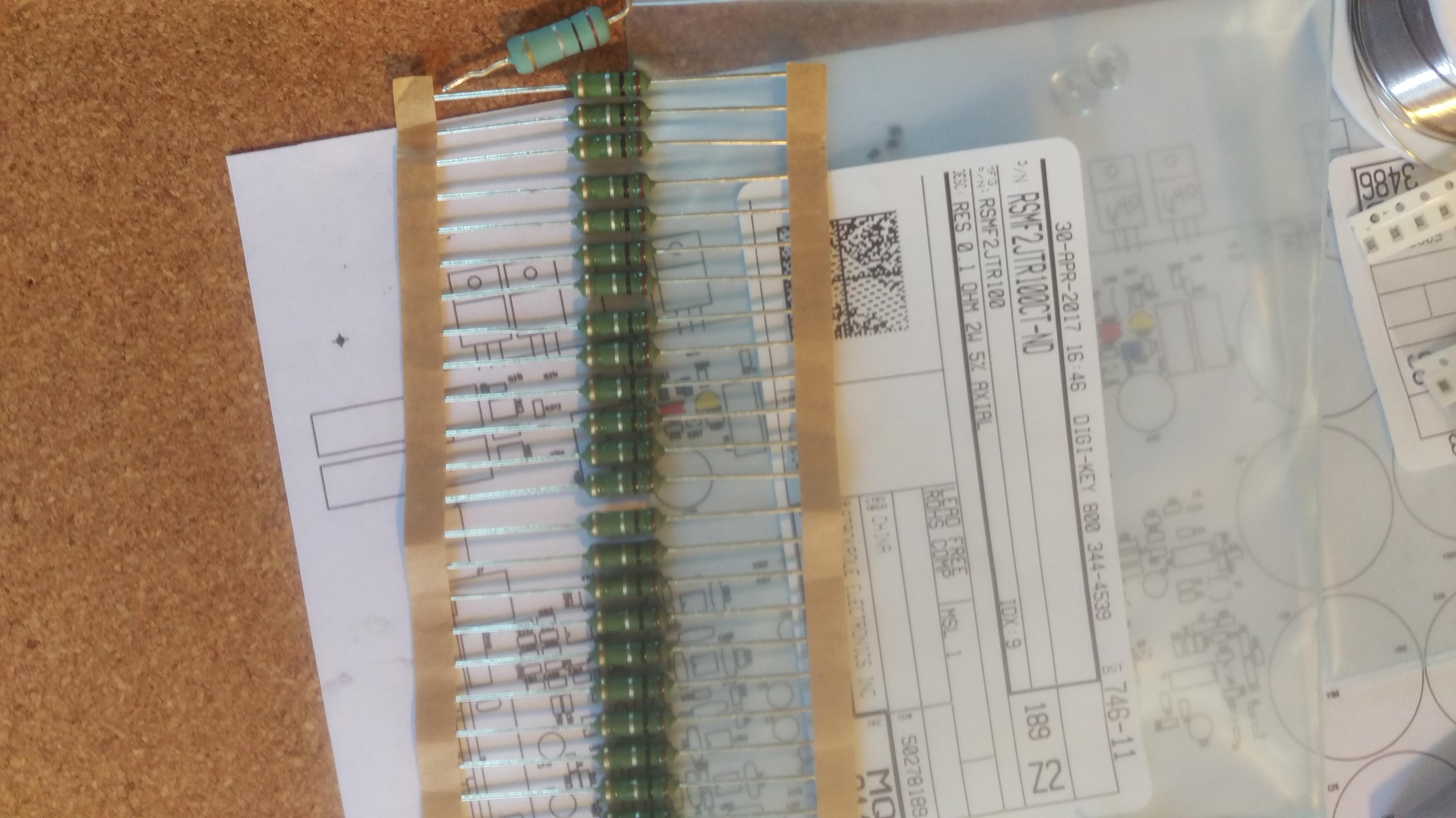

All the ones in blue need to be replaced 20ohm 0805 somehow I got 20k, just verifying I need a 200b 0805, somehow I got a 2002
Those will work but you don't need such expensive resistors. Something like the 311-20ARCT-ND would be fine. The expensive ones are OK when you order just a few but if you do repairs and have to order many hundreds of resistors for stock, the more expensive ones are difficult to justify the cost.
The size/power rating is partly dependent on the material they're made from. Larger resistors will run cooler but sometimes a smaller resistor is needed for the allotted space so higher temperature withstanding materials are used. The ones you have should be OK. In the future, match the size if you want them to look the same.
You don't need to order these. They are what I use but are expensive (especially when you need so many). LVR03R1000FB12 (mouser).

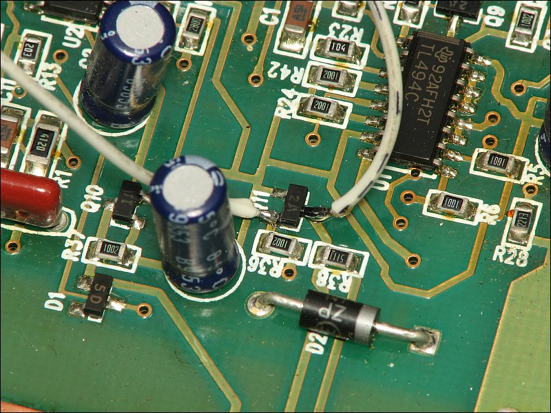

So i have most of the smd resistors tested and swapped, i am waiting on the 20 Ohm to finish, the transistors are all on the rail and sodered, Source resistors back on the board (They came out nice). the drivers are removed. So much better to remove the rail and use a flat skillet in the rail to preheat, it not the prettiest job but there are solid. heat gun and my iron to set them. Just waiting on the resistors they should be here tommorow. All in all not the best looking sodering job on the transistors. Once the resistors come ill replace everyone recommended on the scheme you sent me. Should i go ahead and replace those 8 ps transistors? And what i should i do first after perry, Resisted B+, Or some other test?

Jump the transistor Q11 as shown in the attached image.

Set both bias pots fully counter-clockwise before applying power.
I meant to tell you to do one channel at a time. I forgot to do that in a previous post. Start with the 200 series channel. To disable the 300 series channel, lift Q301.

Perry the board is kind of hard to read in that location,is it a 5d or a 1a, I beleive its the 1a
OK so I removed the q301 jumped the q11 and the computer PS I use for testing shuts right off, as it does this sometimes with large amplifiers, the protection. Should I attempt a silent PS like a car battery?
It actually shorted an output on one channel and also fried the vc, in my bench mid. So I'm not sure where to go from here. All the other seem OK. Not sure I'll wait for some advise.
Should check all the gate resistors again and replace the output and the drivers for the amp again, install the jumper wire and remove the diode to isolate the channels and test for audio,-? It shorted the output and , blew the speaker. That's very disappointing.
You can't connect a load or speaker until you're sure that the channel appears to be working correctly (check for DC with a meter or look at the output with a scope). If it was a small speaker, you should have had a capacitor inline.
Jumping Q11 allows you to use a current limiter and that should allow you to see if it's drawing excessive current before any outputs fail.

OK thanks Perry what resistor should I use to limit the b+ current. The gate resistor is out, it was the output closest to the speaker output. Once I jump the diode and remove the other channel test each output for dc voltage on the output transistors?
Test for DC across the two speaker terminals for the channel.
I'd recommend a 2 ohm, cylindrical wirewound resistor rated for 100w.
