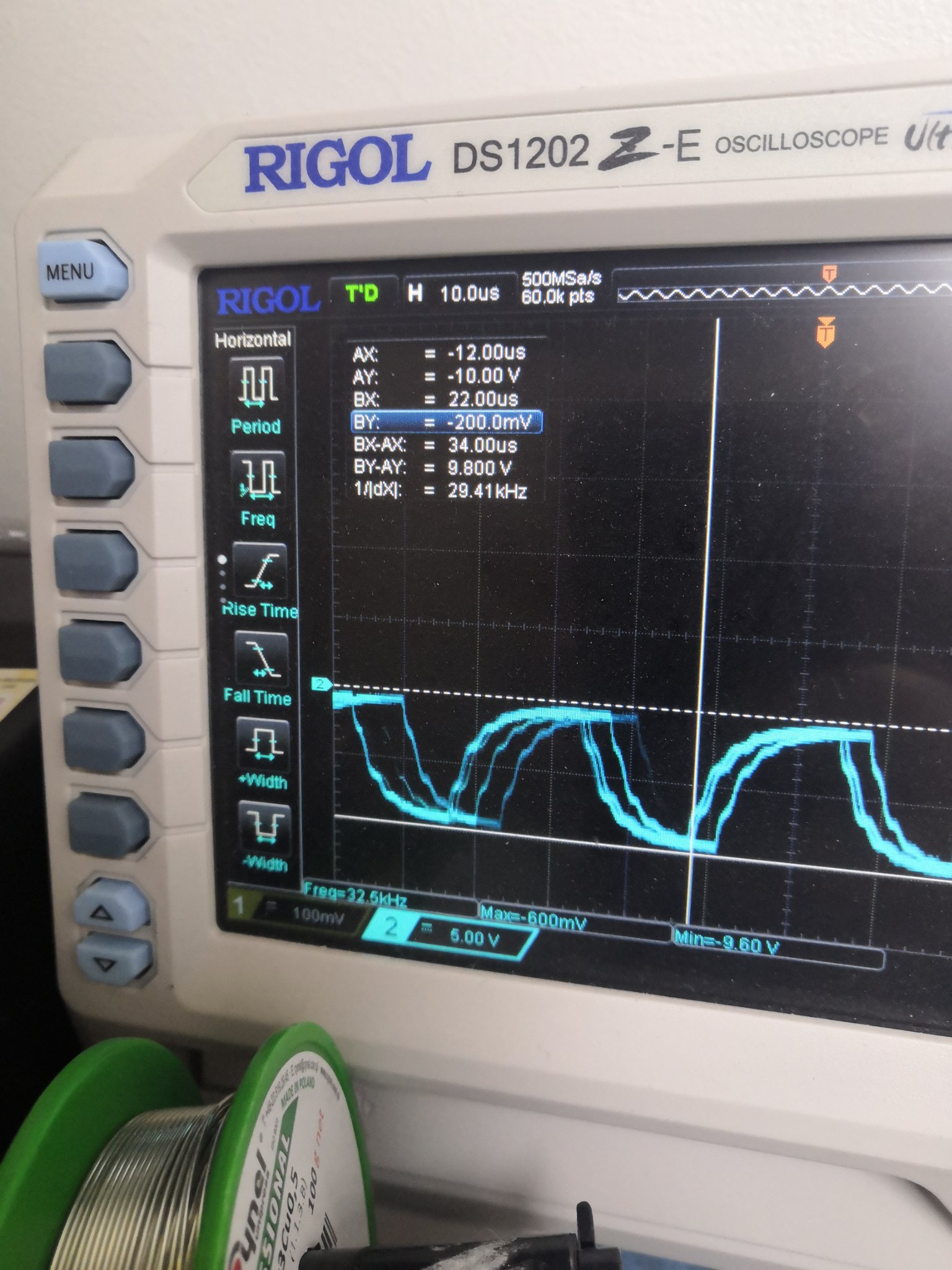

The capacitor is important with the scope, or not.
Do you have any other heat sources? (NOT a propane torch)

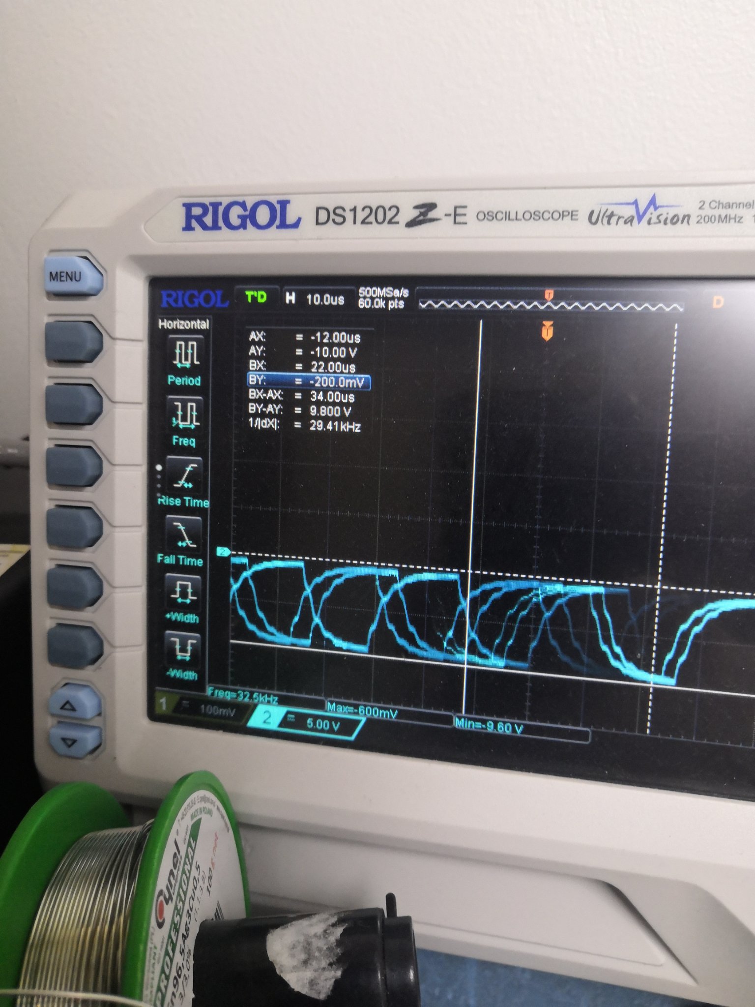

Looks like 10V
i was worried about that shape. my friend had larger iron and his helping hand with hot air mehsa board also clean now. pad 4 had 1.6V today
The shape is due to the capacitor. What's important is that is goes near 0v. The drive circuit often fails and won't pull the capacitor back to near 0v. Without the capacitor, it may not be obvious. For Rockford amps of this design, you can also check with the FETs as a load but you don't connect B+ (only remote and ground used). The capacitor without the FETs is universal so you should learn to use it if you plan on doing more repairs.
