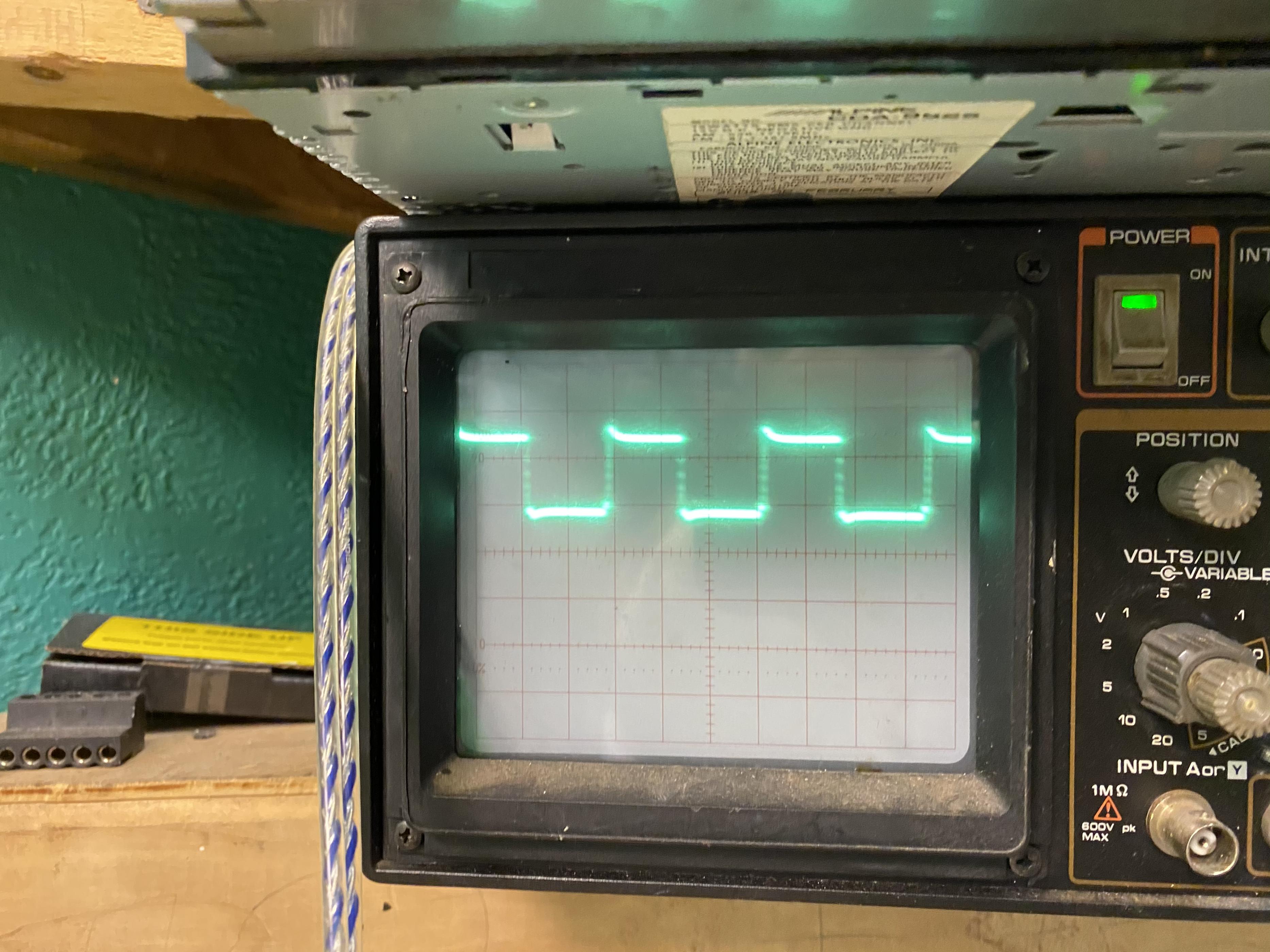

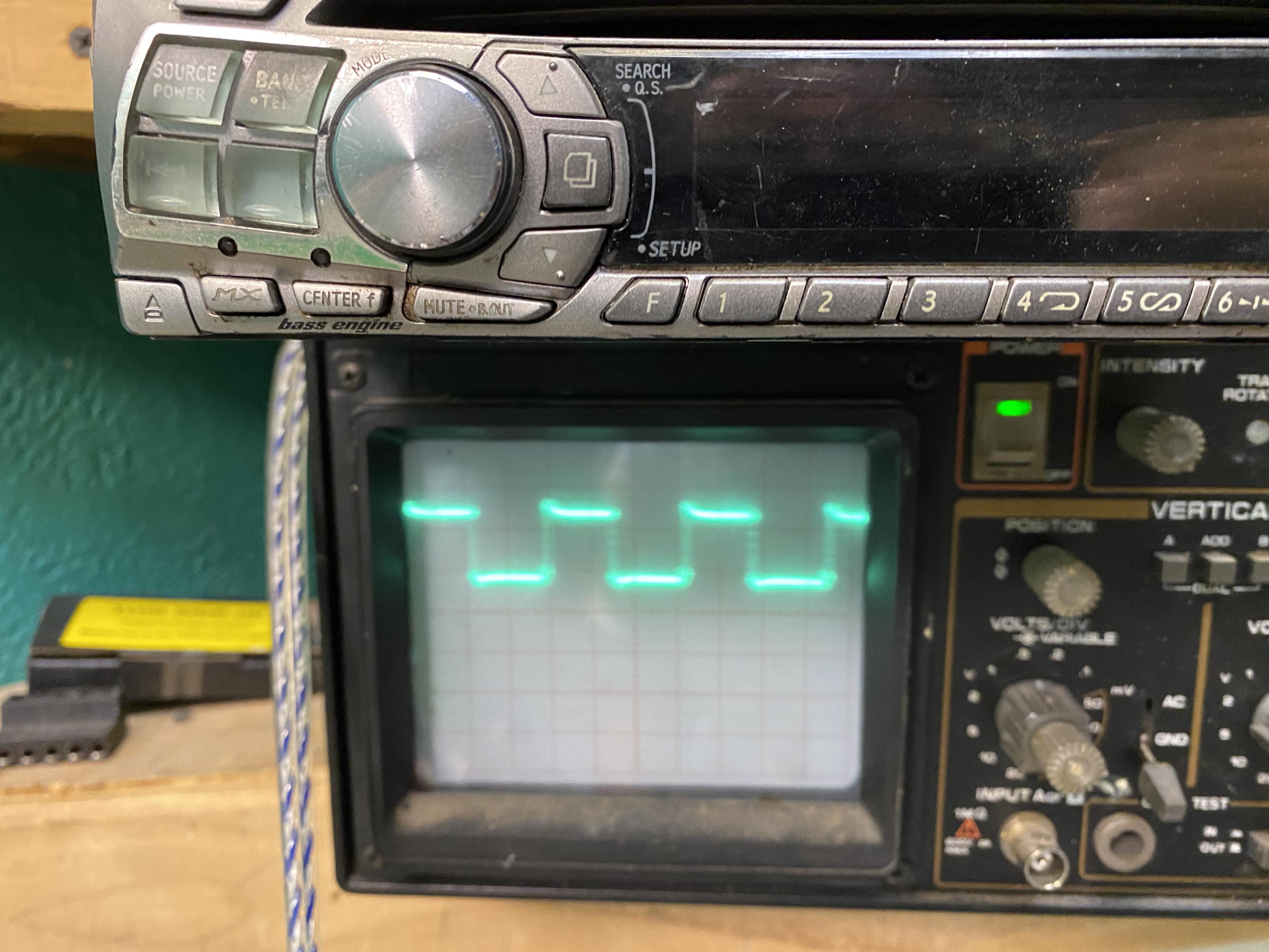

It connects to terminals 6 and 7. Do you read 0 ohms to those terminals?
Do you have a schematic for this amp ?
PC-3125-F
Or do you know what board locations are the pnp drovers for the power supply ?
Since they do not go to ground either so somewhere I have a break in the ground and wanna track down the issue .
The collector of the pnp drivers should connect to amps ground terminal but they aren’t
