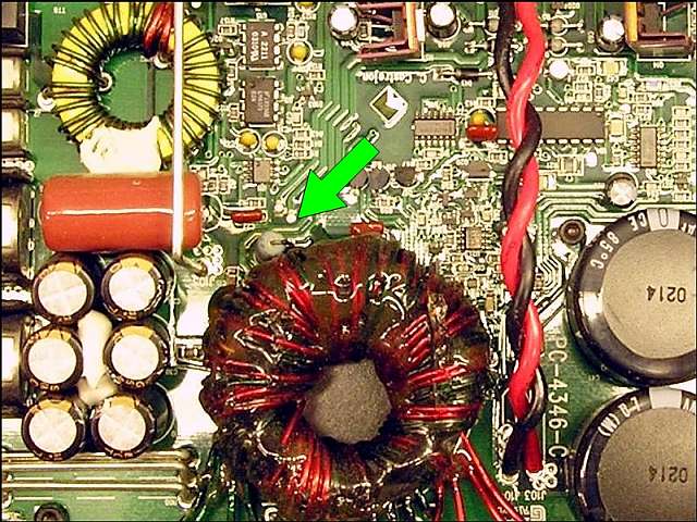

The resistor is likely part of a snubber. They often run hot but if it's far too hot to touch, the capacitor connected in series with it may be shorted.
hi i did the tests in the previous post like u said testing all op amps they all check fine the cap u said is a 822j wondering what is the value of that cap or can i put a different rating in please let me know thanks
The value is 82 and 2 zeros in pico farads. The J is the tolerance (j = ±5%). If it has no voltage rating, it's generally a 50v cap.
8200 picofarads = 8.2nF or 0.0082uF.
If it's not shorted, it doesn't need to be replaced.
A friend brought me a 1001bd to check out. I checked the temperature of the resistor on this one. It ran very hot but neither the board nor the resistor showed signs of heat related damage so this is probably normal.
u said the resistor runs very hot and its probably normal wondering would it still run hot with no outputs 6215 and 3415's installed and no signal hooked up just power ground remote and the resistor gets very hot with in like 5 to 10 secs i checked the cap wasent shorted then i traced the signal to the stpr15's they checked fine after that not sure what to check if anything
yes thats the one im talking about ill put the outputs back in it today and see what it does hopefully its fixed i found that that cap next to the bank of black caps the redish color one had a broken lead on it so i replaced it hopefully thats why i was getting flutter through the speaker

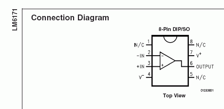

i put the outputs back in and powerd up the amp stupid thing does the same thing speaker flutter lm3337 and 317's get real hot after about 2 or 3 mins of the amp playing im gonna check the op amps again to make sure none are bad but does anyoe know what pin i put the black lead on the tlo72c to get the right readigs and also the lm6171 's also any help would greatly be appericated i tryed looking up datasheets but my comp just locks up when i try to look up the pin order
all of the 337 and 317's get real hot theres 3 of each in the amp and all of them get real hot within 3 mins with no signal hooked up just power ground and remote ad when i try to test one of the surface mount tlo72's the torrriod hiss's at me wondering where i go from here i touched black lead on pin 4 of the tlo72 the surface mount ones to get readings hopefully did that right because pin 1 doesnt give me annnd reading wondering where i might try to find the problem next what to test

Go back to this post and test the op-amps listed.
Try to keep your leads away from the toroids (power supply and output) when testing. If the leads are draped over either, there may be enough induced voltage that it could cause problems.
If that doesn't help, use the chassis ground as a reference and calculate the difference between the two inputs to the op-amp. Touch the black lead to ground before touching the red lead to the op-amp input.
