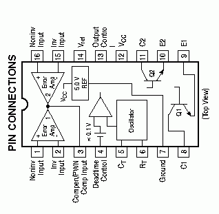

Ok I dont know if it matters it says TL494C.
Pin1=0.648

Are you sure that you have the pin numbering right?
Did you have the black probe on the main ground?
Ok so looking at your diagram. I flipped the top row. Sorry about that.

I think I found the voltage problem. When I connect the remote turn on lead the voltage gets dropped down to 8.06vdc coming into the amp. Once I remove the remote turn on it goes back to 12.5
The low voltage could be forcing it into low voltage shutdown.
How much current is it drawing from the 12v supply when the remote is applied?
If there are no shorted output transistors (check every one), set the bias fully counter-clockwise for both channels. Does the current draw drop?
Does the amp power up normally?
