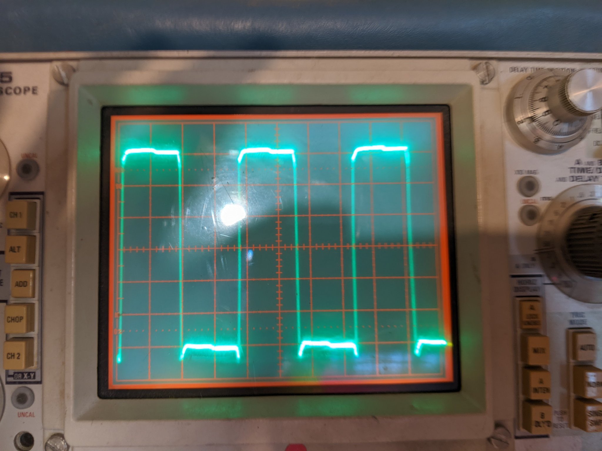

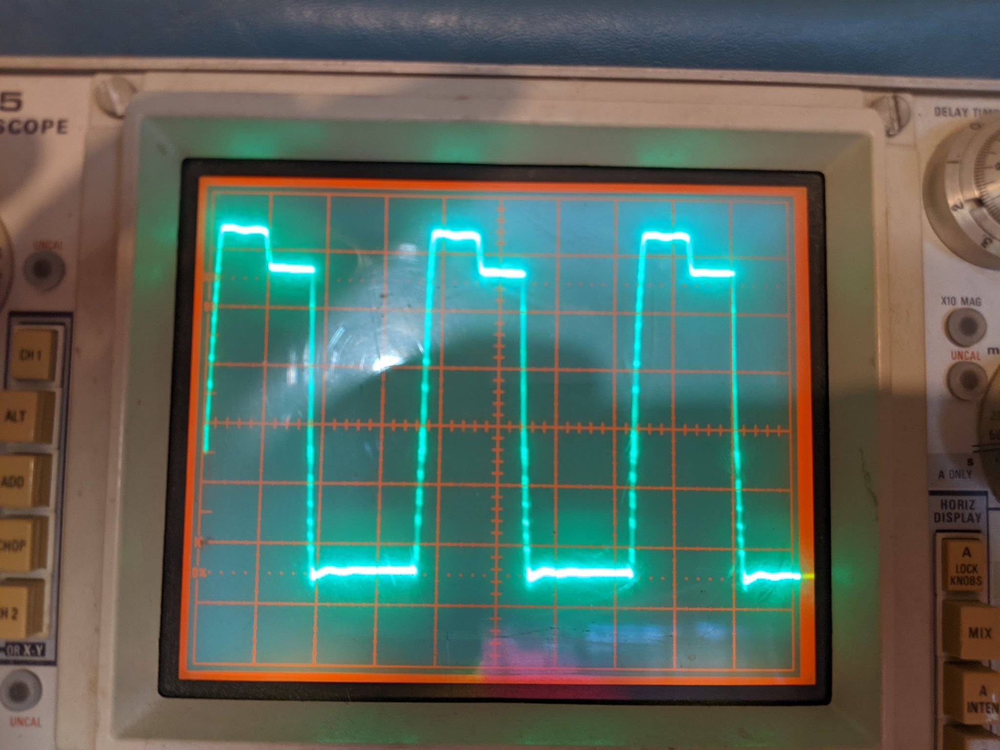

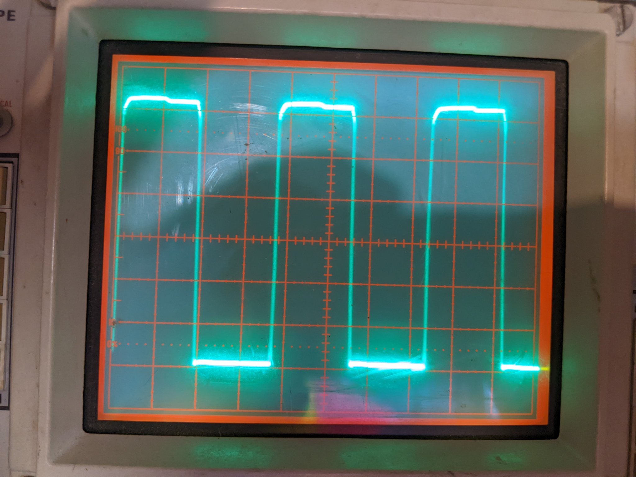

Sorry it's taken so long, been very busy.
Was getting ready to do the differential test for ya, but before I got through hooking up both scope probes I think I see the problem. Question, shouldn't the signal on the source pins on both sides be the same amplitude, just out of phase by 180. The reason I stopped short of doing the whole differetntial test is on one side the source signal is a slightly distorted square wave and 12 volts peak to peak. on the other side I got 120 volt pretty nice square wave.
For the differential test 120 volt pp. All sweeps are 2 us per division.
Now I put the words good and bad in the file descriptions for reference only. Not making an assertion.
Al

Anyway, back to my previous post, remember me pointing out that the source on one side was 12 volt pp, and the other was 120 volts pp, isn't that an indicator of a problem? I'm guessing both should be either 12 or 120 volt. I think you commented earlier that the sources should be 12 volts pp. The fact that the source was 120 volt pp on one side suggests I got a shorted mosfet maybe. Do you agree?
The job of the output FETs is to switch between the power supply rails. The drive for the FETs is driven to the gate but is referenced to the source.
The high-side source is swinging between the rails. This means that the gate drive has to float with the source. If you look at the gate with the ground as a reference (not differential), you see the gate drive added to the floating source waveform and that makes it difficult to know if the gate drive is what it should be.
The differential mode readings are also better for the low side because you can get better resolution.
Using DC coupling with differential measurements lets you confirm that the gate drive is fully going back to the source (to turn the FET fully off).
