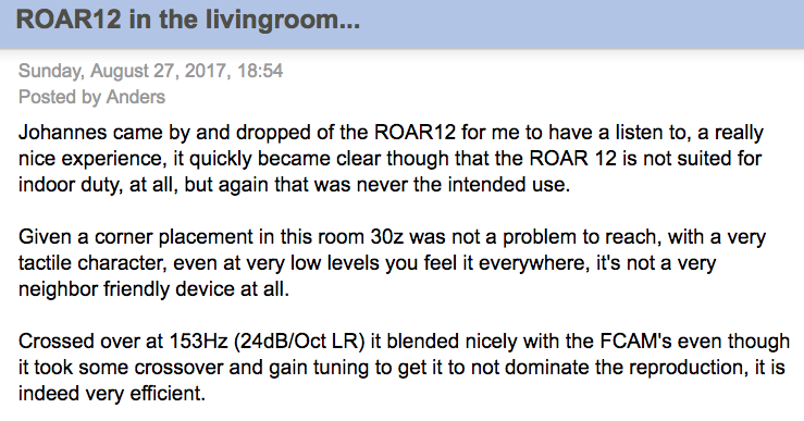

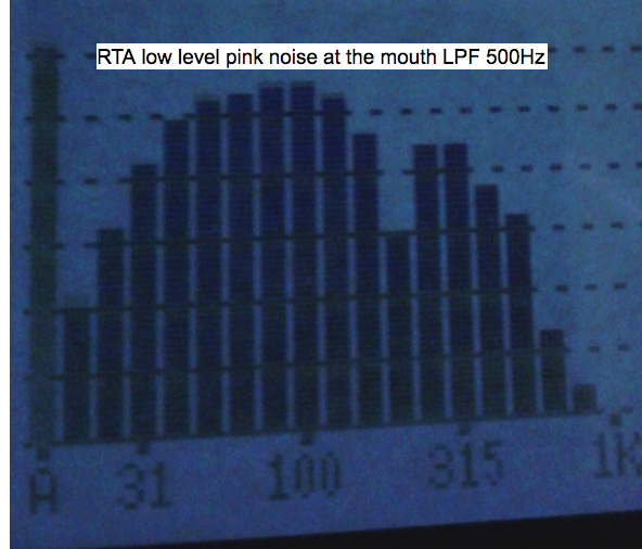

Wow, he ran his Roar15 with a 500hz low pass filter. I told y'all folks have been running TH's without low pass filters and they were still sounding good to the designers.
https://www.martinsson.cc/blog/index.php?m=12&y=19&d=01&entry=entry191201-183913

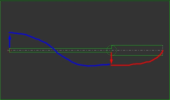

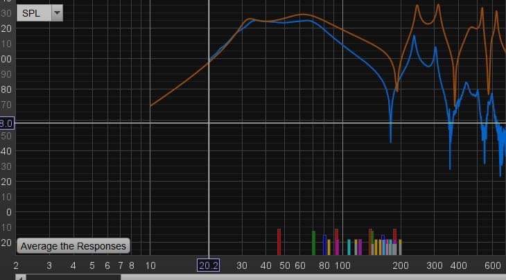

How? There’s a gigantic cancelation notch centered on the frequency that fits between the front and rear of the driver (~50cm(172.8hz)), which is 4x the 1/4 wavelength of the path of the upstream TL section (iOw, 360 degrees of ‘pressure phase’). You can’t ’fix’ that or amplify it out of existence ?
Wow, he used a LP filter for a low level test.
Nothing in Martinsson's blog that says he runs the Roars without low pass filters or they sound good above the null frequencies.

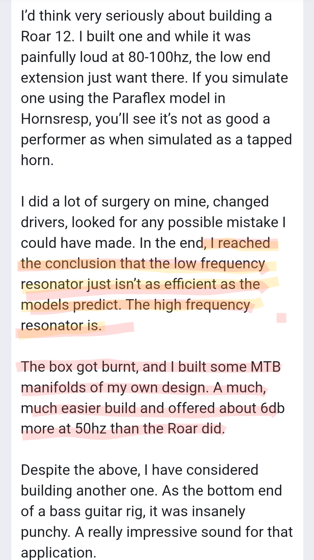

The low frequency resonator is a long skinny (overdamped) pipe . While the second resonator is ferocious. If you don’t have a very potent motorforce to drive/excite the upstream sections high compression TL the Fb suffers greatly and your left with the Big Bang of the higher tuned section ?
It’s very intersting/exciting regardless

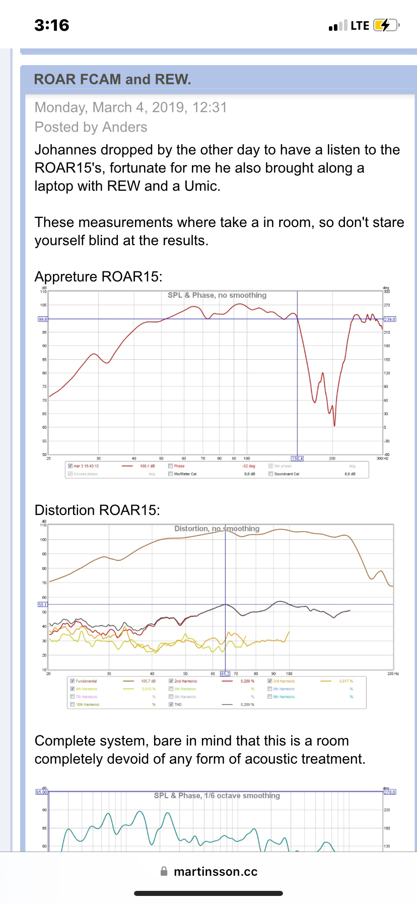

I don't know. The measured response graph I've seen of the type c 2 * 15 looked very flat and with no peak around 90hz which the roars have. I guess I'll find out with a prototype. Even if the overall output is not much different but the lower end extends further and with a few db more output < 50hz region (which is kind of what I expect / hope will happen), I'll go with them.
Running a 500hz low pass filter on a bandpass SUBwoofer is about as equivalent as running no low pass filter as you can get.
I never said how long they ran their TH's without a low pass filter. I said they said their designs sounded good to them when they did it.

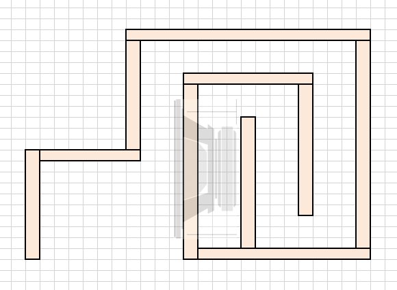

That tap location is not possible unless you are going to actually build the absurd enclosure below.

So you wanna hear 240 hz and 300 something periodically ringing when a female vocal stirs it up? How is it you don’t hear the ~90hz resonace in your box with the XO set at 80 hz? To me that’s either impossible, or your room is full of crazy sounds that make it all just funky and unidentifiable?
That's not a random pic. That's a basic double fold version of YOUR model. You cannot place your DRIVER's tap point where there is an abrupt transition in CSA. What YOU need to do is either model more segments or move your tap point.
That's where we could benefit in having a 5th segment in HR.
