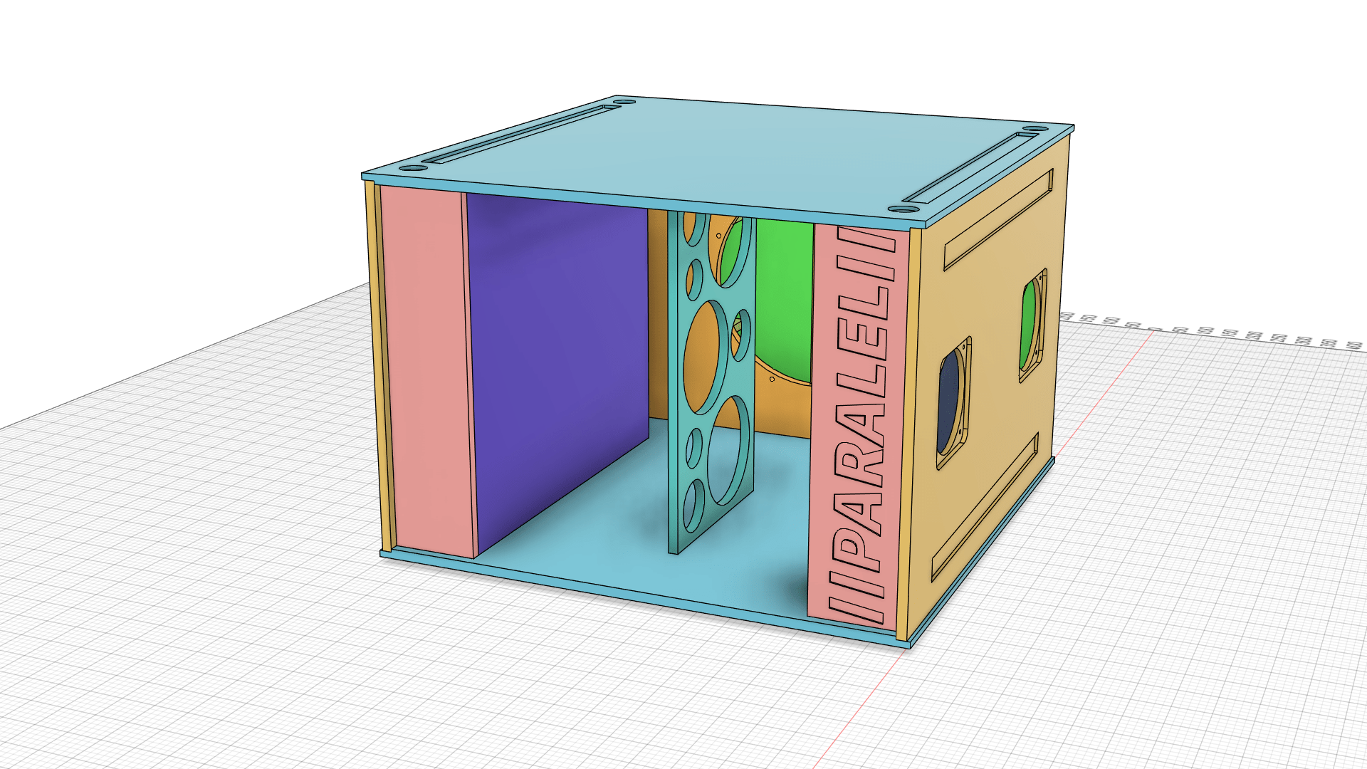

Finally, I found time to remodel them in 15mm with bracing (partly in 12mm) and make them CNC-able. Feel free to use the attached files as a starting ground for CNCing your own version. Already arranged and optimized as a flatpack.
Warning: These files include pockets and overlapping joints and are only meant for CNCing. When using standard tools, you would have to recalculate parts dimensions to build a 15mm version!
I modeled them to be used with

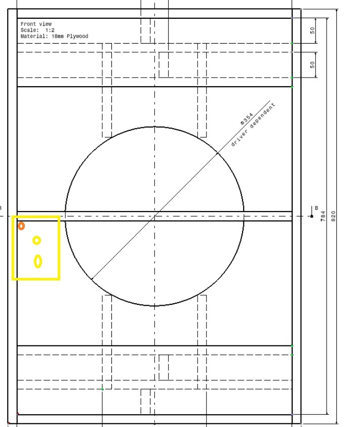

Where did you route your speaker cables? Did you follow the pipe using long cables or drill through
the driver baffle? If you did, how did you seal it?
I drilled through the driver baffle, right next to the driver separating bar at the bottom, which is where the connector plate was also installed. I used round cable the same size as the drill bit so it was tight pushing it through, then it was sealed completely in with the acrylic paint.
See crudely drawn image below. small orange circle is where Ive drilled through the baffle. Yellow outline is where the connector panel is located.

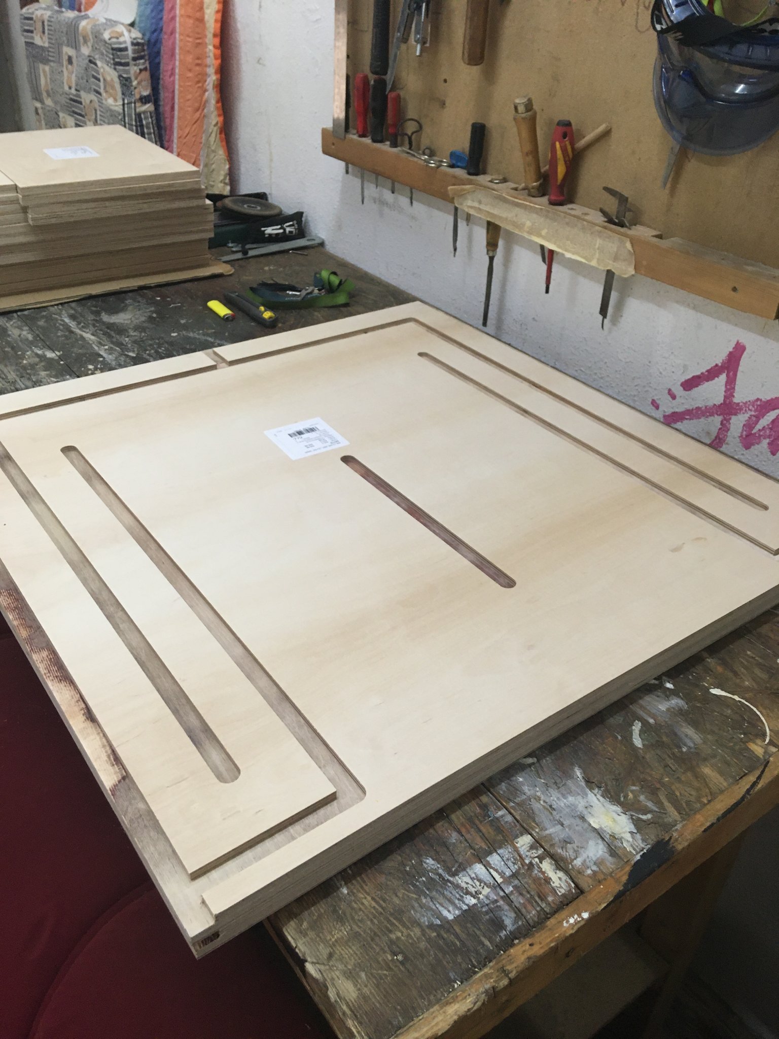

Here I have a CNC version for the side panels of the speakers.
The grooves are 18.5mm wide and 8mm deep. Don't forget to adjust all the 544mm parts to 560mm
in the cutlist to make up for the difference!
Check dimensions before using, plz. I did all the adjustment in measurement out of my head.

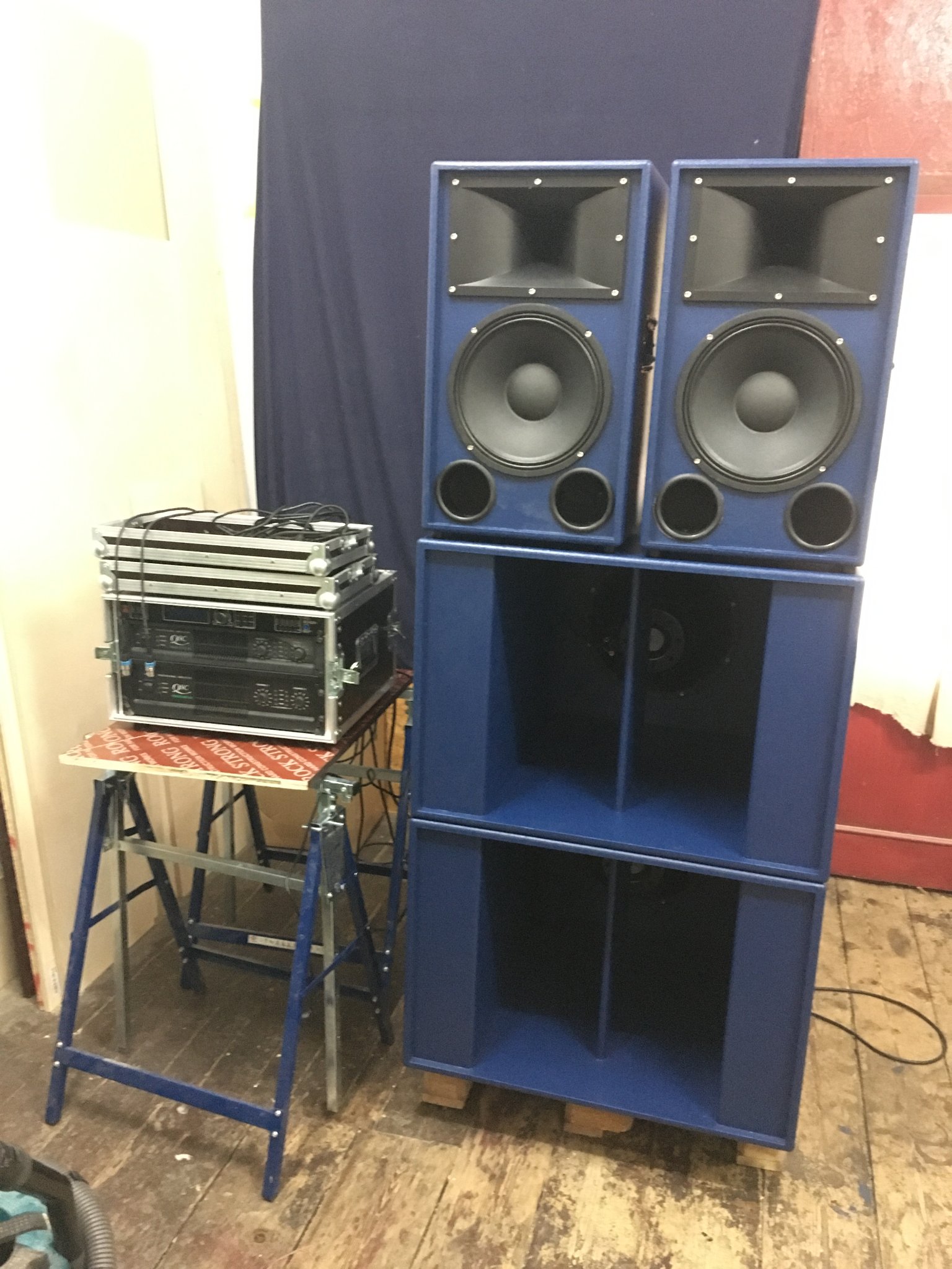

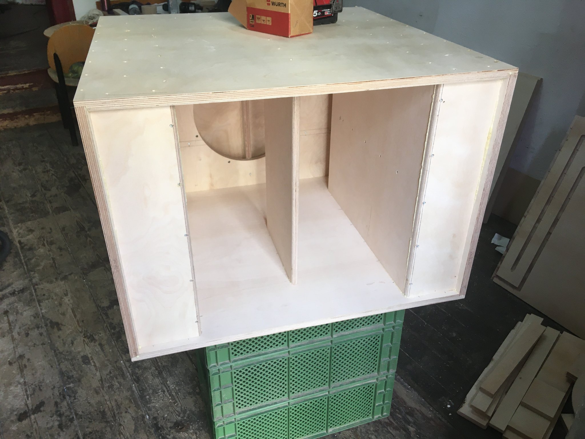

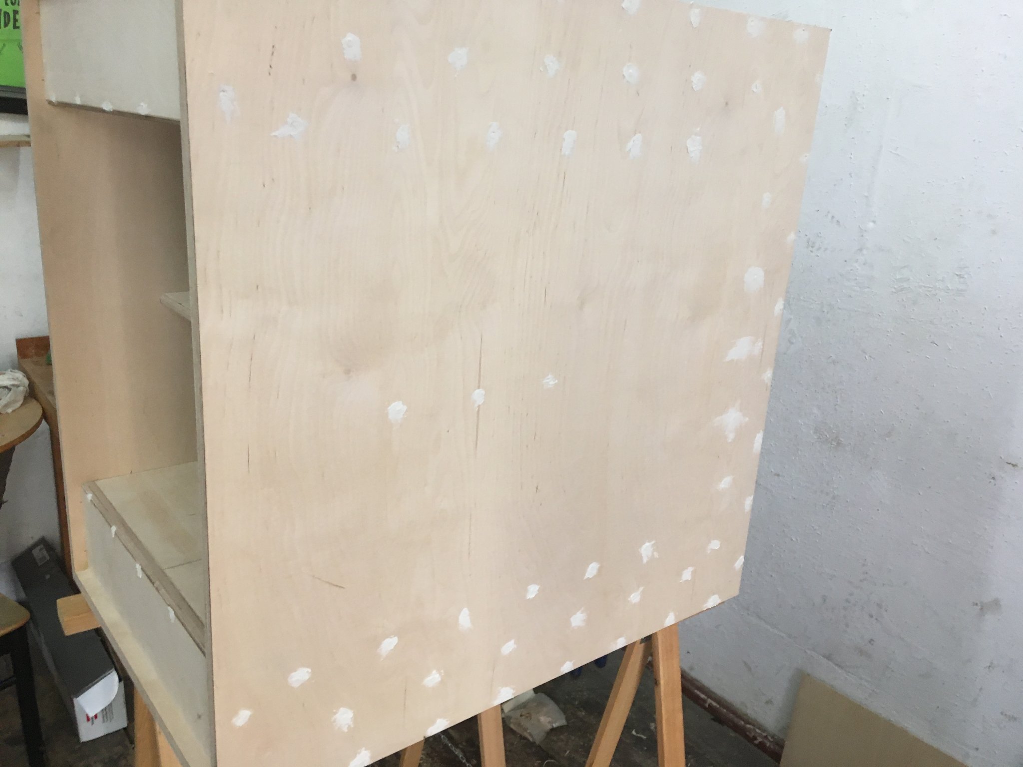

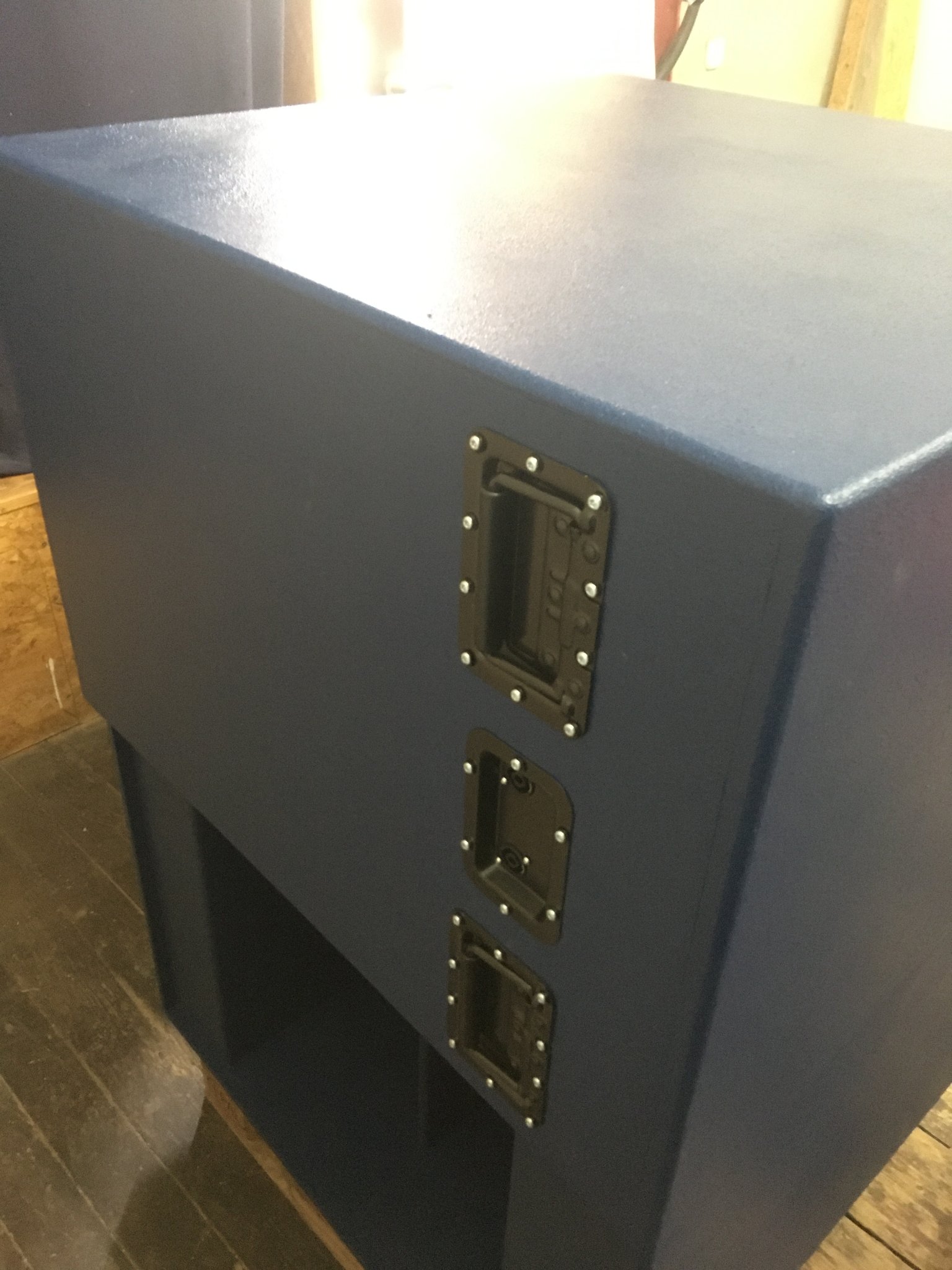

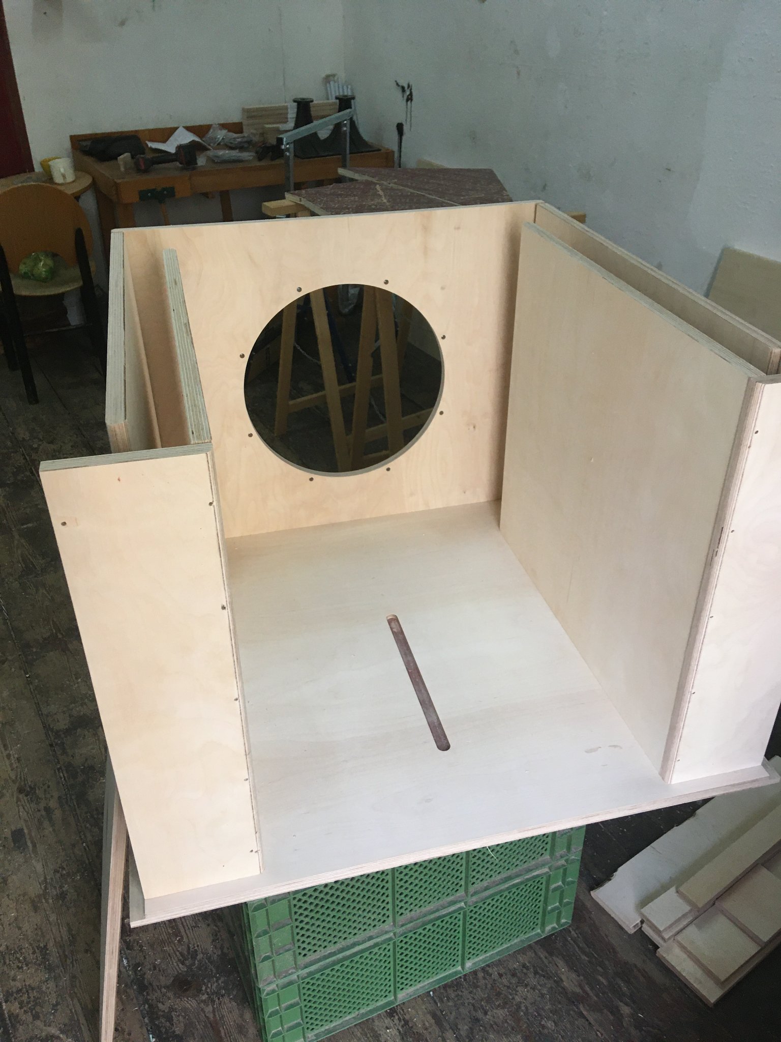

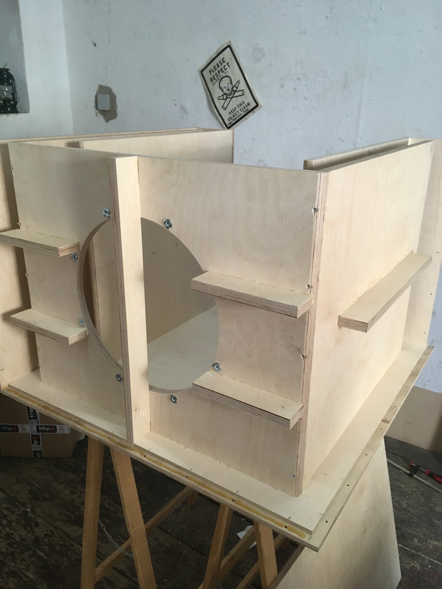

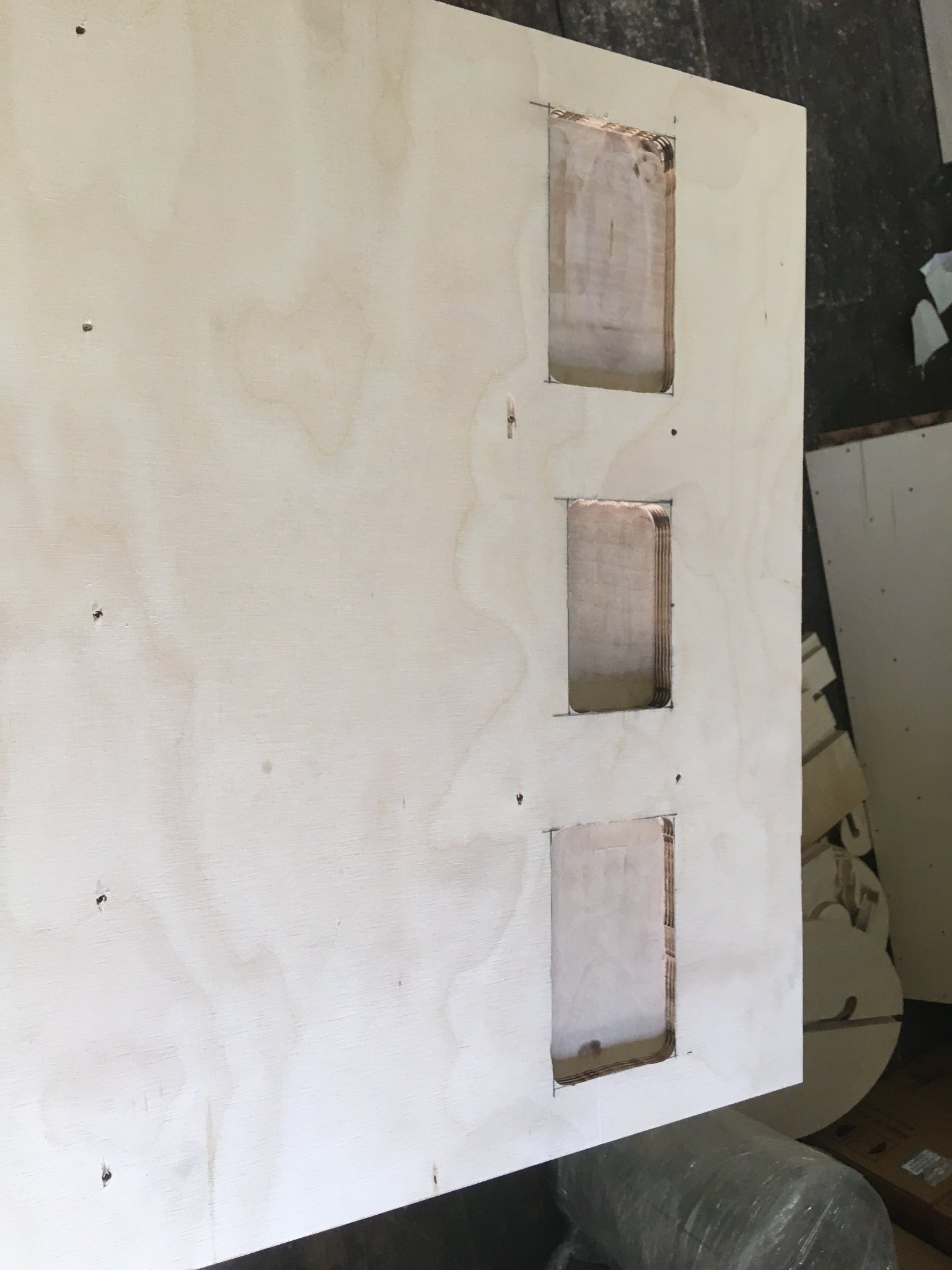

Hey there,

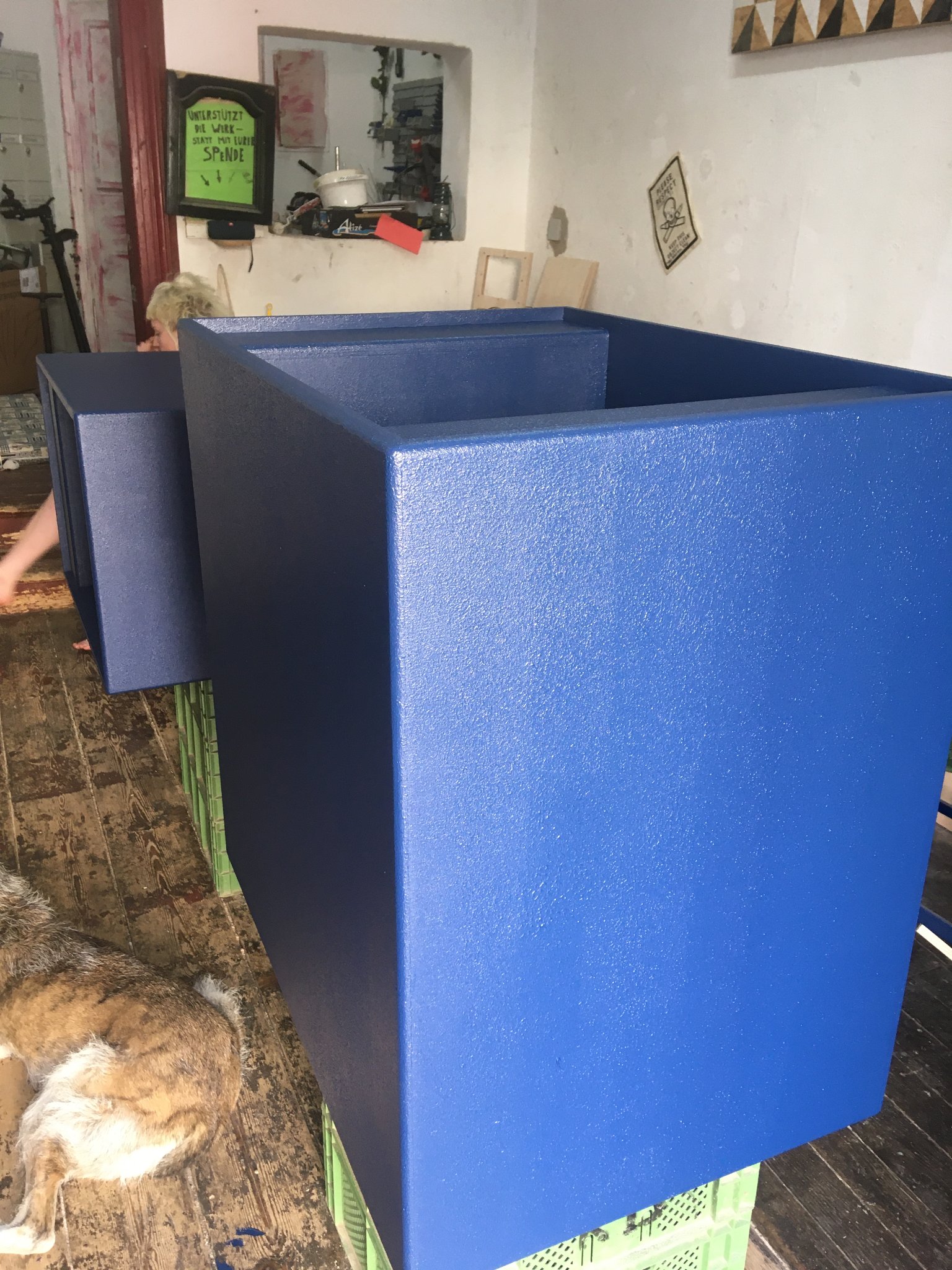

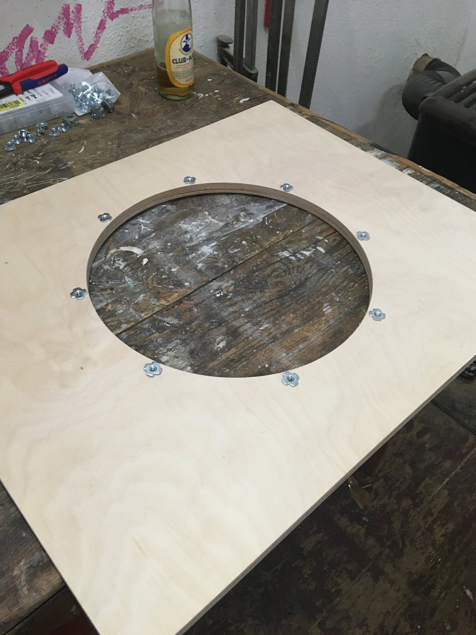

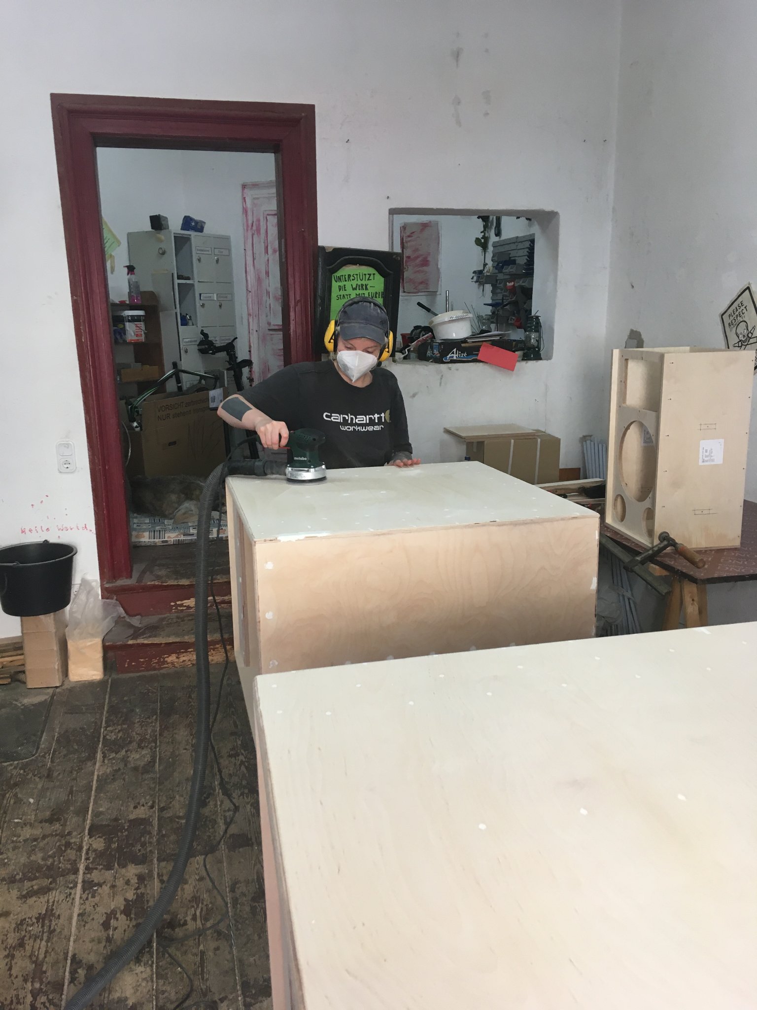

finally posting some pictures from my ROAR15 build.
I am very happy with the build and performance.
I am running them along two Celestion CKT-TF1225.
I am still in the process of good measuring and Crossover Design.
First measurements suggest Phase Alignment with somewhere between 7.95 to 8.25 ms of delay for the mid-top speakers
following Merlijn van Veens Relative/ Absolute method.
https://www.merlijnvanveen.nl/en/st...gnment-the-foolproof-relative-absolute-method
Along with the pictures comes an updated version of the 3D drawing used for CNC.
DM me for DXF. version of that file, as i can't upload that here and had to convert to stp.
