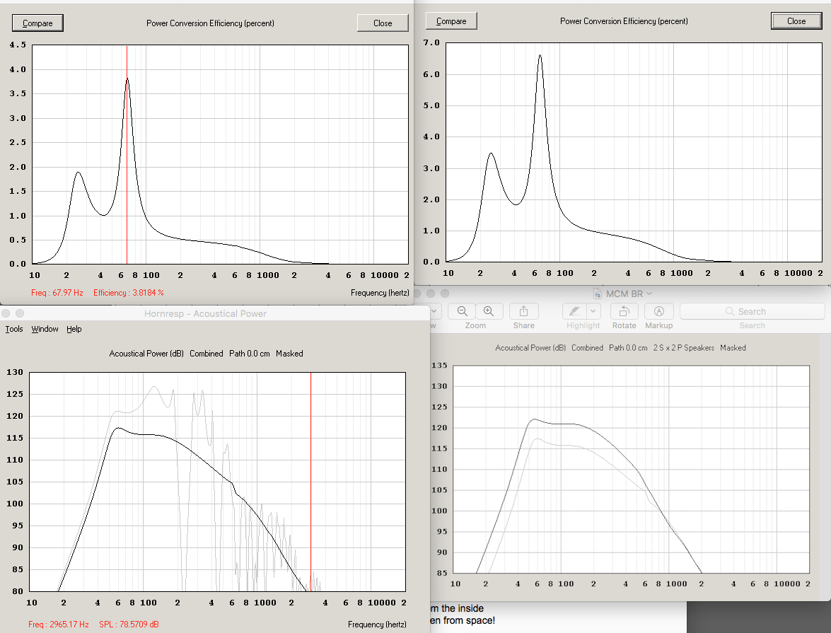

Sub measurement, unfiltered, no eq, outside in relatively open space (see image attached below)
Carlos,
The response looks to be within about 2dB of the sim, well within expected driver tolerances. Nice.

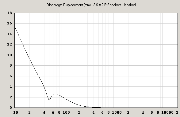

If the SPL readings are correct (65-75dBSPL), at 1meter, -15dB distortion (around 18%) is really poor.I deliberately built this thing cheaply and quickly, and left out any bracing in the pipe section, to stop myself getting overinvested in the prototype and get a baseline for the effect of reducing panel flex - so this box is in 12mm mdf, unbraced! I think the impedence ripples at 90 and 150Hz are panel resonances. REW distortion quite high, but I think a lot will be the panel flex!
At 44volts, 10 meters, the sub should hit around 100dB with only 6mm excursion at 60Hz.
Xmax is 8mm (16mm is a peak to peak figure on the spec sheet..).
Usually distortion is under 10% for good drivers run below Xmax.
Since you are planning to run on battery power, efficiency is important.Overall the design is definitely interesting. The efficiency is great, even at pmax with heavy basslines the driver excursion looks controlled and minimal. At non PA levels no visible cone movement at all!
A 2x8" bass reflex with similar F3 can be built with half the volume.
A pair of those is close to double the efficiency in the 50-100 Hz range (1-3.5% vs 2-6%).
Uses double the drivers, but a fraction of the wood- considering the cost of the drivers, and lugging a lot less weight,
you might want to consider the simple bass reflex cabinets too.
The bass reflex excursion is less, and driver loading less severe, which also should reduce distortion.
The bass reflex could also be tuned much lower with relatively little cabinet size increase.
Anyway, always tradeoffs- the Paraflex upper response gain is nice, but if you like more of a "haystack" LF bass response, the BR may be more to your liking.

The Spl on those sweeps wasn't calibrated and the voltage wasn't measured, so don't read too much into that. Tthe sweeps were at about 5m. No efficiency information there, but the prediction of >120dB at 240w input power seems reasonable based on the what I'm seeing.
I'll take another look at the distortion figures when I build a mk2, the measurement was made at reasonably high level, I was kneeling on the box and could feel a surprising amount of flex from the top panel. Actual levels were about as high as I can go here without upsetting the neighbours!
I have looked at reflex, I'm really building this to have a look/listen with something else. The box as built is for sure far from perfect, but the sound is interesting enough to make me want to work on it a little more.

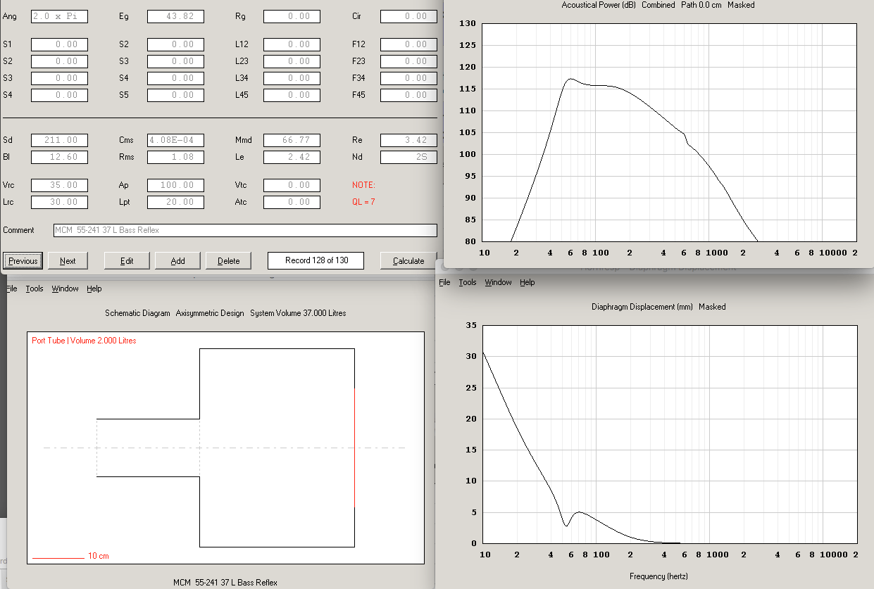

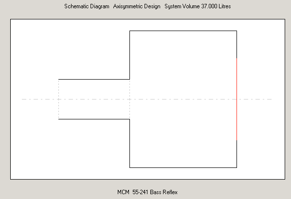

You are right, though I think I will build a compact reflex box with these as well though, for comparison - here is compact 2x dual 8" 20l boxes with 240w total compared with the tp-qwr thing, same power, same f3.
Carlos,I have looked at reflex, I'm really building this to have a look/listen with something else. The box as built is for sure far from perfect, but the sound is interesting enough to make me want to work on it a little more.

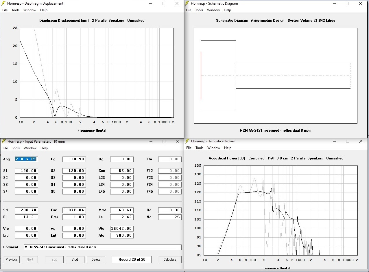

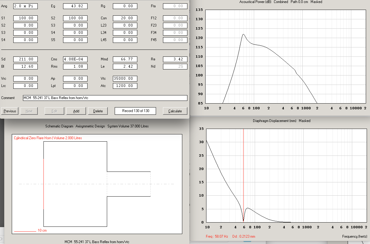

Horn transmission losses are assumed to be zero, unless absorbent filling material is specified.
Without the QL parameter as used for Hornresp vented-box enclosure systems, the output of the port will appear more peaky and greater than it will when actually measured.
An example like your model above:
Now with QTC:
Around a 5 dB difference at Fb.
The above sims port velocity is a bit high, one should size the ports for under 25 m/sec when driven to Xmax (8mm) at the excursion peak above Fb to avoid noise and port compression. That said, high port velocities blow heat out of the box, which helps cool drivers and reduce "power compression" when the voice coils heat up...
Your 21.62 liter sim has larger port volume than needed for an 8mm excursion, you could get more output per liter using a larger Vrc and smaller Ap, especially if you are only driving to under half Xmax at the excursion peak above Fb.
From the Hornresp Help file:
"Vented-box enclosure system losses are taken into account using the QL quality factor parameter. The default value is 7 but the value can be adjusted between 1 and 99 by double-clicking on the input parameters window QL or Lossless label in edit mode. The value can also be adjusted using the QL slider control in the Chamber section of the Loudspeaker Wizard. If the Loudspeaker Wizard slider is set to the maximum position, the true lossless model is selected. If the slider QL label is double-clicked, the control is reset to the default value of 7. The QL parameter reverts to the default value of 7 when a different record is selected or a new record is added."
