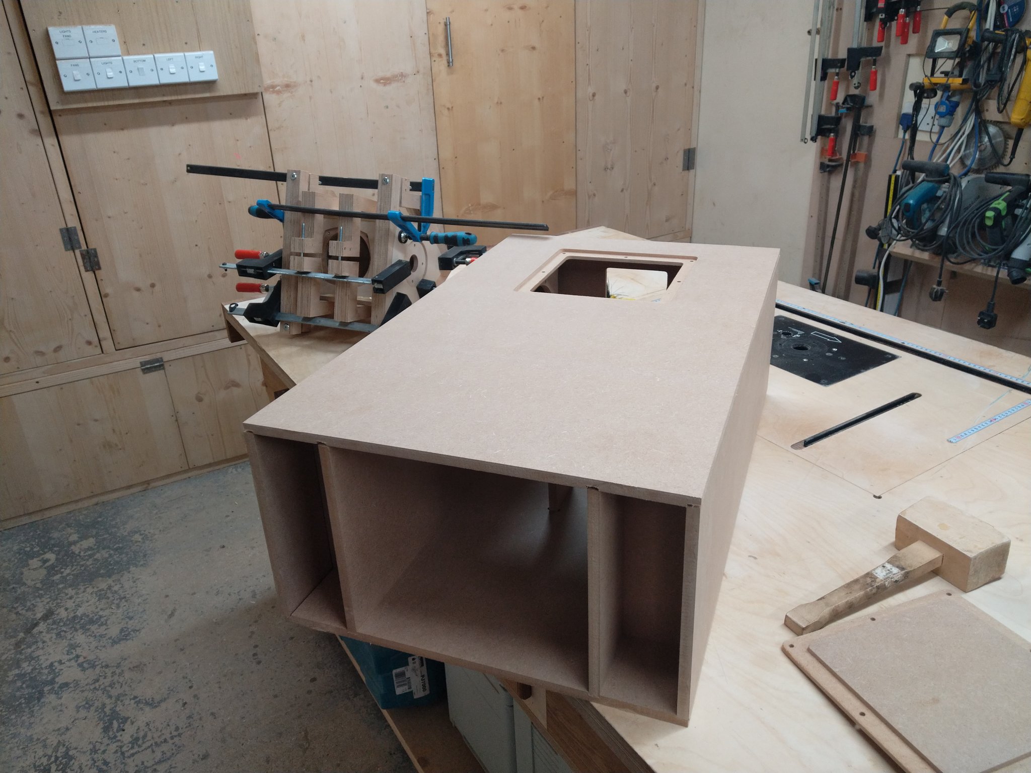

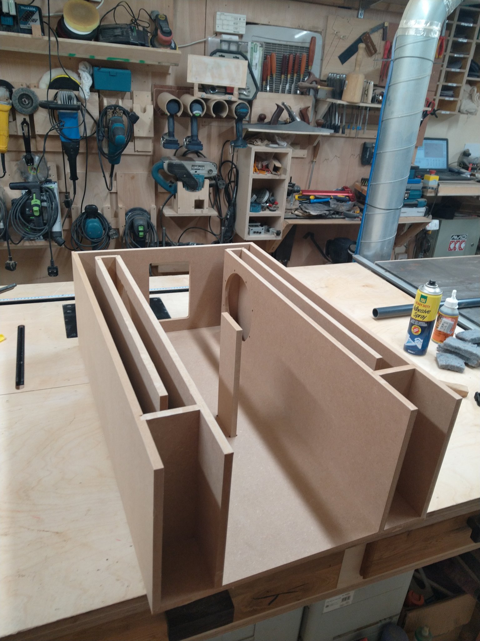

beautiful!! I’m digging all the dado work. I wouldn’t worry too much about the extra junk I’m talking about it’s nickel and dime stuff most likely more of an interesting Conversation that takes The numbers and patterns that Make best use of things that are related in other ways to other areas Physics and things that Spin, oscillate, vibrate ….. orbit, or have a menstrual cycle, LOL😂Well, went ahead and cut some stuff today, will see how it works out...View attachment 1019111
woodworking skills look to be in full forcehere. I think you got this handled! The first person to have more angle grinders in me and I know of LOL
. it’s exciting as a dual 8 inch. I have essentially the exact same thing with a pair of 12s and then it accidentally became a pair of the same. So its four Of the same driver currently.
Go pretty serious on the bracing definitely needed bursting out that little skinny pipe into the wide open Second resonator area . recipe for craziness but also might stir up some junk if its not Given the full respect of the situation.

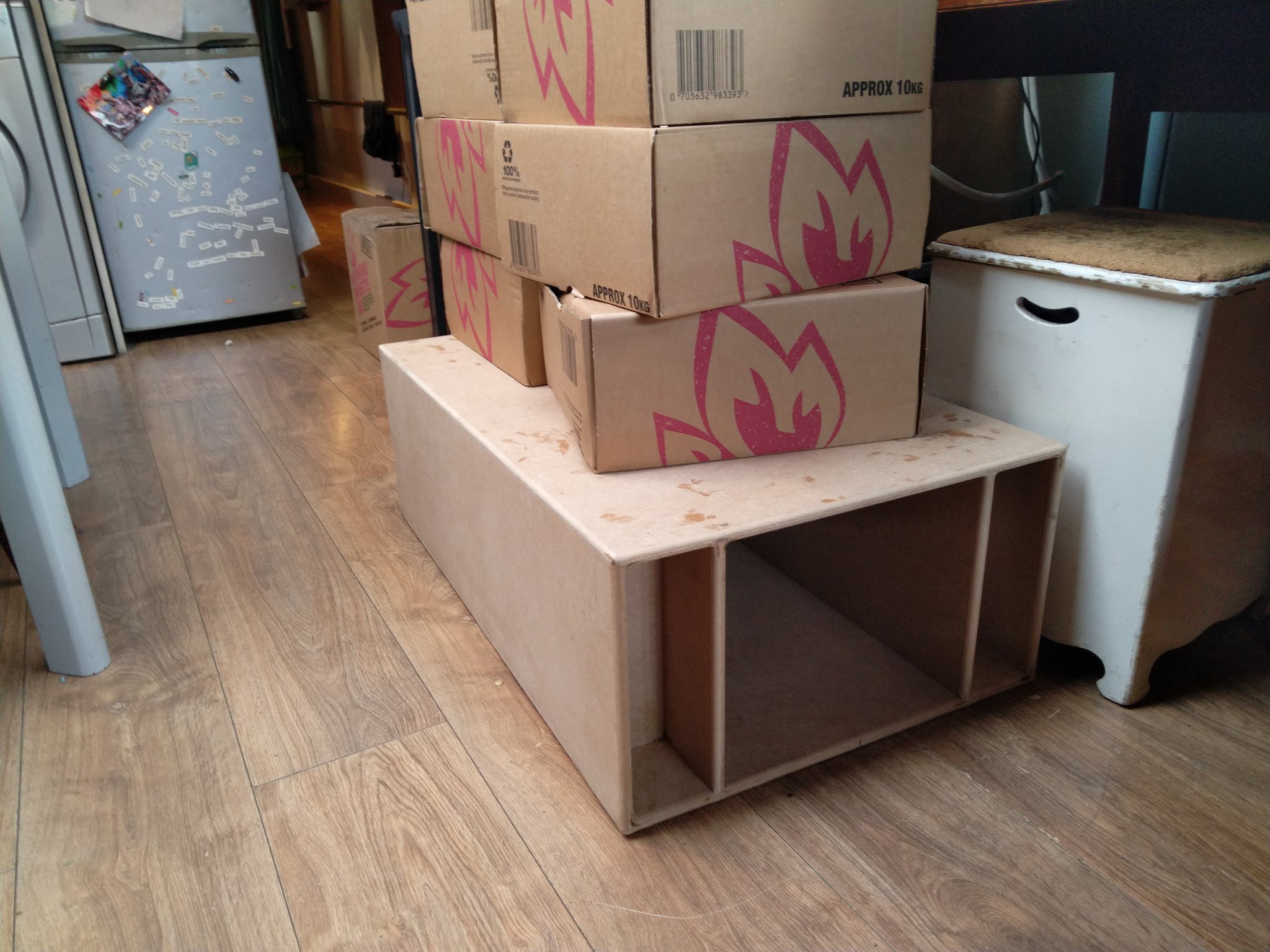

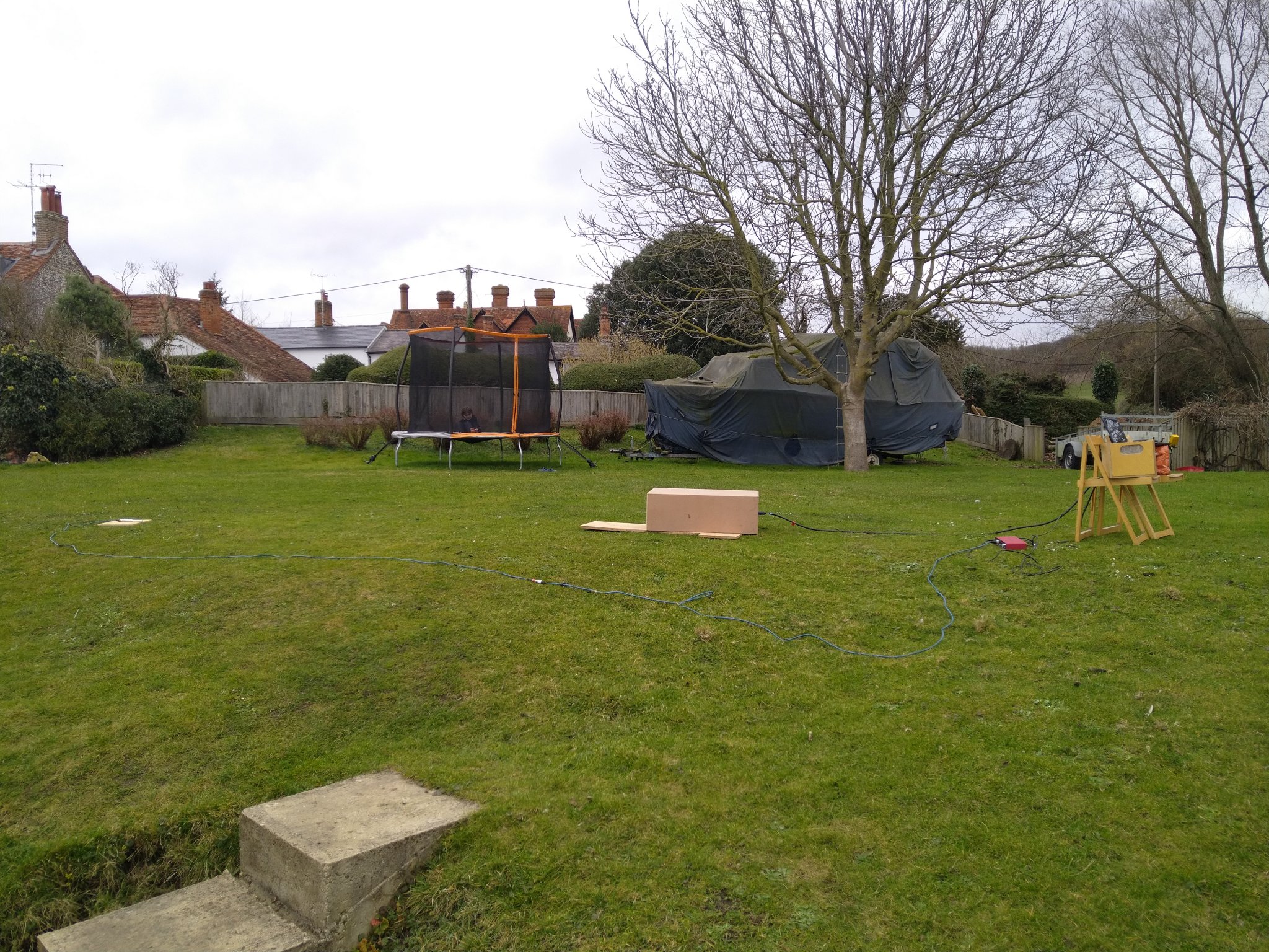

Not my workshop unfortunately! The CNC does make the woodwork easier 😉 and a lot faster. Yep I figure if the box works out I'll make a couple out of ply. Will add proper bracing at that point as needed. Will post the results of the experment up here, hope to be having a bit of a listen over the weekend 🙂
Well, got it glued together and had a bit of a listen...first impressions, it does sound pretty nice. The peakiness isn't as noticeable as you would think, with a bit of dsp tinkering should sound pretty good I think. Not much below 60Hz though...

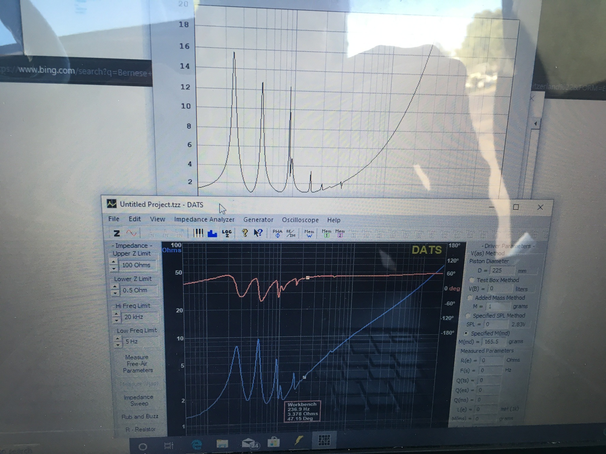

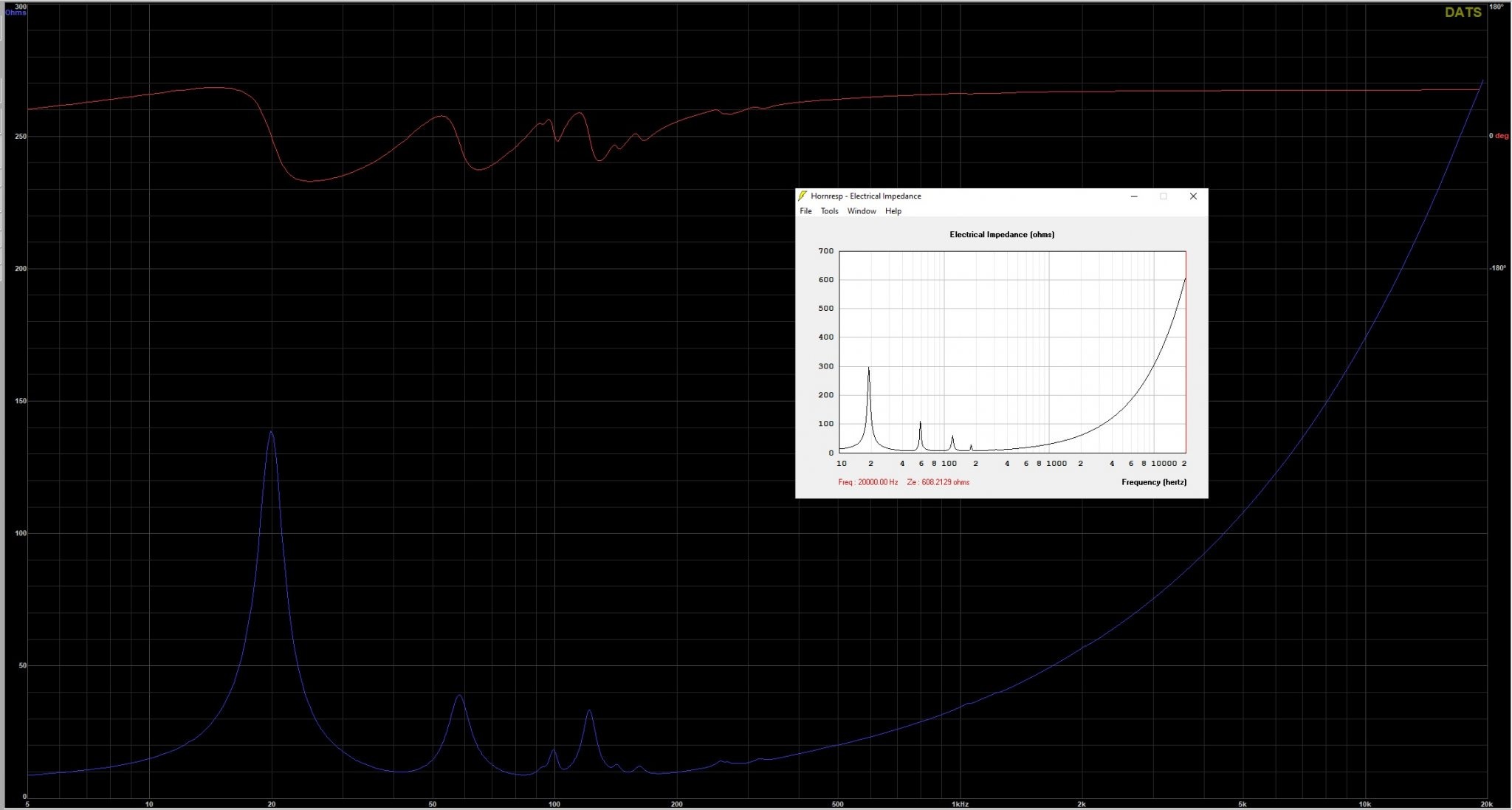

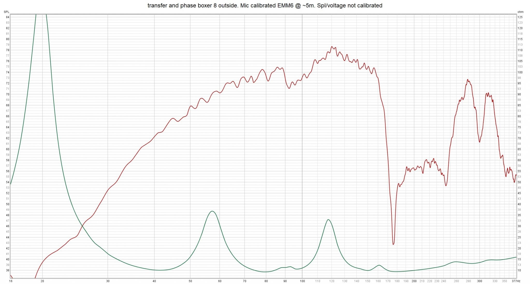

Have to get outside for some measurements, but here is an impedance sweep, along with the hornresp prediction. Frequencies are about right, magnitude not so close. And one peak is missing completely in the measured sweep.
Driver excursion seems pretty low and very well controlled. The cab needs quite a bit of bracing! walking across the floor nicely until I put a bit of weight on it!
Might have a pause and think about how to make a mk2. Would be nice to drop the extension 10-15Hz. Have to try adding an extension onto the front resonator, another 30 cm should get it down to 50...

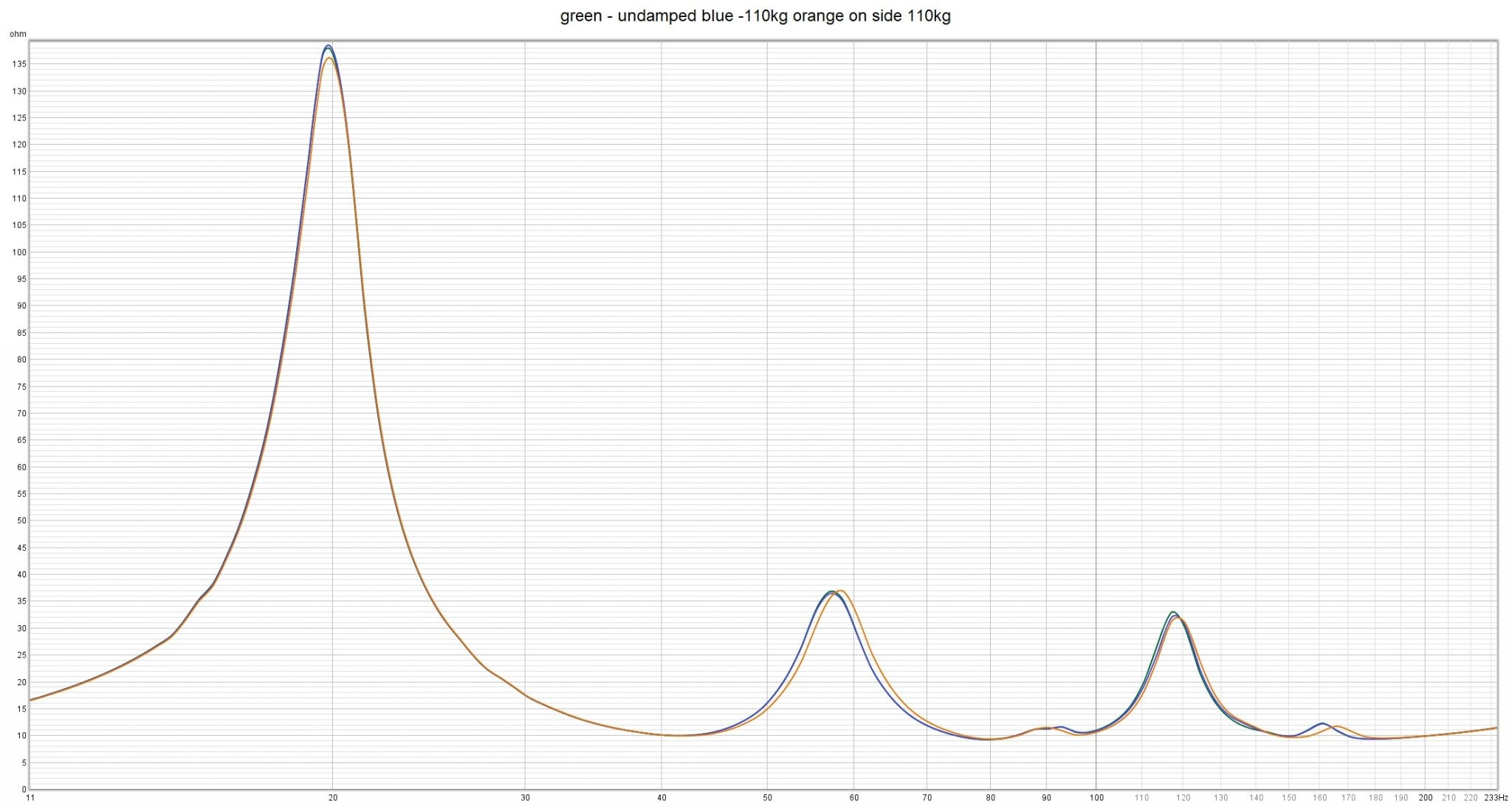

Stand or sit on the box and repeat the impedance measurement. If the peaks above 80 Hz become more like the sim, then it's a sign that you're losing a bit too much output to panel flex.Have to get outside for some measurements, but here is an impedance sweep, along with the hornresp prediction. Frequencies are about right, magnitude not so close. And one peak is missing completely in the measured sweep.

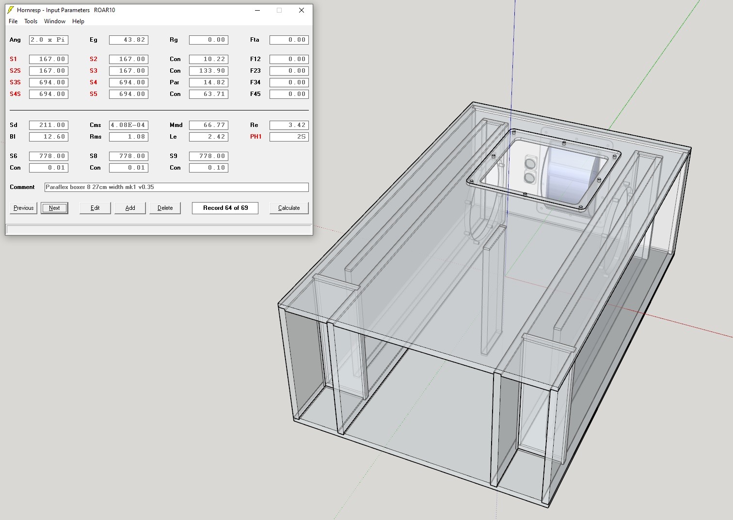

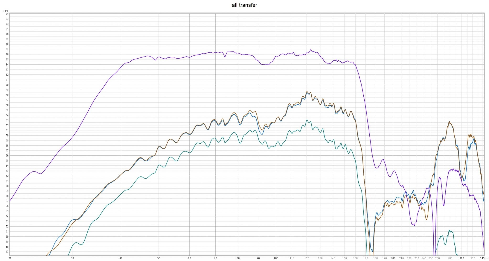

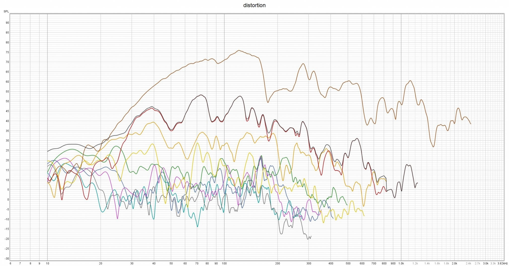

Sub measurement, unfiltered, no eq, outside in relatively open space (see image attached below)
I deliberately built this thing cheaply and quickly, and left out any bracing in the pipe section, to stop myself getting overinvested in the prototype and get a baseline for the effect of reducing panel flex - so this box is in 12mm mdf, unbraced! I think the impedence ripples at 90 and 150Hz are panel resonances.
I tried this, there is very little difference in the sweep, but I don't think adding weight can do much to damp the internal and side panels, they are flexing the most. I'm sure bracing the length of the tapped pipe section, the pipe entry to the front resonator and adding a cross brace at the mouth will make a big difference.Stand or sit on the box and repeat the impedance measurement. If the peaks above 80 Hz become more like the sim, then it's a sign that you're losing a bit too much output to panel flex.

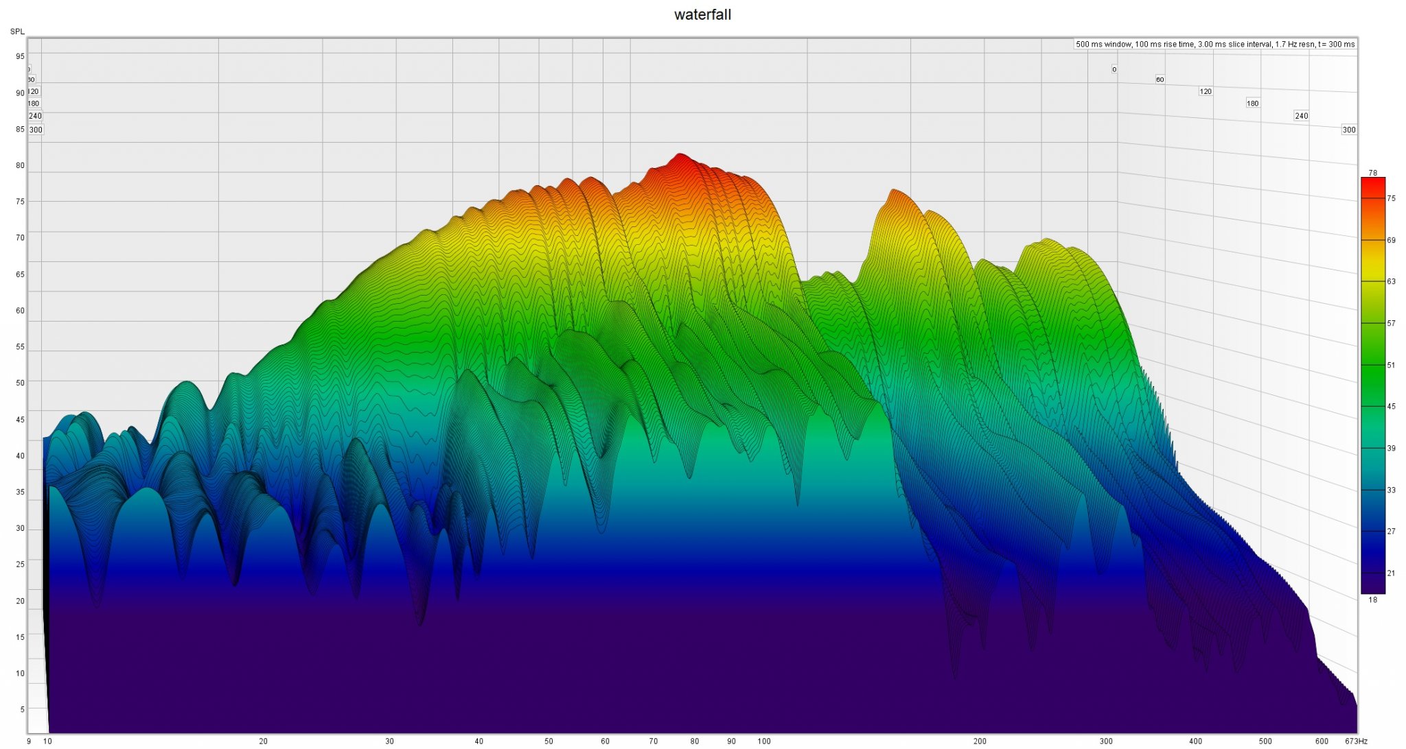

REW distortion quite high, but I think a lot will be the panel flex!
waterfall
And finally, a few more transfer measurements. This shows the unfiltered sub with 256,512 and 1m sweeps (middle 3 lines) and filtered 25-135Hz with a notch filter at 196 Hz, q9 -6dB (guessed at from HR prediction, not doing much here!)
The top measurement is inside, quarter space, (fairly small room, 5mx4mx2m) with the mic on top of the speaker on a cushion at the mouth end, filtered 25-135Hz

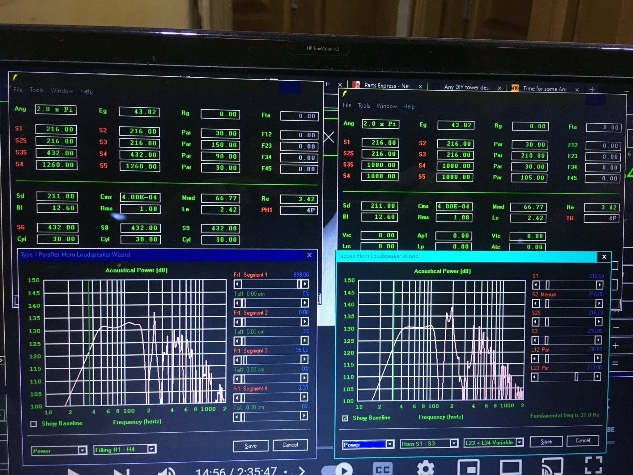

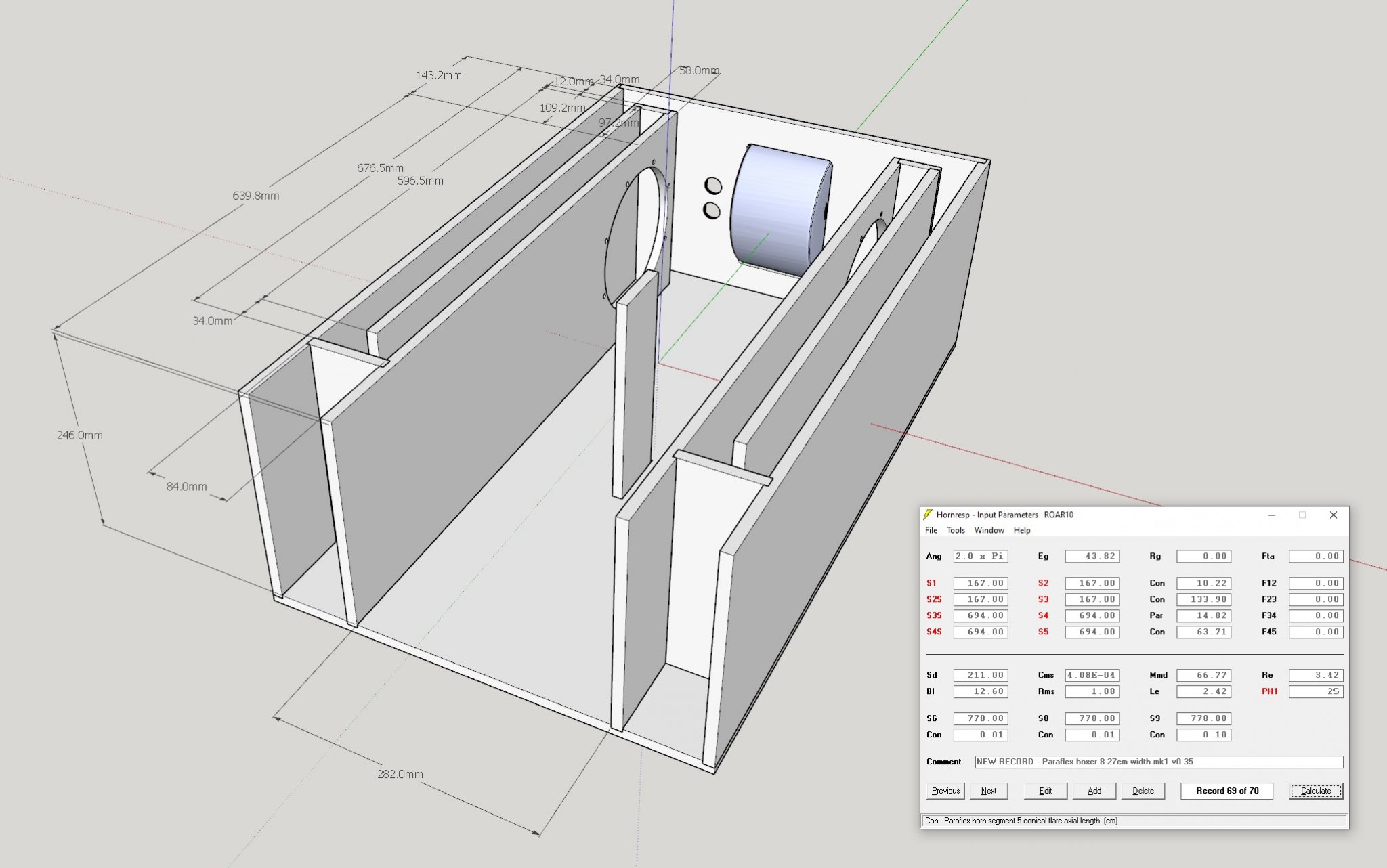

Dimensions and HR inputs:
I'm keen to run through another iteration or two of this design, very open to observations or suggestions! Booger Weldz, I'm sorry I'm still not getting the maths, I think I kind of have an idea what you're saying, but not enough to translate into the design of the sub - I'm not much of a maths guy unfortunately. I'll keep trying though, would be very interested to build something that conforms to your thinking and see if that brings it into focus.
Overall the design is definitely interesting. The efficiency is great, even at pmax with heavy basslines the driver excursion looks controlled and minimal. At non PA levels no visible cone movement at all!

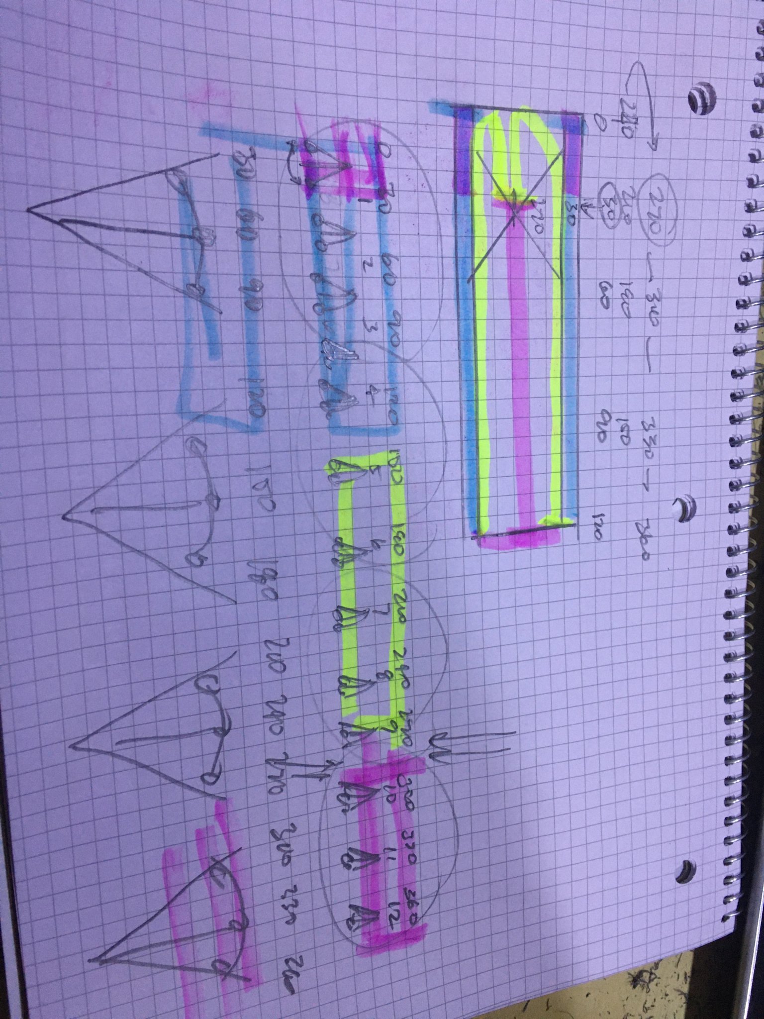

yeah it is hard to describe But if you take one centimeters and look at what it is as compared to an inch half of that discussioBut if you take one centimeters and look at what it is as compared to an inch half of The math and science in higher orders taken care of right there alone For the sine wave or the circle or what a cm represents as one drop of water. Freshwater anywhere anytime anyplace On a dry surface. Including what is cut in half and made into a sine wave?
All the decimal points count they all stand for numbers more than what is just seeing if you break it down further that says 12 and 24, 48 and 96 192 and 384 and 768 where it starts repeating again, at the same time it redefined in another cycle numerically 1536….
those numbers and the size of the circles and what they say based on the centimeter alone might not mean much.
do you however just keep looking at them say plenty and can see a whole lot more the more you look into it.

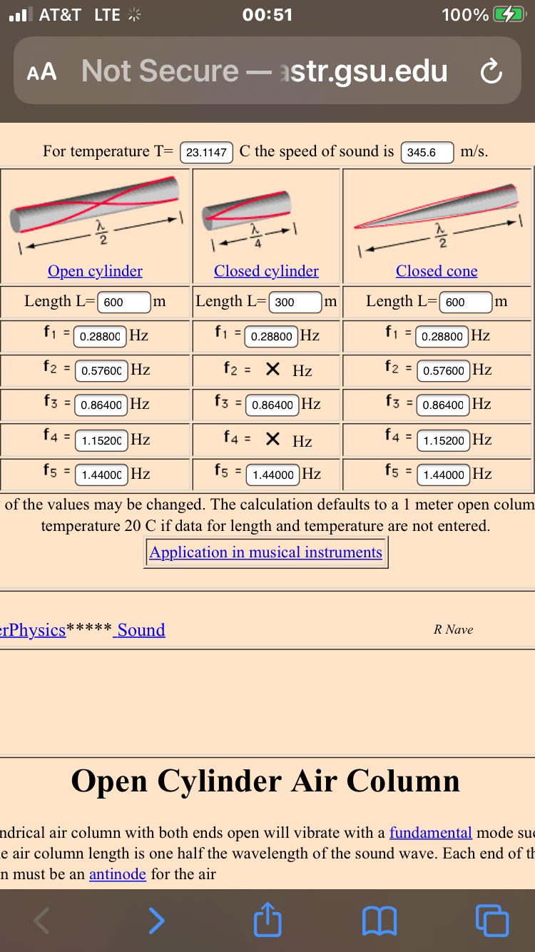

Given the correct CSA for the TS parameters and using zero path or anything to taint the result.
That whole concept is the beginning of all this other stuff there after the asset driver splitting up of the sine wave the ability to get anything out of a quarter pipe accept the fact that it’s just a big long.
That whole concept is the beginning of all this other stuff there after the asset driver splitting up of the sine wave the ability to get anything out of a quarter pipe accept the fact that it’s just a big long vent
All of pipe harmonics and physics to do with that same exact thing resides on these exact principles in this exact same function as so easily seen instead of described horn response.
Put a driver in a 300 cm pipe and you’ll understand that completely the only thing left is to understand radians versus degrees and circumference of a circle as a function of your enclosure and how that works and nothing else does so very well or ever could.
As soon as you start doing that you will see what’s really going on and you’ll be able to build a better enclosu closurerea then anyone does otherwise using any method. There’s nothing left to do once you reach that point and it will become obvious in the scrutiny of the simulation details

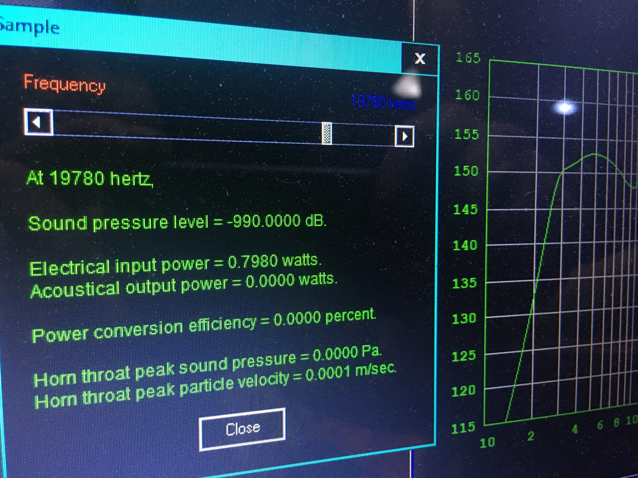

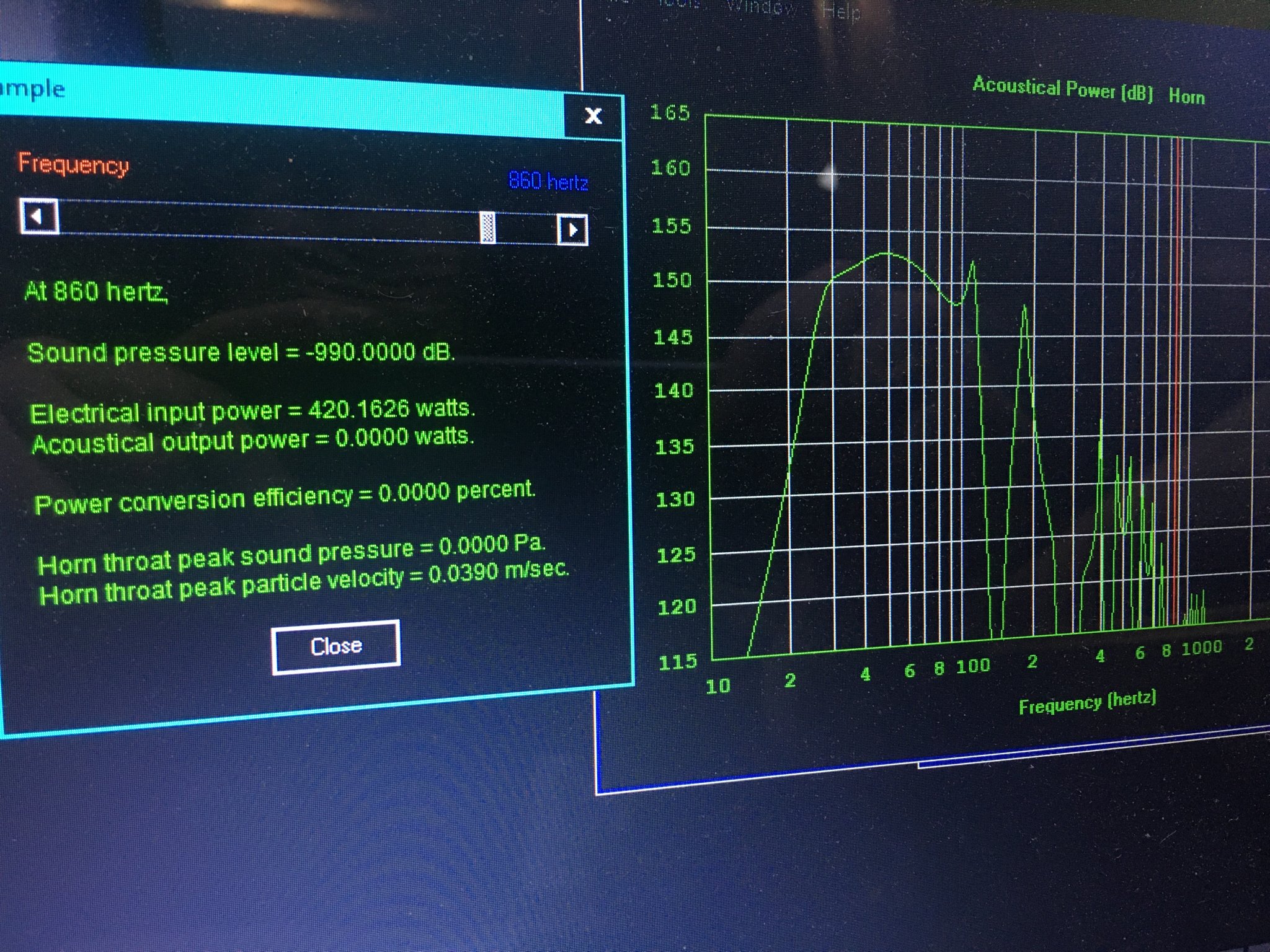

However you’ve already seen the -990 DB I believe in at 860 if you get there to fill up all the blanks from 860 there on that’s really 864 Horn responses has a speed of sound set at 3:44 If it was 3456It wouldn’t make 864 into 860. And 8640And all of those numbers out of band or what matters nothing else does this is higher order enclosures therefore higher orders are what matters and where the information is that to describe how they’re functioning
But you’re sitting on a gold mine because you’re already pretty close and you’re go for an attitude where you don’t give a **** you got bunny good time tBut you’re sitting on a gold mine because you’re already pretty close and you’re go for an attitude he’s gonna figure this out pretty quick for sure.

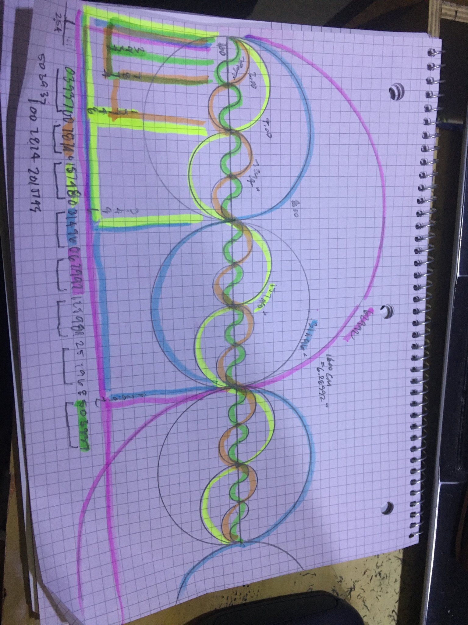

That entire blue row and the pink one next to it Will show up in the response at -990dB . As well part of both yellows prior to 20,000.
meanwhile that initial green rope is the other function riding alongside that you can see and peaks and valleys all the way out of the passband over and over again. That all is based on the circle is 360° is and then the higher order mass amongst that which you can either figure out or just push the I believe button I don’t bother with it but please note the orange row to the right take any of these things and put them into a pipe Calculator to see what they are in centimeters and frequencies and how they are all intermingling at 345.6 m/s when that is the speed of sound versus 299792458 when that is the speed of sound.
Those concepts and all of these numbers and all of his information combined it’s probably annoying and overwhelming Lee so however once you grasp it and once he started to make these this to your closers you’ll see what this is all really about I promise

A lot to digest above and been a busy few days, going to try to tweak the cab design a bit and build another prototype with bracing, better handle and hatch position, etc. etc. Should be able to run 4 of these off my little battery amp rack, which would be quite decent on the cost/performance scale I think 🙂
