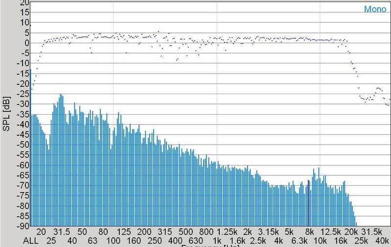

Response at the listening area about 14 feet from source is reasonably flat from about 22hz to 18khz:

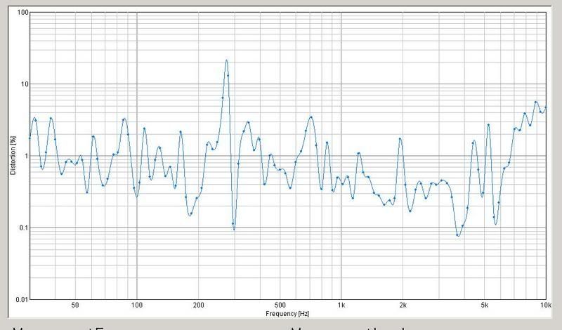

Distortion vs Freq, approx 95db

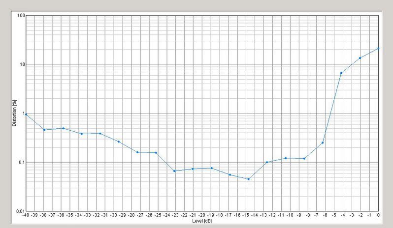

Distortion vs volume, 1000hz, Best Vol between 75 - 90db
Couple buds dropped by the other day and just for kicks we did a few sound tests on my horn system using a behringer 8000 mic.
All measurements taken with no integration, (averaging) or time delay.
Bass: Eminence/Klipsch
Mid: Jbl/altec 511 horns
Tweet: Eminence/altec 511 horns
Bass Amp: Crown k2 (.1 distortion) 3000 damping.
Mid/Tweet Amp: Carver 500, (.05 Distortion) 350 damping.
Bass Wire: 15ft Awg00 Ultra Flex 600 amp welding cable.
Mid/Tweet Wire: 15ft Awg 1 Ultra Flex 300 amp welding cable
Electronic bass crossover is final at 1300.
Electronic midrange crossover is final at 400.
All measurements were taken using sweep tones and the rta bandwidths were set to 1/24th octave because any wider averages it to much and tends to hide errors.
It would be nearly perfectly flat using 1/3 octave for instance and not show the combing effect that is occuring in the 200 - 600 region.
i should really straighten that area too some day if i ever decide to spring for another equalizer but since the combing is pretty fine, (narrow), it still sounds pretty brite, just not quite as brassy and pure sounding in that area as it could be.
The biggest thing a person will notice with this kind of setup is that the speaker will sound more live.
If you play a guitar through a good guitar amp and speaker, (marshal/fender etc), you will notice that no matter how quiet you turn it down, it still sounds like it is extremely loud and brilliant, yet when you turn it up it just gets big and eventually huge sounding.
That is the effect you can expect with this kind of speaker set up, and with the crown amp or any high damping amp you do not need a loudness contour to increase the bass as you reduce the volume as it retains the bass linearity with virtually no dropoff like soft amps do.
Instruments tend to sound more real and begin to have that natural sibilance and ambience even down into the bass regions that is typically lost in most systems.
An interesting observation is that the distortion drops below .1 and as low as .05ish in the midrange bass driver region which is driven with a .1 distortion amp.
