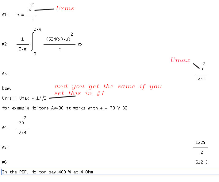

Lets be clear on this :
There are power amplifier losses that require a voltage
difference between the rails and output voltage.
At low output current this is basically a minimum drop-out voltage.
At high currrent it can increase due to resitive losses for Bipolar
output stages and in the case of Mosfets increase much faster
due to output current higher gate drive voltage requirements.
It is not reasonable to only assume power supply droop,
and the ripple voltage below this for minimum voltage.
🙂 sreten.

@sreten
yes, my estimation with 3V drop in the output stage is very optimistic
if we consider the high output current. depending on the VAS stage
and the BJT output stage this can easily exceed 5V.
in MOSFET designs it can easily exceed 10V......
cheers
markus

Yes. You can calculate peak power based on available voltage and the amplifier working voltage, but I don't know any math that'll get you to how much distortion there will be at that level given any particular topology.sreten said:
Sorry but you've lost me on this one.
Transistor amplifiers distort usually by running out of rail voltage,
or more to the point rail voltage - working voltage of the amplifier.
🙂 sreten.

"rms" power
Hi guys:
I should recognize that your oppinions are righ, but I must recall that the "rms" value was defined just for current or voltage, but not for power.
A "rms" voltage value will produce the same power dissipation in a pure resistor when is replaced with a d. c. voltage having the same value (1 V).
I mean if a pure resistor is (under the same conditions) dissipating 1 watt with a "rms" voltage of 1 V, then will also dissipate 1 watt when the a. c. signal is replaced with 1 V d. c.
An exact and valid phrase can be constructed for current, just replacing the word "voltage" with "current" when talking of the magnitud or "ampere" when doing that with the unit.
Then, what is the meaning for "rms" power?
I understand that spec as "honest" power, because Chinese introduced horrible specifications for power, followed by Sony that introduced "PMPO" watts.
But there is not any technical reason for talk about "rms" power.

Hi Hugo!
...true words...
Yes the rms values for voltage and current are a simplyfied
math tool to enable power dissipation calculations in linear resistive loads. This power dissipation is the average power dissipation of the resitor. For a DC signal this is clear. Constant voltage times constant current gives a constant power. So there is no difference
between max, mean and rms values.
For alternating signals things are getting more complicated.
The name rms (derived from: root mean square) are somehow
misplaced when we talk about the result in watts.....
Mathematical you get the rms voltages and currents from
the root of the average of the squared signal.....
For sinusodial signals this also delivers the well known factors 1.41 or 0.707 .
This makes life easier than always handling with u(t) and i(t),
which is already with sinusodial signals and without phase shift (inductive or capacitive load??!!!) somehow driving us crazy.
i(t)= Imax *sin (wt)
u(t) = Umax * sin(wt)
p(t) = i(t) * u(t) = Imax * Umax * (sin(wt))^2
Please note while voltage and current show positive and negative
values, the power will never get negative. No power is feed back from the resistive load to the amp. Of course in reality you have a complex load with phase shift and some energy will swing back....
Back to our rms-power, which is of course a really unfortunate name
because in fact it is more an average power than an rms-value!!
We can caculate
P = Urms*Irms, but have to keep in mind that this
is exactly the same as
P = average(p(t)) = average( Imax * Umax * (sin(wt))^2)
Well, nevertheless the wording "rms-power" has somehow established for honest power......
You can also play a little bit with a simulation software.
Simply simulate a resitor connected to a sinusodial voltage.
Then display the current and the rms value of the current.
The same with the voltage.
Next plot: current times voltage ==> shape of a squared sinusodial (no negative part anymore, but double frequency ....)
Average of this plot is the same as the power calculated from
Irms*Urms.
Please note that you have read the avg and rms values only at that points , when a full period or multiple full periods are finished.

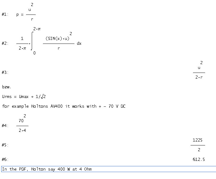

We can caculate
Irms*Urms.
Have fun
Markus
