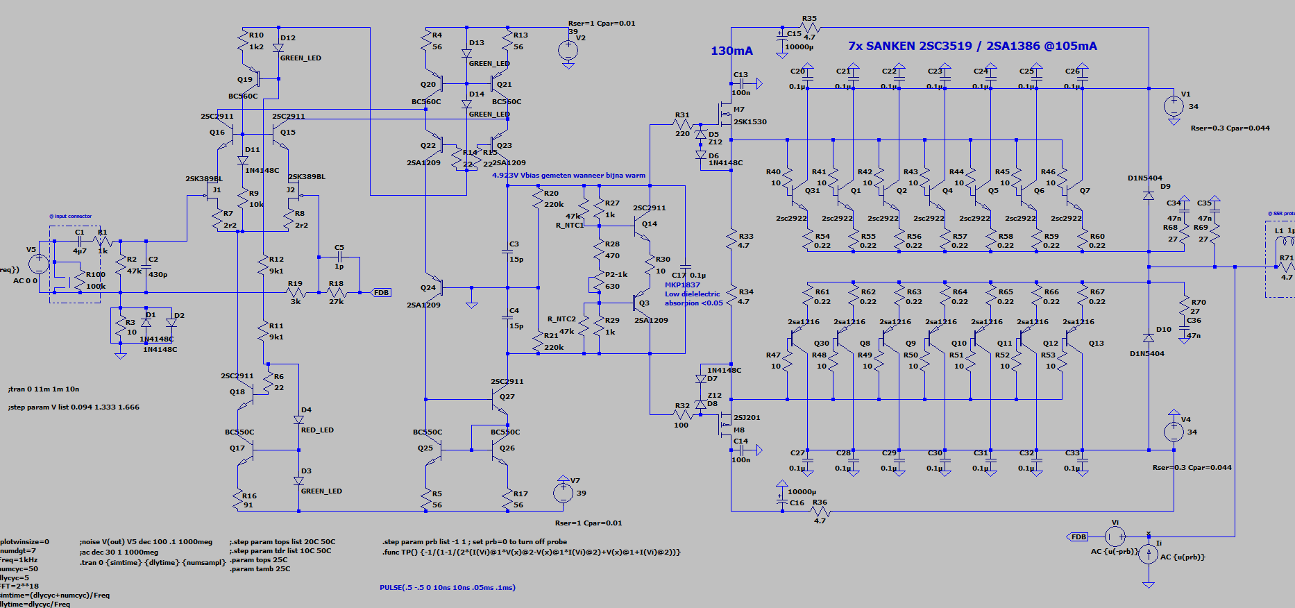

How can i convert the circuit adding a Vbe multiplier,so i could use BJT like njw0281,0302 as output?
Hi Thimios,
FC100 is also on my todo list some day. Below on example of how the VBE multiplier could be. This design is fine tuned and very very stable, for the output stage seen here.
Don’t look to much to the output stage, just wanted to give ideas for VBE multiplier. (I have this output stage running in my monoblocks and had the idea to put the FC100 front stage to it)
It is rather easy to replace those obsolete Toshiba Fet’s with laterals.
