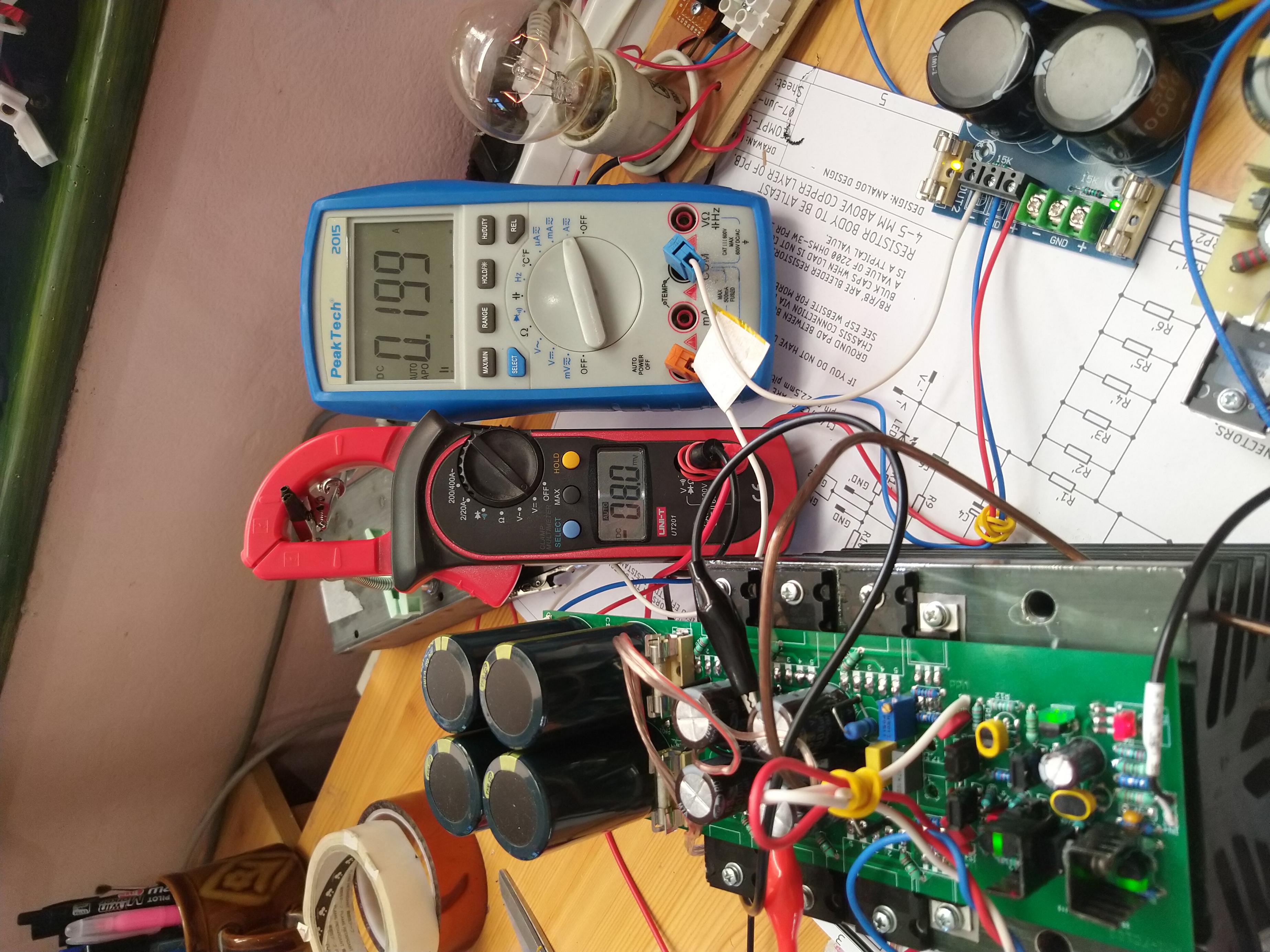

Dear All,
I built the amplifier based on the original plans. Now I setting up the quiescent current.
Do you think the values in the picture are correct or could I go even higher?
Listening the amp I did not recognize any distortion by maximum allowed input signal level.
After one hour run, the heatsink warmed up little therefore I can touch it easily with bare hands.
I measured 8mV between the legs of two emmiter resistor series, while over the half-supply 0.2 A ran through.
The voltages on the front end psu are +-43VDC and on the power stage +-38 VDC.
I want to load the amp with 8R speakers in the future.
Thank you for the help in advance!
Best regards,
Arcor
Picture:
https://i.postimg.cc/nrNm3dhv/IMG-20210901-154336-034742.jpg

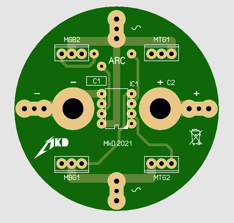

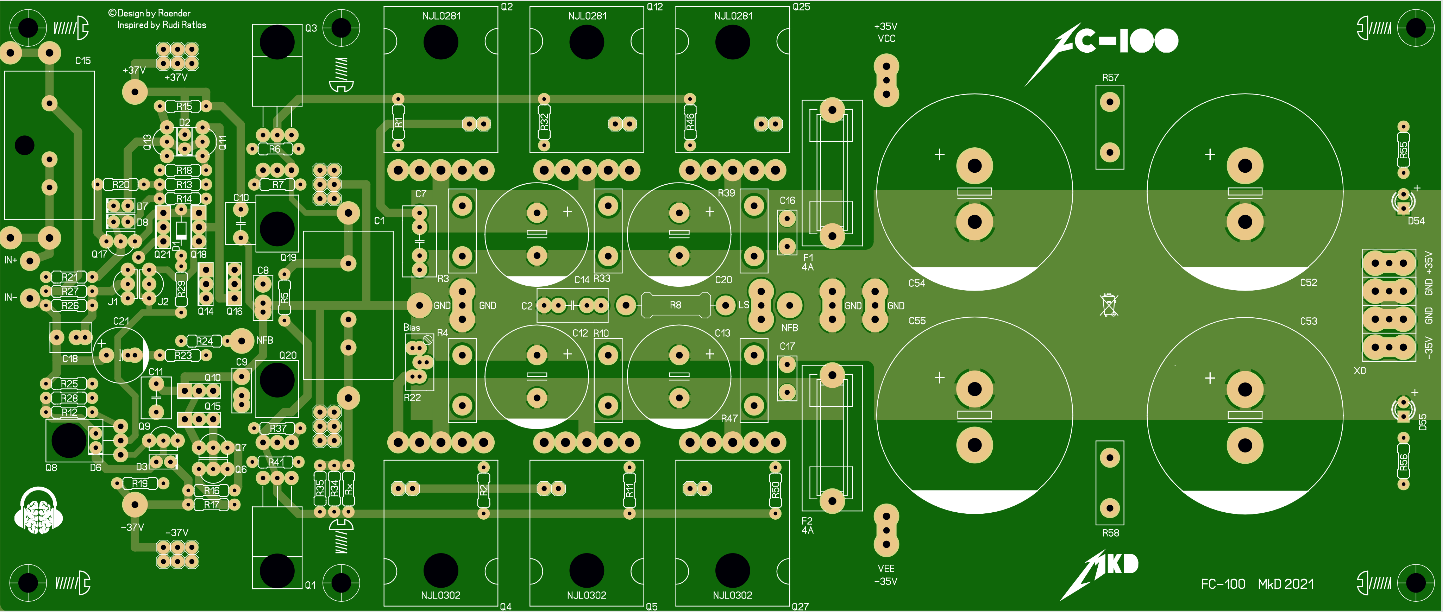

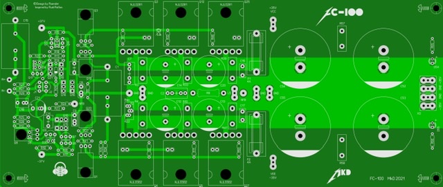

Actually I design the front end psu (active rectifier, lt3062) and rectifier board (active rectifier).
After that I will order circuit boards.
I will order a couple of boards next week.
If someone is interested, contact me.
Do you plan to build an amp and psu board to verify there are no unforeseen errors?
No, I am brave 😉
I can send all layers and the schematic to someone to verify it.
Who is ready to this job?
