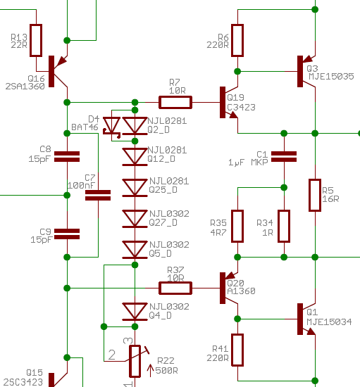

Bypassing one of the five diodes with a Schottky will work. Schottky have higher tempco than regular silicon diodes. Togheter with the somewhat higher serial rezistance needed (with very low tempco compared to the diodes) the resulting compensation should work. Sanken also used Schottky diodes togheter with junction diodes in their SAP series.Well, it's worse than i thought. At lightly warm temp NPN diode = 0.67V and PNP = 0.52V.... Schotky diode in place of them ?....
Denis
I can second what Franz said. I have bypassed one internal TT-Diode by a Schottky BAT46 diode, when I built my FC-100 prototype,
and the TEMPCO consisting of 4 TT-diodes and the Schottky works absolutely stable.
The VF across 2 emitter 0R1 resistors returns to the adjusted value (quiescent current / BIAS adjustment) within the blink of an eye!
I have ordered about 180 NJL0302DG/NJL0281DG from MOUSER currently (still waiting for delivery), needed for a current group-buy,
and wonder, how the TT-diodes will measure (behave).
I will tell you.
Best regards - Rudi_Ratlos

On one channel I seem to have a problem with the TT diode bias current. Recognising the risks of fuse blowing and worse I have avoided breaking into the diode string to do a current measurement; instead estimating the figure from the voltage across R17.
I=E/R .33V/150R=2.2mA I presume Q19,Q20 Ib's are shunting some current away from the diode string.
To get a more accurate figure I dialled up 100R in the pot, and while measuring the voltage across this things started to go awry. I need to understand what it is that DEFINES the 2mA TT diode current. The current mirror Q6,Q7 only ensures equality of the currents between Q14, Q16 rather than the value. The value is 8.25 mA minus 13.5mA/2 plus ?
Looks like I may have to back track somewhat and power up the front end only per post 640 and lift one end of R7 and R37 (base stoppers). Any insights appreciated. Wouldn't be surprised if another suspect Toshiba device has gone leaky etc.

Bingo, i added a Shottky diode in place of NPN ThermalTrack diode, keep the 3 PNP diodes and 1 NPN diode.
1 NPN , 3 PNP, 1 Schottky on the heat sink near the hottest transistor, that's it. Lightly over-compensated (best for me because my heatsink are borderline). seems to work great.
Would someone be willing to show a quick sketch/schematic of this 'fix'. I want to understand it better before I try to implement it.
Thanks,
Ryan

I don't recommend the shottky modification unless you are prepeared to check properly that the tempco is close enough to correct with just 4 diodes left in place as the bias voltage generator.
I would much prefer to believe the designer when he/she says use 5 diodes for tempco.
Andrew: the BAT46 - Schottky diode has a negative temperature-coefficient as well and I recommend to fasten it on the heatsink.
When I built my prototype (having problems with the Vf of the internal TT-diodes), I did the following test:
I could not adjust the quiescent current / BIAS with 5 internal TT-diodes being active.
I could do the quiescent / BIAS adjustment with only 4 diodes being active.
I played music very loud for some time and then stopped playing. I could see that it takes a second or so, until the voltage that dropped
across 2 emitter resistors settled to the initial value that I adjusted during quiescent / BIAS adjustment.
I did the same test with the Schottky diode, bypassing the "5th" internal TT-diode.
After playing music for some time and then stopping it, the voltage that I measured across the 2 emitter diodes,
dropped to the initial value within the "blink of an eye".
This was the proof for me that the Schottky diode enhances the temperature compensation and is very near to the
originally designed "5 TT-diodes - solution".
In my current build, I use 5 internal TT-diodes and everything works as designed.
Best regards - Rudi

After some tests it works well Andy.(and i don't have many other simple solution).
In the spec sheet of the Schottky diode i use (ONSemi MBRS family), the temp curve shows a more sensitive variation than the thermaltrack ones.
I have finally sorted out my problem mentioned in post 1244 (more than 2mA through the diode string). I think I must be getting too old and dopey for electronic projects as I failed to notice that LED D8 was not glowing! The reason was that it was installed back to front resulting in Q17 sourcing 5.9 mA instead of 1 mA.
For anyone experiencing biasing problems it would be worth checking the voltage drop across R17 in the current mirror. It should be around 0.33V when 2 mA is passing through the TT diodes.
