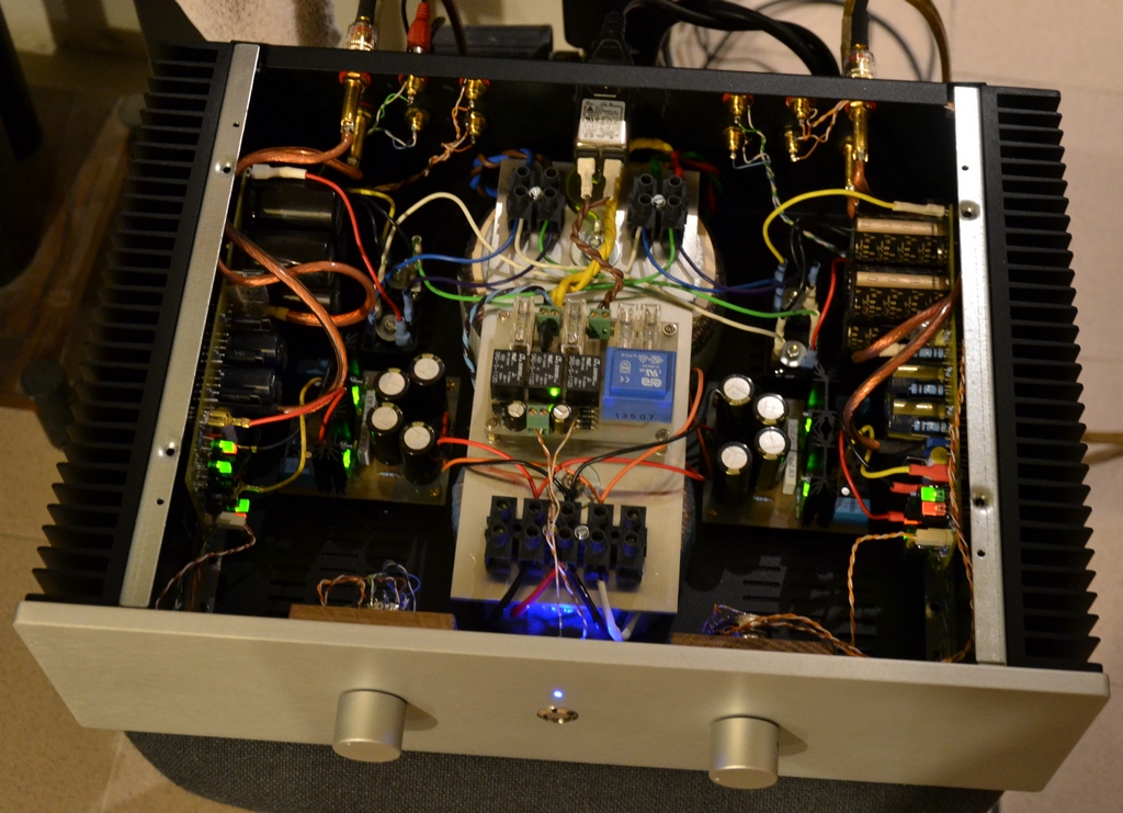

RMI-FC100, a single stage audio power amplifier
The primary goal is to match the hfe across NPN and PNP AND also the Vbe among the same polarity power transistors.
One of the primary source of distortion in a class B powerstage is the hfe discrepancy between opposite polarity power transistors. The other one is caused by "the differences in the slope of the transfer characteristic near the operating point as compared with the slope at high current levels" (http://www.hpl.hp.com/hpjournal/pdfs/IssuePDFs/1971-02.pdf)
By closely matching both hfe and Vbe we will minimize the crossover distortion and by putting as many as possible closely matched BJTs in parallel, and biased at correct class B current - 26mV across one Re, we will minimize even more this distortion.
26mv is the theoretical total voltage dropped over internal and external emitter resistors. We do not know exactly the value of internal emitter resistor but we can detect the minimal distortion point variating the bias current.
I have found that minimal crossover distortion, in the particular case of 0.1ohm external Re, is attained at roughly 18-19mV voltage doped over external Re. Higher values will increase the distortion but is not so worse to err on that direction rather than in the other, less than 18mV
Well, I am done now. I just have one little problem - how do I stop those little hairs on the back of my neck from standing up while this baby is playing? :clown:
I am done with amps now, I might build one day another just like this one. I just need to solve some minor hum issues, and it's getting a bit hot with Re=0.1 on those small sinks, so I might go for 0.22.
I am using BF862 in the front. Right channel pair is matched on Idss only at 0.01mA, and offset is at 0.4mV. The other channel is a bit loose at 1.4mV. :clown:
Photo:
I had a strange occurence today. I had to increase all Res to 0.15ohm since my sinks were not up to the task. When I reassembled the amp, I got trafo hum from both channels - and excessive buzzing noise from the output stage toroid itself. I disconnected output stages of both channels and noise went away. I connected one channel back, still no noise. I put back the second channel - again no noise! Any ideas what happened?😕
