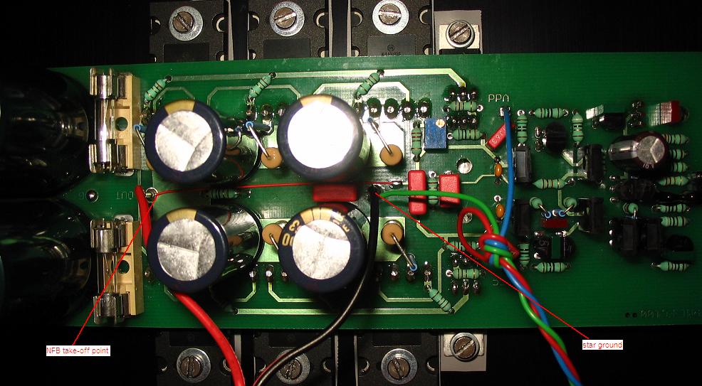

I love this wonderfull design too (= excessively + also) !
But... I'm sorrowfull because of C21. An electrolytic capacitor at the most critical node... even of very superior quality...
Pierre Lacombe.
Pierre Lacombe.
Pierre,
With a servo, and using JFET LTP, you could easily remove it.
However, what makes you think this cap will destroy the sound?
Hugh
Hugh
Dear Pierre,
In an earlier design stage I was worried about this elcap and for tests I've replace it with a DC servo with 0.1Hz response time. The change in sound fingerprint was NULL ... or my ears are not able to hear it.
Not the same thing I can say about the series input cap, even a very good quality one will affect the sound, not in a bad way but will make it colorful and unnatural. I have a pre with almost zero DC so I decide to not use one.
Mihai
Mihai
One more thing regarding elcap to ground in feedback network.
I don't know why many designer use to bypass that cap with a polywhatever "good quality" capacitor. There is no need for that if you use a low ESR one.
The risk for micro oscillation is huge at paralleling low esr elecaps with other very low esr capacitor.

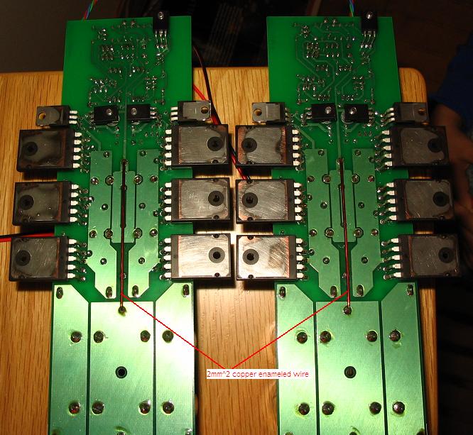

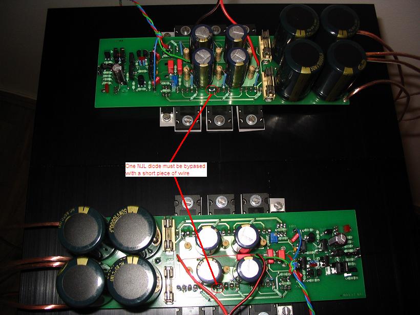

RMI-FC100 amplifier BOM
Resistors and capacitors values are printed on schematic.
http://www.diyaudio.com/forums/attachment.php?postid=1349109&stamp=1194852081&
All resistors are 0.6W metal film with exception of
R3, R4, R10, R33, R39, R47: 2W metal film.
R8, two 10ohm 0.6W metal film resistors conected in parallel
C8, C9, C18: silvered mica or styrofelx or ceramic NP0
C1, C10,C11: WIMA MKS4 63V
C2, C7: WIMA MKS4 250V
C21: 16V LOW ESR (Panasonic, Rubycon)
Biggest capacitors on PCB: 4 x SAMWHA 10.000uF/50V HC series *
Capacitors colse to power BJTs: 4 x Panasonic 1000uF/63V LOW ESR FC series *
*- see amp pcb http://www.diyaudio.com/forums/attachment.php?s=&postid=1349504&stamp=1194895504
D1, 1N4148: 1W glass case
D2, D3, D8: Green LED type LT433B or any other rectangular LED with Vf>=1.9V at If=5mA
D7, D6: BL-R5122B.RED or any other rectangular red LED
J1, J2: 2SK170BL with Idss >= 9mA
Q6, Q7, Q9: BC550C
Q11, Q13, Q17: BC560C
Q8, Q15, Q18, Q19, Q21: 2SC3423Y
Q10, Q14, Q16, Q20: 2SA1360Y
Q1: MJE15034
Q3: MJE15035
Q2, Q12, Q25: NJL0281D (prefered) or NJL3281D
Q4, Q5, Q27: NJL0302D (prefered) or NJL1302D
The following BJT peers must have hfe as close as possible:
Q21-Q18
Q11-Q13
Q6-Q7
Q14-Q16
Q19-Q20
Q1-Q3
The folowing power BJT must have the same Vbe +/- 1mV (only between the same type NPN/PNP) and all must have hfe as close as possible:
Q2-Q12-Q25-Q4-Q5-Q27
J1 and J2 must have the same Idss>=9mA and must have the same Vgs +/- 1mV at Id=6.25mA
