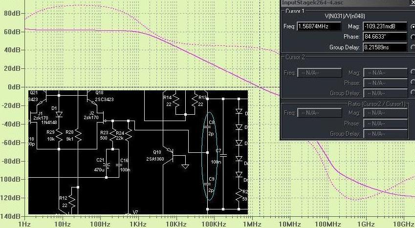

AKSA said:
... did you consider phase lead from Q15/16 collectors back to the feedback node?
Hugh
This looks very promising, at least in simulator. More phase margin (+20grd) and more SR too, because now "VAS" is loaded only by the output stage. With only 2 x 2pF, good ...
It seems that in this case I can drop output coil ... very good 😎
Thank You

I do have some comments about the Q15/16 collector drive to the output stage, however. It's very high impedance, and with the varying load seen at Q19/20 there will be some variation in OLG, though nothing like as much as if Q1 and Q3 were missing and it was a simple Double Emitter Follower. Variation in OLG with loading, particularly around the crossover region when transistors turn on and off, is problematic and where much of the low level spatial information is lost. Your output triple is good, but I'd try replacing Q1/Q3 with low current, thermally robust mosfets, say IRF710 series, and then you could use TO92 devices for Q19 and Q20 and drop the collector current to 1.5mA, making them easier to drive. Because of the gate capacitance of these mosfets, the drive current would eventually meet with SR issues, and this would have the effect of pulling back OLG at higher frequencies, in turn enhancing stability.
I admit I'm just giving my thoughts off the top of my head, without PSpice. From the stability POV, PSpice is not very reliable, but nothing can substitute the mental arithmetic of figuring out all the currents and voltages in your head.
The advantage of phase lead, Mihai, is that it means you can reduce toxic lag compensation slightly, and it will improve tolerance to reactive loading at the speaker.
Mihai, you can use just one phase lead cap, say around 3pF, from collector of the active device, Q16, back to fb node, and back it up with roughly 10pF of lag comp from collector Q16 to ground.

Mr. Dean,
Thank you again for your good advice regarding PL compensation method.
Respectfully allow me to not entirely agree with you.
1. Q8 is there to isolate outside signals to reach active current source transistor. In that way, will be hard to modulate output CCS current.
I know that there is not much voltage variation at Q8 collector but in any case Q8 will not do any harm to sound fingerprint.
2. The output stage has a input impedance in the Mohm order. At 20Kz, near full output power, Q19/Q20 base currents variation is in the range of 9 to 24uA
3. What is the difference, in sonic fingerprint, between PL and lag compensation?. With PL, if there is enough phase margin - let say more than 80grd, can I omit output coil?
4. Well, the 77mA drivers current has no magic in it as number but the MJE15034/15035 drivers are more linear at this collector current. I've read somewhere, now I don't remember where, that carriers in base output transistors will be much faster evacuated, at reverse bias, if driver current is a little bit higher than normally required for proper driver classA operation. I could be wrong in that ...
As per suckout capacitor, I don't have any experience with it regarding sonic signature.
The 0.1ohm Re resistors are not to small because output transistors are matched at less than 5% hfe. All 0302/0281 ONsemi transistors are factory matched in 10% hfe between 50mA to 5A Ic.
I need a small as possible Re in order to achieve as much as possible class A operation, without overbiassing output stage and to have a smooth transition between A and B operation class.
The bias current is very stiff and time stable because all output transistors are on the same heatsink and all are at the same TC with NJL diodes incorporated in output transistors.
Mihai

HI Mihai,
Of course! I would be disappointed if you did not - motivation comes from within, not from without.....
Modulation of the output CCS current will be asymmetrical, leading to even order distortion. This is benign, and would scarcely amount to 0.0001% anyway. You would need to replace Q9 with the 3423, however, for increased dissipation.
My mistake. This is more than acceptable, and vindicates your choice of the output triple. The CFP driver stage indeed has hugely high Zin, and this should preserve low level control over the outputs beautifully.
Phase lead has less effect on SR and appears much more benign than LC. You need some LC, and in my opinion you will still need an output coil (<1uH) to prevent ingress of RFI, but LC could be reduced to maybe two thirds of that presently used alone with a tiny amount of PL. The effect on the sonics of reduced LC is very positive, and the PL makes it then unconditionally stable.
The linearity of a CFP in Class A is essentially dominated by the master, not the slave device. I say Class A because even at high peak currents, the inactive side driver will still be on at all times because of R5. The real challenge is to sharply control the switching of the output devices. Since the master, Q19/20, is in constant 3mA current, the high levels of local fb will render the transfer function of the slave, Q1/3, almost insignificant, that is why I recommend a mosfet here. You could try a lower driver current in simulation; you might find the linearity is not much affected. In any event, changing this current is merely a change in R5, so it's easy to check sonically as well. In truth, the linearity of the output stage will be largely dominated by the variations in Vbe of the output devices (non-ohmic) and the ohmic losses of the emitter resistors.
I do like your output stage. I think it's very cool.
Mihai, do experiment with the suckout cap. It's very important to the sonics, and should have low dielectric absorption.
On output matching, what is the variation of stage current on each conjugate pair? I use 0R47 emitter resistors, match my beta within 2% and Vbe within 1mV, and achieve better than 3% matching between output pair stage currents.
I'll say it again; these are not criticisms, merely discussion points, I LOVE this design.
Hugh
