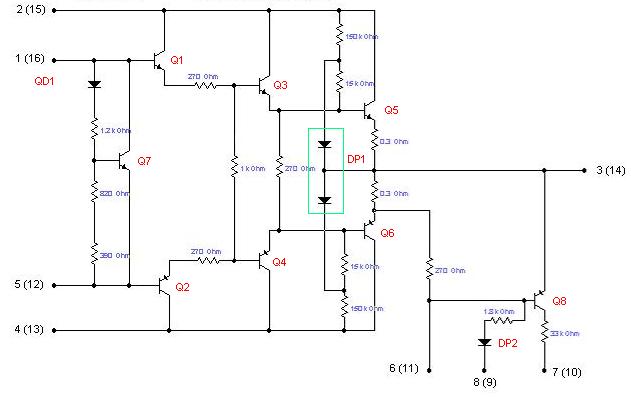

What kind of package is D1 1n4148? Can't see it between the transistors in your photos. Is it a DO-35 package? I ask because I assume the diode is stood up with the leads bent over at the top, and I see that the resistor in series with it has an insulated lead, yet there is no reason the resistor and diode can't touch, since they are connected together anyway.

Could we use the spare diode in the output to feed a comparator and give an overheat indication? Maybe a flashing LED?

AndrewT said:Could we use the spare diode in the output to feed a comparator and give an overheat indication? Maybe a flashing LED?
Thoughts please.
Yes Andrew, good idea.
I was thinking to cut the power when heat sink temperature is over 85C
pooge said:Mihai,
The 1N4148 diode has 1W glass package. I don't know the code name of the capsule...
The diode leg is isolated in order to not dissipate heat into cascode voltage reference 10Kohm resitor.
We want that diode to closely track the thermal variance of the cascode devices.

I was thinking the same thing. Of course, with the present board layout, those leads would be hard to access if the transistor leads are not soldered the board, unless some traces are cut and jumpered elsewhere. Perhaps in MK1.2a boards. ^\^

Is it one like this, stood up with the top lead bent over?
DO35 diode
So should both the diode lead and the resistor lead be insulated?
pooge said:
Yep, that's it, do-35 package
It is correct. My diode is in a little large package, i think is DO-41 (2mm diameter) glass, but DO-35 500mV will suffice.
In fact, is not important how large this diode is, if it fit between TO-129 cascode devices
Great. That makes things easier. I was wondering why you specified a 1W part to carry only 1ma.
I was thinking a mechanical switch on the heatsink to trigger a latching relay to cut off power.
But using the diode as a fast warning that overheating is starting to occur,
Again. What about the wattage of the 36v zener in the front end power supply? Anything I find availabe in 1W comes in a DO41 package with .8mm dia leads that won't fit in the holes on the circuit board.
AndrewT said:I was thinking a mechanical switch on the heatsink to trigger a latching relay to cut off power.
Or perhaps, in addition, use the signal to shunt the bias pot.
