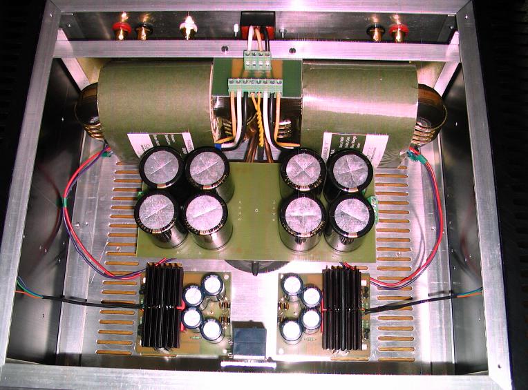

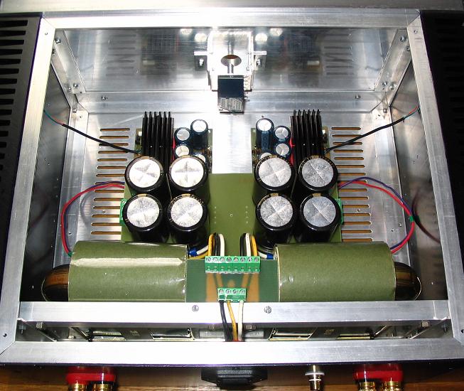

WHERE do you get those R-cores???
Is the capacitor on the input needed for stability, i.e., to extend the bandwidth of the input transistors? If not, and it is only there as an RF filter, can it be removed so an input transformer can be properly used?
pooge said:WHERE do you get those R-cores???
R-core? From Paris: http://www.selectronic.fr/magasin.asp#01
Regarding the input capacitor, you need some RF ingress protection in the input stage ...
Lucky you. The single primaries won't work for North American 117V supply.

homemodder said:Pooge, for the USA, try electroassemblies.com.
Thanks, but they no longer carry them, and Custom Magnetics has not been very helpful.
pooge said:no longer carry them
Shame, i was hoping some day there'd be sufficient interest in a joint 1.5-2 KVA endeavor.
