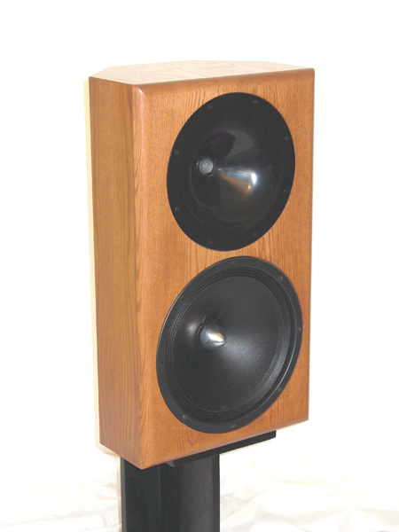

Hello JoshK,
The Alpha module enclosure is barely deep enough to accomodate the woofer's magnet. The rear vertical "corners" are bevelled, which from some angles can make the cabinet appear shallower than it actually is. I think you can see what I'm talking about by looking at the top of the cabinet in the image at this link.
The 45-degree bevels give a visual reference for the recommended 45 degree toe-in, and also reduce the effective width of the cabinet when it is thusly toed in.
Duke

Hello tomtom,
I chose the TD12M because it has very good midrange performance. I compared it with several other 10" and 12" high efficiency woofers, mainly looking at performance between 80 and 3000 Hz. Below 80 Hz doesn't matter as much in this application because I am using subwoofers; otherwise, I may well have used the TD10X or TD12X.
I prefer not to post measurements at this time, but I'd characterize the TD12M as an easy driver to work with from a crossover standpoint.
Duke
That is a very smart looking, most compact possible, cleverly picked high quality drivers using system, based on Geddes practices. I have no doubt that it deserves the excellent word of mouth here. Congrats!
P.S. Are the bass boxes differently tuned band pass units?
Salas, if you're talking to me... well, thank you!
The speaker shown obviously owes a great deal to Geddes' work, but departs from his recommendations in several ways. The waveguide is smaller than he would use with a 12" woofer, and lacks his patent-pending foam insert.
The subwoofer enclosures are fairly small, fairly low-tuned reflex boxes - not bandpass. I was unable to come up with a practical compact bandpass design that would cover as wide a frequency range as I wanted.
