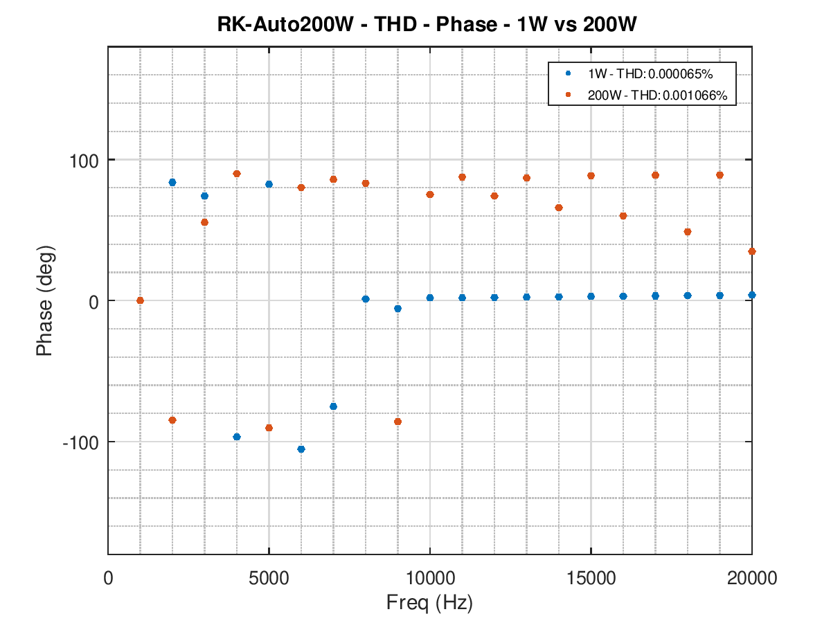

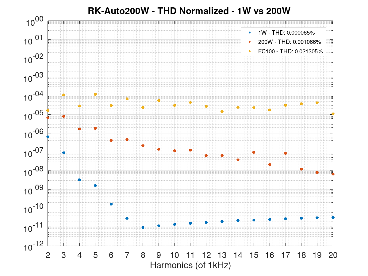

However please find attached your THD Data visualized. For Ploting I have used the free Matlab alternative Octave. Log is needed as csv.
Just a fast Plot script nothing fancy.
eps generated by the script have better quality. I do not use png a lot so sorry for the mediocre quality.
Need to refresh my ltspice skills then I will make thd analysis for Fc-100 and we could compare it. I have the spice data somewhere on my nas.
IMD Figures would also be interessting.

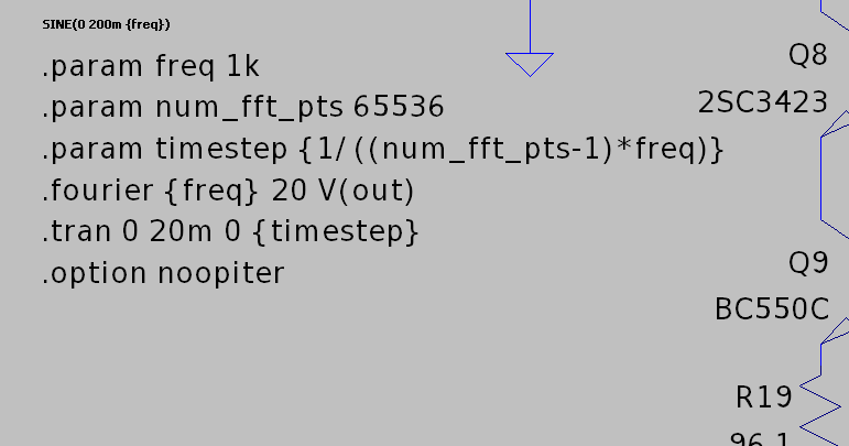

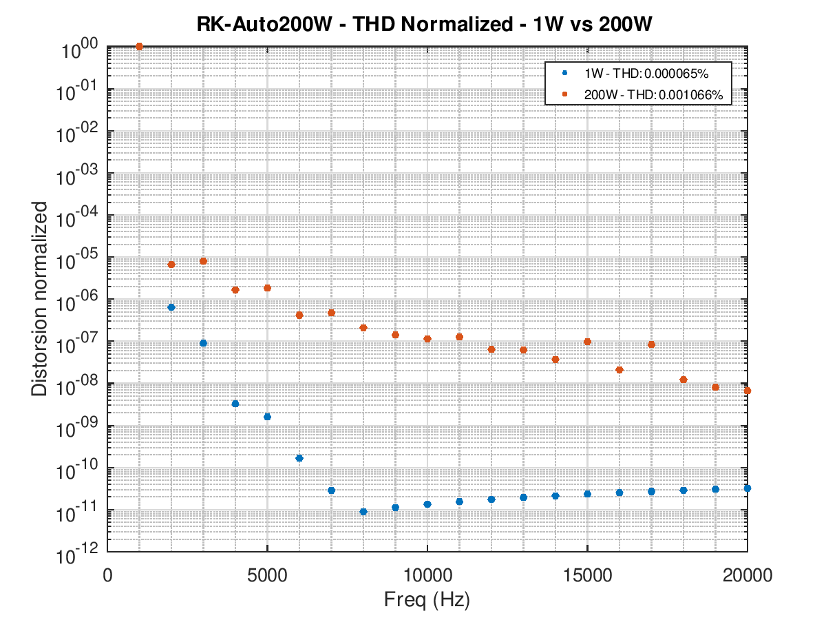

I have cranked up ltspcie again and used the original ltspice dataset of Mihai. His THD calculation have been a bit different compared to yours. So I changed it to 1kHz Plot of 20 Harmonics. Input amplitude is still 200mV as set by Mihai.
In comparison your Amp is looking really good. See yourself.
p.s. fc-100.zip is the LTspice Set. Comparison-fc-100.zip contains the pltoscript this time a bit more convinient with Harmonics # instead of pure freq.
btw...the THD is calculated by the script not necessary to copy past the result from Ltspce log.

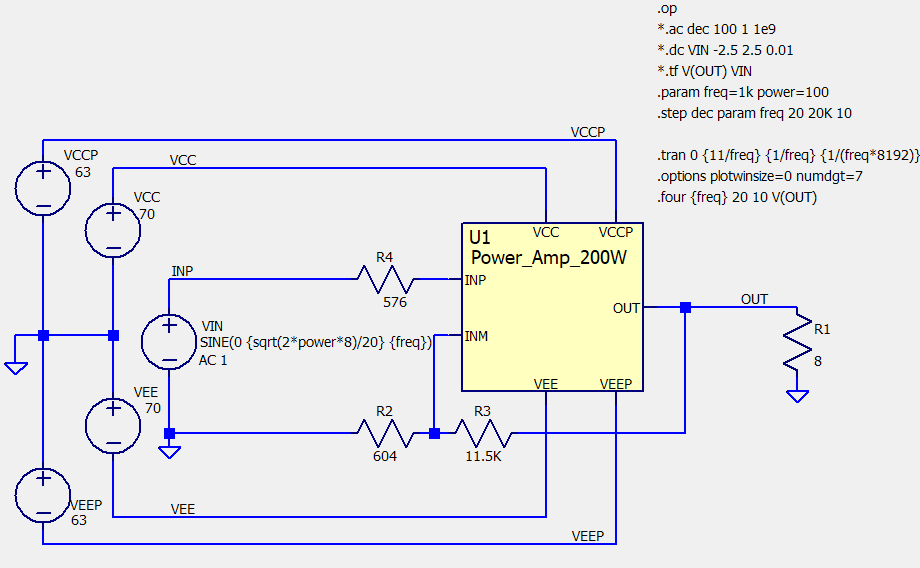

Step 1: Simple C to GND compensation
I have run several simulations on the closed loop. I initially closed the loop with a gain of 40, but I actually compensated it for a gain of 26dB or 20. I have changed the feedback for a gain of 20. That decreases the distortion from what I reported initially. Seems like all preamps are capable of 2V RMS output, and most are capable of over 10V RMS.
I have completed Step 1: C from the output of the folded cascode to GND. The C value is 68 pF, as shown in the schematic. BTW, that yields a calculated slew rate of 4mA/68pF = 58 V/us. A 60V amplitude, 20 kHz sine wave has SR=7.5 V/us.
Attached is
After I close the loop, I will develop the compensation in three steps, tracking distortion at each step.
1) C to gnd from the output of the folded cascode. Folded cascode op amps with external feedback are often compensated this way.
2) Miller Input Compensation (MIC) to the amplifier's inverting input from the output of the folded cascode. The local loop may need some compensation.
3) Transitional Miller Input Compensation (TMIC) with a split C to the inverting input, and a resistor to the output from between the caps.

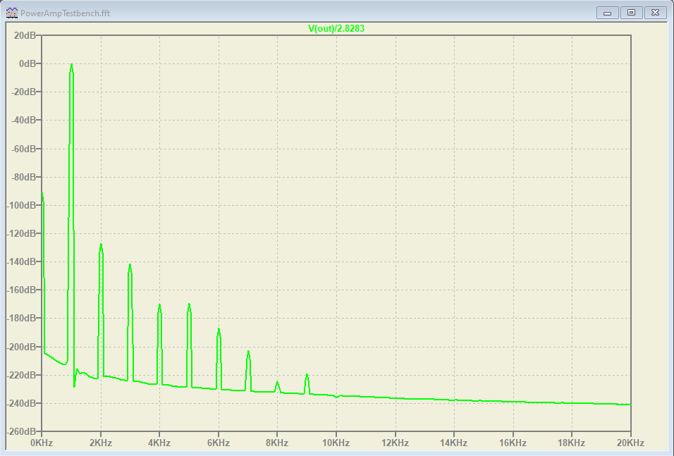

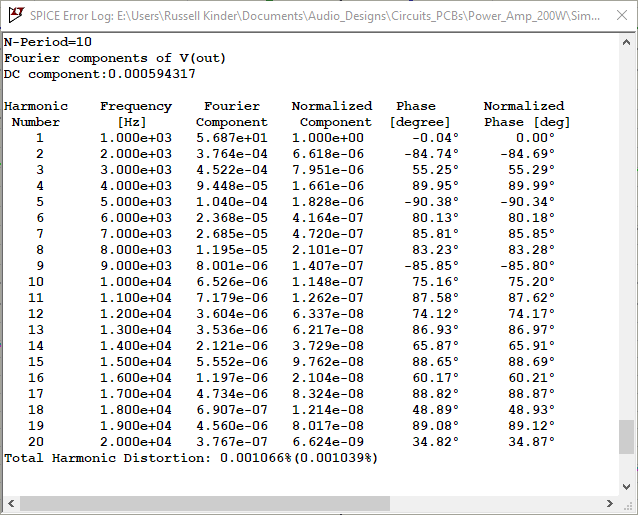

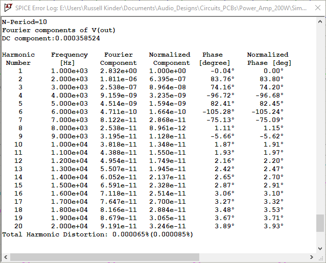

Attached is

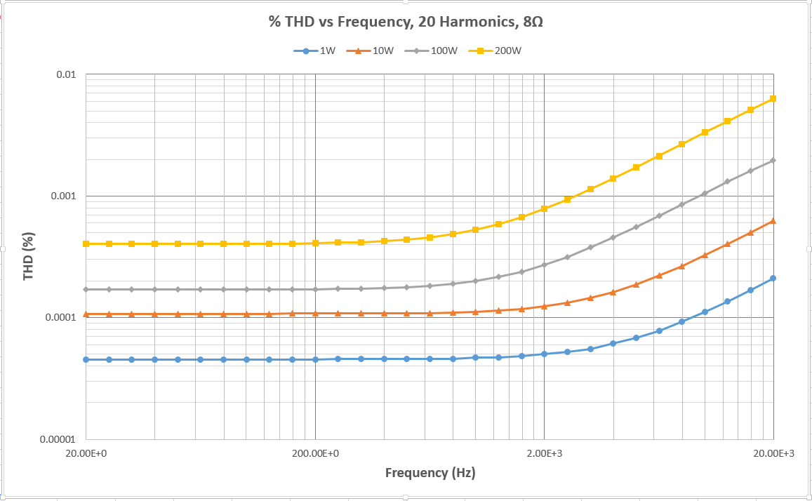

1) Picture of the closed loop test bench,
2) a plot of THD vs Freq for 1, 10, 100, and 200W, and

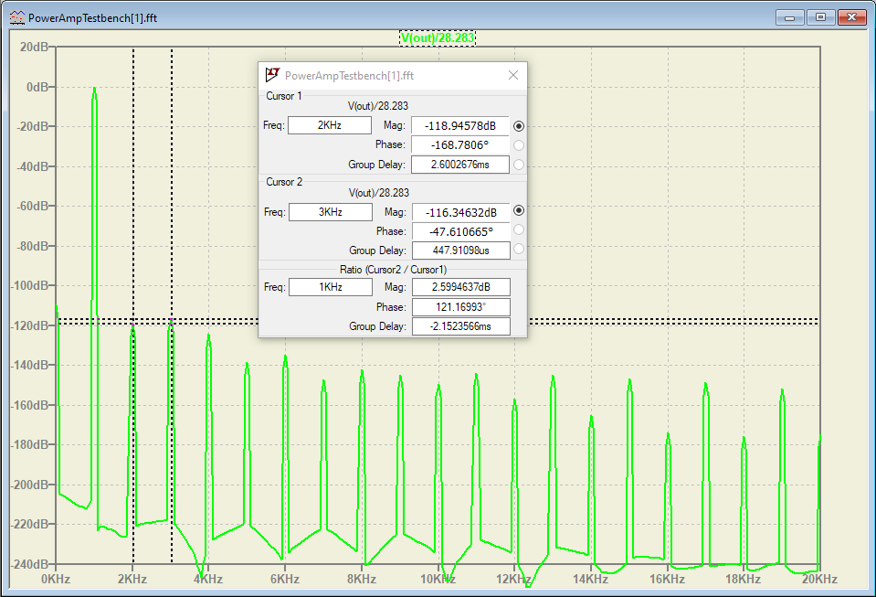

3) FFT at 1 kHz, 1W
4) FFT at 1 kHz, 100W
5) The .asc file of the testbench.
6) The netlist of the amplifier, in a .txt file.
The THD data shows that decreasing open loop gain above 600 Hz results in THD rising at 6dB/octave. The highest THD is 0.00633% at 200W, 20 kHz. I will see if Miller Input Compensation (MIC) or Transitional MIC will allow me to increase the loop gain at 20 kHz enough to get this number below 0.001%. That is the original design goal I stated in the first post of this thread.2) a plot of THD vs Freq for 1, 10, 100, and 200W, and

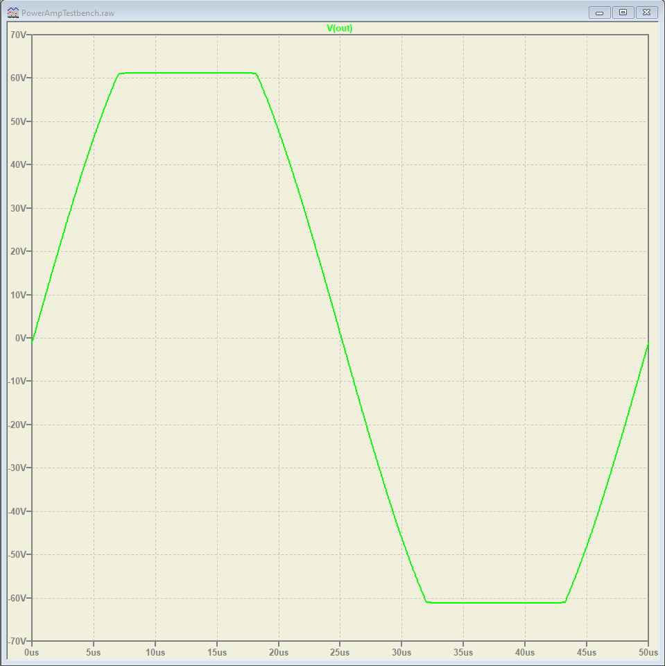

Clips of clipping
Hey, kids, guess what time it is? It's time to clip the amplifier.
I set a signal to clip at just over 10% THD. It's all graceful except for the squiggle at 45us. I investigated and found this problem is due to quasi-saturation of Q20, the KSA1220. I gave Q20 2 extra volts on its collector, and the problem disappeared. I'm using keantoken's models. Perhaps he will wander by and comment on it.
This is either an anomaly of the model, or I need to find an alternate device to the KSA1220. Comments welcome.
