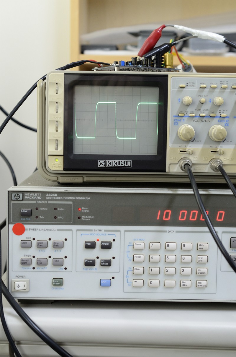

Okay, so that went really well...

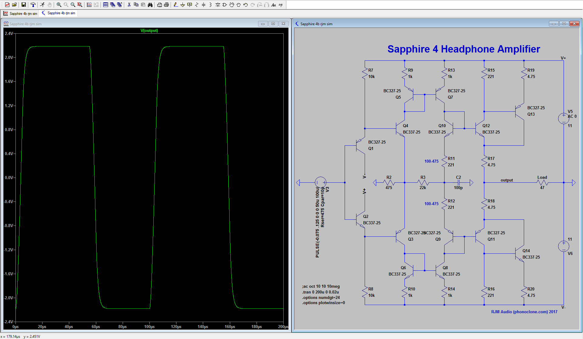

Bandwidth 125 kHz, 1.5 V rms output into 47 ohms. 10 kHz 2 V p-p output square wave passes cleanly, no sign of any kind of unpleasantness. Gain 26.6 dB, precisely as simulated.
(with C2 = 100 pF, R2 = 475 ohms, R3 = 22.1k. C2 is 100 pF C0G but I'll replace with 47 pF mica later, the smaller compensation cap as per the BOM should increase bandwidth to above 200 kHz)
aside: I checked and yes, the trim pot R6 is absolutely required
C2 can be removed to no ill effect. Bandwidth increases to about 500 kHz. Can output 0.5 W into 47 ohms ... the 1/4W test load resistor is piping hot but the heatsinks are still barely warm.

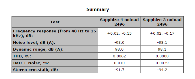

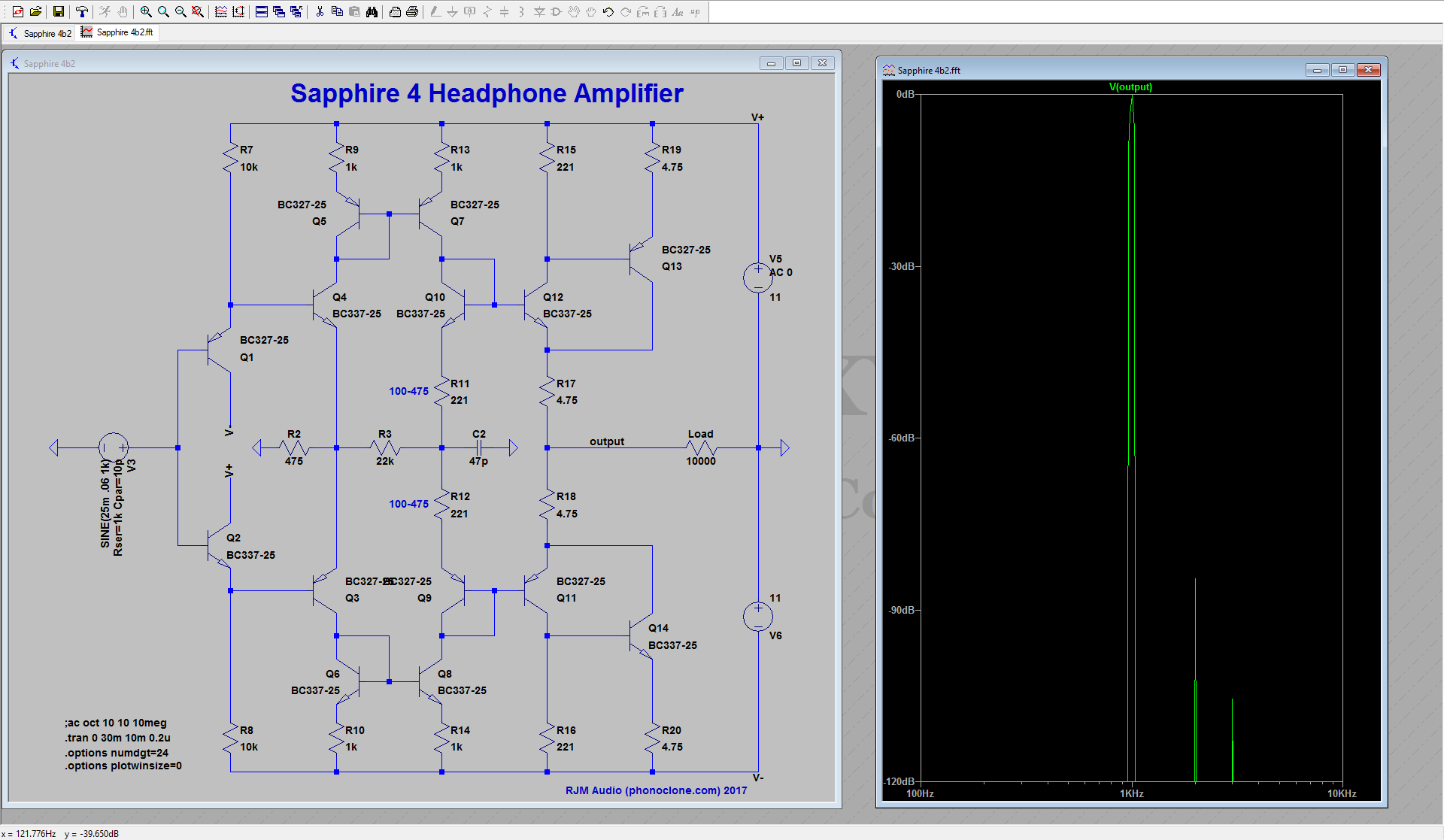

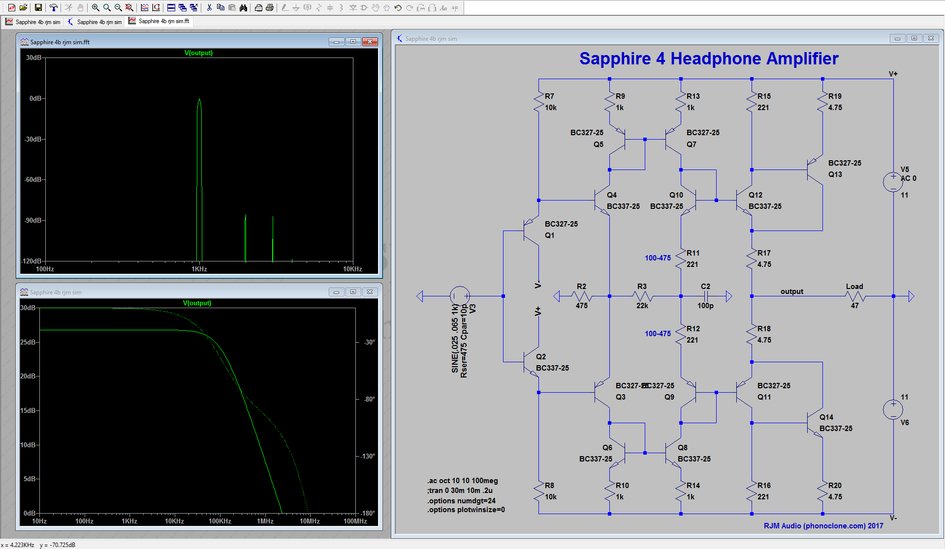

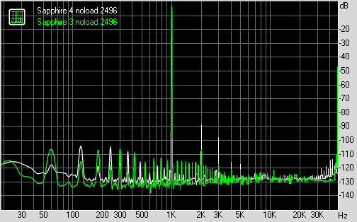

So obviously the thing that jumps out here is the THD, so lets deal with that:
It's what it is expected to be, based on the simulation. 2nd harmonic is -85~-90 dB, even unloaded. That's pretty decent, but not as good as a good op amp. My sapphire 3 sounds cleaner, the sapphire 4 sounds a little colored / warmish / fatter in comparison. Other than that there isn't much in it. The version 4 admirably keeps up in all other respects. As expected the HF rolloff is a tad steeper.
*note: ignore the comb-like patterns in the FFT, those are because the soundcard doesn't like the loopback connection with the Sapphire in/out. they are not present with the input unplugged from the PC.

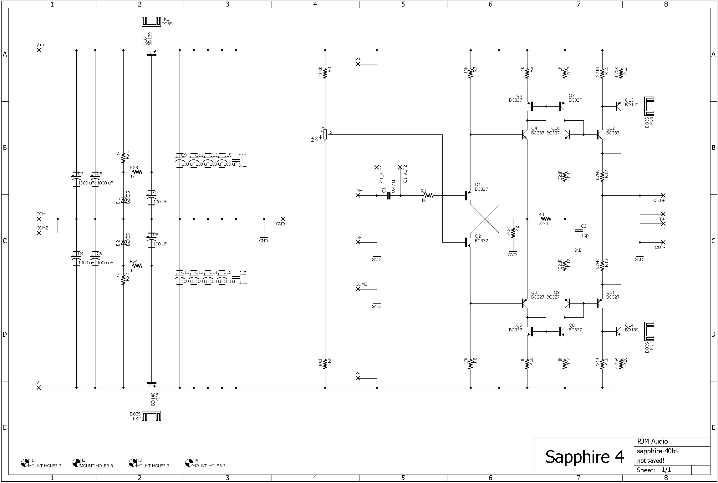

BOM 4.0b4
R6 trim resistor changed to 2k, and re-wrote part of the notes to explain the preamp configuration a little better.

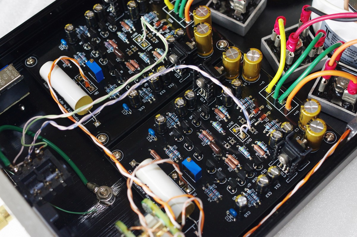

In the photo of your boards, I can see a variety of resistor types. Could this be part of what you’re hearing?
Interesting, but alas no: it's built with a mix of Vishay and KOA Speer, all metal film resistors.

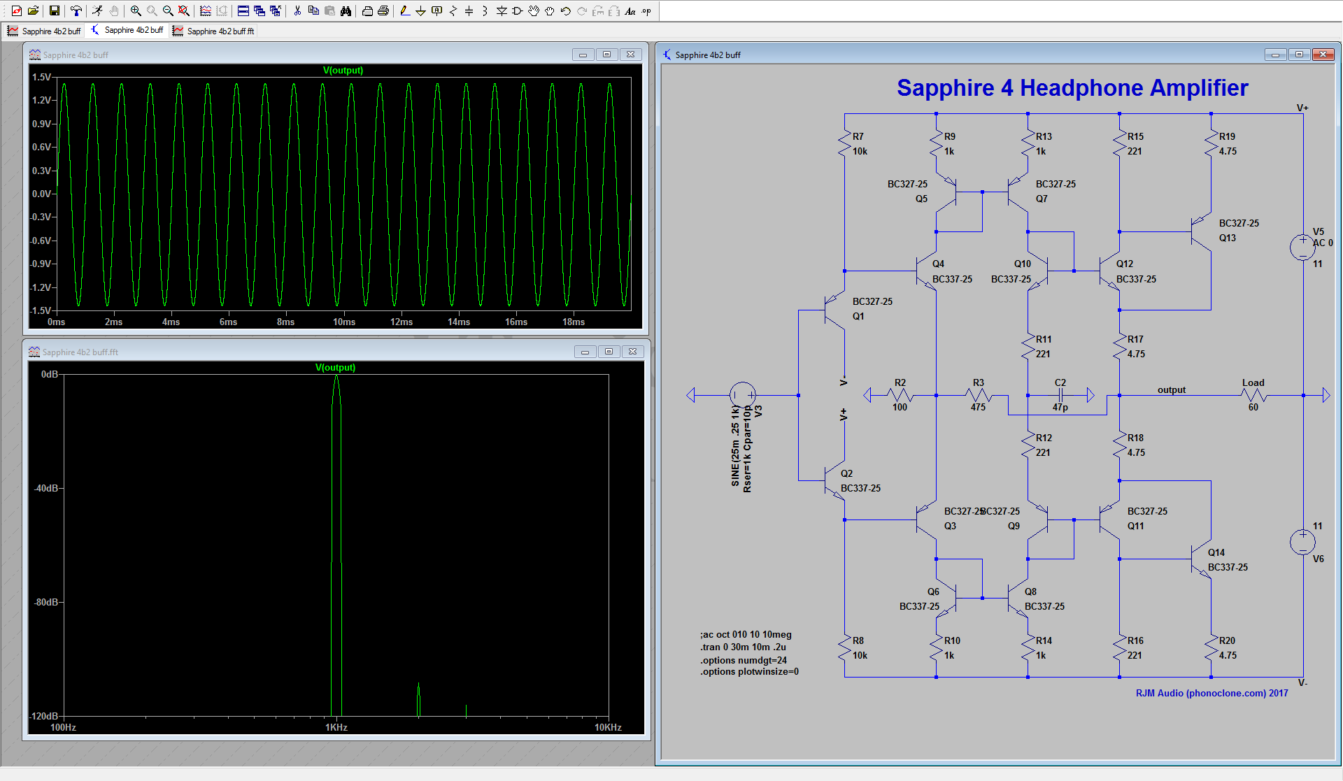

I spent a little effort in LTSpice to try and finesse the circuit values with the aim to lower the distortion.
What I found is what you'd expect: you can trade stability (phase margin) for lower distortion. This is done by keeping a high open loop gain (R2 = 475 ohms) while simultaneously dialing in a low closed loop gain (R3 = a low value). The harder you push this the more the circuit relies on the compensation capacitor C2 to maintain enough phase margin to stay stable. The upside is distortion becomes vanishingly small.
The values below show what is possible, at least in theory. -107 dB 2nd harmonic for 15 dB voltage gain, 0 dB output level.
Other than that, the other circuit values seem to be well optimized already.

BOM 4.0b5

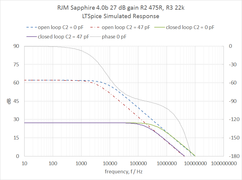

For R2=475 Ohms, the circuit should be stable without any capacitance in C2, at least for gains more than 6 dB.
Removing the capacitor increases the open loop gain at high frequencies, so there is more feedback applied, and less distortion. For my configuration with R3 = 22k it amounts to about 8 dB more feedback applied for audio frequencies above 10k. Since there was only 15-20 dB applied in that region to start with, that's a pretty significant increase.
I tried removing the 47 pF mica cap I was using and, wow, "now we're cooking with gas!" The treble really lights up and the bottom end starts to pack some serious wallop too. The amp throws off it's previous lethargy and wakes up, in other words.
So, C2 is dropped as a required component from the BOM. It should not be needed for any of the suggested R2/R3 combinations.

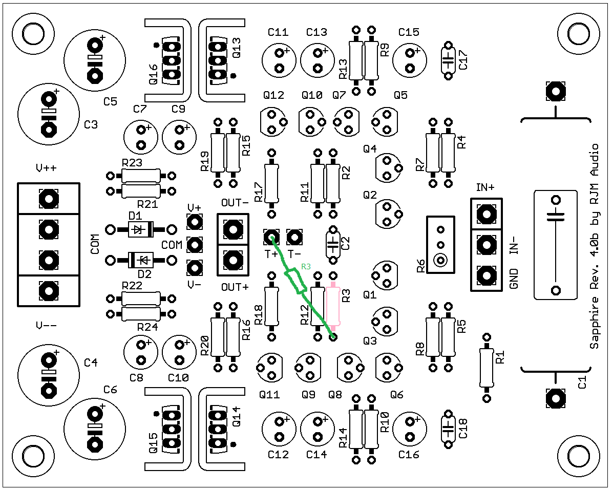

Continuing on from yesterday's post, about the values of R2 and R3 and where I said there were limits on how small they can be because the current sources were only set to 1 mA...
Well, there's a way to get around that, and that's to power the feedback loop from the output of the buffer rather than the internal current sources Q5-8.
It's interesting, normally we think that wrapping the feedback loop around the output stage reduces the distortion of the output stage, but here at least that's not what is happening at all. The buffer provides drive to R2 and R3, so more open loop gain can be dialed in, more feedback applied, and lower distortion obtained.
It's a simple modification. One end of R3 is disconnected taken to the T+ pad on the board instead.
Oh, the shiny attractiveness of global feedback! Such sweet benefit for no downside!
And everyone knows how that story ends.
First the circuit is now reliant on C2 for stability.
Second, the feedback now has to deal with the inductance and capacitance of the headphone cable and drive units.
Third, as a consequence generally of more applied feedback and higher bandwidths, the circuit will be more susceptible to the "unsimulatables" such as parasitic capacitance.
Still, it's an interesting avenue for experiment, which, evil genius that I am, is provided for with the existing board layout.
Probably should get in touch with me to discuss before going ahead with it though. I can give you some suggestions and guidelines at least.

I'll try it. Reminds me of a resistor on the backside of Sapphire 2, but I'd have to go back and see what that was all about.
Shall I do this as a later mod, or start with it?
