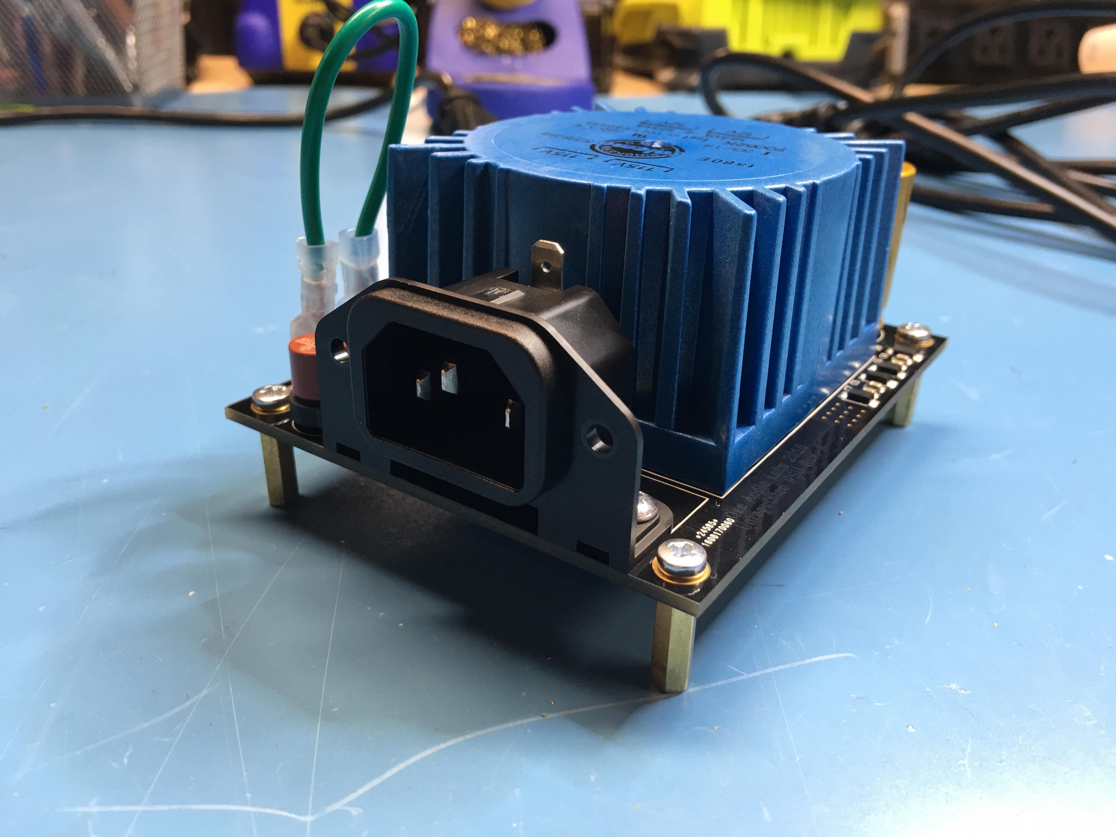

I would counsel against putting the IEC jack on the board like that if the boards are to be fixed to the bottom plate of the chassis rather than the back panel. As it is now, the back cutout must be perfectly aligned or you'll have to shim the standoffs. Not fun.
I don't feel there is particular need for additional filter capacitance on the power supply board like that, but it is up to you if you want to include it.
Surface mount diodes are fine is someone else is installing them, but I think through hole would be a better choice for diy.

rjm, thanks for the feedback!
I luckily have access to a CNC machine I'll be using to for the rear panel cutouts, so hopefully alignment won't be an issue. Also, I just built a reflow oven, so I'm using this as a chance to give SMDs a try.
I've added the extra filter caps because this will be powering an additional circuit per channel, a relay switched passive attenuator when I get time to design it.

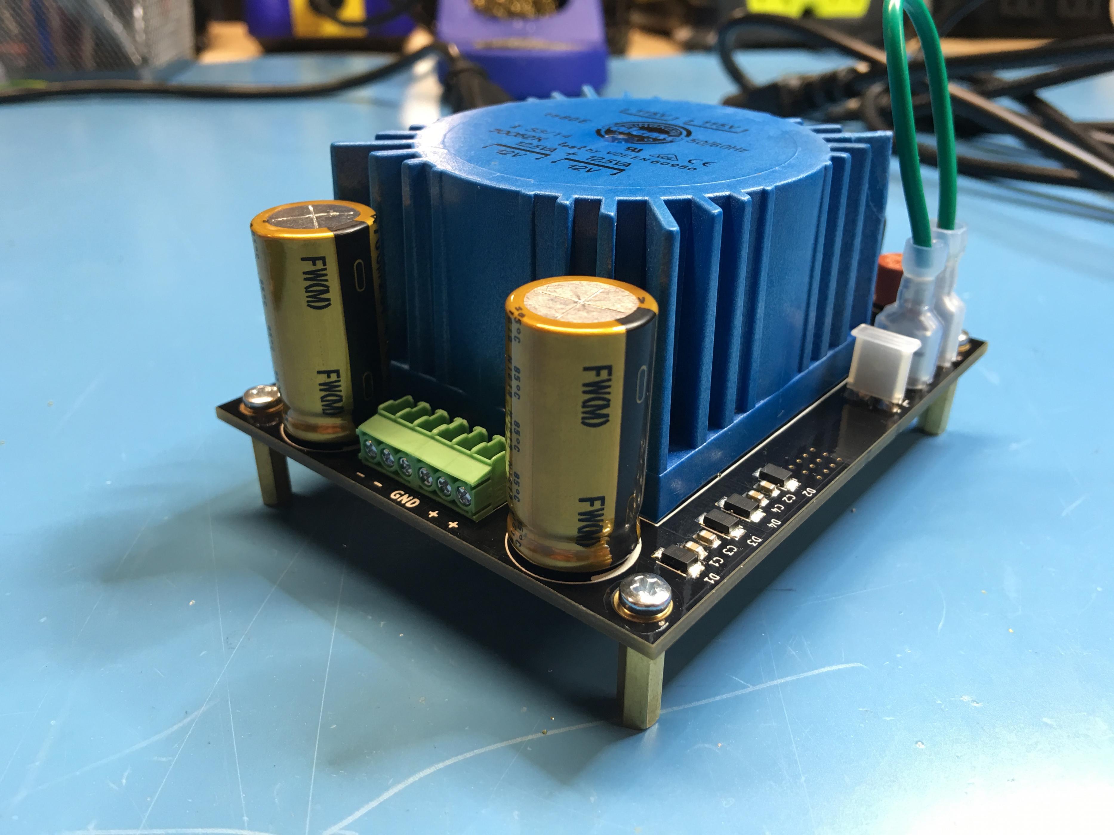

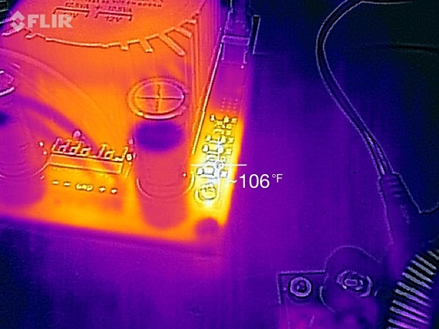

Meanwhile, my PSU PCBs arrived and the initial build looks promising! I ran it for a while with a 1A load @ 15V and nothing melted on me!
Neat!
(Not surprising your SMT diodes started to heat up, but for the application this will not be a concern.)

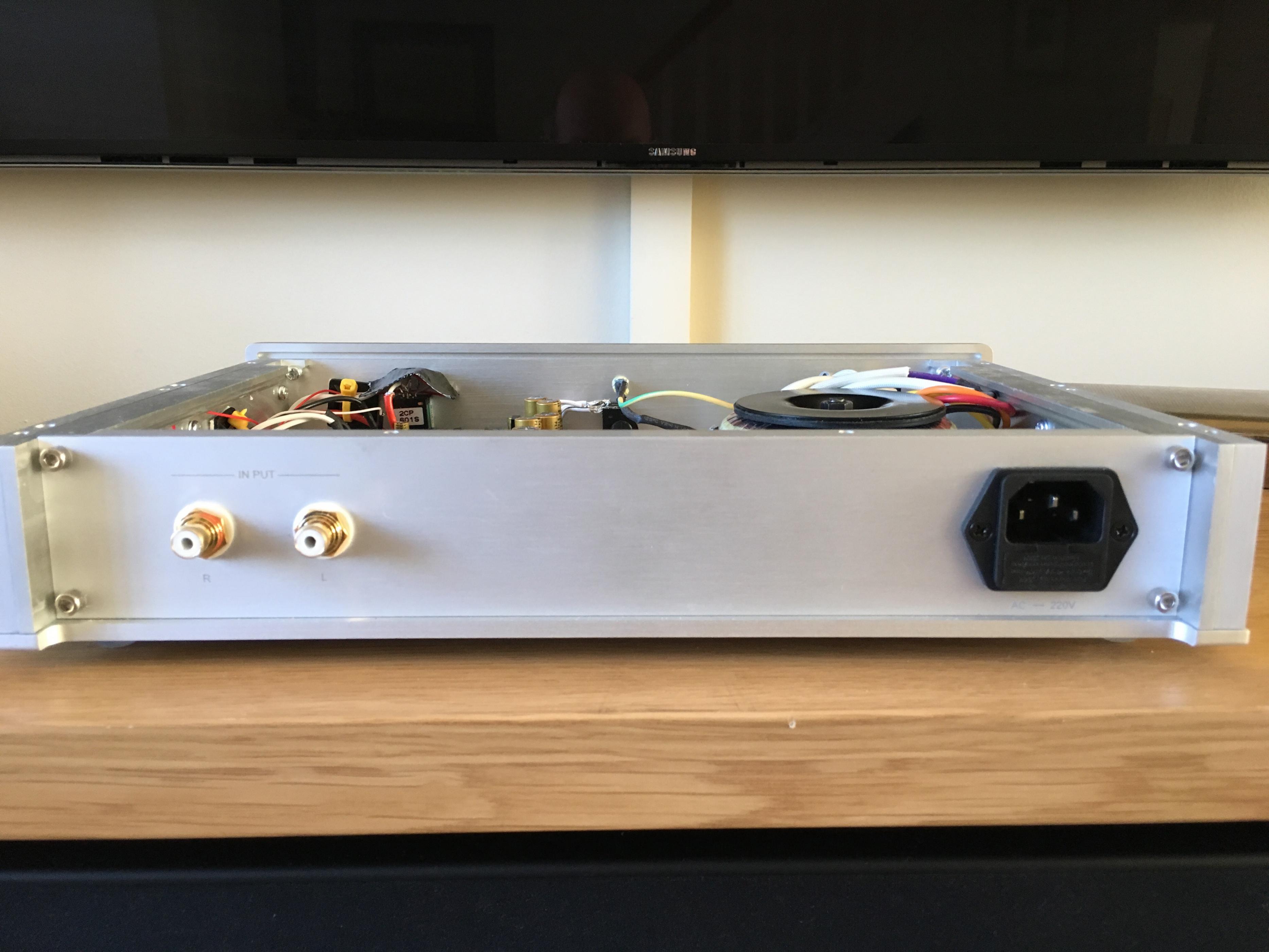

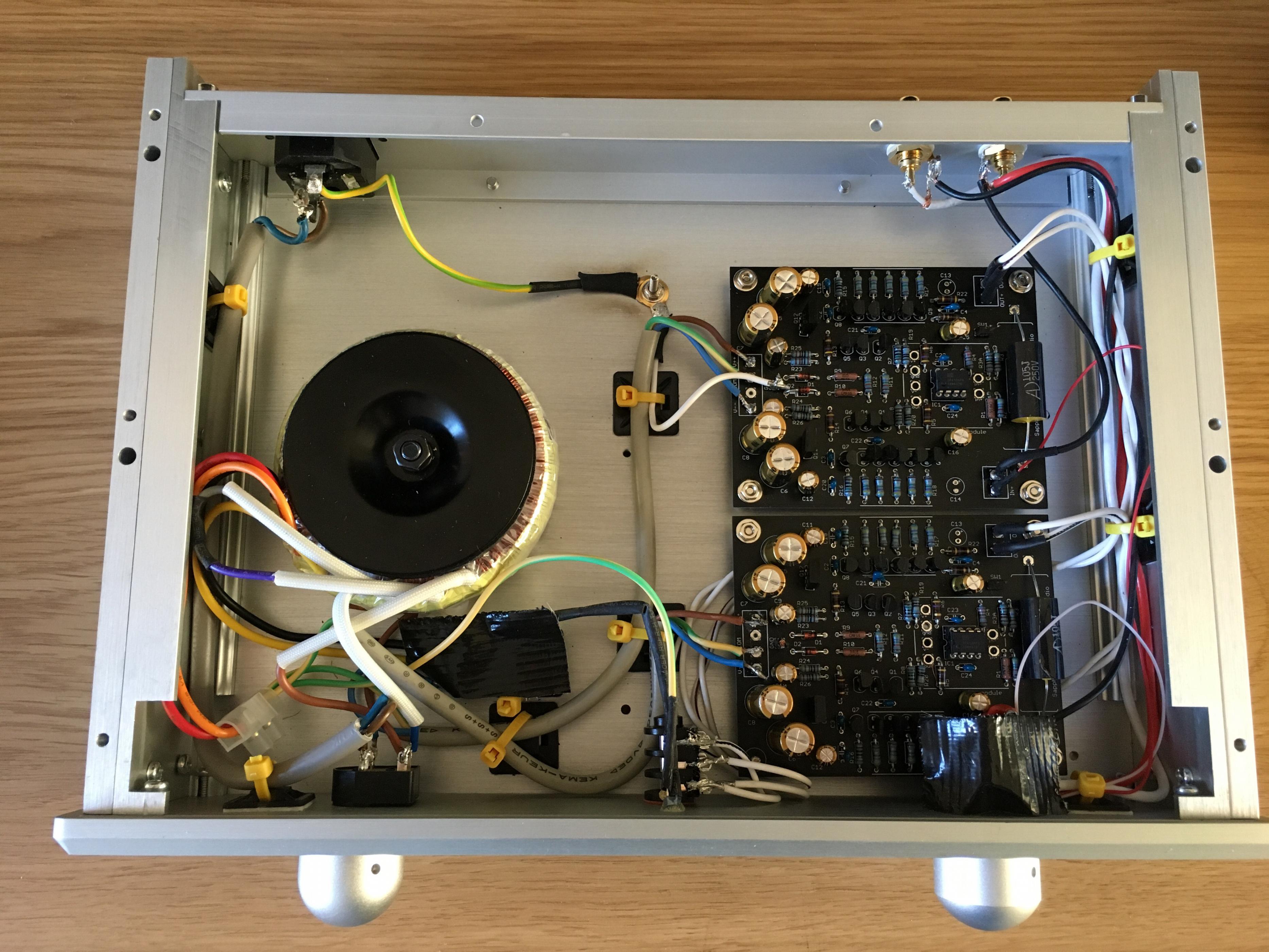

Just wanted to thank Richard for a great kit and fantastic email support (I had soldered Q2 on one of the boards back to front - doh!). I haven't done a great deal of listening yet, but first impressions are very good, nice dynamic sound, plenty of depth and space through my Grado SR80's.
The case is from ebay: Aluminum Chassis Amplifier Enclosure Preamp Case Headphone Cabinet DAC box | eBay

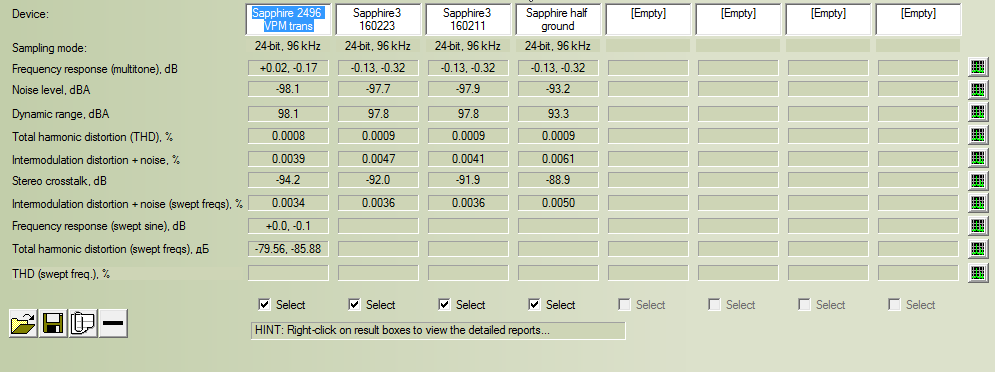

Today I replaced the power transformers on my Sapphire 31n with Triad VPM 24-1040 medical grade toroids.
These are 25 VA models, and note they were a very tight squeeze into my existing case. If I was doing it again, I would plan on not going dual mono on the power supply.
The reason for the upgrade is 1) the electrostatic screen and built in magnetic shield, which the regular Triad models don't have, and 2) the dedicated 100 VAC taps on the primary for Japan line voltage.
I got them at Mouser, but Digikey also stocks them.
I don't feel they made a huge difference, honestly, compared to my permalloy wrapped standard Triad models, but according to RMAA I've gained a dB here, a dB there.
Considering the cost of buying your own permalloy sheets, the VPM are something of a bargain and I'd definitely recommend them.

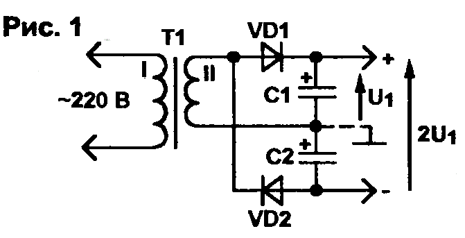

Two transformers 15W (2х12V, 0.55A) will be enough?
Can I use a single transformer 40W (2x12V, 1.5A) and rectifier circuit in the picture?

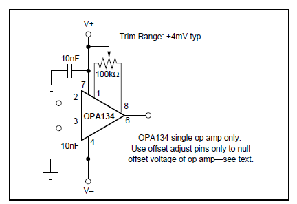

OPA134PA has Offset Trim. This adjustment will work?
