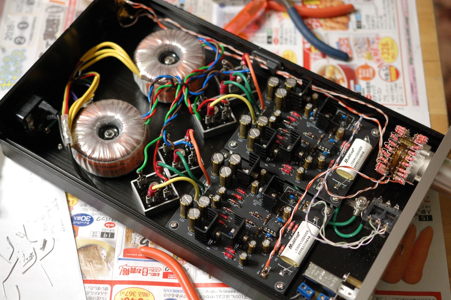

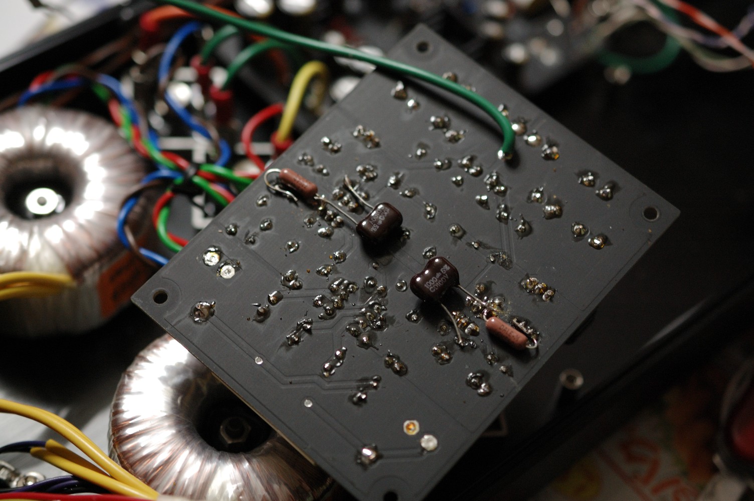

Hi again!
I took photos of the new make-up process. I'm still solving problems with the diy discrete opamps; after this, I will change the condensators, maybe a pair or Jupiter HT could be a good option (I have a pair in my Icon HP8 with very good results)
I took it to a friends meeting in Madrid and the amp enjoyed a lot
¡Take a look at the photos! :-D

Thanks both of you
Rjm, point 2: Of course; the problem is that my lvl of english language is very poor, and the technical terms that I perfectly handle in Spanish I can't tell you in a right english translation, but I will try
The people comments are:
Sapphire (with paper in oil russian nos condensators and default opa134), it's a powerfull amp, with enough "balls" for move VERY well the HE-500, LCD2 / 3 and HD800 for example.
It can move the (really hard to move) Hifiman HE-6, but not with the same bass and tonal control as Beta22.
Anyway, it's a very versatile amp, clear and transparent with a slight warm touch.
Another adjetive is fast; very good dinamic represantation (fast drums, rythm changes...)
For me, Sapphire was a great discovery. I enjoyed too much mainly with Senn HD800
Ok, it's not a Beta22 (probably the best dymanic headphone amp) but, Saphhire cost MUCH less...
For the price, there's no opponent , it can beat in sound quality vs. Burson amps and company...
If the amp grows up with better condensators and better ap-amps... it will be the awesome

repente, I use the Sapphire as the main driver for my HE-6. In my case, I replaced R4 with a 33k ohm resistor. The gain is just about perfect, with my volume pot just passed 9 o'clock. (I tried a 66k ohm resistor, too, but the gain was just too high.)
I've never hear the Beta22, so I can't compare the two, though!
You can read about Amb's beta22 amp here. I haven't heard it either, but from the schematic it looks pretty cool.
As for improving the Sapphire, the hard part, and why I was asking repente about the impressions, is figuring out what's wrong with it. I'm very happy with the way it is. If anything I suppose I could wish for a little more "mellowness", as I agree that the dominant impression is of power/control/clarity rather than warmth. How one might obtain a more relaxed sound that without making the amp worse is, however, not immediately obvious to me.

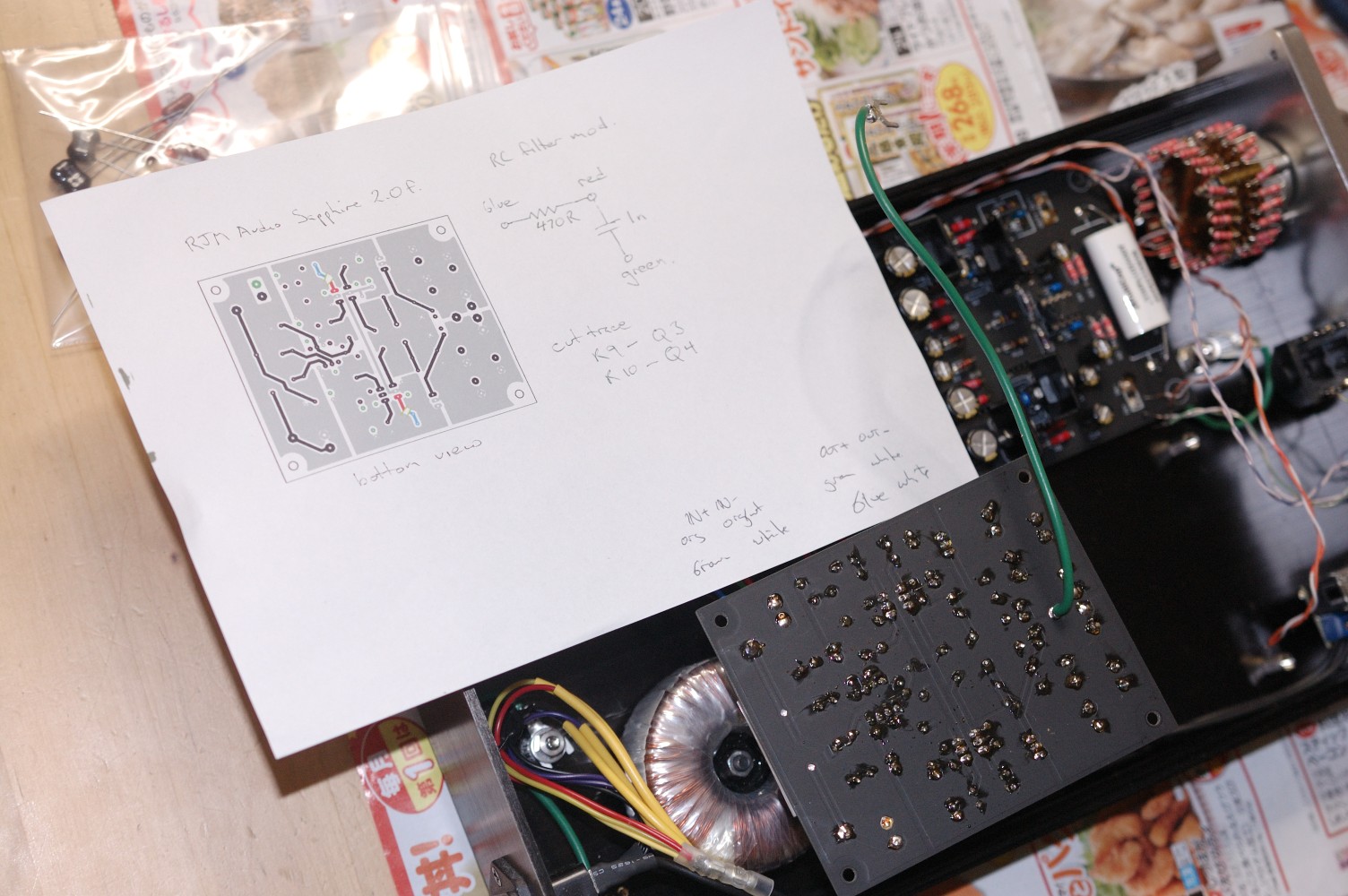

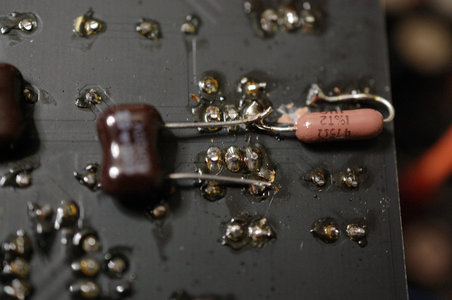

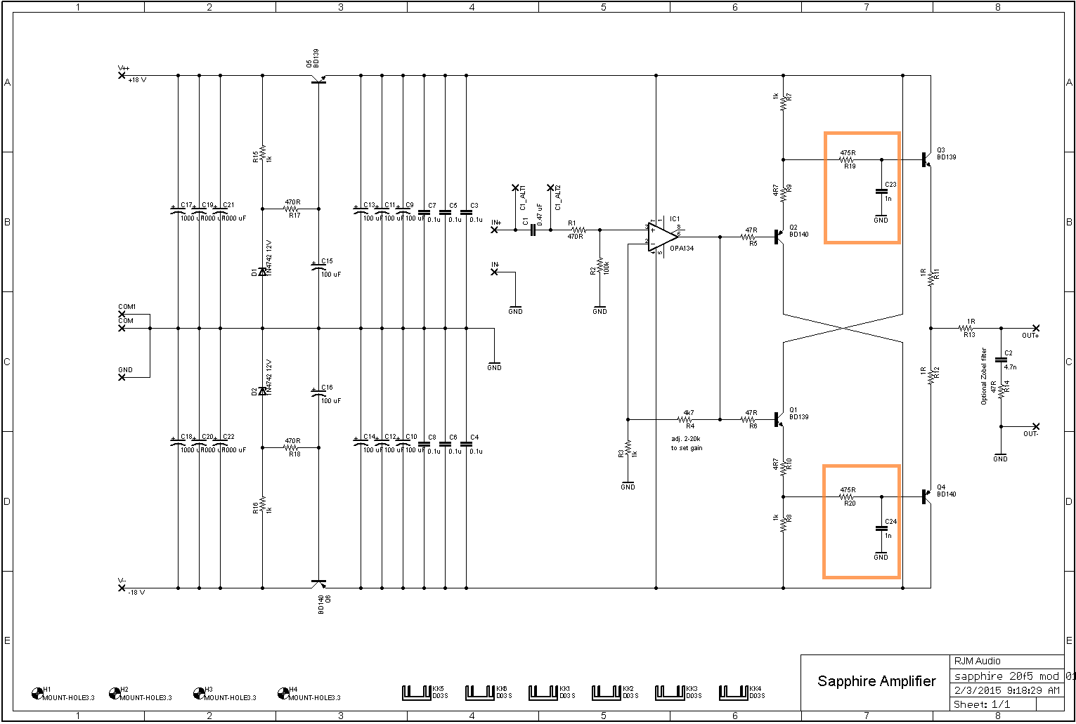

Lately I've been wondering if some soft of damping was needed in the Sapphire circuit between the driver and output transistors of the diamond buffer.
I added an RC filter stage (475R 1nF low pass) before the output transistors limiting the buffer bandwidth to 335 kHz.
The voltage drop across the resistor lowers the bias current in the output stage. I hadn't planned for that, and the side effect of considerably less class A output power is unwanted. In future this will have to be compensated for by adjusting R9, R10.
The effect of the RC filters on the sound is surprisingly large, and not a result of the change in bias current (I already confirmed independently what low bias current sounds like.) It really does seem to take the "edge" off things. I think I may have overshot it a little, and a smaller filter or perhaps just damper resistors alone might give the best balance - but the interesting thing is that the position does really seem to be a "pain point" for the circuit, so its worth looking into it in some depth.
Adjustment to R9,R10 can be calculated easily enough, assuming the base of the output transistor draws about 0.06 mA, and the emitter of the driver pair sources 10 mA.
R9 should increase about 1 ohm for every 133 ohms of resistance added before the base of the output transistors.

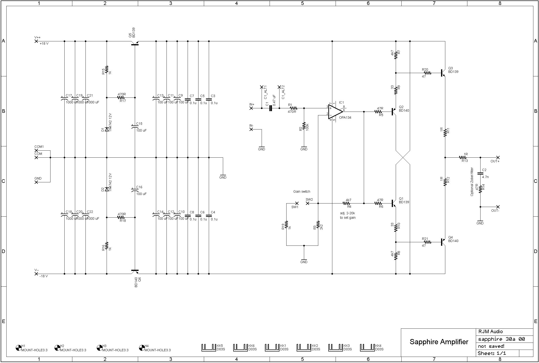

Sapphire 3.0
I'm starting to ramp up things towards the next spin.
Upcoming features being considered:
1. Gain switch, optional, configurable, hi/lo.
2. Current sources on the driver emitters.
3. Better optimization of the bias current ratios.
4. A well-defined, resistor-programmable output bias current.
5. Some sort of damping between driver and output stages - the exact circuit is currently under evaluation.

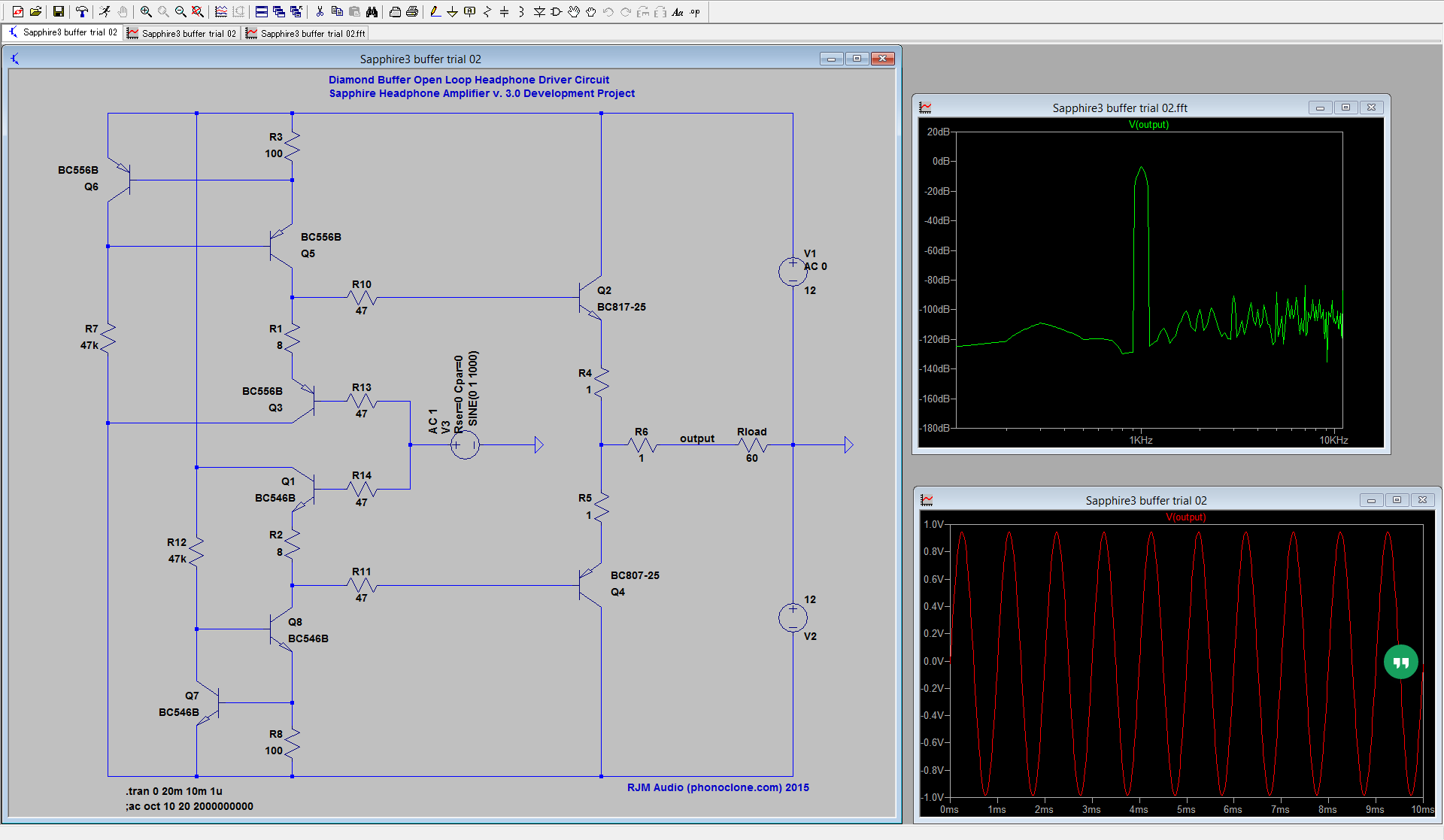

A word or two about bias currents.
The diamond buffer is a sequence of two emitter followers, the driver and the output. Both have minimum h_FE current gains of 100. (BD135/6)
The output drives headphones, the "design maximum" output current into the headphone load is about 50 mA. So the output base needs 0.5 mA, provided by the driver. The driver runs in class A, so the standing bias has to be slightly in excess of this value, say 1 mA minimum, to avoid clipping. 2-3 mA is a reasonable headroom. In my rev. 2 version, it was 9-10 mA.
In terms of impedances, 30 ohm headphones translates into an output driver input impedance of (30xh_FE) 3 kohms. The driver stage emitter resistor (R7,R8) was 1 k in rev.2, a substantive load, for a total of 750 ohms, translating to an input impedance of the buffer of (750xh_FE /2) 37.5 kohms.
It's ok, but the circuit is working unnecessarily hard to put a large current through the driver transistors. This lowers PSRR and increases distortion, as well as lowering the input impedance. The solution is to replace the 1k emitter resistors with a) a larger value or b) a current source.
A current source would allow a large current AND a large impedance, at the expense of noise and complex distortions. A larger resistor means lower bias currents, unless the driver stage power rails are increased of course. I haven't fully committed to one or the other solution yet.
As the input impedance of the output transistors is not especially high (particularly with low impedance headphones) its probably not a good idea to put large resistors in from of the base. A maximum of about 220 ohms seems reasonable. The small "boost" resistors on the driver emitters (R9,R10) need to be included in this total. They are 4.7 ohms in rev. 2, they could be made significantly larger with no real detriment to the performance.
In the schematic below I've made some tentative changes, adding the switchable gain feature, reducing the driver bias currents, and adding small resistors to the base of the output transistors. I haven't replaced the driver stage emitter resistors with current sources yet.
