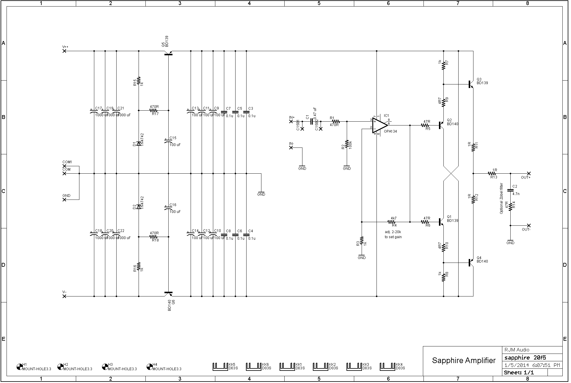

Hi Richard, if I want to increase gain in Rev14, can I just parallel R8 to reduce the value instead of changing R8. its much easier. Is there any particular reason for selecting the value of R7 to be 4.7k in the first place, why not 5k? (// R8 1k with 4k = 800R, so 4.7k/800R +1 = 6.875)
In the old version of the circuit the gain is set as R7/R8+1 i.e. 1/4.7+1=~6 There's a number of factors which influence the resistance values you'd want to pick, but as long as you keep R8 between 500-1500 ohms, and R7 say 3k~30k you won't run into any problems.
The actual BOM values are chosen to 1. give the optimum gain with the widest range of headphones and 2. nominally balance the input impedances at audio frequencies. 3. keep the total resistance of the feedback loop above 5 k or so to avoid loading the op amp.

Yep. The input section is optimized for impedance balance of the inputs at audio frequencies rather than for DC.
To clarify the issue of volume control impedance, 10k, 20k or 50k won't make much of a difference to anything and there is no need to adjust the resistance values to compensate.
If anyone is interested, the input stage assumes the typical impedance of the volume potentiometer as seen from the op amp is 500 ohms. That calculation was based on my 50k Takman stepped attenuator and my normal listening level. The instructions call for a 20-50k value. That specification is a usual compromise between too large (noisy, distortion) and too small (excess loading of the input signal).

By the way with 600 ohm headphones you should probably increase the gain a fair bit more. I have mine set to 20x (26 dB) with 300 ohm HD600s. For 600 ohms I'd increase the feedback resistor to 33k approx.

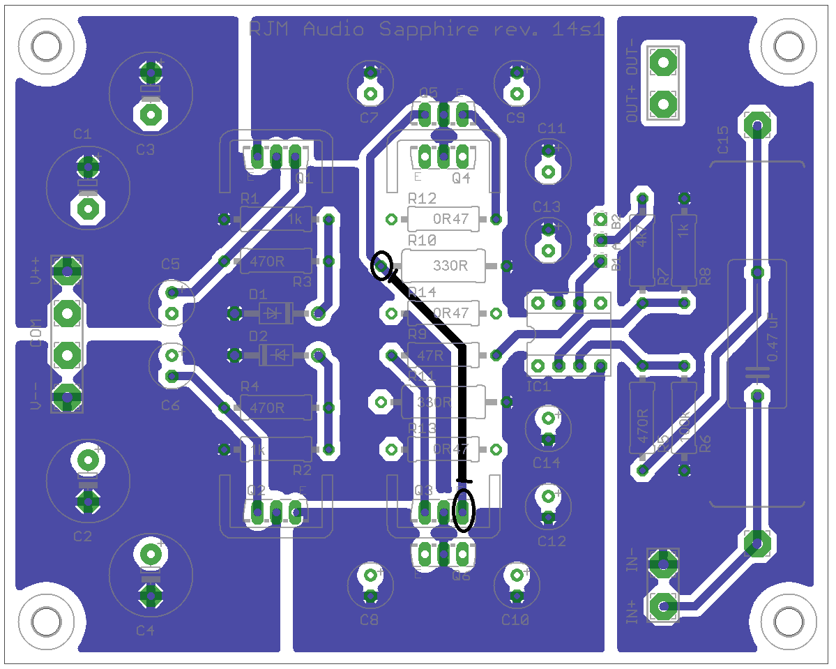

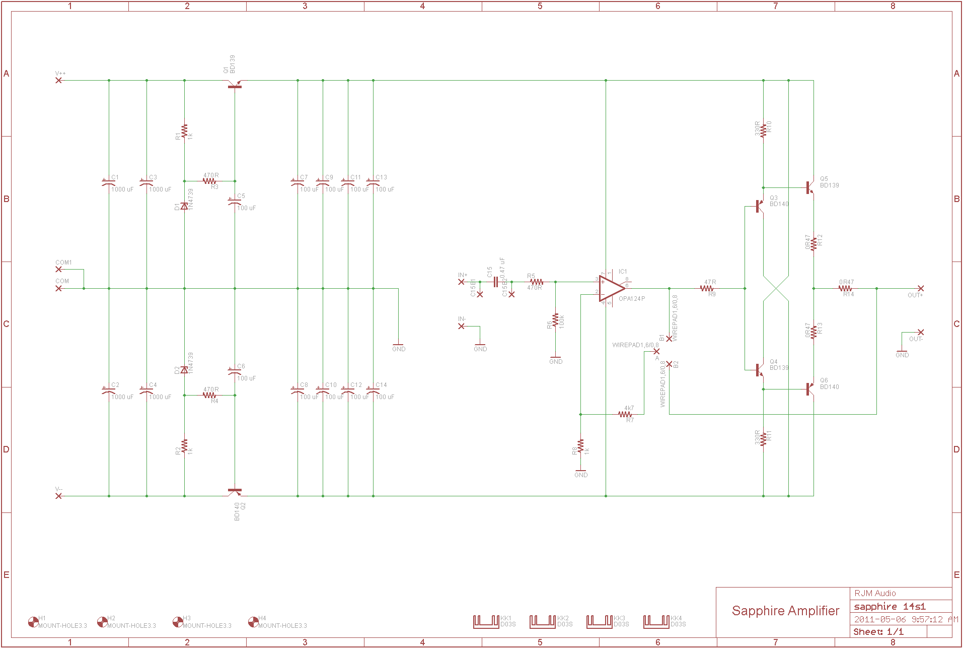

While the 14s1 boards can be modified, it is not trivial: you'd have to cut traces on both the top and bottom of the boards, and wire resistors between pads to connect over the cut traces. If you are up for it I can show you what and where.
Red is the top trace, blue is the bottom. X-ray view.
Black traces between Q3 and R10, and Q4 and R11, must be cut, and 1 ohm resistors to bridge the cut trace, connected to the pads marked in black circles.
Increase R10,11 from 330 ohms to 1 kohm.
/R
/R
Good luck. Remember that the voltage across R13 and R14 tells you the bias current, as I = V/R. If should be about 30 mA for best results, and you can adjust by changing the value of the resistors you add over the cut traces.
Which should be about 4.7 ohms, I realized, not 1 ohm as I wrote above. Sorry about that! (you are adding R9, R10 from the rev 2.0 schematic, below)

R11, R12 are 0,47 Ohms in 1.4s1 rev.
Is it better to raise their value to 1 Ohm, as in 2.0 rev. ?
Frank
Frank
Good question. It tells me you are serious about this...
I do not know what the ideal value for the emitter resistors is, for a given bias current. The general rule for (power) amplifiers is 0.47 ohms for 30 mA. I doubt there is a material difference between 1 ohm and 0.47 ohm, but it does influence the bias current. So if you stick with 0.47 ohms, you might find the bias current is a little higher than 30 mA when you use 4.7 ohms for the bias trim resistors (R9,10 rev 2). Maybe lowering the trim resistors to 3.3 ohms or 3.9 ohms would be better in that case.
