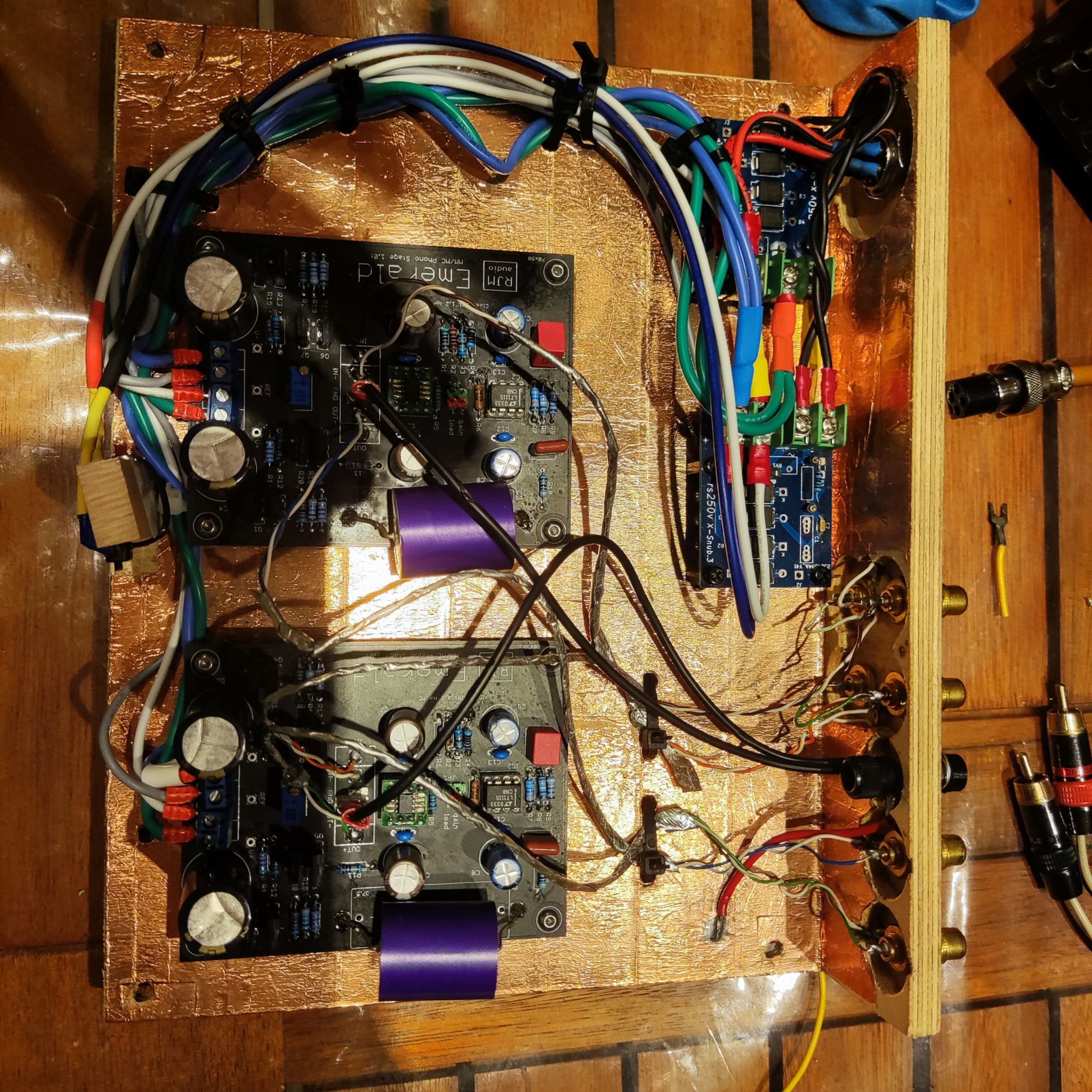

hi all guys, and thanks Richard for this creation, i couldn't be happier with the sound of my emerald.
i just bought an used one and it's pretty sounding but i have an issue, there is some background noise like electrical noise that becomes very naggy on the second half of the volume of my amplifier.
i already tried to remove the earth and it's not disappearing, it disappears only when i plug in the second RCA input rca jacks with loads (100 or 300 it's the same, it disappear).
all the tests were done with the turntable disconnected so the noise is coming from the emerald.
my problem is that my turntable have a MM head so i don't need any load on the second RCA and for the same reason jumpers are all open, i'm attaching some photo in order to help understand you.
my idea to solve is to try to put some jacks with a dummy load like the lower i can find, could this work for you?
sorry for my bad english and my bad explanation but it's not my mother tongue and i'm not so skilled in electric

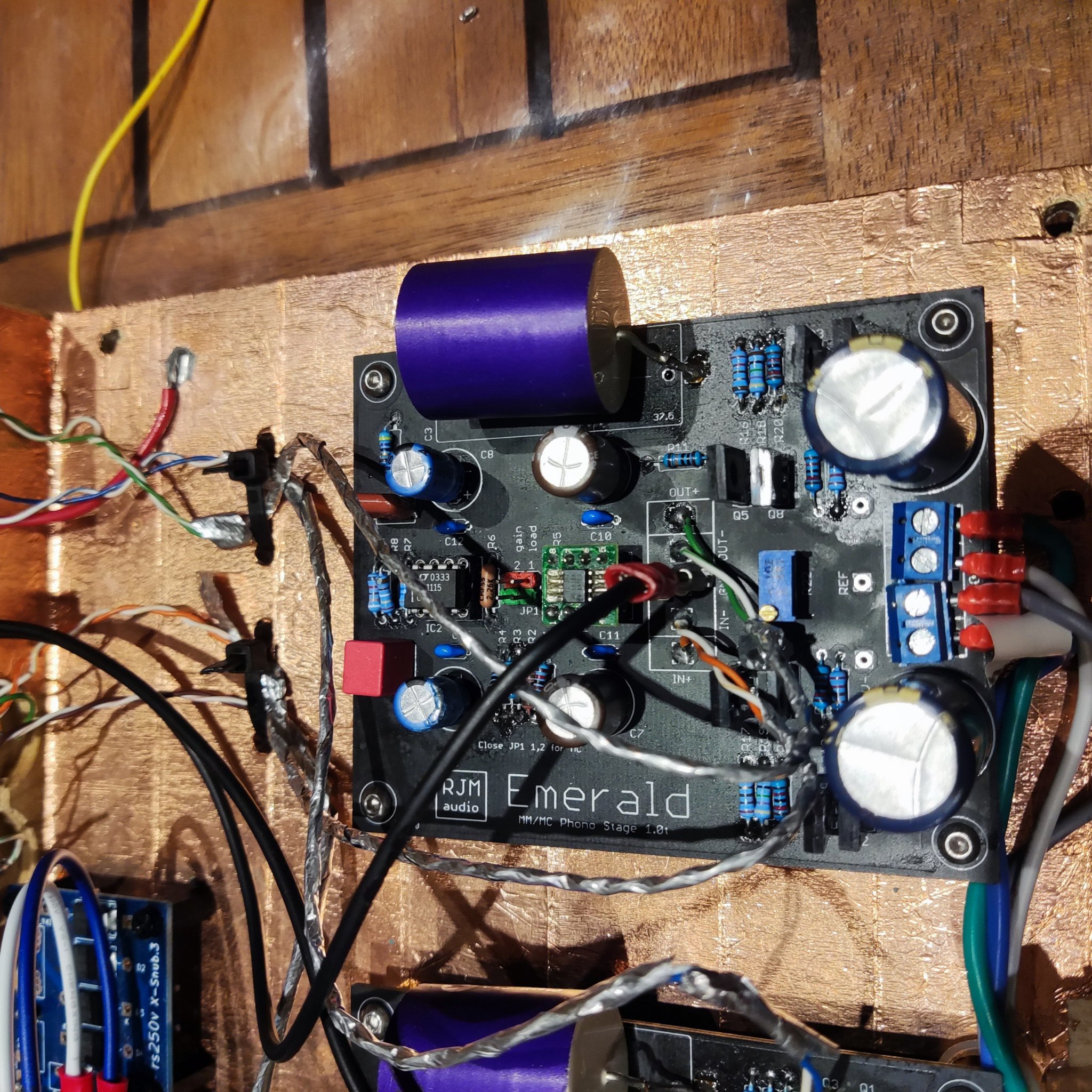

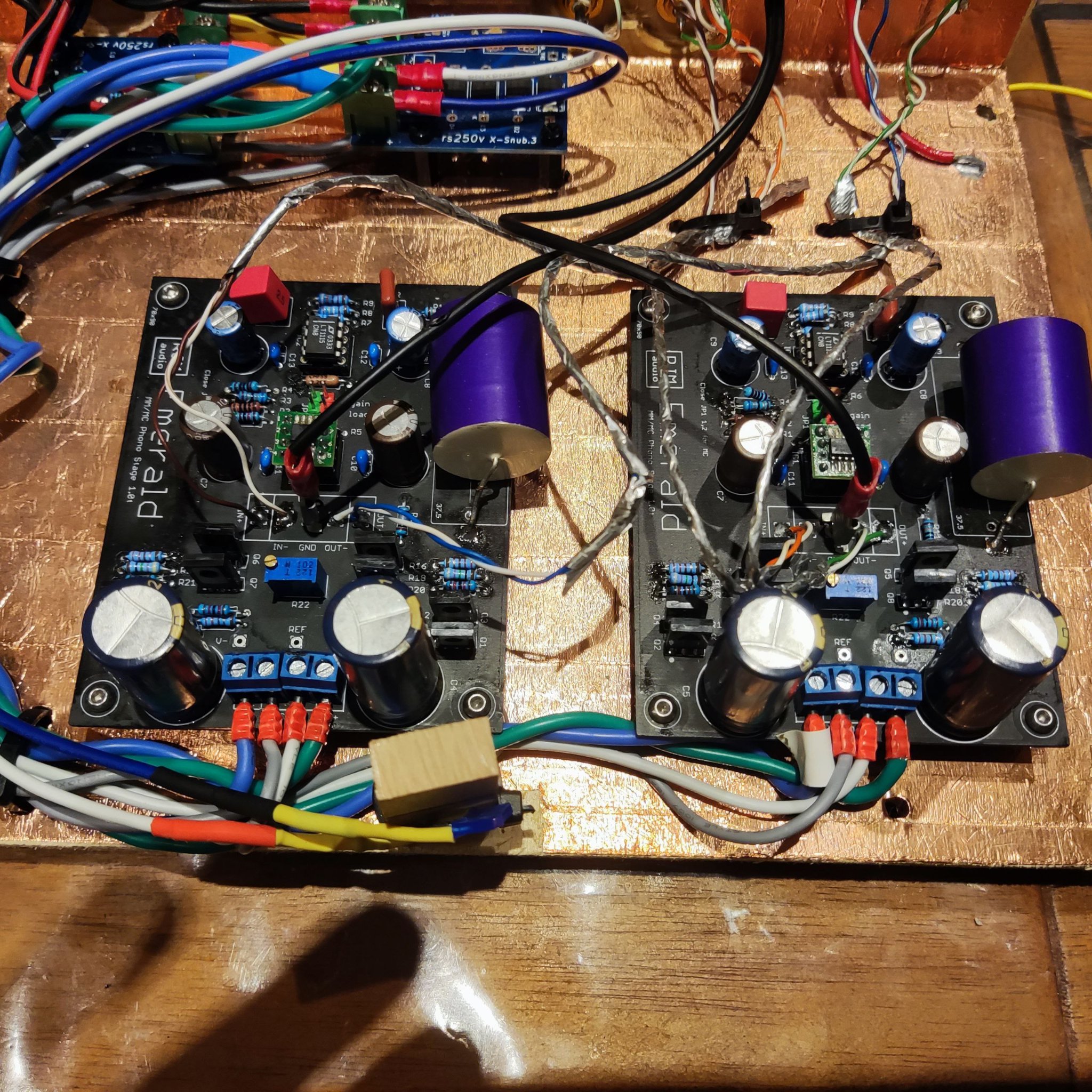

That Emerald you obtained looks rather messy, and the less said about the soldering quality the better, but I think it is working properly.
The noise will be high if the inputs are left open circuit. You have to leave the cartridge connected, or use a dummy load <1 kohms for testing.
The noise will also be audible if you turn the system volume all the way up past the normal listening level.

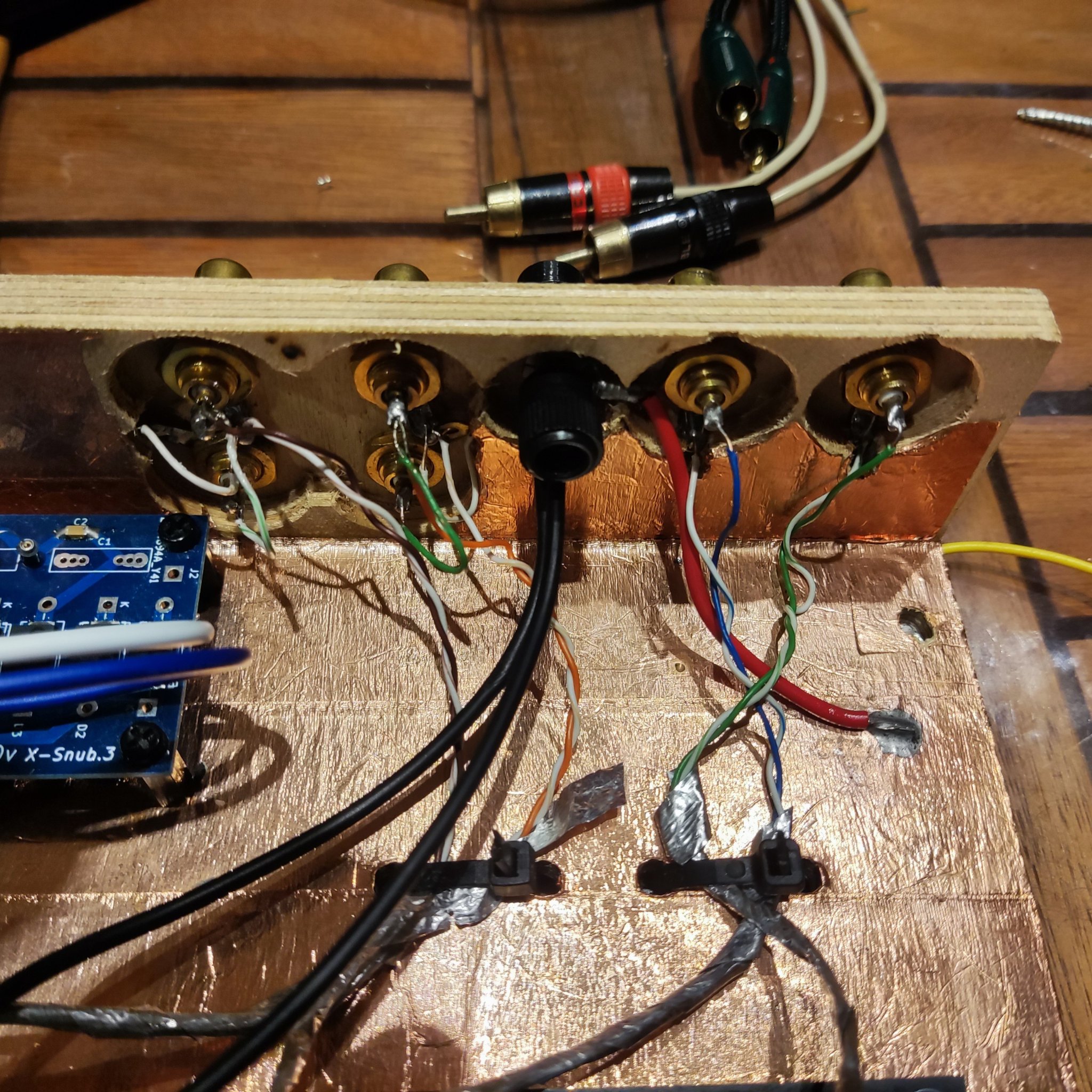

The chassis is wood but lined with metal foil and connected to the circuit common, so that's fine.
Note the previous owner has customized the op amp selection, TL1115 on IC1, some SOIC I can't ID on IC2.
If it sounds fine at normal listening levels, I'd be inclined not to touch it.

Hi Richard and thanks for your answer, let me clarify some points
-If I test the emerald without turntable connected it's silent, if I connect it it start nosing even with turntable plugged off from electricity, but If I use 100 ohm resistance it remains silent, given the fact my turntable is MM cartridge have I to use a dummy load 1kohm together the std input to keep it silent?
-rear wood panel is not tin foiled, does this matters ?
-are there some contraindications to keep gain jumper on with mm cartridges ?

Is the noise hum or more like static?
If it is silent with the 100 ohm input load, but noisy (hum?) with the cartridge plugged in but the turntable turned off, that narrows it down a lot.
1. The cable used to connect the cartridge to the Emerald is picking up noise
2. The grounding arrangement in the Emerald generates a ground loop connected to the ground plane of the turntable
One thing to check, with the dummy load in place, connect a cable from the right input ground to the left input ground at the RCA jacks. If that doesn't change the noise, then try lifting the ground of the turntable, if it has one. You also need to connect a ground wire from the Emerald to the Turntable of course.
Sometimes this problem can be sources to an improperly wired tonearm, but that's a rare case.

The noise is like a rustle, about your points above
1 it's what I supposed but if I connect turntable directly to the amplifier no noise
2 I tried to disconnect all the grounds and noise increase so I guess it's not a ground loop

Could be a bad solder joint...or by the looks maybe a good cleaning of the boards. (but that could be the photo ?)
You say 'not so skilled in electric', how good are you with solder ?
Some flux and a re-heat of the worst solder joints could help.
Connecting the turntable directly to the amplifier... do the amplifier have a dedicated phono input ?
(I had to ask....a phono input are about 100x more sensitive than the 'CD' input)
It's the whole comparing apples to oranges thing 😉

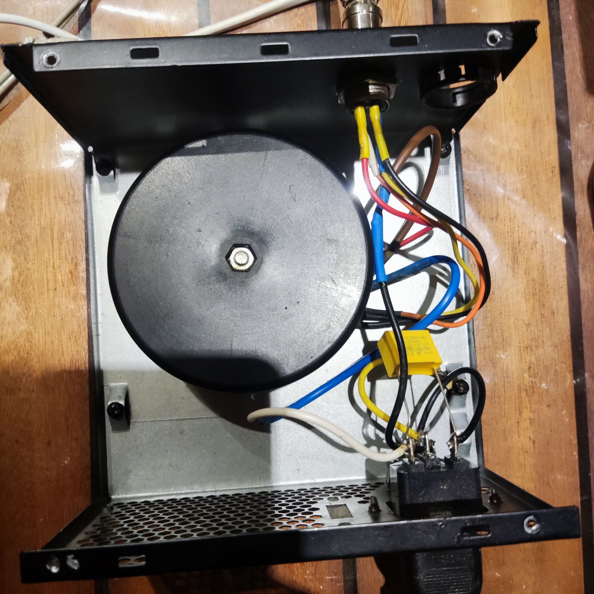

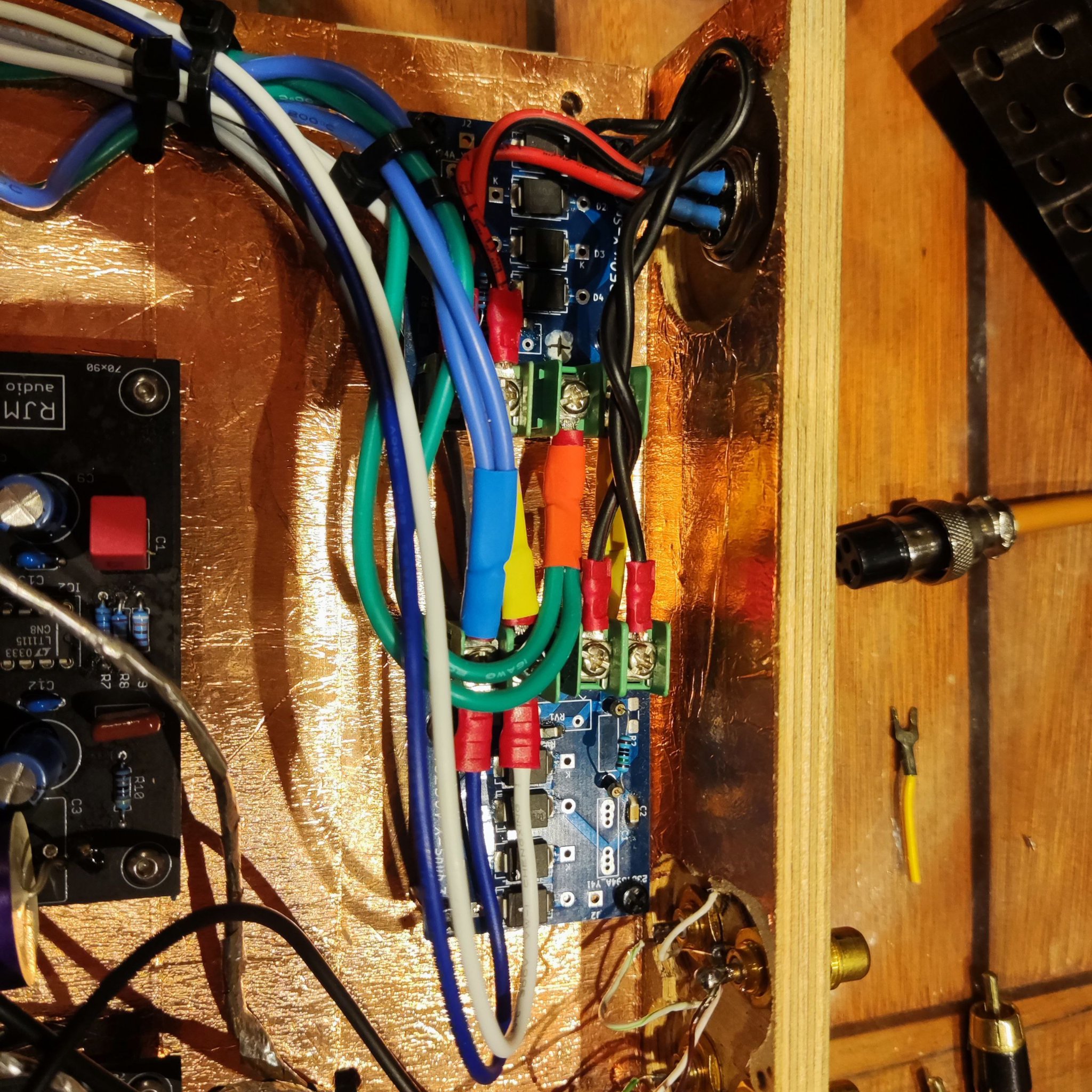

On another note, I would move the rectifier/snubber thingies to the transformer box,
they are very close to the signal wires.
Hi
I'm an honest solder man, when I say not skilled in electric I mean in terms of knowledge, obviously I can recognize a cap from a diode but I'm not a pro in that terms, my amp have no phono input it's a headphone amp but no noise on it, if I disconnect turntable gnd noise appears so with gnd connected and directly in the amp no noise,
For me too rectifiers are too near to the signal wires, about that these are made with a lan cable, is that fine? Because I noticed if I touch with my finger the ones on the input side it gives an enormous noise
LAN cable should be fine.
Since you're having noise problem and not hum (ie 50/100Hz) it's probably a bad solder joint or some kind of oscillation.
Do any of the op-amps get warm ?
What OP-amp is the SMD one on the green pcb ? (some fast ones like to oscillate)

OK, the 1115 draws about double the idle current than the OP27, it gives off about 0,25Watt - so warm but not scalding hot.
OPA1611, interesting choice - not too extreme, a bit high on the offset voltage - but for MM probably OK.
For MC I would swap to 1115 as IC1.
Then if all solder joints look OK it's back to the cables...
You have at least one big antenna with the grounding.

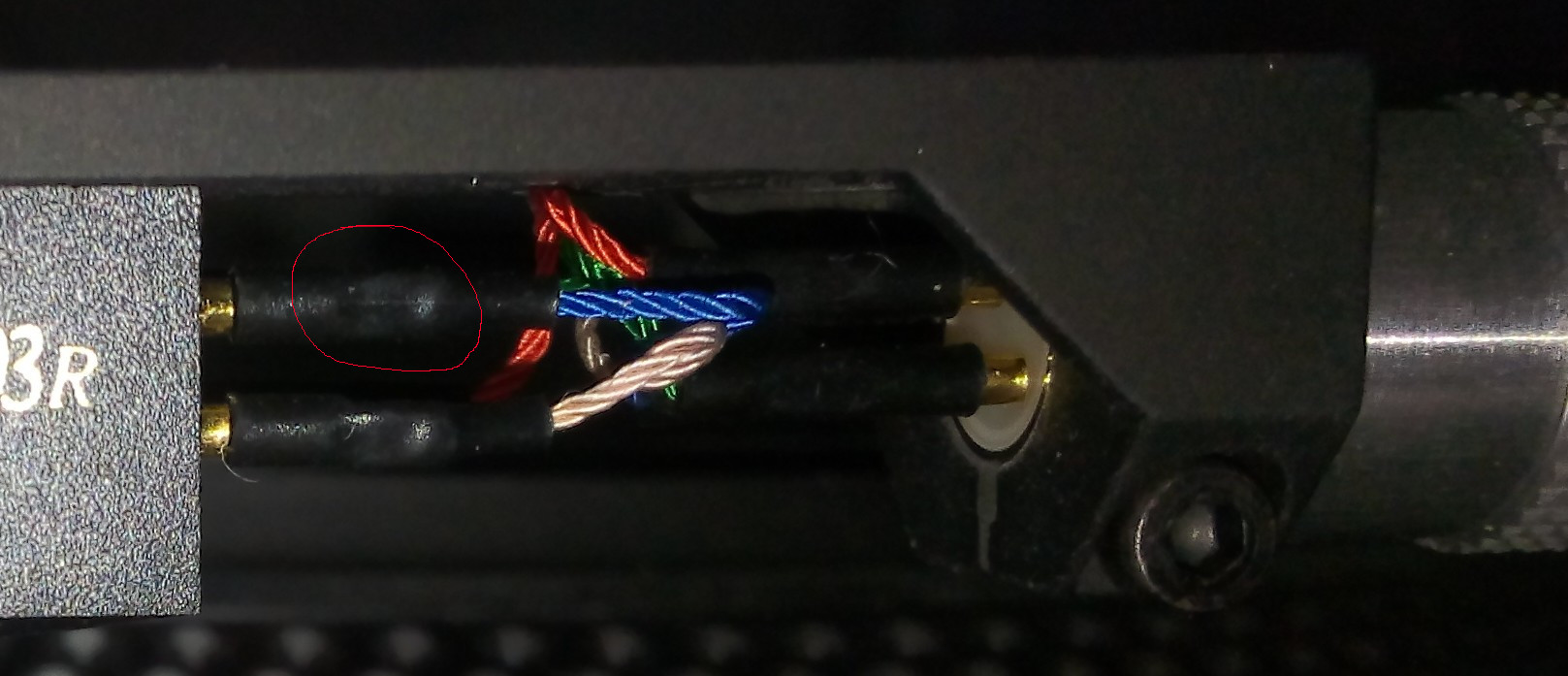

Check the wiring of your turntable, mine was suspicious close to the pickup:
...and I changed to the fancy ones in the picture...

Best to leave the boards as they are, for now.So if I turn the board 180 deg. And reduce wires length could improve this?

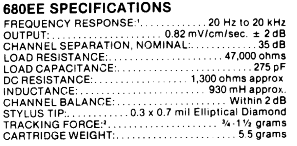

Ahh, that's a somewhat rare beast 🙂i have a Stanton 680 EE
Recommended Capacitive load are 275 pF.

The Switchboard would conveniently allow you to load the cartridge correctly, but it won't fix the noise you are hearing.
Which, to me, sounds like an op amp with the input left floating, of perhaps with the feedback resistor disconnected -- a circuit running with way more input sensitivity than intended, in other words, so every little electrical noise is magnified. Though I suppose if you were recording those videos with the gain at max that could also account for it.
