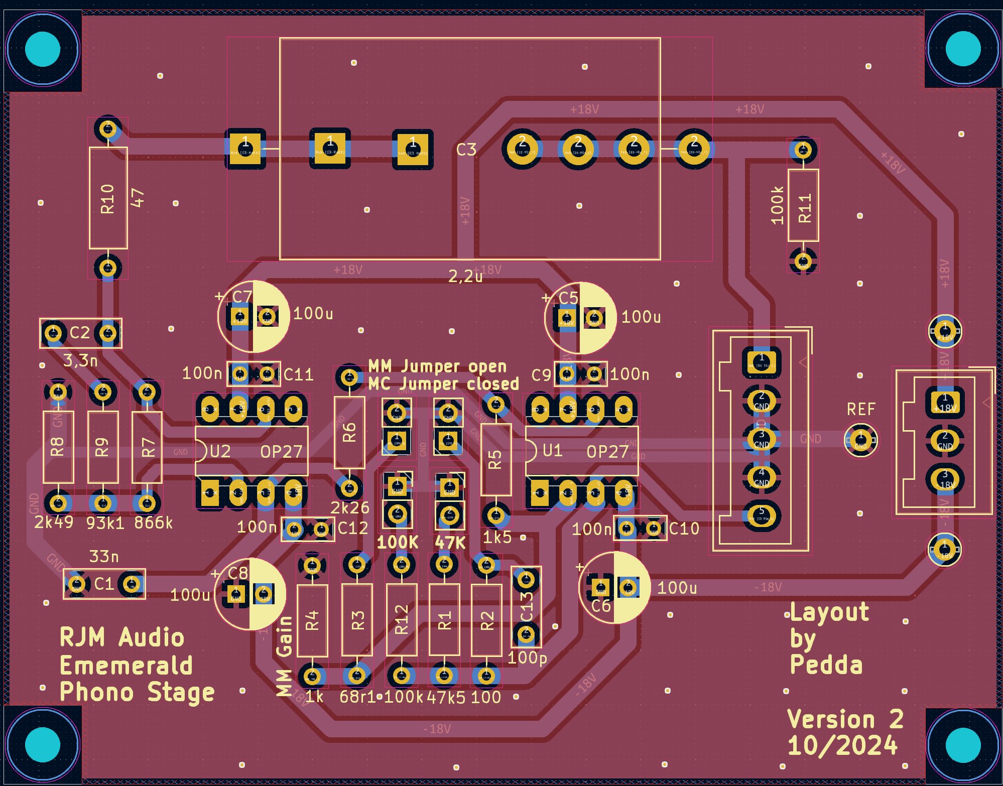

I found a stupid mistake i made in the schematic and afterwards in the layout then.😡
There was a connecting from the rails to the testpoints. I cut this little track connection with a cutterknife. Kenta16807 gave the right tip 👍
I compared the original schematic with mine and took another look the original layout, using a gerber viewer, and found out my stupid mistake.
I hope the emerald boards are working now without a problem. It was too late yesterday evening and i will test the boards soon...
I will report...

you seem to have a short here or something wrong in Q1 and Q2.

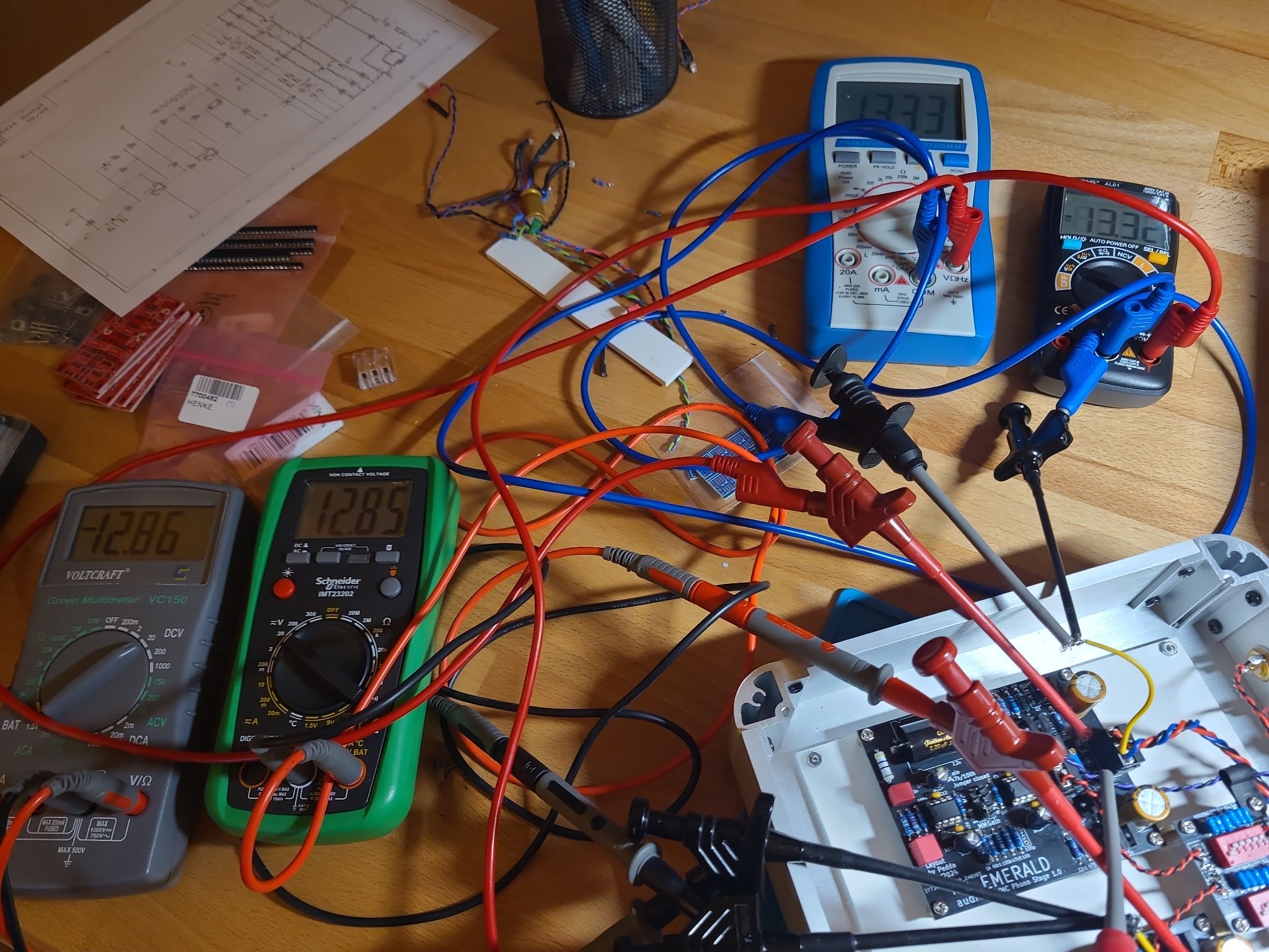

So, a bad solder joint and a short to earth on the housing have cost me some time.Now I have finished the pre-amp. It works great on one channel, on the other it sounds as if the tweeter is defective.
The OPAs are all OK, the jumper also works. I suspect an electrolytic capacitor is defective. If the voltage after the R11 is correct and the OPAs are OK, there it could only a capacitive out of range - is that correct?

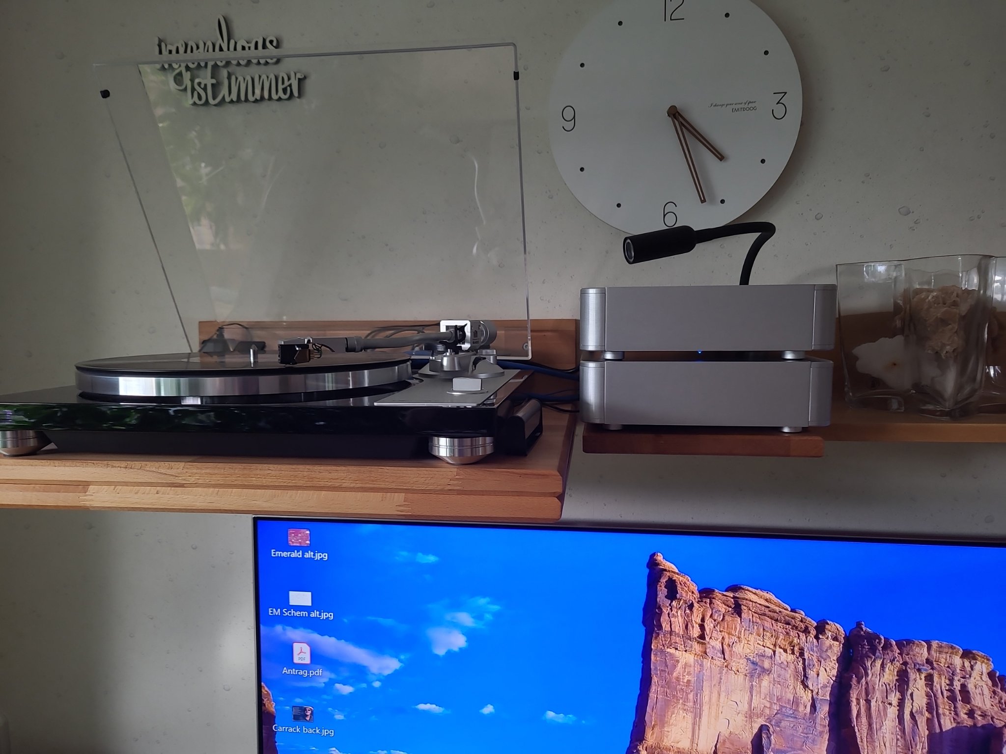

I have now installed the LT1007 and the NE5534 and what does it do, or rather what is noticeable?
1. dead silence - whether MC or MM, no background noise. I liked that so much with the VSPS, and it's the same here. Maybe it's the circuit design? Very good in any case!
2. channel separation: subjectively very high, i.e. a large stage
3. fundamental: superior bass, delicious.
MC: Very very nice.... I like it.
Richard, Thanks for the Emerald!

I have a question aubout the on board supply....
The voltage on my boards is drifting a little bit up and down in mV. Is this the normal case ? It takes a little time to reach the adjusted +-14 volts after power on.
For example...+13,99 volts/-14,21 volts if i power on....after a few minutes the voltage on both boards is equal and i get 14,16 volts with a trnd to lower on each rail, but thats not what i have adjusted in the evening.
Thats not dangerous to the OPA, but i find it a bit strange.
As wrote here in the thread....using one pot give different voltages on the boards. I had one board wtih 13,34 volts and the second with 12,85 volts. Using two pots you can adjust equal voltages for the two boards. On my boards i designed the layout for two pots.

@Kleinhorn As you note, rocksteady output voltages are unnecessary for this circuit, and the S-reg is not designed to provide them.
The idea is to provide low noise and low impedance, the actual output voltage will fluctuate a little with temperature, which is especially noticeable on a cold start.
You are welcome to use whatever power supply / regulation circuit you prefer. Will it sound better? I suggest you might want to compare before deciding.

Hi rjm,
you are right. There is no need to use a different supply. My Emerald is working and the sound is very good, like it more than my Supra 2 from Elektor. I am using a grado silver, MM, and had to adjust the gain a bit. In the moment i use (R4) 470 ohm, 1 k was not loud enough....i think i change to 330 ohm at last.
No backround noises, clear sound. I will hear with the OPA27 a time and then try other ic's.
