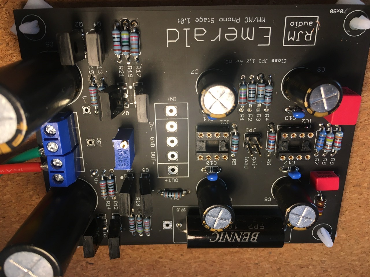

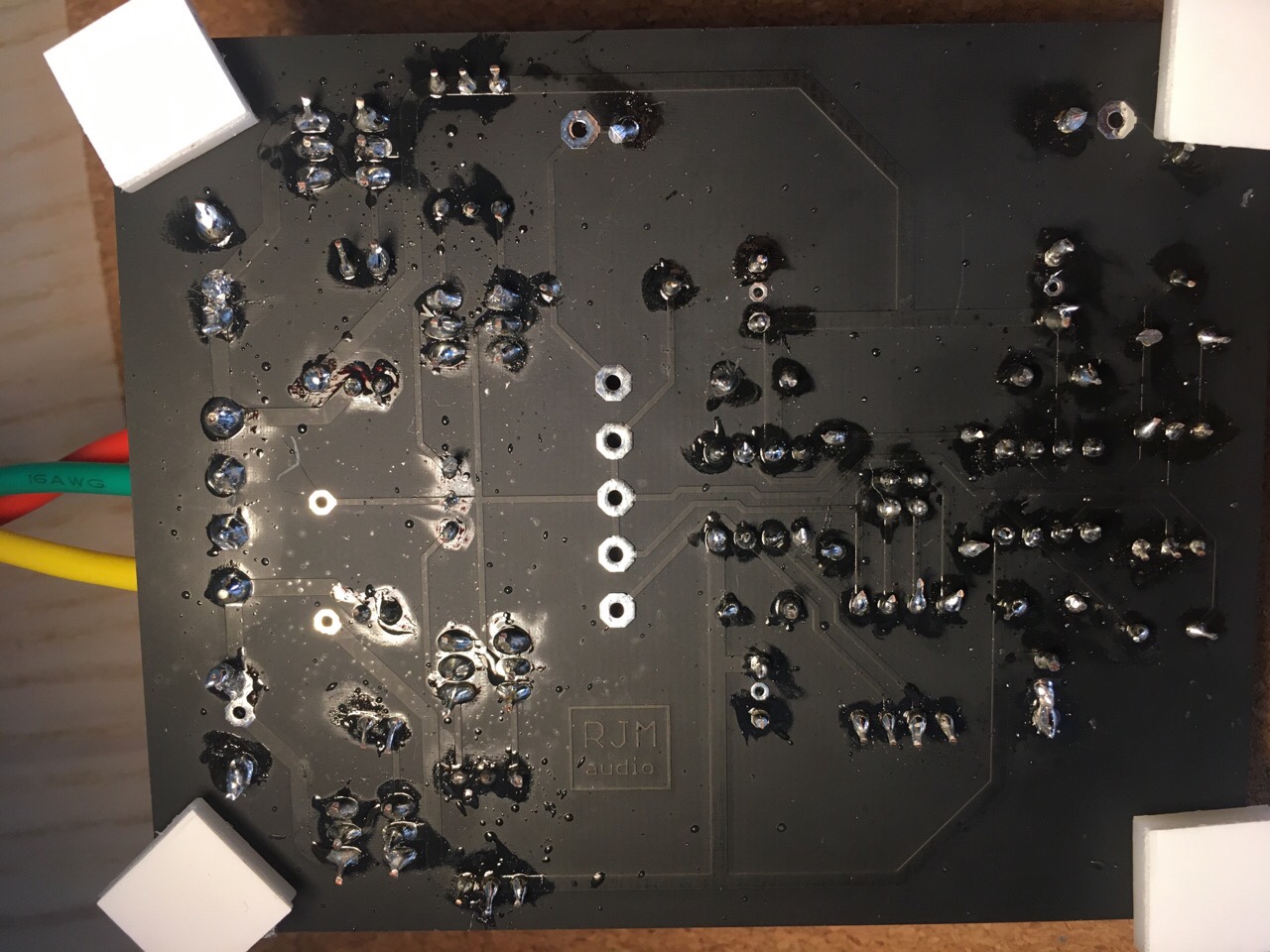

Here is the board, I hav checked the resistors and the transistors. Everything looks good to me. Sometimes I have soldered the two + pads together with the capacitors, but I don’t think it matters?

First comment is the circuit will work just fine with +\- ~9 V rails. So you may want to give it a try to see.
Second comment is
Q1,Q3,Q5,Q7 BD136 PNP
Q2,Q4,Q6,Q8 BD135 NPN
Odd part numbers are "positive" PNP BD136, even part numbers are "negative" NPN BD135. I'd be surprised that you soldered all the transistors incorrectly and the output was still more-or-less right, but I can't confirm or deny it being possible.
The output at the V+ and V- pads should be about +/-13 V. It can be reduced by changing the value of R20,21 from 10k to 6.8k or so. The output voltage will scale with the change in resistance. I say this because if your V++ V-- rails are only 15 V running at 13 V is a little tight as it doesn't leave a lot of headroom for the regulation circuit. I would recommend changing R20,21 to 7.5k or 6.8k. You can test by soldering 47k or 100k in parallel, which will temporarily lower the effective resistance by 10-20% or so.

Yes, spend one hour with a soldering pump, flux and solder wick and managed to get one out and break another. I don’t have a desoldering gun.
I will do as you say, snip them and buy new.

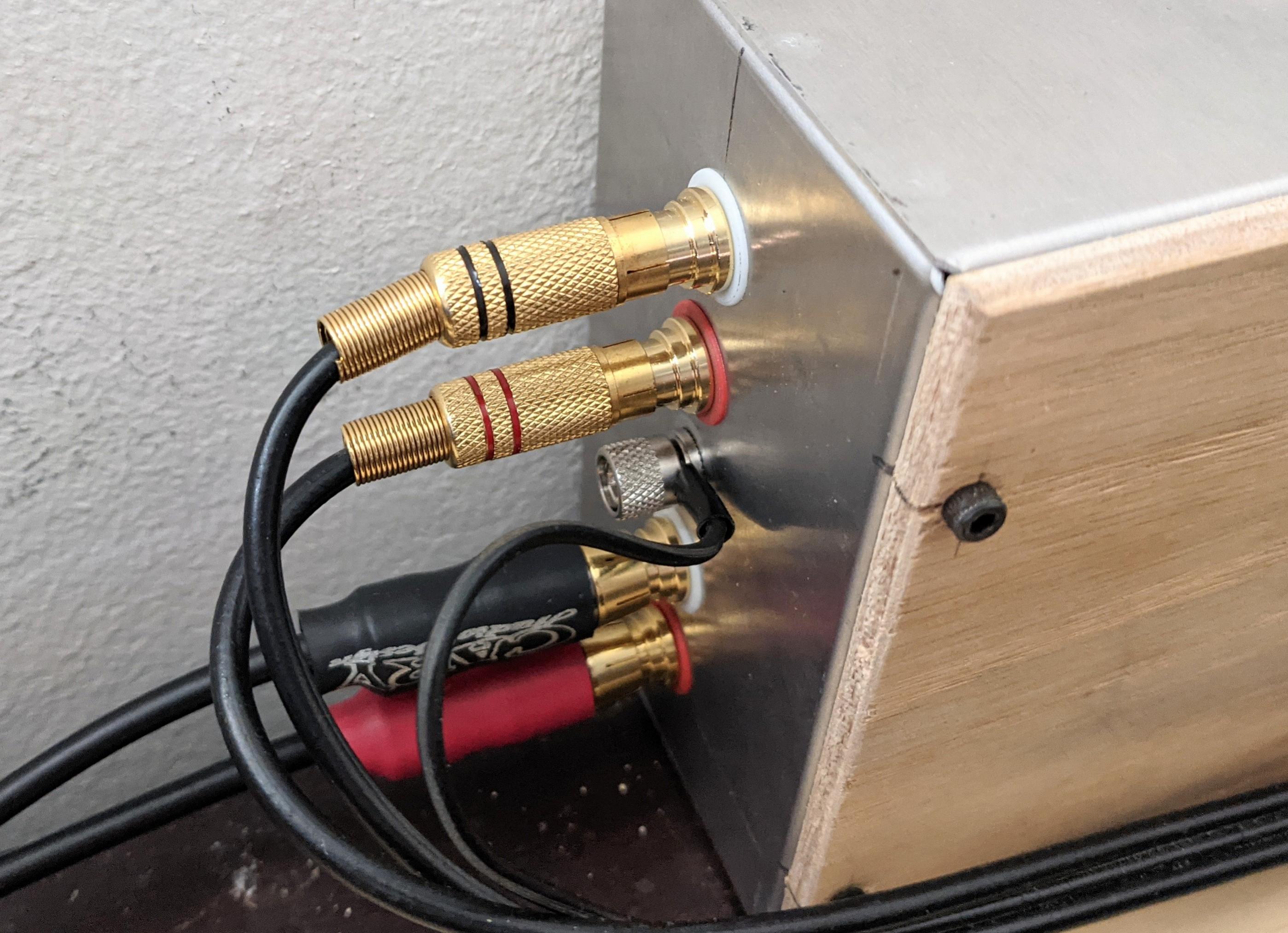

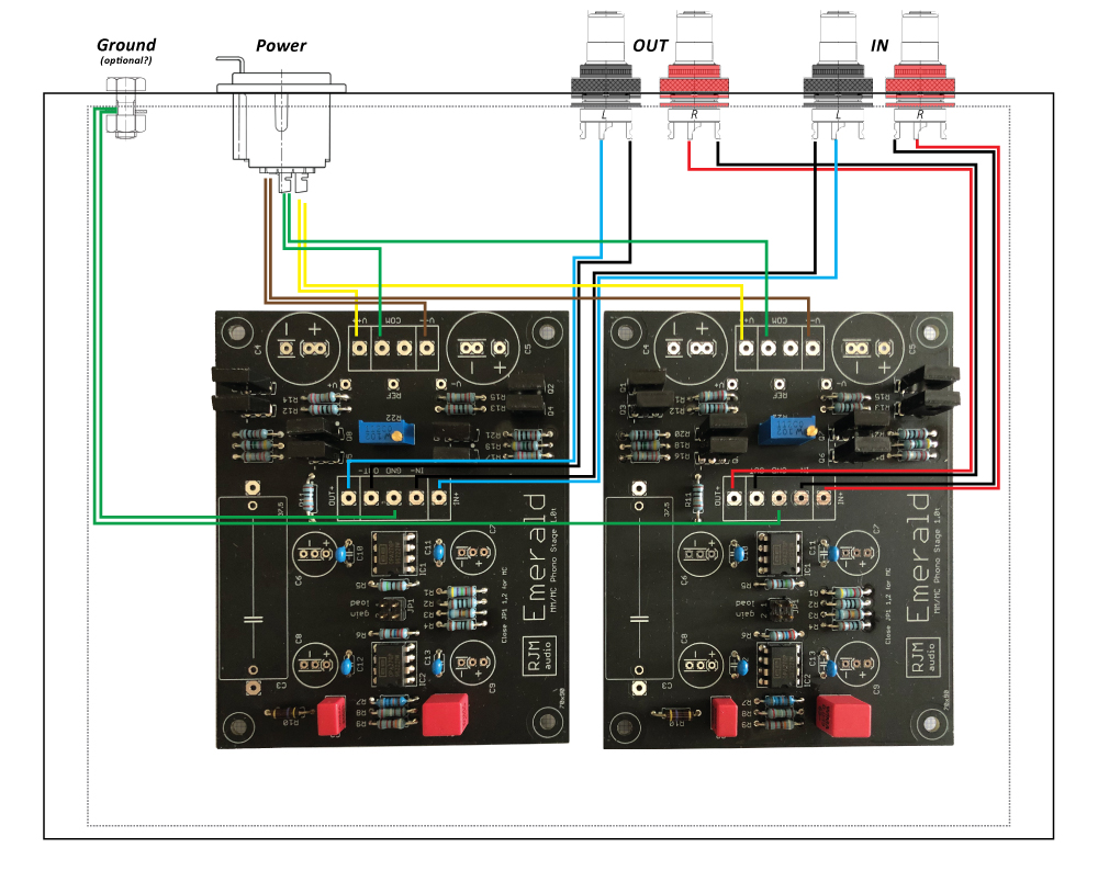

Hello, ground is not optional unless your want your turntable to sound weird.
Ok, I thought only the Psu chassi had to be grounded. And the Emerald only if there were any weird sounds.
Your turntable has a ground wire that needs to be attached to the preamp chassis.
Most turntables have a ground wire that gets attached to the preamp chassis. I used one of these: 111-2223-001 Johnson / Cinch Connectivity Solutions | Mouser
I attached the two ground wires from the Emerald boards to post inside the chassis, and connected my turntable ground to the post on the outside of the chassis.

That ground lug connects to the turntable, if the turntable provides a ground wire for that purpose.
Don't confuse this with the AC Earth, which the power supply chassis connects to, even though they are all at technically zero potential. You don't connect earth to the Emerald chassis in a two box build, normally, at least not explicitly.

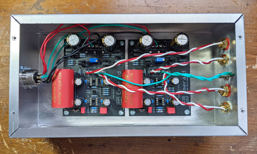

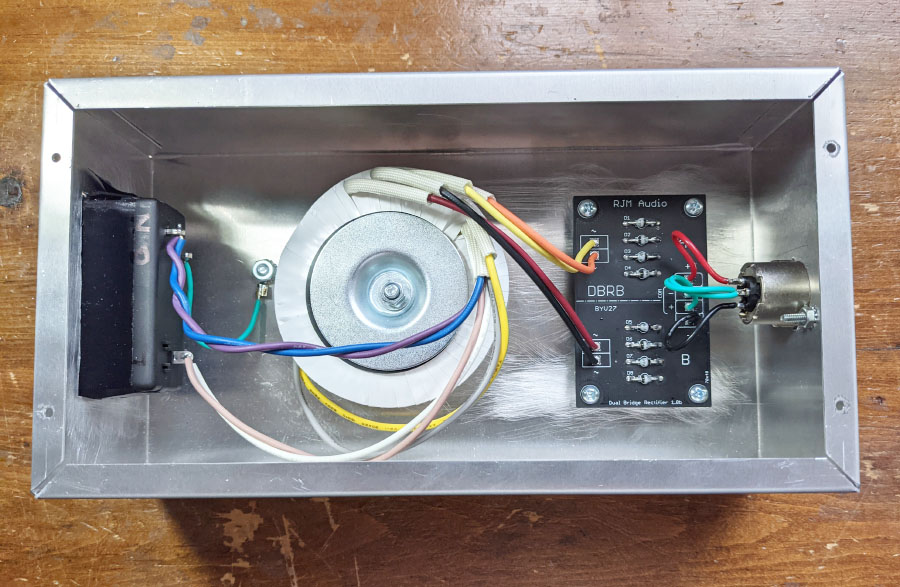

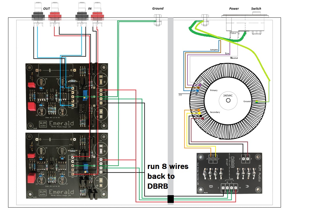

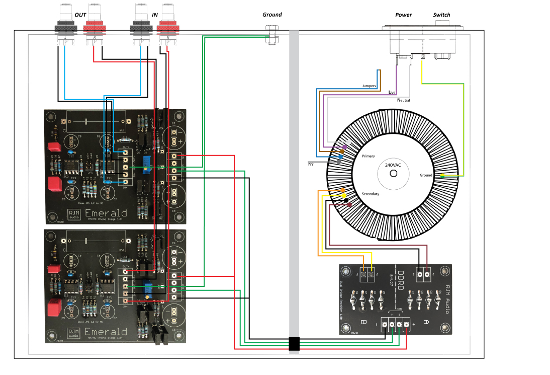

I decided to go with an all-in-one box instead but I'm not sure about the wiring.
According to the Triad toroidal
In 240V: Input to White and Violet, jumper Blue & Brown. What happens with the Grey?
Out 24V: Output from Black & Yellow, jumper Red & Orange
Does this look right?

KeLLoGsX, I see one serious error: The Green/Yellow wire from the transformer is a ground wire for shielding in the transformer. Do not connect this to the Earth Ground terminal on the power receptacle. Connect it to the chassis.
You must have an Earth Ground wire from the power receptacle to the chassis. I drilled a hole in my chassis used a dedicated bolt. You could also attach the Green/Yellow transformer shield wire to this same bolt, too.
But, in your drawing there is no connection from the incoming power cable ground wire to the chassis. It's very important to have that using a very secure connection which is why I used a bolt. Look just to the left of my transformer in the pic below. You'll see a green wire running from the power receptacle to a #8 bolt:

Ok, so a ground from power inlet to chassi. As well as the ground from transformer to chassi.
Got it, thanx!
You have also connected the jumpers (Blue and Brown ”pink”) with the others. Is that the way it goes. I thought I’d stick them together and leave unconnected.

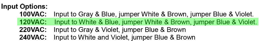

I'm wired for 120VAC. I had to ask Richard about this to be clear. But, for 120VAC it's White and Brown twisted together and Blue and Violet twisted together. I attached the White/Brown pair to Line and the Blue/Violet to Neutral. And, of course, a separate Green wire from Ground to the chassis bolt. I insulated the Gray wire and tucked it away; same with the Green/Yellow shield wire (which I could have connected to the #8 chassis bolt).

Your diagram for the output is correct, it connects as two independent 12 V secondaries, one to each diode bridge on the DBRB.
The 240V AC connection is correct. Connect BLU BRN, grey is not used.
The screen connection is incorrect. It connects to the chassis. The Earth of the IEC socket also connect to the chassis (use a solid bolt with serrated washer, make sure it is to bare metal not paint). So while its true that the shield and socket are connected, the connection is not direct like you show it there.
No no, the shield (electrostatic screen, actually) must be connected to the chassis and earth/ground. It serves no useful purpose otherwise.

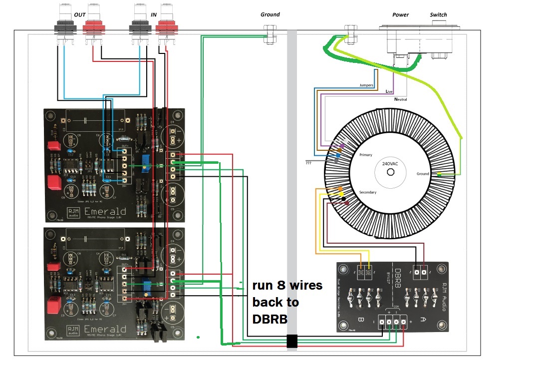

Oops, spotted another mistake. The Emerald power input is v++, com, com, v--. For convenience, duplicate COM connections are provided. The DBRB output is (+ -) (+ -). Each pair is separate.
The connection needs to be
+ -> V++
- -> com
+ -> com
- -> V--
Both inner wires of the DBRB output (+ and - maked "com") have to connect back to the Emerald COM.
You can jumper the pads at the DBRB side and use one wire to connect to one of the COM, or you can run separate wired back to the two Emerald COM pads and they will join there automatically. What you can't do is have the com of one channel connect to the + terminal of the DBRB, and com of the other channel connect to the - terminal. Even though technically both channels are at the same potential, it will likely cause problems.
