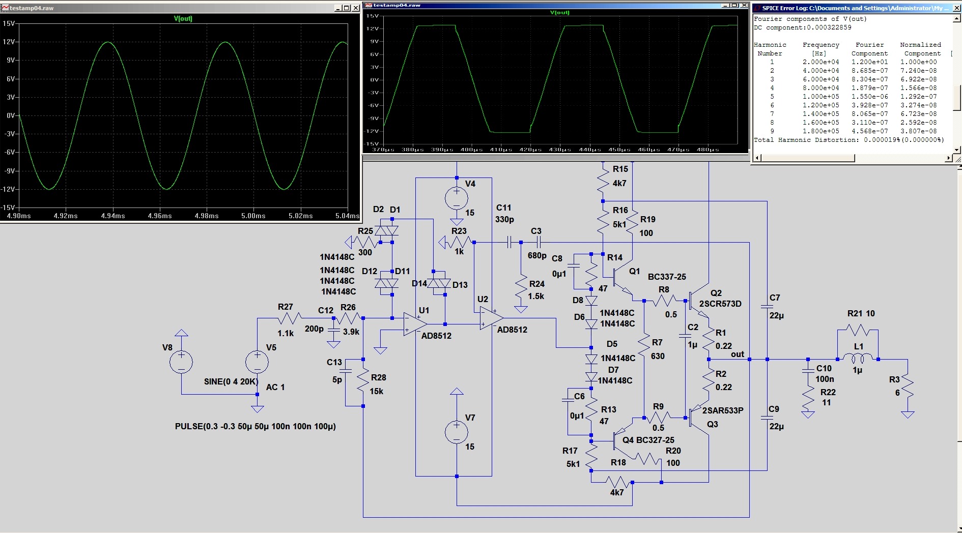

If you put a second operational amplifier and then the distortion will decrease - 0.000019%.
This amplifier can be used for headphones or small 10 watt monitors.
I also checked with OPA2134 - 0.000009% THD in the simulator.
  • testamp04.asc
    testamp04.asc

An important consideration is whether a system can behave ideally with a simple signal and still fail with a more complex signal. If that's not possible, then there is no drawback to testing with a simple signal. In fact, testing using a simpler signal practically has more sensitivity to subtle distortions, so despite it being a simpler signal, such a test may actually be more sensitive.
The whole issue is nonlinearity, and given that a complex signal can be made up of a linear superposition of simple signals, there's no reason to expect simple signals to be insufficient. If a system is nonlinear, it cannot pass a simple or complex signal without alteration. Given that our current equipment can test sine waves to a much higher sensitivity than other test signals, it seems that sine waves, despite their simplicity, could be better suited to detecting nonlinearity.
You are fully correct, but some signals are better to detect a non-linearity than others. A single tone FFT for instance does not give you a lot of info on phase and polarity relationships between the components. IMD signals give a different type of info in the intermod products, while multitones give another rich set of info, like noise in the presence of sinals.
But yes, the non-linearity is what it is and does not change with test signals.
