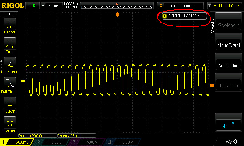

Consider investing in a differential probe (you are trying to measure a very high-speed signal ~400MHz), then you can measure these high frequency / low amplitude signals around the circuit even if neither "side" is grounded; i.e. the fact that the oscilloscope is grounded won't matter.
I checked the schematics.... the clock assembly feeds clock signal to 3 different destinations; 2 are unbuffered; one is buffered. Which one are you trying to measure?
To fit more cycles of a signal on the LCD (for example 30, as suggested...), adjust the time base.

Yes, adjust the time base - the horizontal time / division control - until there's more cycles on the screen.

I have the same scope: use the counter function! The frequency display works better if you have some 10 to 20 waves in the screen: if you have only 3 waves displayed it can't calculate of course an exact value!!

As mentioned in this thread: use settings for averaging, noise reduction etc. etc.!

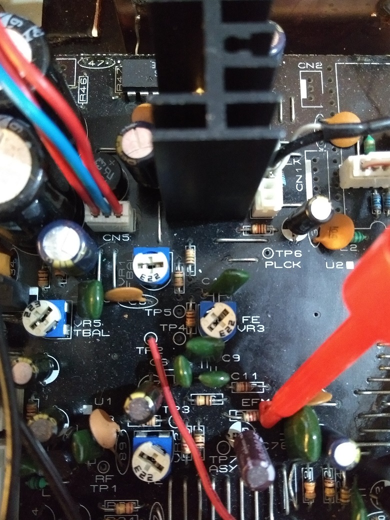

Hi, the cable is to ground the resister as per instructions. When I do ground it I get a lot of noise. 😱
I suspect they didn't mean chassis ground. You will need to identify a local ground on the board. Possibly there is a something identified as a ground point on the board itself.
The chassis safety GND may not be connected directly to the board GND plane.
Possibly use the same point the RCA output jacks connect to, although technically that is probably too far away even at 4.3MHz.
A quick hint as to whether the PCB ground and safety ground are connected would be to measure the DC resistance between chassis and the RCA jacks using a DMM.
