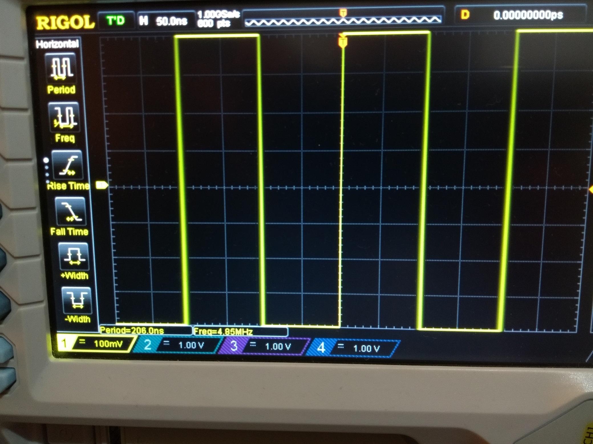

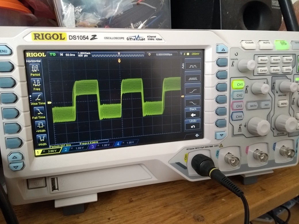

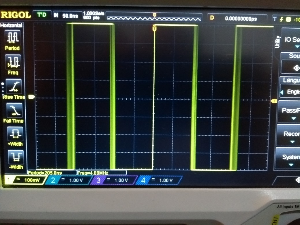

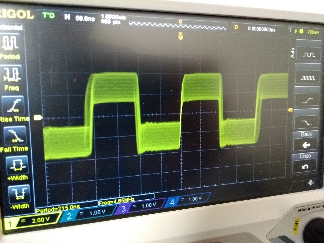

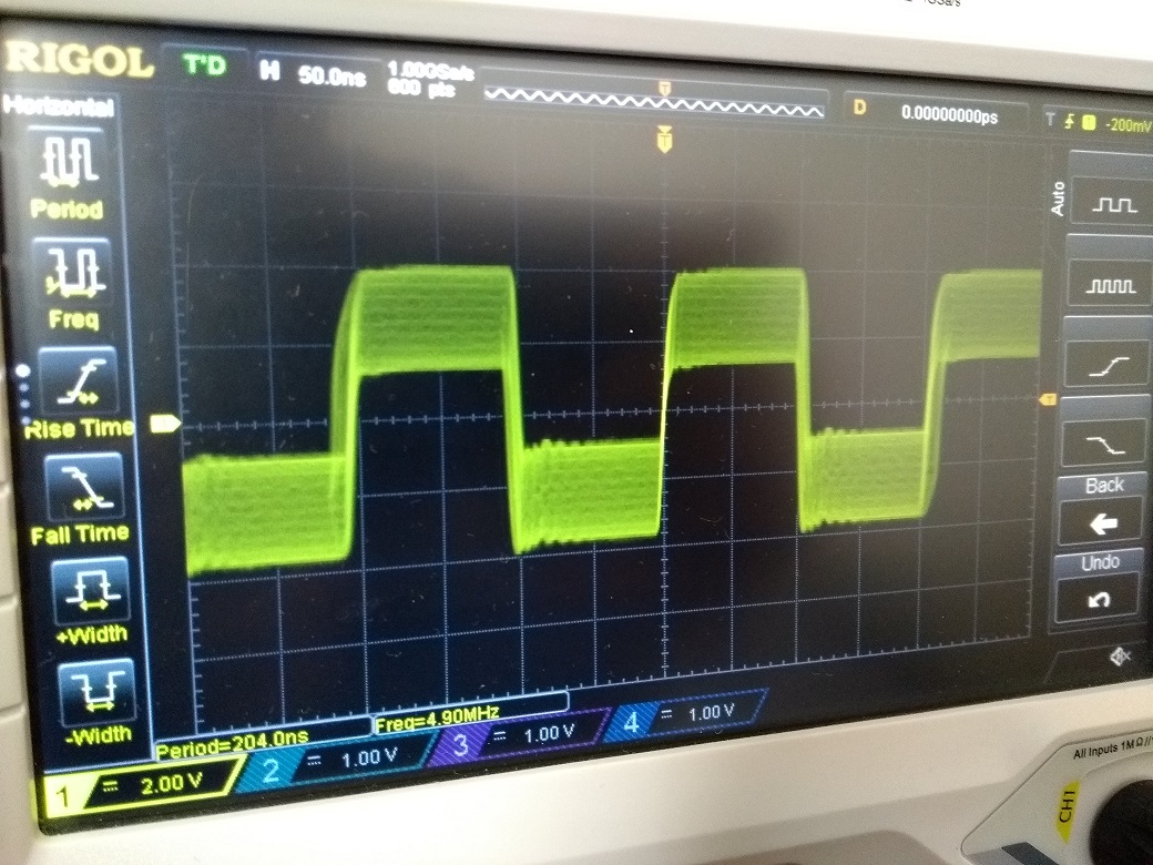

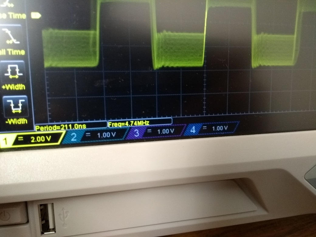

Rigol DS1054Z not stable reading MHZ

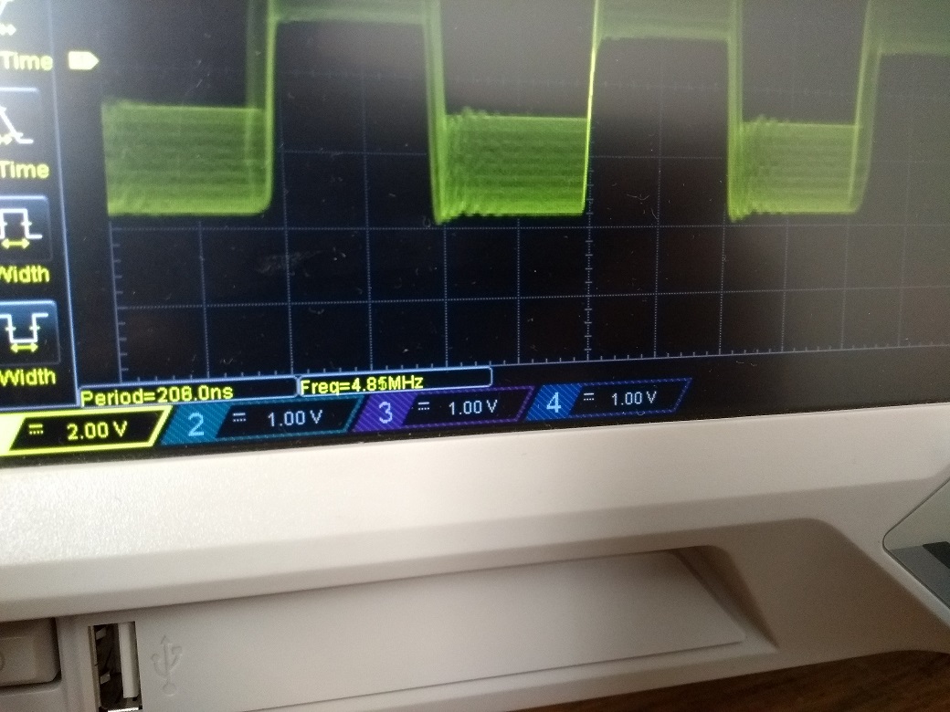

To fit more cycles of a signal on the LCD (for example 30, as suggested...), adjust the time base.
Does the oscilloscope power cord have an earth pin? Also, are you sure that the mains (IEC) connecter earth pin at the back of the oscilloscope is DC (directly) coupled to the probes' BNC connector shell? Very unlikely! The mains ground is properly connected to the BNC ground using capacitors (of various capacitance).

Its should be under 5 MHZ and the scope is rated at 100MHZ

Yes, adjust the time base - the horizontal time / division control - until there's more cycles on the screen.

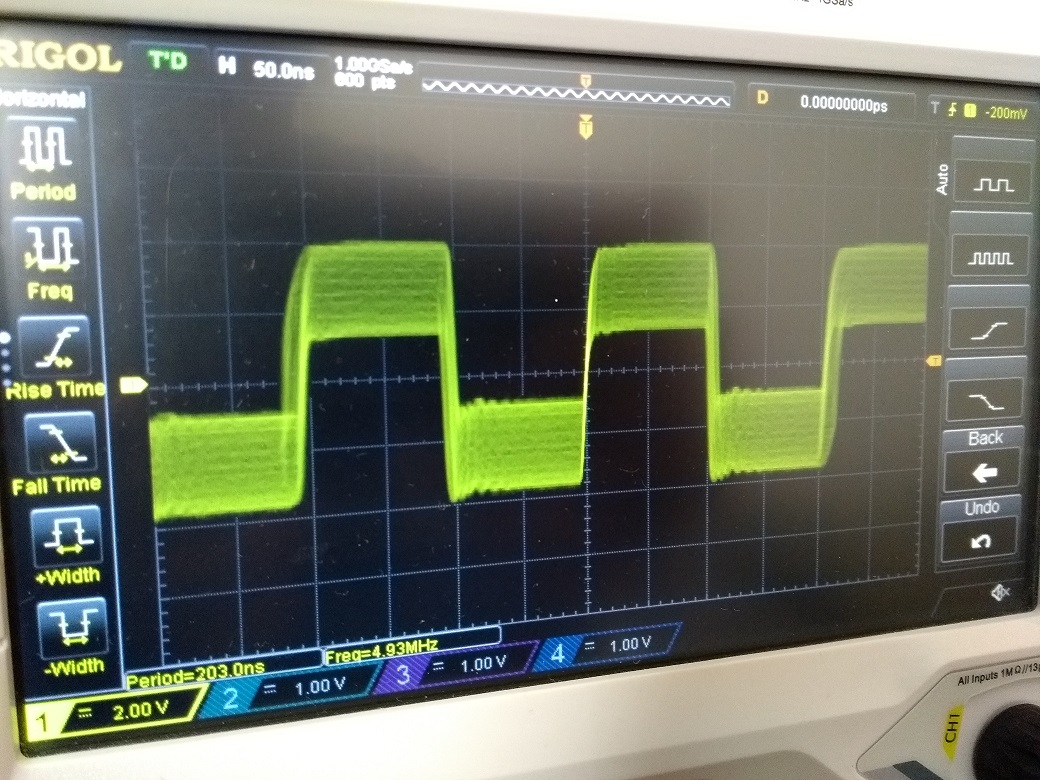

Since you're just measuring frequency, you may get away with a cap between the scope probe ground and the ground at the measurement point. Big enough cap to let 4MHz through, small enough to reject the AC interference.
You may get away with using a ground pin isolator on the scope AC cord. This advice requires caution - Tektronix screamed bloody murder about their scopes not being earth grounded, yet they designed them to be able to do so (even their battery powered scopes had all kind of WARNING about not connecting the scope ground to earth ground) Unsure if Rigol can do this...

I have the same scope: use the counter function! The frequency display works better if you have some 10 to 20 waves in the screen: if you have only 3 waves displayed it can't calculate of course an exact value!!

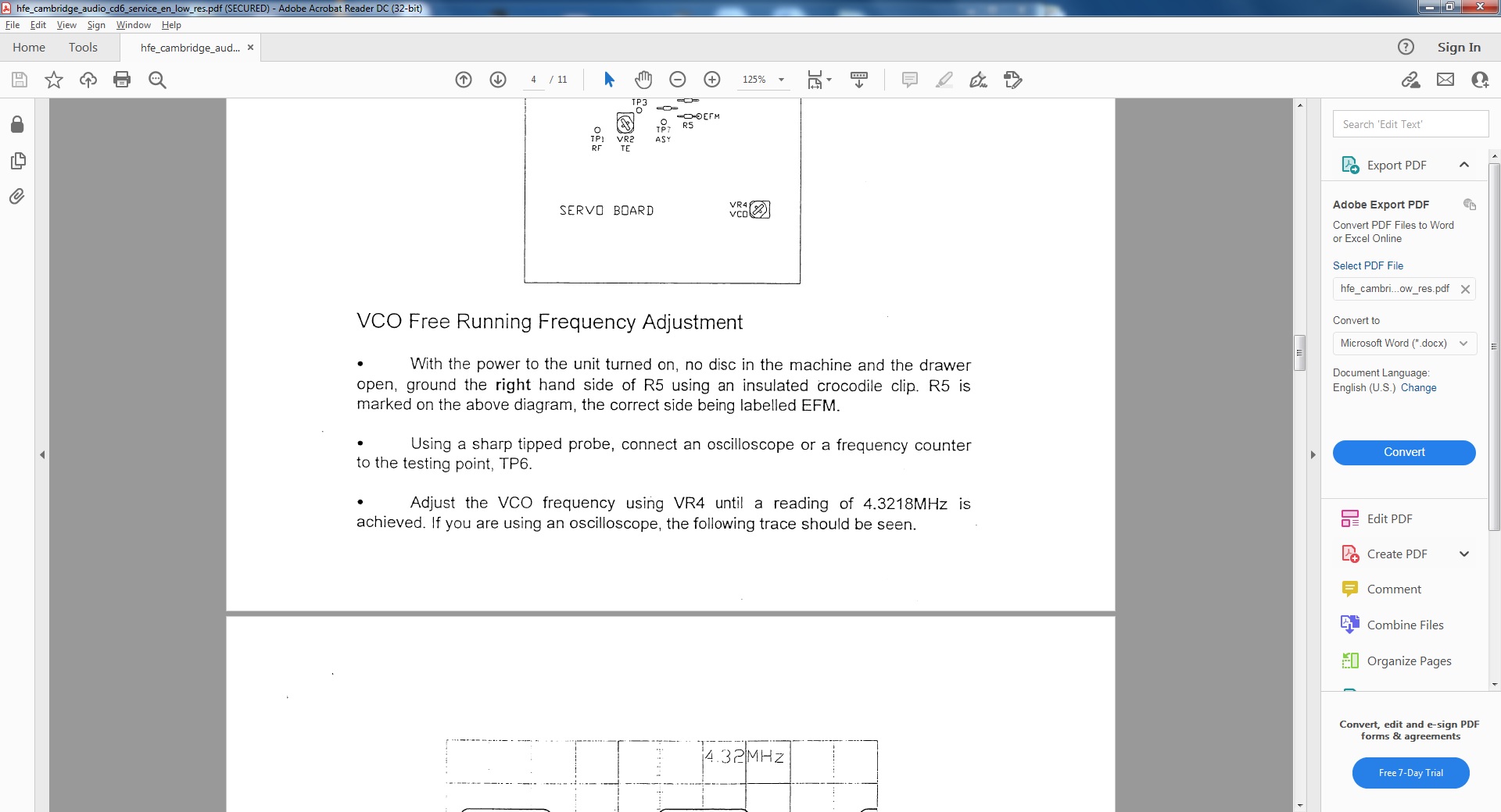

I suspect they didn't mean chassis ground. You will need to identify a local ground on the board. Possibly there is a something identified as a ground point on the board itself.
The chassis safety GND may not be connected directly to the board GND plane.
Possibly use the same point the RCA output jacks connect to, although technically that is probably too far away even at 4.3MHz.
