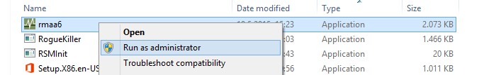

I have, right click on install file and choose run as administrator.
Hope it helps
Marko

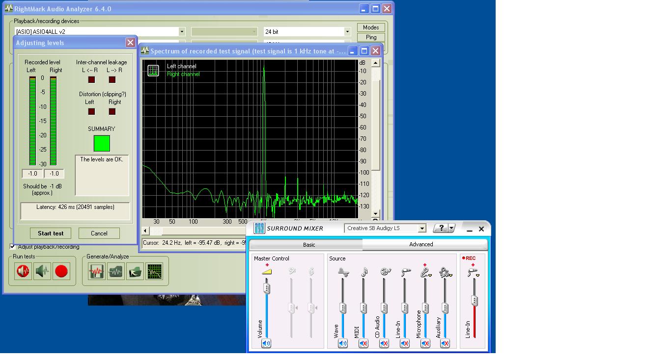

RMAA needs you to adjust the levels before you run tests. It needs around -2dBfs signal to correctly read the sync signal. It works fine with mono signal, I use it all the time.
The interface has a level setting interface that comes up when you run the tests. You need the two red squares to turn green or you get the sync signal error.
I find the best way to use RMAA is to use a small attenuator at the input side, set the input level to max, the output to a suitable level depending on the gain of the DUT, and when the level check interface comes up, adjust the attenuator for the correct level so the green lights come on.

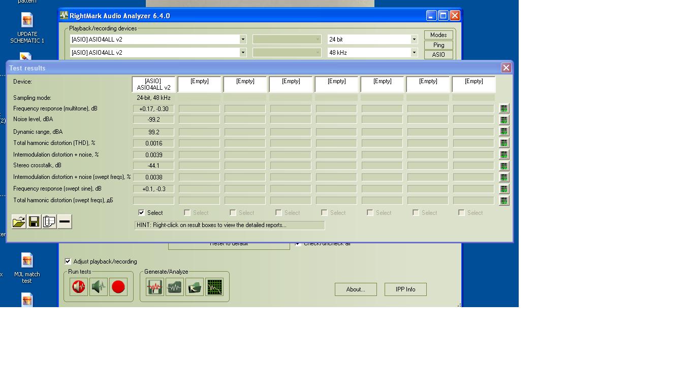

Hi Bonsai,i'm using both RMAA ,ARTA under Win xp without any issue (ASIO drivers).
What operation system are you using?

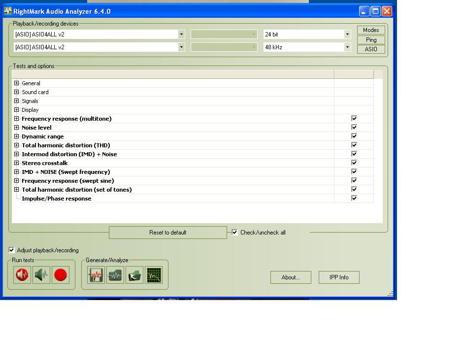

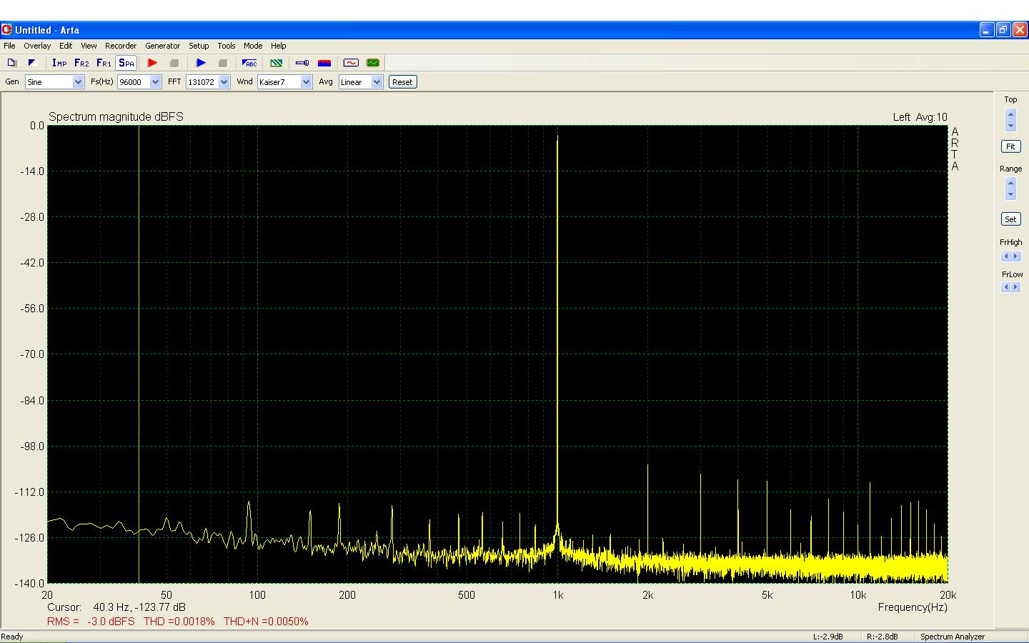

Here is a loop test line out to line in.

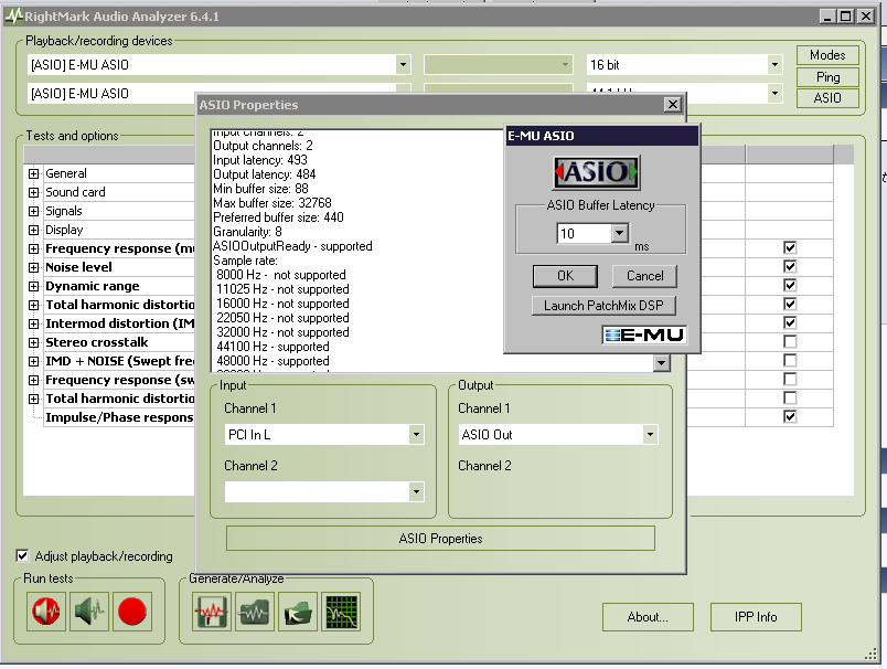

Bonsai, can you provide a screenshot of your MixControl page? I am not 100% familiar with that interface because I don't have a Focusrite, but it might be simply a routing/mixing issue.
